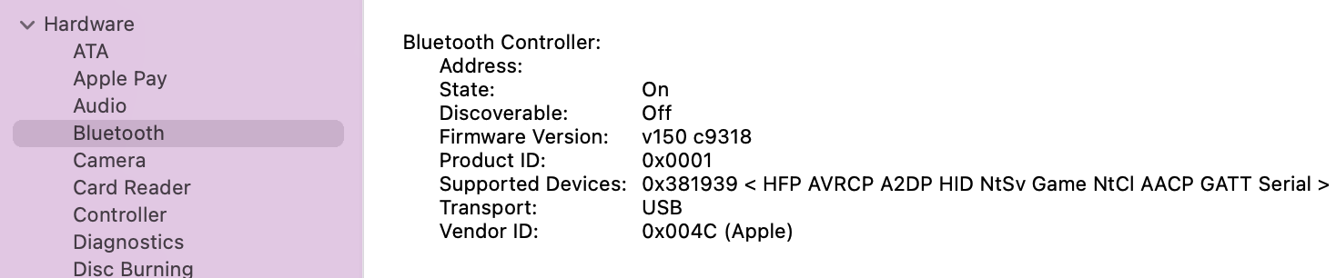

Rocky12 Posted July 17, 2021 Share Posted July 17, 2021 I have no idea how to make this working Quote Link to comment https://www.insanelymac.com/forum/topic/348300-macos-monterey-bcm943602cs-bluetooth-not-working/ Share on other sites More sharing options...

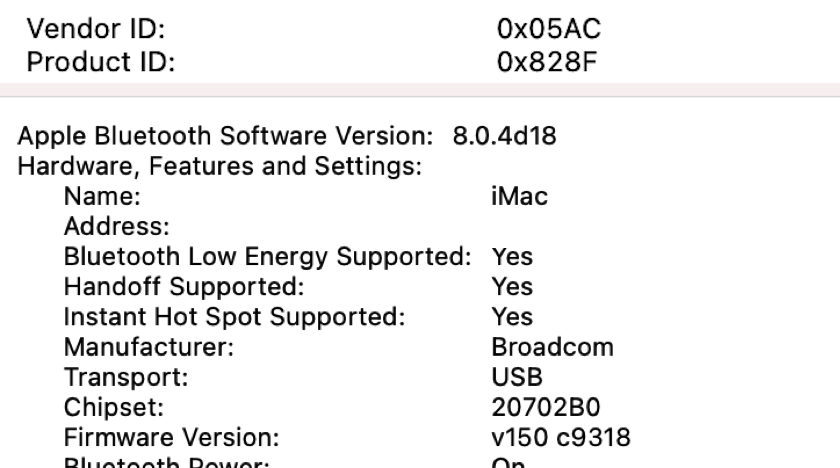

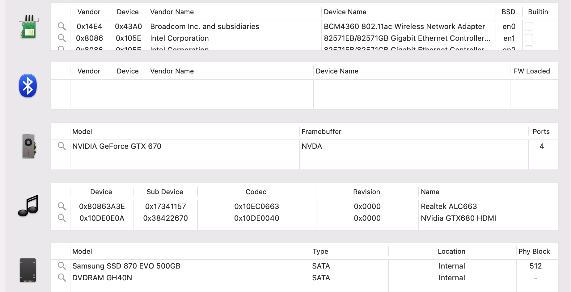

Rocky12 Posted July 17, 2021 Author Share Posted July 17, 2021 Some hardware info this, a genuine Apple Card I am using in my pc with PCIe Adapter thanks buddy, I will give this a try Quote Link to comment https://www.insanelymac.com/forum/topic/348300-macos-monterey-bcm943602cs-bluetooth-not-working/#findComment-2763081 Share on other sites More sharing options...
Rocky12 Posted July 17, 2021 Author Share Posted July 17, 2021 All this information I got from BS, not from Monterey Because under Monterey the Card doesn't load the Firmware Quote Link to comment https://www.insanelymac.com/forum/topic/348300-macos-monterey-bcm943602cs-bluetooth-not-working/#findComment-2763082 Share on other sites More sharing options...
