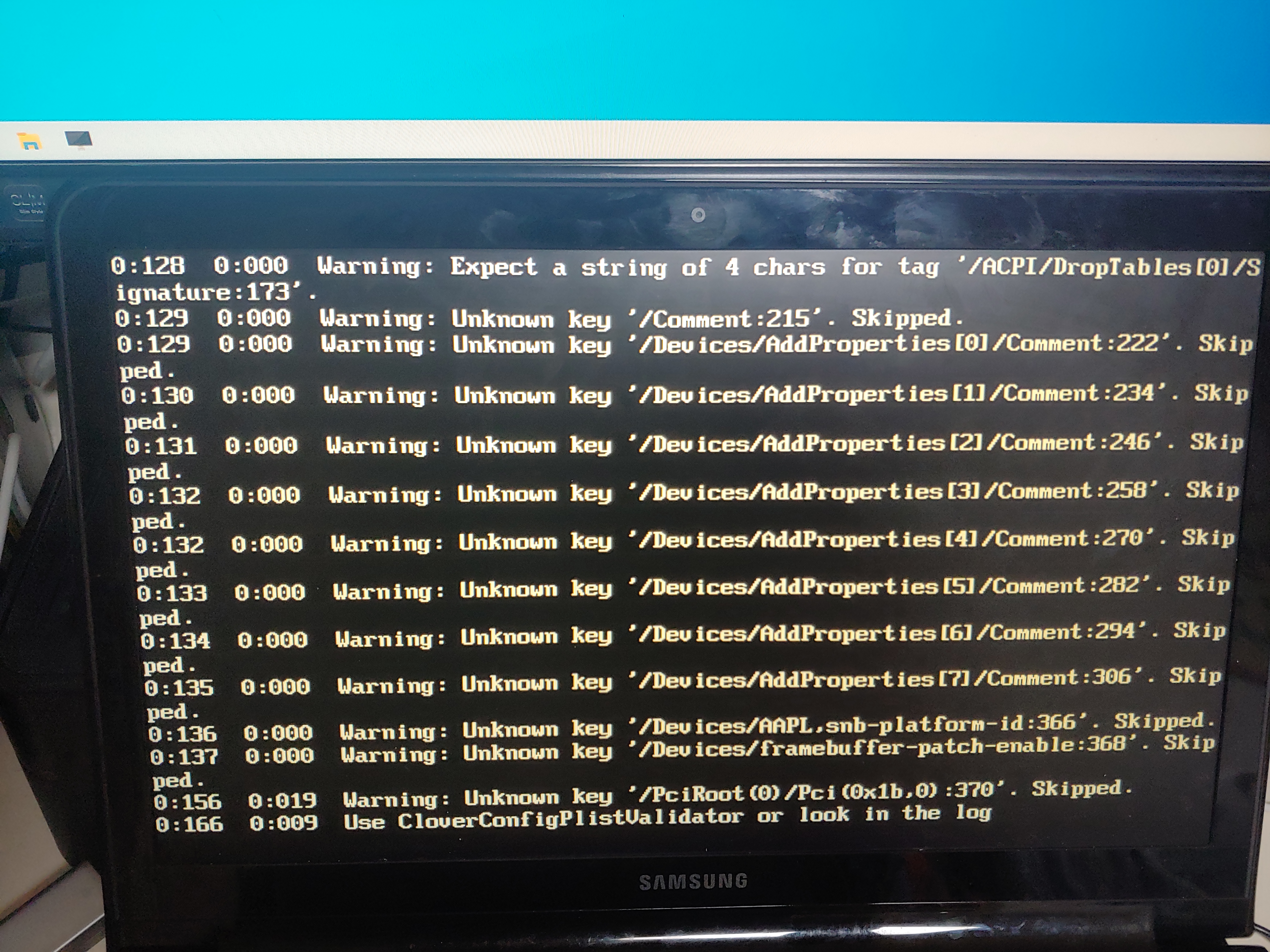

Duhee Cho Posted May 4, 2021 Share Posted May 4, 2021 (edited) Hello. I am trying to install macOS 10.15.7 Catalina using Clover Bootloader version 5134 and Rehadman's laptop config.plist. However, I am encounter with the error even before seeing the Clover Bootloader screen. What can I do to solve the problem. I will attach the photo showing error on the screen and config.plist I used. Thank you in advance. Specs of my laptop Manufacturer: Samsung Series: Sens Series 9(2011) Model Number: NT900X3A-A51(Korean variant of NP900X3A series) CPU: Intel Core i5-2537M GPU: Intel HD Graphics 3000(GT2, Mobile) Motherboard: Intel HM65 Express SSD: Samsung Portable SSD T1(Based on Samsung 850 EVO SATA) RAM: DDR3-1333 4GB * 2 config.plist Edited May 4, 2021 by Duhee Cho Quote Link to comment https://www.insanelymac.com/forum/topic/347631-unable-to-enter-clover-bootloader/ Share on other sites More sharing options...

Guest 5T33Z0 Posted May 7, 2021 Share Posted May 7, 2021 Validate your config and fix the errors. See my Clover Update Guide in my signature for details Quote Link to comment https://www.insanelymac.com/forum/topic/347631-unable-to-enter-clover-bootloader/#findComment-2757343 Share on other sites More sharing options...

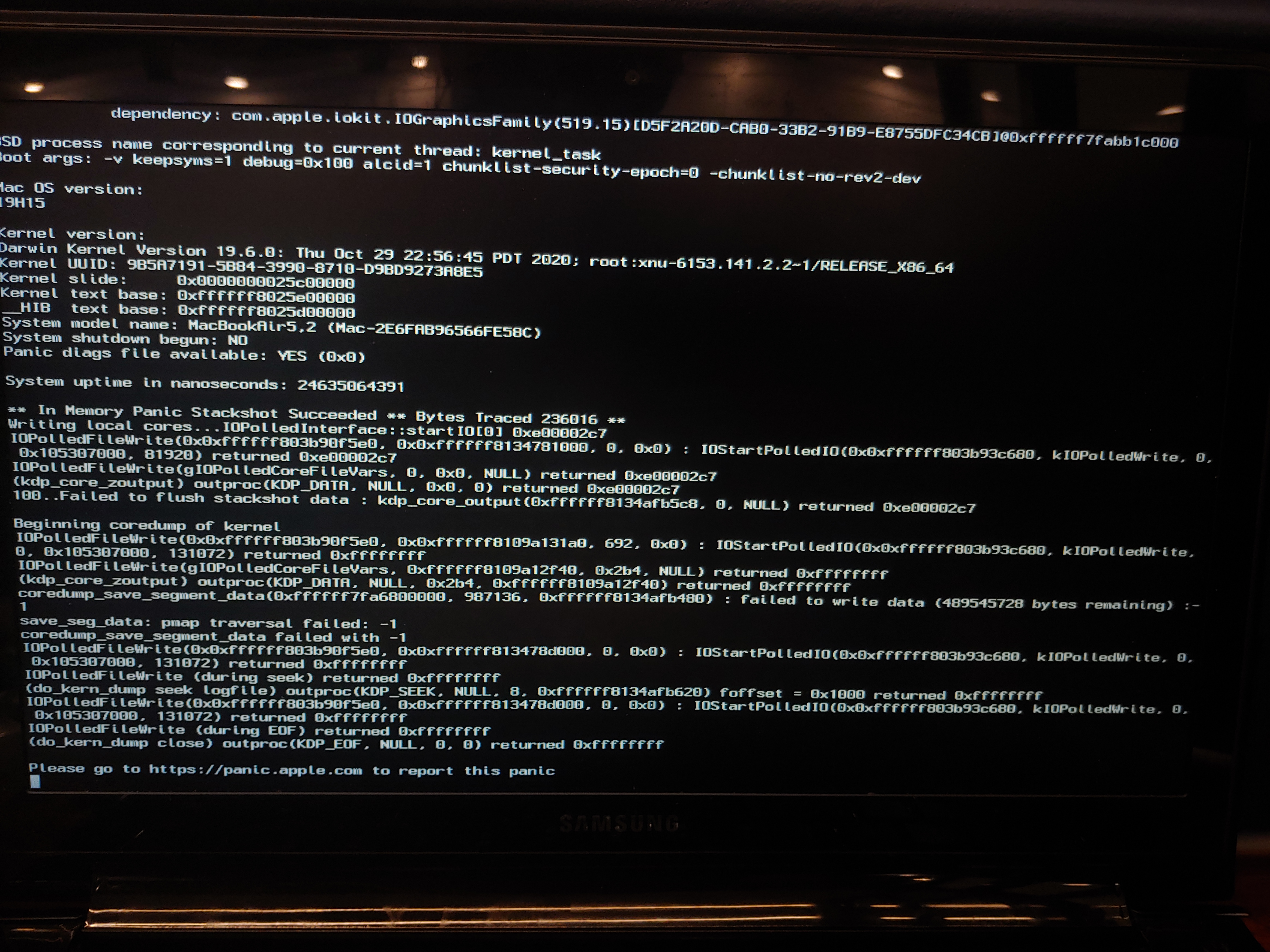

Duhee Cho Posted May 8, 2021 Author Share Posted May 8, 2021 (edited) 22 hours ago, Hervé said: @Duhee Cho I don't fully agree with @makk's writings and assertions. Stick with High Sierra, you'd get the same horizontal lines in Sierra. My own past experience with a Dell Latitude E6220 (Sandy Bridge laptop with HD3000 graphics) taught me that these graphics defects started in El Capitan. I had no such issues up to Yosemite. I also found out that it gets worse after repeated Sleep/Wake operations so I tended to switch off the laptop after usage rather than put it to sleep. The bug lessens a little with 8GB RAM and VRAM increase patch but never disappears and, as stated before, there just isn't any fix. My laptop, in fact, has horizental all the time since it boots up. I am trying Catalina with Opencore 0.6.9., and there are no horizental lines here. But kernel panic occurs when I installed legacy video patch in 19H1030. So I am trying to install 19H15 now. Edited May 8, 2021 by Duhee Cho Quote Link to comment https://www.insanelymac.com/forum/topic/347631-unable-to-enter-clover-bootloader/#findComment-2757417 Share on other sites More sharing options...
Allan Posted May 9, 2021 Share Posted May 9, 2021 @Duhee Cho Kernel Panic after installing Legacy Video Patch - Deleted Follow the Rules: Quote Link to comment https://www.insanelymac.com/forum/topic/347631-unable-to-enter-clover-bootloader/#findComment-2757502 Share on other sites More sharing options...
Duhee Cho Posted May 9, 2021 Author Share Posted May 9, 2021 7 hours ago, Allan said: @Duhee Cho Kernel Panic after installing Legacy Video Patch - Deleted Follow the Rules: I see... I will be more aware of it. I apologize you for my violation. a On 5/5/2021 at 3:40 AM, Hervé said: You'll need a patcher (like dosdude1's one) to run (and probably to install) Catalina 10.15.7 because HD3000 graphics were dropped with Mojave (it's not Metal capable/compatible). This iGPU can still be supported (in OpenGL mode only) but only after intensive patching past Catalina 10.15.3 (patching is less complicated until 10.15.3) but you must bear in mind that it's a poorly supported iGPU in all recent macOS versions with some inherent graphics defects/bugs like artefacts and black horizontal lines that appear on screen after a while and only go away after reboot. No fix, no workaround available. You may want to consider sticking to High Sierra instead, it's the last version that properly and fully supported HD3000 graphics Hello. installed macOS Catalina 10.15.7 with Opencore 0.6.9 bootloader on my laptop. I used Legacy Video Patcher by chris111 to patch my GPU. However, after installing the patch, my laptop has kernel panic. I disabled SIP. What can I do to solve the problem? Quote Link to comment https://www.insanelymac.com/forum/topic/347631-unable-to-enter-clover-bootloader/#findComment-2757540 Share on other sites More sharing options...
Duhee Cho Posted May 11, 2021 Author Share Posted May 11, 2021 On 5/10/2021 at 6:38 PM, Hervé said: @Duhee Cho I specifically stated that Chris1111's patcher cannot be used past 10.15.3 and that, from 10.15.4 onwards, you must use a patcher such as dosdude1's... Chris111 said on his Github(https://github.com/chris1111/Legacy-Video-patch) that his patch also works on 10.15.7(he also attached some cases that succeeded), and dosdude1's patch is recommended on real mac . But do you recommend dosdude1's patch on my Samsung laptop anyway? Quote Link to comment https://www.insanelymac.com/forum/topic/347631-unable-to-enter-clover-bootloader/#findComment-2757677 Share on other sites More sharing options...
