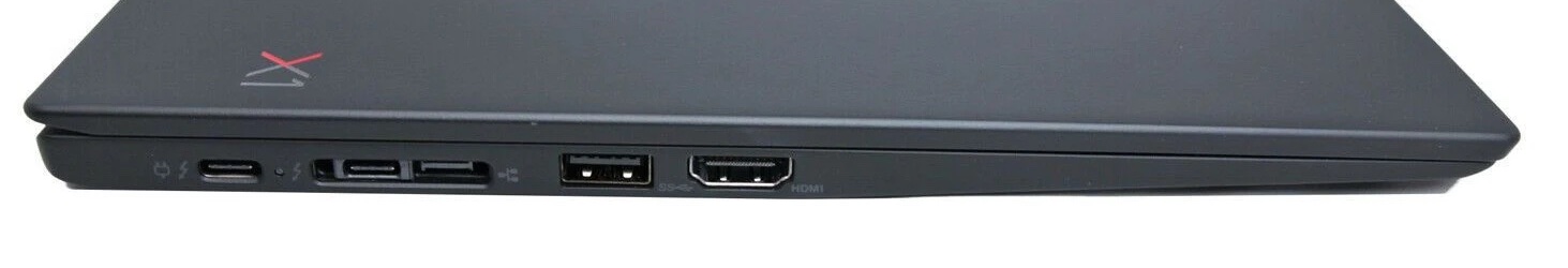

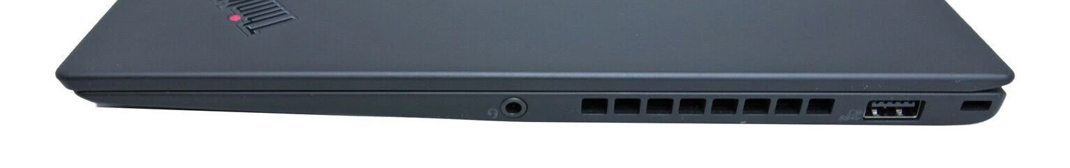

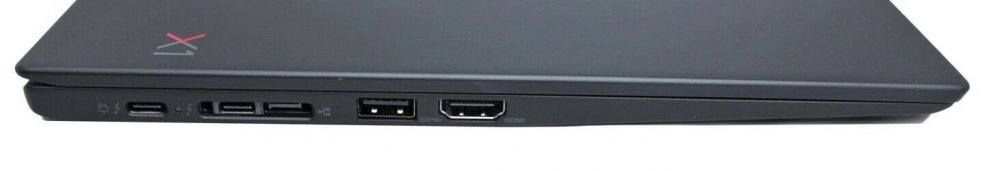

kushwavez Posted January 13, 2021 Share Posted January 13, 2021 (edited) (A really good & compatible notebook for hackintoshing) Lenovo ThinkPad X1 Carbon 6th Gen (20KH and 20KG) (Working from High Sierra 10.13.6 to Ventura 13 - Windows 11) Left side (2x USB-C TB3, Ethernet dongle, USB-A 3.0, HDMI) Right side (combo jack, USB-A 3.0, kensington lock) Specifications: BIOS: v1.50 CPU: i5-8250U (Kaby Lake-R, 1.6 GHz up to 3.4 GHz, Quad-Core) and i7-8650U (Kaby Lake-R, 2.1 GHz up to 4.2 GHz, Quad-Core) GPU: Intel UHD 620 Display: FHD 1920x1080 (non-touch IPS) 14” 300 nit, WQHD 2560x1440 (non-touch) 14" 300 nit RAM: 16 GB (2x8) DDR3 2133MHz Audio: ALC3286 SSD: Original Samsung PM SSD replaced to KINGSTON SA2000M81000G (1 TB NVMe) (~2400 MB/s read, ~2000 MB/s write) WiFi & Bluetooth: Intel AC-8265 M.2 (replaced to BCM94360CS2 with NGFF M.2 adapter) Fingerprint reader HD webcam Multigesture SMBus/RMI Synaptics touchpad with 3 buttons 2 level Backlight keyboard 57 Whr Battery Connectors: 2x USB-Type C - Thunderbolt 3 2x USB 3.1 Gen 1 (1x USB charging) 1x Ethernet dongle (Intel I219V4 PCI-e) 1x HDMI 3.5mm combo-jack audio BIOS settings: Secure Boot: Disabled UEFI: Enabled CSM: Disabled Virtualization, VT-d: Enabled Hyper-Threading: Enabled Anti-Theft: Disabled Intel SGX: Software Controlled Disable Fingerprint at I/O Thunderbolt device: Enabled For Thunderbolt 3 hot-plug (higher power consumption): Thunderbolt BIOS Assist Mode: Disabled Security Level: No security Support in Pre Boot Environment: Disabled For Thunderbolt 3 without hot-plug (lower power consumption but need to plug your device before boot) Thunderbolt BIOS Assist Mode: Enabled What is working: AirDrop, Handoff (only with Broadcom cards) iCloud, Messages, App Store, FaceTime, etc. Instant WiFi Hotspot with iPhone (only with original Apple Broadcom cards, such as BCM94360CS2) Intel UHD 620 (QE/CI, hardware decode/encode, VP9, HDMI) Sound (incl. combo-jack, HDMI out) Thunderbolt 3 (with hot-plug support) USB ports Ethernet dongle TrackPad, TrackPoint and Keyboard (incl. native multi-gestures, FN keys) FileVault Battery (~0.5 W when TB3 hot-plug is disabled, ~2W when enabled) Sleep Power Management Webcam SD card reader External Monitor connecting with USB-C External Monitor using HDMI What isn’t working: Fingerprint reader (disabled in BIOS) Hibernation I think it's fixable, but just not worth the trouble for me. Just use normal sleep (hibernationmode=3) like on real MacBooks Original Samsung PM NVMe SSD Causing kernel panics. Not fixable, replace your drive with an aftermarket one. I used KINGSTON A2000, WDC PC SN720 but feel free to choose anything other than Samsung Here is a list about what to avoid: https://dortania.github.io/Anti-Hackintosh-Buyers-Guide/Storage.html Issues: Although we have OpenIntelWireless for Intel WiFi, it’s quite unusable in my case (v1.1.0). It’s really slow (4 MB/s) and disconnecting quite often, the ping is also really high sometimes (spiking up to ~3000ms when pinging google.com). Sleep also breaks the connection. For reconnecting I have to reboot the whole system. Bluetooth quality is also really bad unfortunately, also disconnecting quite often. I suggest everyone to just get a compatible original Apple BCM94360CS2 with an adapter for OOB support, excellent speed, Instant Hotspot, AirDrop & Handoff, Universal Control support and for best Bluetooth quality (you can buy these cards from ebay, Aliexpress or Amazon) With BCM94360NG I have a strange issue where the speed/rate is capped at 434 mbit/s ~30 MB/s and can only reach 866 mbit/s ~60 MB/s if I RESTART directly from Windows. Unfortunately isn't fixable, so if you really need high speed just go for the BCM94360CS2 instead, or BCM94352Z (with AirportBrcmFixup.kext) HDMI isn't working if you start the system with plugged in, disconnect before start and reconnect it after macOS is up and running HDMI breaks after sleep/wake, need to re-plug Audio sometimes just goes blank at random, combo-jack also doesn't recognise the combo-jack sometimes (garbled sound output): A sleep/wake solves the problem most of the time, issue needs to be debugged and reported to the Acidanthera team Thunderbolt 3 (I only have an ADT-Link R43SG-TB3 device with RX 470, so maybe other devices are good, but I don't have more TB3 devices to test with): If you disconnect the eGPU the notebook will freeze (high CPU usage), you need to restart After some testing on other machines as well I think this is related to the ADT-Link itself as macOS can't detect it as a normal eGPU like the Razer Core X, but a 3rd party generic PCIe to TB3 adapter After sleep hot-plug is not working with the TB3 eGPU (device not detected) Workaround: Plug the TB3 in, put the notebook into sleep, wake it up. It may fail sometimes, try it again if that is the case Not tested: WWAN (no equipment) Installation: Download the bootpack zip Download the Release from GitHub -> https://github.com/kushwavez/lenovo-x1c6-clover-efi Create an installer with any method you know Mac: App Store - createinstallmedia, gibMacOS Windows: Use my guide to create an Internet Recovery for Monterey (should work with Ventura, choose the correct version) You can use gibMacOS for older versions of MacOS Copy my bootpack folder to the USB's EFI folder Boot with the Installer USB If you stuck in boot, reboot and in the Clover bootloader select "config_debug.plist" -> you'll have more informations about the freeze To disable SIP boot with "config_debug.plist" Post Installation: Generate a new Serial Number with Clover Configurator.app for yourself (open up your config.plist with CC then -> SMBIOS -> Serial Number -> Generate New) Windows 10 dual-boot (on one drive): My GUIDE to create a dual-boot with Windows 10 (or 11) on the same drive: Some pictures: macOS Ventura 13.6.6 PCI Device list Working Trackpad Spoiler Original Apple BCM94360CS2 WiFi card fitted. Be careful about it and make sure that the card does not make any contact with the NVMe drive! Useful Applications for Mac: EFI Mountain Show -> To easily mount your EFI Clover Configurator -> To easily manage your config.plist https://mackie100projects.altervista.org/download-clover-configurator/ PlistEditPro -> Advanced plist editor https://www.fatcatsoftware.com/plisteditpro/ XPlist -> Free CrossPlatform .plist editor https://github.com/ic005k/Xplist iStat Menus -> To monitoring your devices https://bjango.com/mac/istatmenus/ Boom 3D -> To significantly increase your audio quality https://www.globaldelight.com/boom/ TextMate -> a basic code editor just like Notepad++ on Windows https://macromates.com BBedit -> More advanced text editor https://www.barebones.com/products/bbedit/ Modified Wineskin to run basic Windows 32-bit or 64-bit (or DX9 games) applications on Catalina (and higher)-> https://www.reddit.com/r/MacOS/comments/fobx5t/i_didnt_want_to_boot_windows_every_time_when_i/ CrossOver 21 -> Run DirectX 11 applications on Catalina=< https://www.codeweavers.com/crossover/ MaciASL -> View/Edit your .aml, .dsl files https://bitbucket.org/RehabMan/os-x-maciasl-patchmatic/downloads/ Xiasl ->CrossPlatform .aml/.dsl editor https://github.com/ic005k/Xiasl Hackintool -> All useful info, tools in one place https://github.com/headkaze/Hackintool IORegistryExplorer V2.1 -> To view your IO tables https://github.com/vulgo/IORegistryExplorer/releases/tag/v2.1 App Cleaner -> To delete your apps with caches https://freemacsoft.net/appcleaner/ Intel Power Gadget -> To see your frequencies https://software.intel.com/en-us/articles/intel-power-gadget Carbon Copy Cloner -> Advanced macOS drive backup utility https://bombich.com Commander One -> A Total Commander alternative for macOS https://mac.eltima.com/file-manager.html Useful Applications for Windows: Total Commander -> To easily manage EFI https://www.ghisler.com mountvol b: /s -> To mount your system drive EFI EasyUEFI -> To manage boot orders and any bootloaders with ease https://www.easyuefi.com/index.html MiniTool Partition Wizard -> To mount your USB EFI, and manage other drives https://www.minitool.com/partition-manager/ Notepad++ -> Basic code editor for all type of files https://notepad-plus-plus.org gibMacOS -> A python script for downloading/creating macOS Internet Recovery USB from Windows (working internet is needed when installing) https://github.com/corpnewt/gibMacOS XPlist -> Free CrossPlatform .plist editor https://github.com/ic005k/Xplist Xiasl ->CrossPlatform .aml/.dsl editor https://github.com/ic005k/Xiasl Credit for tylernguyen for his hard work for creating SSDTs for Thunderbolt 3, he did an excellent job Notes: You should use Thunderbolt BIOS Assist mode to lower your power consumption, but you'll lose hot-plug If you're using KINGSTON NVMe SSD like me, you should not use NVMeFix.kext. It's causing stutters and kernel panics. Only use it if necessary Changelog: 2024.05.03: Updated Clover to v5158, removed AppleBacklightSmooter.kext (Does not work anymore), added SMCLightSensor.kext, updated to Ventura 13.6.6, updated Kexts 2022.01.06: Updated Clover to v5143, updated SMBIOS with FirmwareFeaturesMask, updated kexts, updated to Monterey 12.1 2021.06.03: Updated Clover to v5136, deleted SSDT-HPET no need for that, updated some of the kexts, cleaned up config.plist 2021.04.19: Added BCM94360CS2 to the list, working OOB with ~75 MB/s (in my case), updated IntelMausi.kext -> Fixes an issue where at saturation (~125 MB/s) the Ethernet started stuttering 2021.04.12: Updated Clover to v5133: Fixes an issue where if FileVault is enabled, macOS OTA Installer entry cannot be seen 2021.03.09: Fixed TB3 Hot-Plug, deleted AirPortBrcmFixup.kext (not needed with BCM94360NG), Updated VoodooRMI.kext & VoodooPS2Controller.kext, updated Clover to v5131 2021.02.09: EFI moved to GitHub: it's easier to push minor(and major) updates 2021.01.27: Updated to Clover v5129 -> Recovery is now working 2021.01.24: Downgraded WhateverGreen from v1.4.6 to v1.4.5. v1.4.6 caused kernel panic with Installer USB's (failed to route the function IsTypeCOnlySystem). 2021.01.21: Fixed TouchPad, TrackPoint: Fixed not loading VoodooRMI & VoodooPS2, removed BrcmPatchRAM, not needed for BCM94360NG, updated bootpack 2021.01.13: Initial upload Edited May 3, 2024 by kushwavez updated to Ventura 4 1 Link to comment https://www.insanelymac.com/forum/topic/346368-guide-lenovo-thinkpad-x1-carbon-6th-gen-from-high-sierra-to-ventura-13-windows-11/ Share on other sites More sharing options...

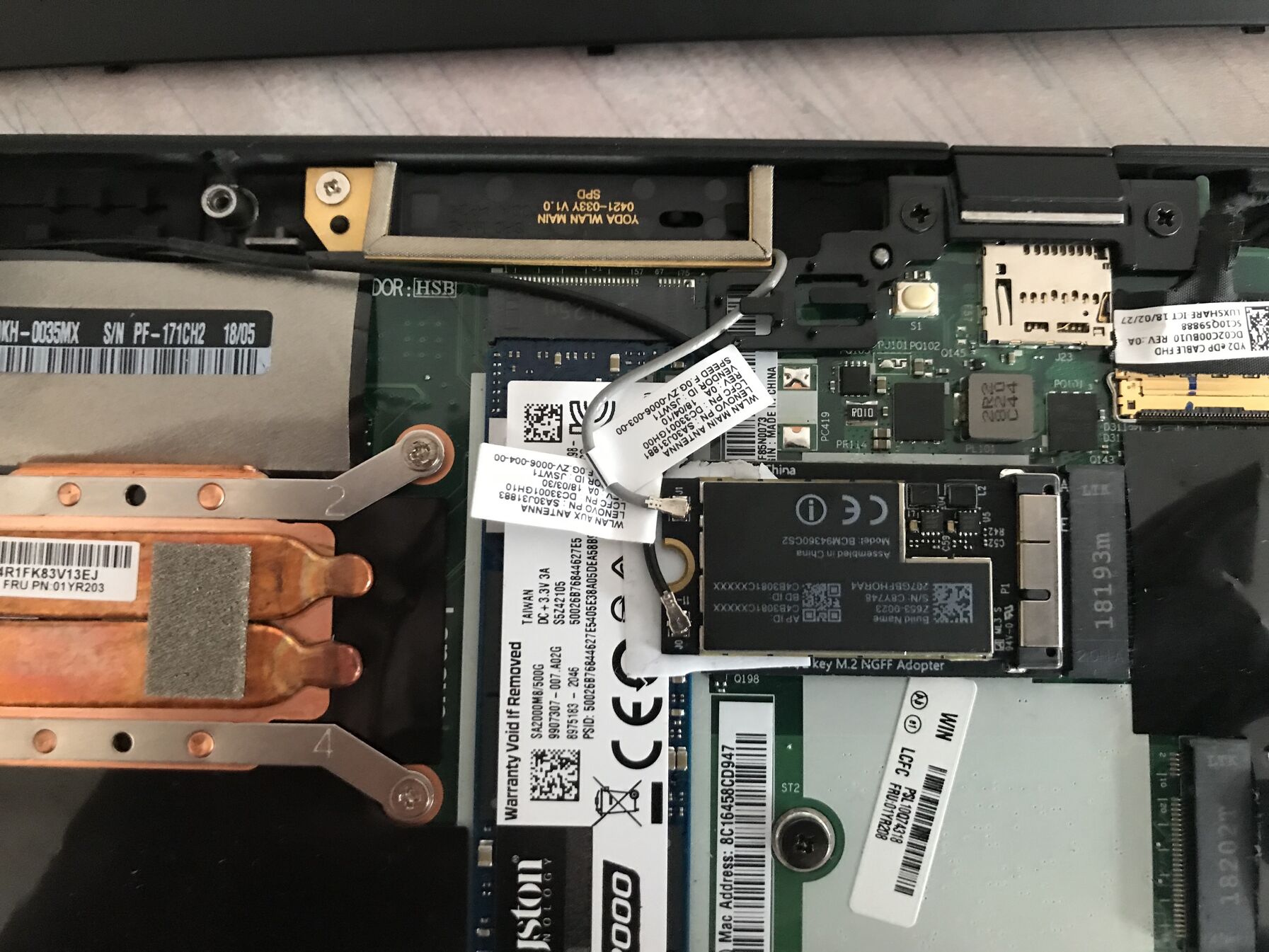

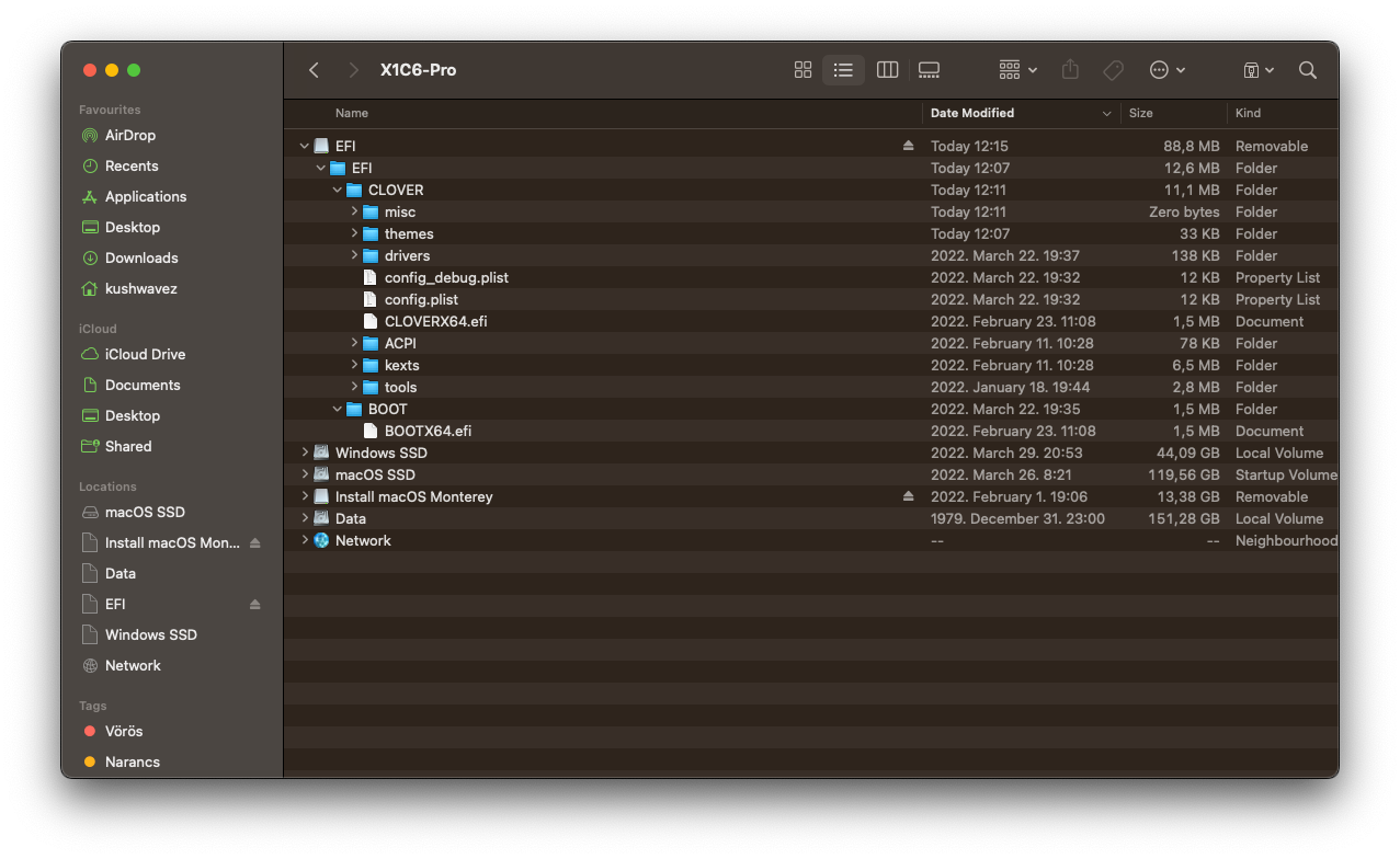

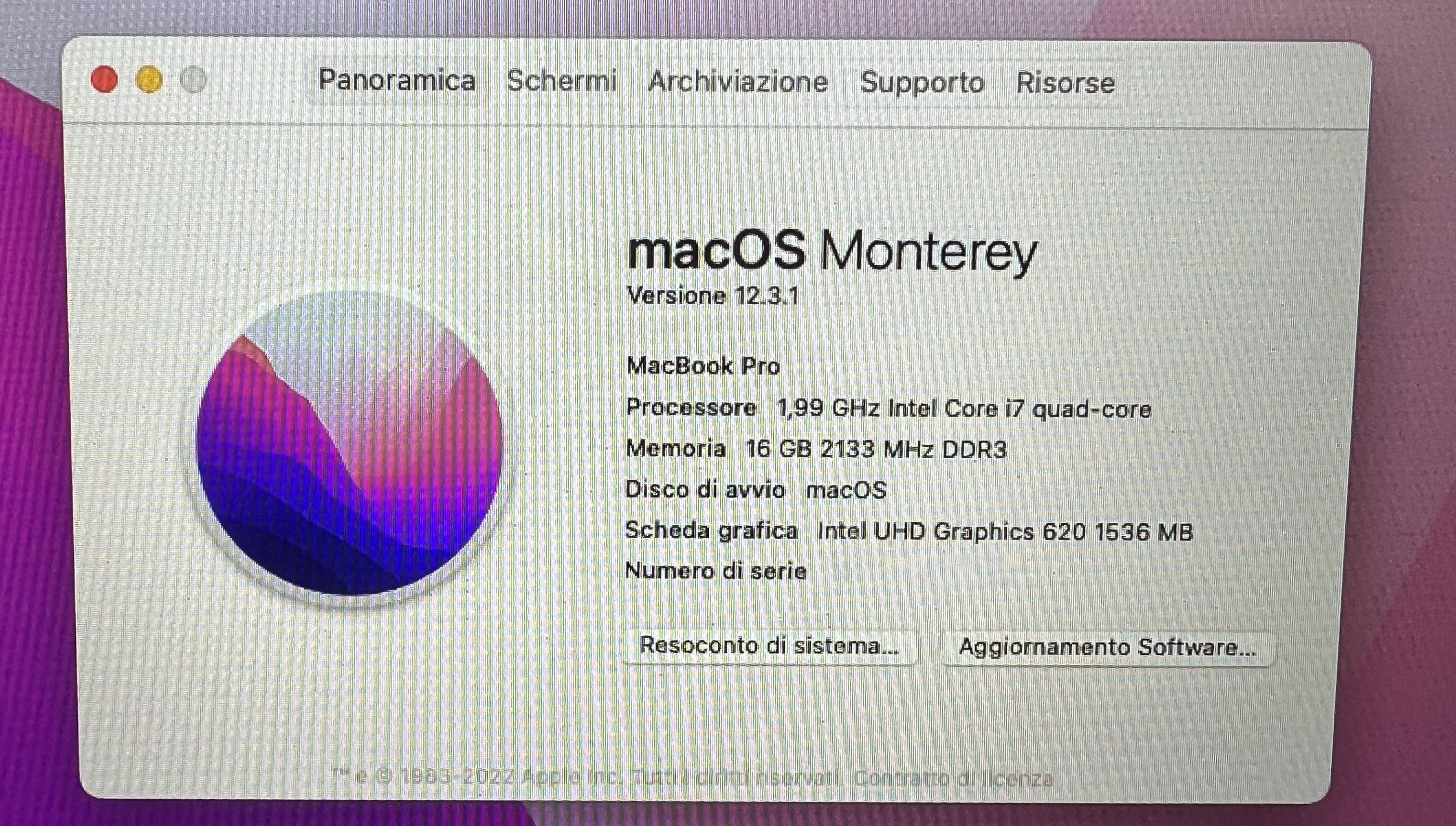

espanico Posted April 2, 2022 Share Posted April 2, 2022 Hello, the pc finally arrived, which is very nice, we hope to be able to install macos. I created a monterey usb via a mac min, then I installed clover and finally I replaced the files in the efi of the usb with those of your repo. I set the bios as per your advice, but when I try to start the usb nothing happens I click on the USB bot but after a few seconds the same screen reappears. Can you give some advice? Link to comment https://www.insanelymac.com/forum/topic/346368-guide-lenovo-thinkpad-x1-carbon-6th-gen-from-high-sierra-to-ventura-13-windows-11/#findComment-2779285 Share on other sites More sharing options...
kushwavez Posted April 2, 2022 Author Share Posted April 2, 2022 Vierfy if you have UEFI only (without Legacy CSM) in BIOS settings, also verify the structure of the EFI directory, it should look like this: EFI -> EFI-> CLOVER and BOOT Link to comment https://www.insanelymac.com/forum/topic/346368-guide-lenovo-thinkpad-x1-carbon-6th-gen-from-high-sierra-to-ventura-13-windows-11/#findComment-2779286 Share on other sites More sharing options...

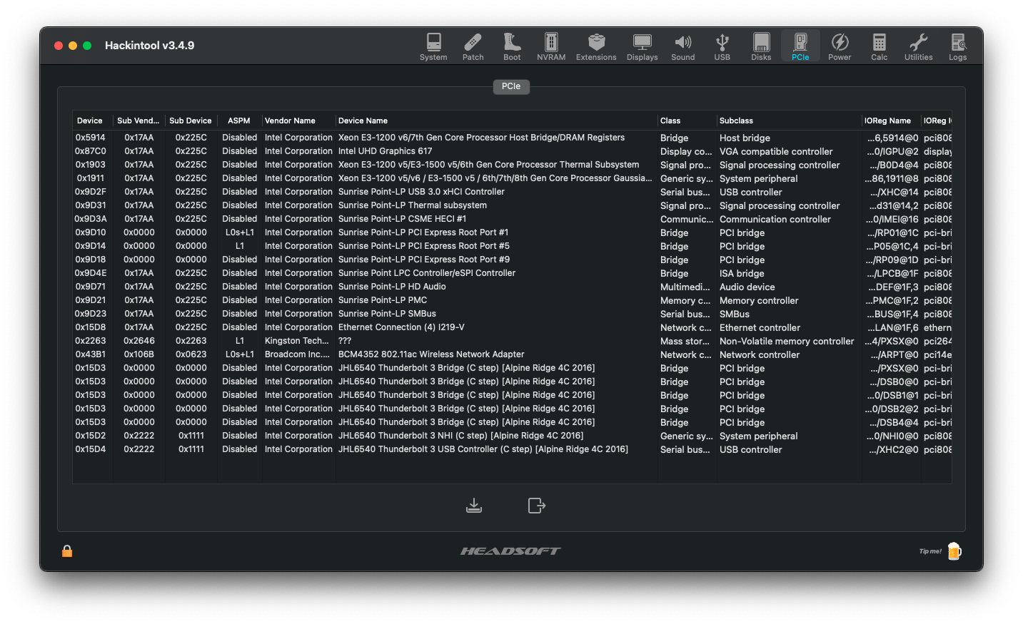

espanico Posted April 2, 2022 Share Posted April 2, 2022 (edited) Thank you! in fact the EFI folder was missing I had put everything in the root of the partition. I launched the installation and to my surprise it was installed at the first try, the wifi does not work naturally (8265NGW) I have to take the BCM94360CS2. As for the ssd I used the one already present, but I saw that it is not a samsung but a Union Memory model, I do not know how to continue with this or replace it ... How can I test that everything is working as it should? Spoiler Edited April 2, 2022 by espanico Link to comment https://www.insanelymac.com/forum/topic/346368-guide-lenovo-thinkpad-x1-carbon-6th-gen-from-high-sierra-to-ventura-13-windows-11/#findComment-2779292 Share on other sites More sharing options...
kushwavez Posted April 2, 2022 Author Share Posted April 2, 2022 (edited) Great to hear! For intel, as a temporary solution you can try the AirportItlwm.kext. For me it didn't work great and had so much trouble (disconnects, bluetooth didn't work, was slow), but it was updated since then. Try it https://github.com/OpenIntelWireless/itlwm, but I really think the best is just change.. Especially if you have other Apple devices and would like to use the Apple specific features for real Mac experience. As for the SSD, well if you don't experience any kernel panics, slowness or freezes then it's good and you don't have to replace it. As for the test, well just use it... Try USB ports, etc, if you have Thunderbolt devices test them too. That is one thing I cannot really test as I just only have one Thunderbolt device (an eGPU) so I cannot make any assumptions. But just use the notebook, if there are any problems then it'll come up sooner or later. Also don't forget to generate a new SMBIOS with Clover Configurator before logging in to iCloud Edited April 2, 2022 by kushwavez Link to comment https://www.insanelymac.com/forum/topic/346368-guide-lenovo-thinkpad-x1-carbon-6th-gen-from-high-sierra-to-ventura-13-windows-11/#findComment-2779293 Share on other sites More sharing options...

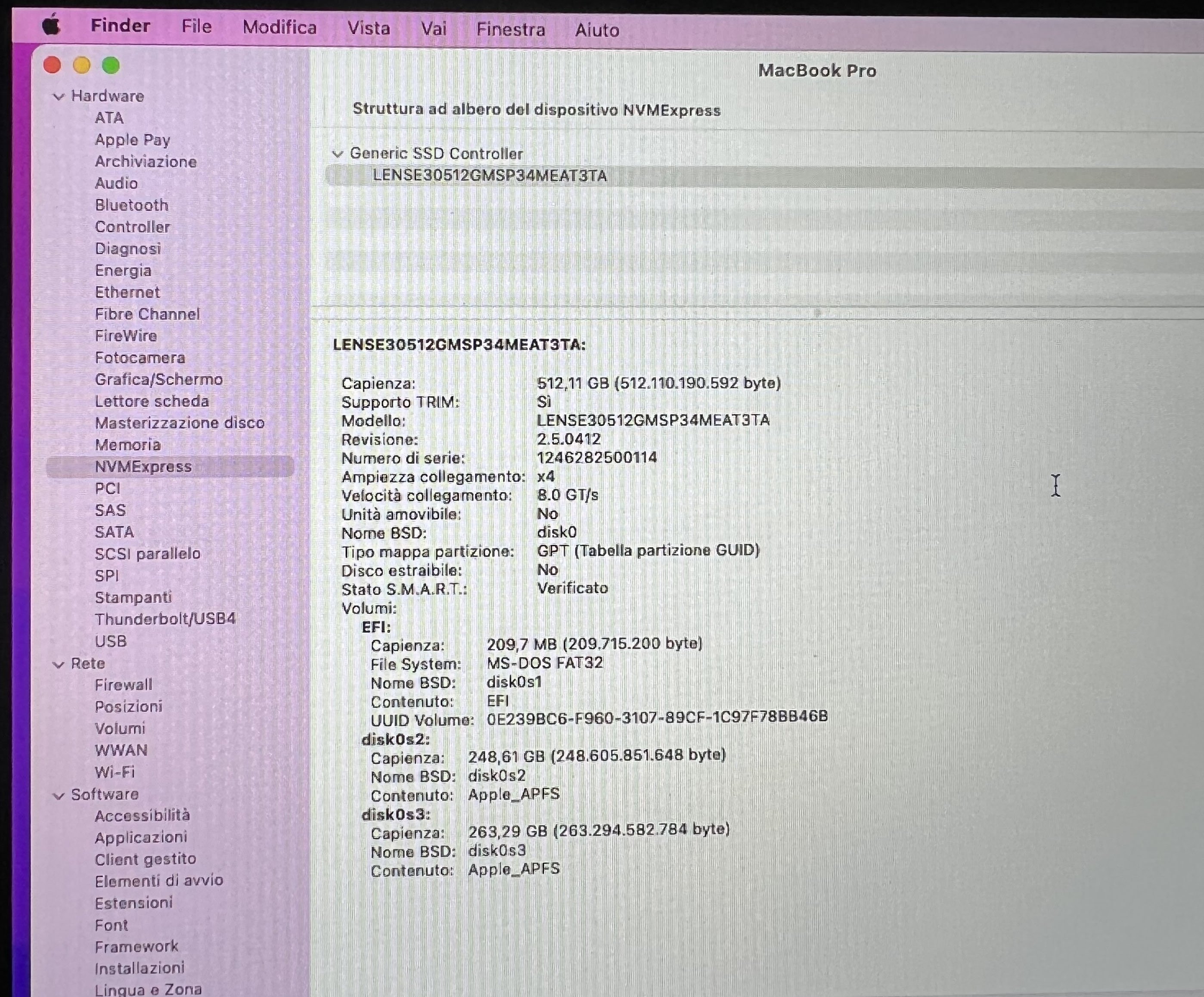

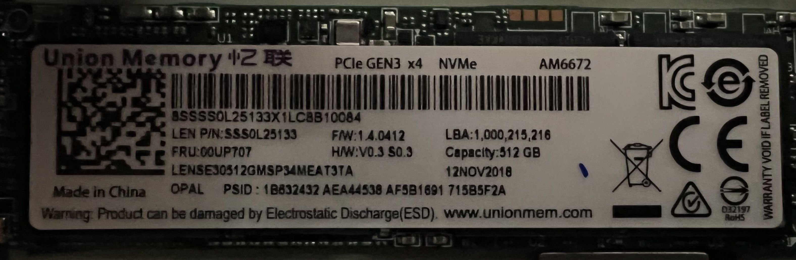

kushwavez Posted August 21, 2022 Author Share Posted August 21, 2022 I found SK-Hynix and Western Digital ones, they could be good. Unfortunately they're max 512 GB. There is an original Lenovo one that is 1 TB, but that is very expensive so I won't buy it. These are the two that are not 'no-name' branded WD SN530 512GB M.2 2242 SSD (PCIe, SDBPMPZ-512G, 2242, 2400MB/1750MB) SK-Hynix BC511 512GB M.2 2242 SSD (PCIe, HFM512GDHTNI, 2242, 2300MB/1000MB) In my country they're about $50, so not a bad deal. I have found several noname brands too on aliexpress/amazon but... I don't trust them and I do not recommend them to anyone. Link to comment https://www.insanelymac.com/forum/topic/346368-guide-lenovo-thinkpad-x1-carbon-6th-gen-from-high-sierra-to-ventura-13-windows-11/#findComment-2791790 Share on other sites More sharing options...

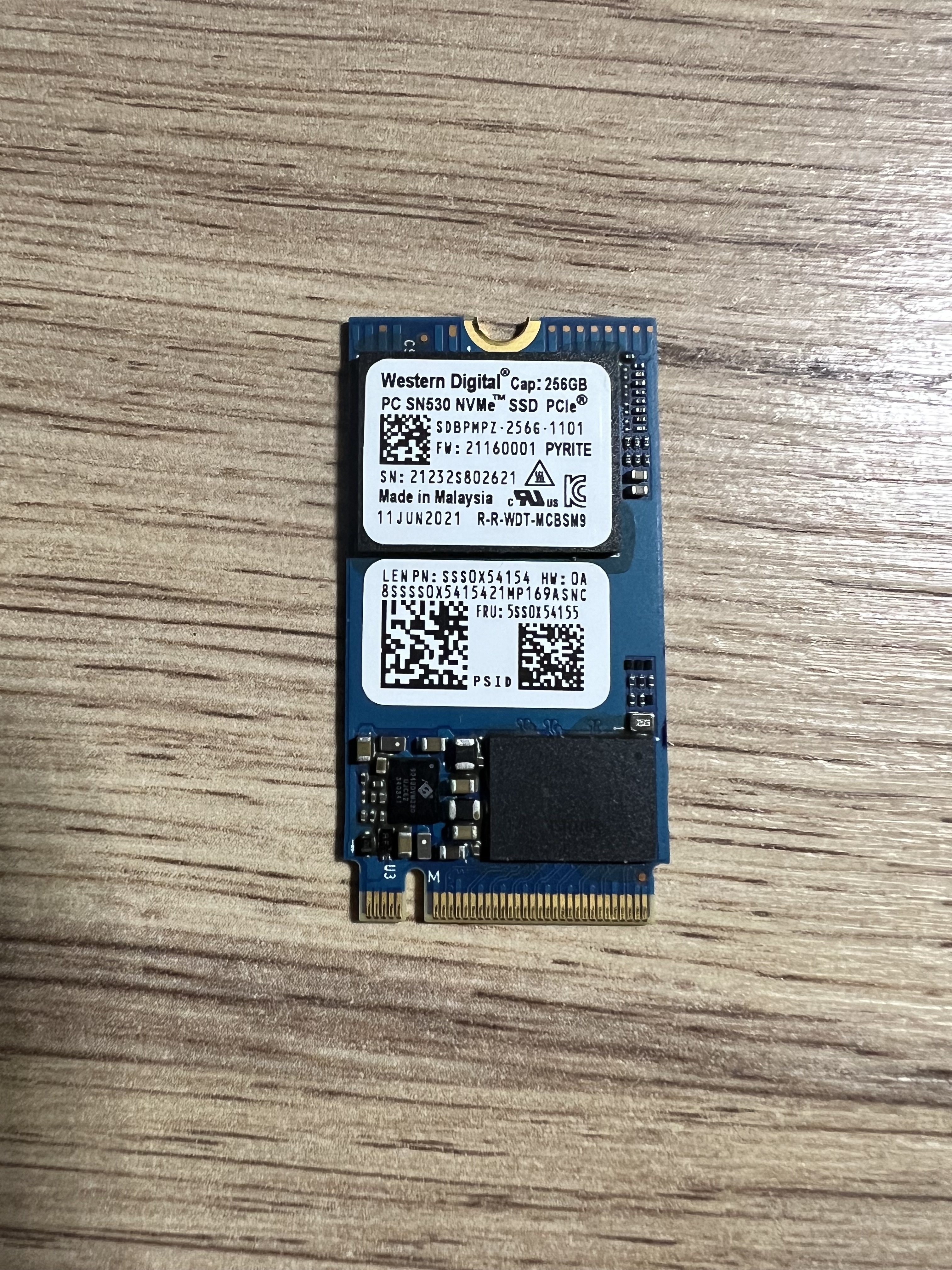

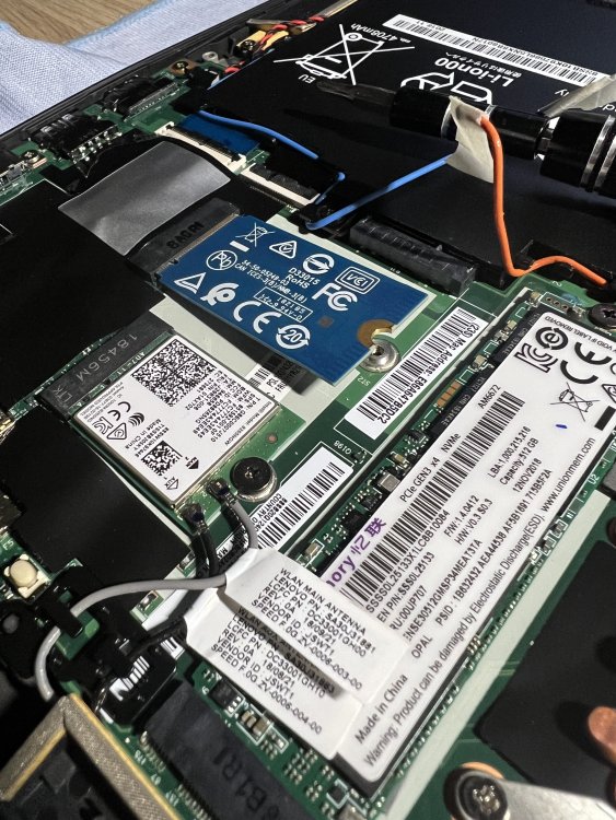

espanico Posted September 29, 2022 Share Posted September 29, 2022 (edited) Hi, I finally bought an M.2 2242 ssd a WD 256 GB which I am willing to buy for about 20 $ But I encountered 2 problems, the first that to mount it in the right position must be put backwards and therefore remains raised (I attach photos), and the second problem is not recognized by windows or macOS. Furthermore, if I start the PC with the SSD connected, the wifi does not work. Has anyone tried it and did it work? do i have to activate something from bios? Spoiler Spoiler Edited September 29, 2022 by espanico Link to comment https://www.insanelymac.com/forum/topic/346368-guide-lenovo-thinkpad-x1-carbon-6th-gen-from-high-sierra-to-ventura-13-windows-11/#findComment-2794200 Share on other sites More sharing options...
kushwavez Posted September 29, 2022 Author Share Posted September 29, 2022 From the pics it looks like it's not properly connected. So because of the chip you can't screw it down? what if you screw it just a bit, until you feel it won't go lower? Obviously be very careful about it, if you feel it won't go down then don't force it. Another thing is that maybe check the BIOS to see if it's recognised or not, for example it Boot selection menu. Unfortunately I still could not get an SSD to try, they're just too inexpensive in my country, but I am looking for it and maybe can find a good deal Link to comment https://www.insanelymac.com/forum/topic/346368-guide-lenovo-thinkpad-x1-carbon-6th-gen-from-high-sierra-to-ventura-13-windows-11/#findComment-2794205 Share on other sites More sharing options...
espanico Posted October 2, 2022 Share Posted October 2, 2022 Hi, in the end I got a new ssd of the wd to replace with the original one that gives problems. I will do as I always did the two partitions. After I wrote here a user privately wrote me how technically this is not feasible, to use an SSd in the WWAN slot could damage the entire laptop, so to avoid problems I forget this path. Now I still have another question, should I install macOS Monterey or wait a little longer and wait for macOS Ventura (always if compatible)? Link to comment https://www.insanelymac.com/forum/topic/346368-guide-lenovo-thinkpad-x1-carbon-6th-gen-from-high-sierra-to-ventura-13-windows-11/#findComment-2794343 Share on other sites More sharing options...
espanico Posted October 8, 2022 Share Posted October 8, 2022 Hi, I bought a new WD ssd I recreated the usb with your EFI folder. The installation all ok, in the post installation I copied the 'EFI' folder in the EFI I restarted and everything started, but the startup is very slow about 1 minute, it loads half the bar in the black apple screen then it stops and then it arrives to the login screen. Maybe I am doing something wrong or do I have to make some changes for the new SSD? Thank you Link to comment https://www.insanelymac.com/forum/topic/346368-guide-lenovo-thinkpad-x1-carbon-6th-gen-from-high-sierra-to-ventura-13-windows-11/#findComment-2794687 Share on other sites More sharing options...

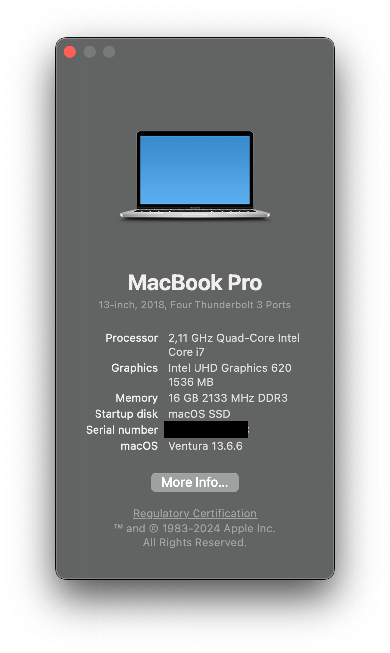

espanico Posted January 23, 2024 Share Posted January 23, 2024 Hi were you able to install sonoma ? Link to comment https://www.insanelymac.com/forum/topic/346368-guide-lenovo-thinkpad-x1-carbon-6th-gen-from-high-sierra-to-ventura-13-windows-11/#findComment-2815812 Share on other sites More sharing options...
