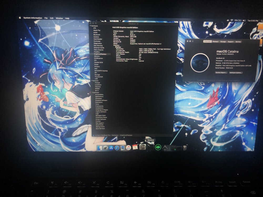

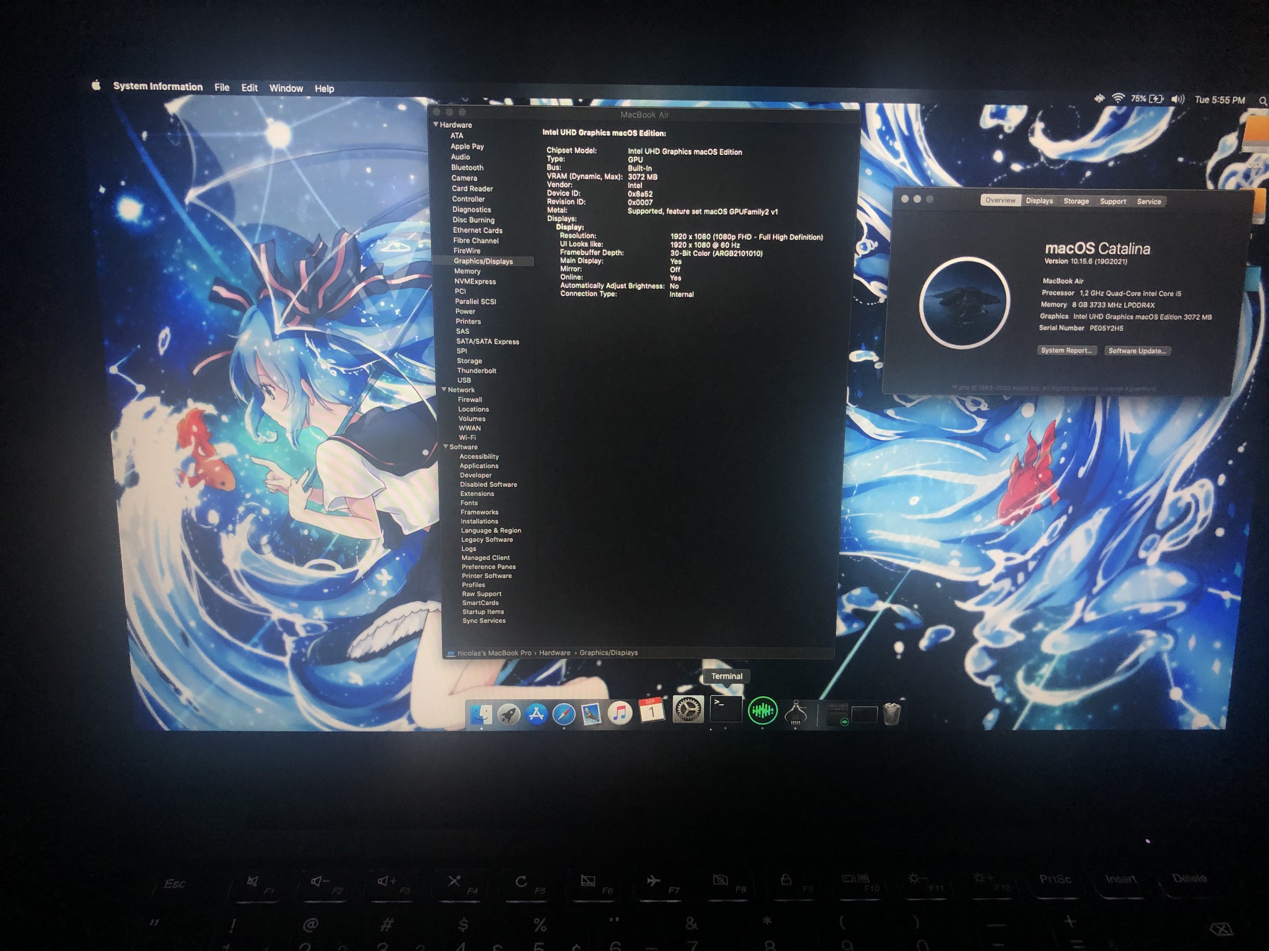

LireMei Posted September 1, 2020 Share Posted September 1, 2020 (edited) Success!! I managed to get graphics acceleration working on my Lenovo YOGA S740 14inch with an i5 1035G1 by utilising snippets of @Ab2774 's EFI as well as resources found in: https://github.com/frozenzero123/YOGA-S740 I made a new EFI which you all can download here: https://files.catbox.moe/vodnnf.zip PS: I'm running macOS from my portable SSD drive so if you get boot problems when trying to boot from the YOGA's m.2 drive don't quote me, I will install it there later. PS: the login screen has broken graphics but it does not matter since everything works fine once you finish typing your password. I just need to properly setup power management... Thanks everyone in this thread for the patience and help! I'll be adding this to my Hackintosh EFI archive. Edited September 1, 2020 by LireMei Link to comment https://www.insanelymac.com/forum/topic/344939-general-discussion-intel-ice-lake-graphics-on-macos-catalina/page/2/#findComment-2736101 Share on other sites More sharing options...

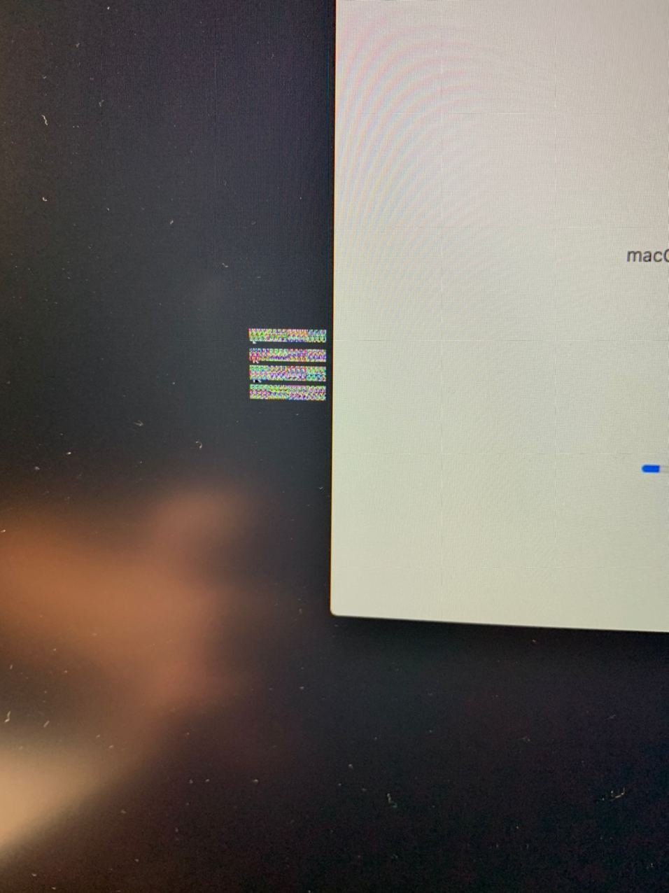

b0ltun Posted September 5, 2020 Share Posted September 5, 2020 hello i got hasee kingbook x57s1 (i7 with G7 graphics). i got installed catalina 10.15.6 with the help of latest weg + took some files from that EFI folder - https://github.com/Ardentwheel/OpenCore-Hasee-X57S1 (thx btw) my bios is pretty poor, so i have no options to changed DVMT and so on, so i used boot-args to boot my hackintosh - -igfxcdc and -igfxdvmt. Without that boot-args i can't boot hackintosh. So it's okay, but i got straaange glitch of cursor and i saw same glitch on systems here, but i didn't find the way to fix it. Has anybody fixed that glitch? Link to comment https://www.insanelymac.com/forum/topic/344939-general-discussion-intel-ice-lake-graphics-on-macos-catalina/page/2/#findComment-2736425 Share on other sites More sharing options...
LireMei Posted September 5, 2020 Share Posted September 5, 2020 This is due to the memory you set on the device properties tab. Download the EFI I had attached earlier in this post and try using the values I used. Link to comment https://www.insanelymac.com/forum/topic/344939-general-discussion-intel-ice-lake-graphics-on-macos-catalina/page/2/#findComment-2736449 Share on other sites More sharing options...
b0ltun Posted September 6, 2020 Share Posted September 6, 2020 finally i got fix for that glitch. i did mod for my bios (replaced "main" page with "chipset" page) and set DVMT to 160 (it was on 60 before). now glitch is gone, cursor is okay. Link to comment https://www.insanelymac.com/forum/topic/344939-general-discussion-intel-ice-lake-graphics-on-macos-catalina/page/2/#findComment-2736499 Share on other sites More sharing options...
