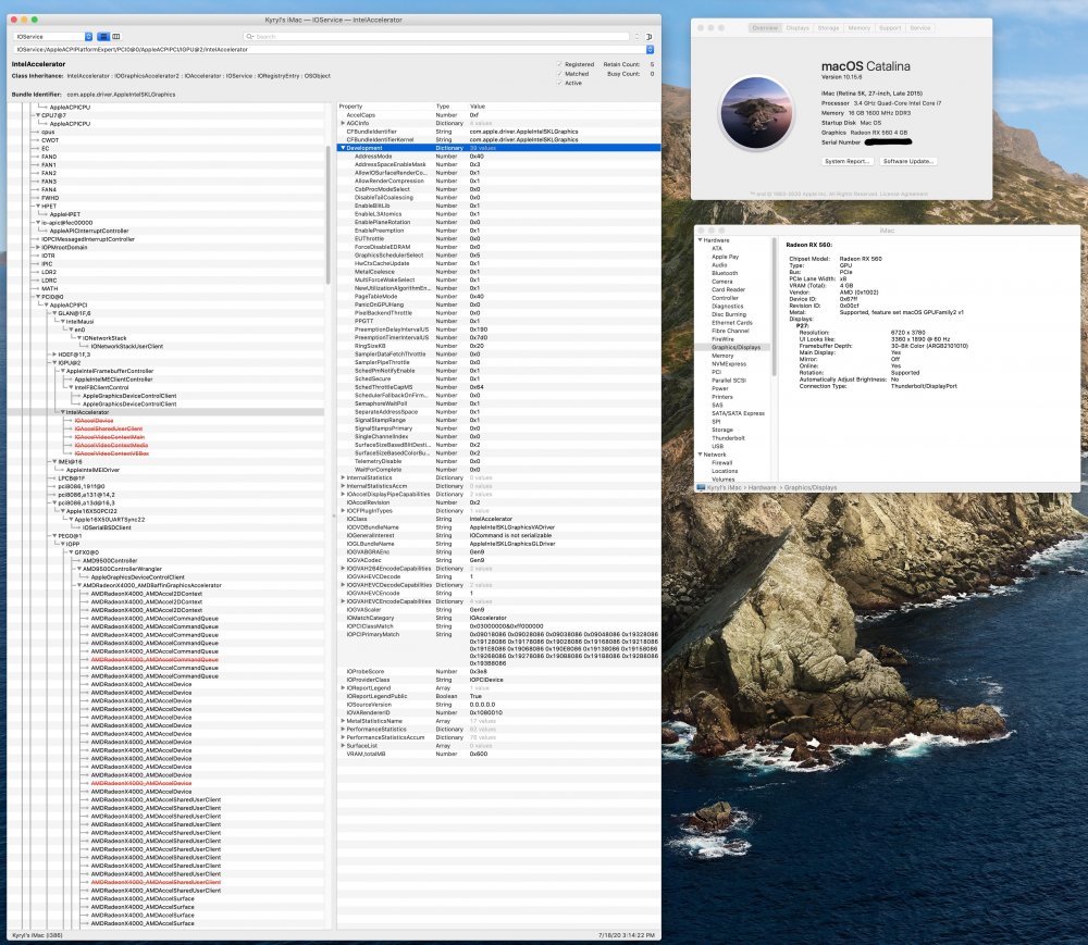

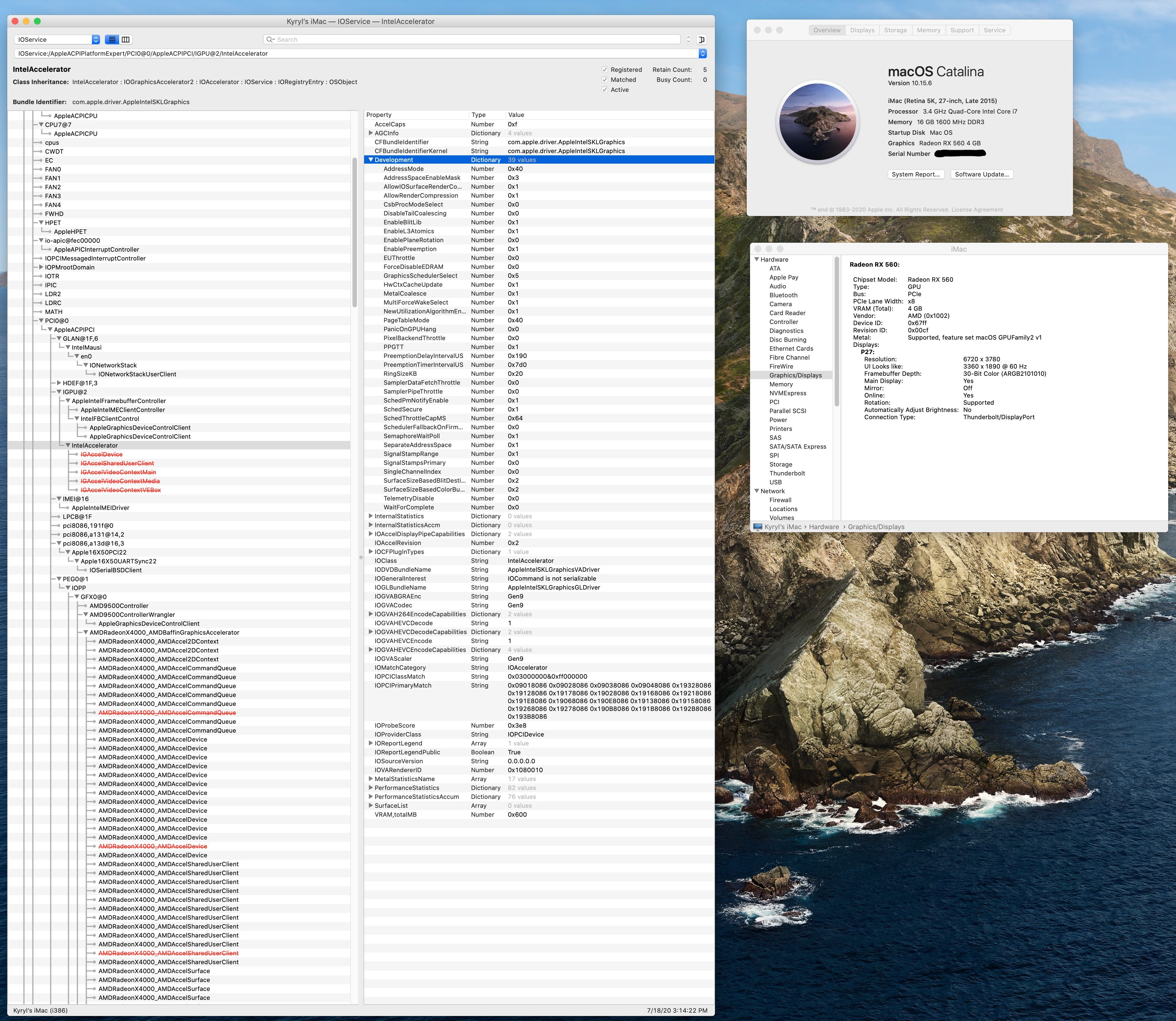

kkdart Posted July 18, 2020 Share Posted July 18, 2020 I would like to learn what patches I would need to do in order for the HD 530 to be properly detected by Mac OS I have dell Optiplex 5040 with Catalina 10.15.6 installed. i7 6700 (Intel HD 530) 16 GB DDR3L ram NVME SSD AMD RX 560 Boot & Kext settings: Open Core 0.6.0 Plist Attached as well. LILU WEG I have set 01001219 for iGPU to be in headless mode as well, to no avail. BIOS settings DVMT cannot be set in BIOS (shouldn't matter as only need Intel Quick Sync to work for Hardware Acceleration) Intel Multi Display is enabled Initial display is set Intel Integrated config.plist Link to comment https://www.insanelymac.com/forum/topic/344570-intel-hd-530-not-being-detected-in-mac-os/ Share on other sites More sharing options...

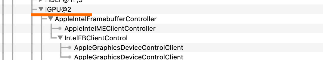

Cyberdevs Posted July 18, 2020 Share Posted July 18, 2020 @kkdart Set Primary GPU to IGFX in BIOS/UEFI and look for the iGPU here to see if it's loaded, that's the only way I could get it to show in System Report Spoiler Link to comment https://www.insanelymac.com/forum/topic/344570-intel-hd-530-not-being-detected-in-mac-os/#findComment-2730911 Share on other sites More sharing options...
kkdart Posted July 18, 2020 Author Share Posted July 18, 2020 Yep did that but still not showing up. A workaround for getting hardware acceleration with an AMD GPU is to use this boot args for WEG: shikigva=40 + shiki-id=Mac-7BA5B2D9E42DDD94 Link to comment https://www.insanelymac.com/forum/topic/344570-intel-hd-530-not-being-detected-in-mac-os/#findComment-2730917 Share on other sites More sharing options...
