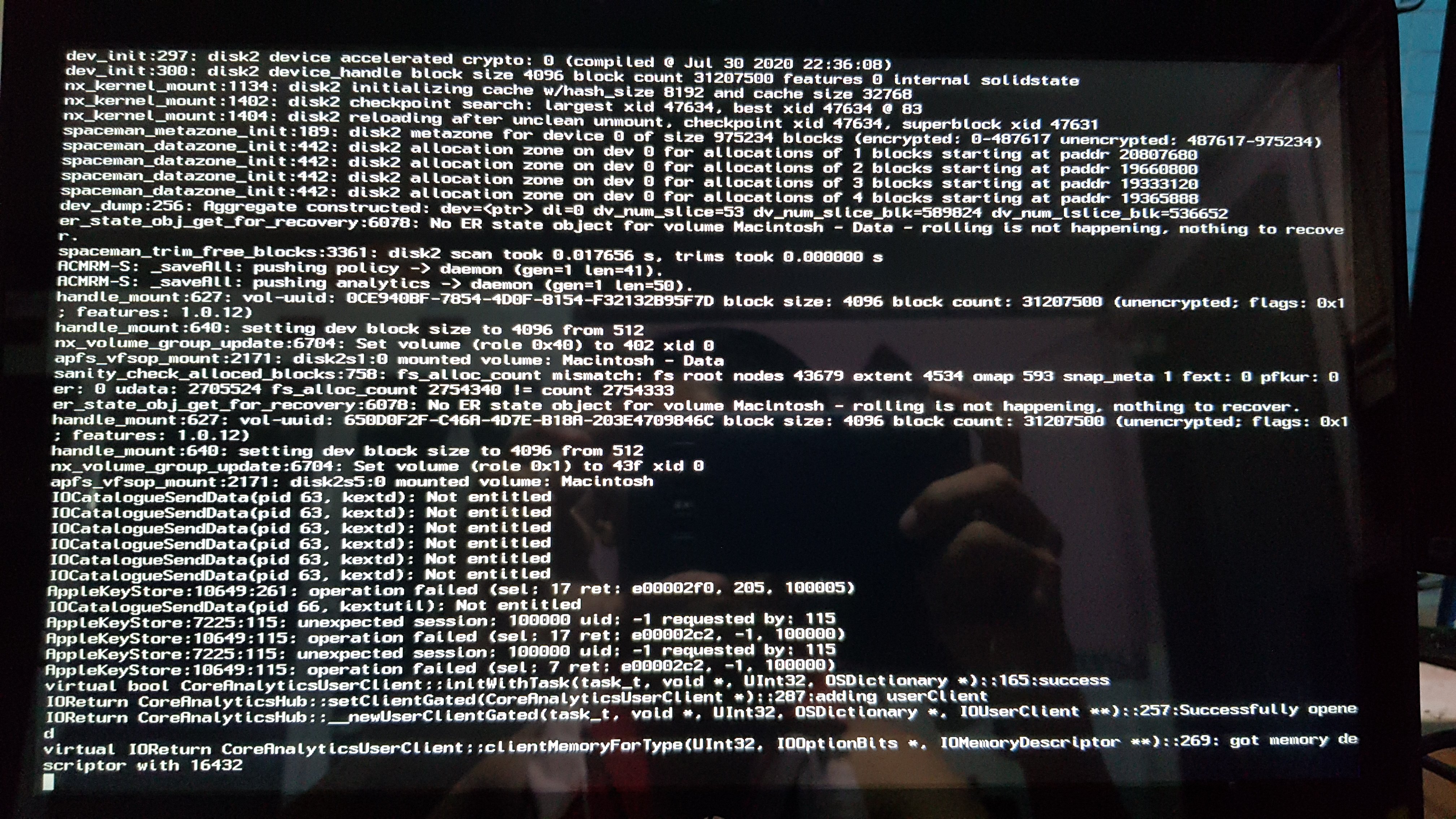

Jake Lo Posted August 17, 2020 Share Posted August 17, 2020 I think my HP 840 G2 is cursed. I tried installing Catalina with OC 5.9, 6.0, and 6.1. All goes well until the final reboot, when I select the newly installed drive from OC Picker, it'll boot to the recovery partition. I thought maybe the 2 partition got reversed? So I booted the recovery partition but it also boots to the the recovery partition. I had also tried using @Axon_80 and @Epimenide's EFI, both results are the same as mine. So I decided to try their files on Big Sur Beta4, both rebooted after being selected without any error whatsoever. Really strange. So going back to my Catalina install, I was able to create a Clover boot disk and complete the installation where OC had left off. Everything works great with Clover so far. Sleep / wake with closing and opening lid, all USB ports, SD Card reader, webcam, even multitouch gestures. Spoiler I hope someone here can help me with OpenCore for 840 G2. What version of BIOS are you using and what configuration you have set? @Axon_80, can you post your OC 6.1 version? On the other hand, I have an HP 840 G3 working perfectly fine with Big Sure on OC 6.0 also with multitouch gestures. Link to comment Share on other sites More sharing options...
Axon_80 Posted August 18, 2020 Share Posted August 18, 2020 (edited) 7 hours ago, Jake Lo said: I think my HP 840 G2 is cursed. I tried installing Catalina with OC 5.9, 6.0, and 6.1. All goes well until the final reboot, when I select the newly installed drive from OC Picker, it'll boot to the recovery partition. I thought maybe the 2 partition got reversed? So I booted the recovery partition but it also boots to the the recovery partition. I had also tried using @Axon_80 and @Epimenide's EFI, both results are the same as mine. So I decided to try their files on Big Sur Beta4, both rebooted after being selected without any error whatsoever. Really strange. So going back to my Catalina install, I was able to create a Clover boot disk and complete the installation where OC had left off. Everything works great with Clover so far. Sleep / wake with closing and opening lid, all USB ports, SD Card reader, webcam, even multitouch gestures. Reveal hidden contents I hope someone here can help me with OpenCore for 840 G2. What version of BIOS are you using and what configuration you have set? @Axon_80, can you post your OC 6.1 version? On the other hand, I have an HP 840 G3 working perfectly fine with Big Sure on OC 6.0 also with multitouch gestures. I think oc 0.6.1 will not help. But of course I will post it in my free time. Can you post your EFI / CLOVER with working multitouch gestures? Edited August 18, 2020 by Axon_80 Link to comment Share on other sites More sharing options...
Jake Lo Posted August 18, 2020 Share Posted August 18, 2020 Can you also post the BIOS version and settings you have set for the 840 G2? Here's my Clover files, just the important files: Config file / kexts folder and ACPI folder. HP840G2.zip Link to comment Share on other sites More sharing options...

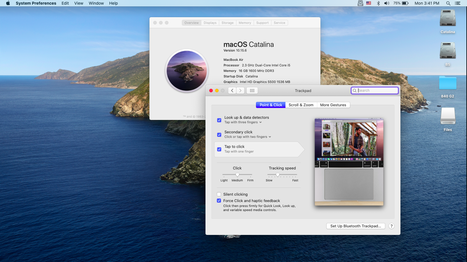

Axon_80 Posted August 18, 2020 Share Posted August 18, 2020 (edited) My BIOS ver. 01.31 02/24/2020 Bios settings: Fast Boot - off Boot Mode - UEFI Hybrid Video memory size 64MB Sata speed 6.0Gbs Deep Sleep - off Wake on lan - Disable I check, Multitouch gestures not work for Big Sur. Edited August 19, 2020 by Axon_80 Link to comment Share on other sites More sharing options...
Jake Lo Posted August 18, 2020 Share Posted August 18, 2020 Try this, replace the Config file, I add the kexts in order to the Config. Add the 3 kext to the kexts folder, this will replace your VoodooPS2Controller. You could rename the VoodooPS2 if you like before replacing. Keep an external USB mouse handy incase this doesn't work. 840G2_touchpad.zip Link to comment Share on other sites More sharing options...
Axon_80 Posted August 18, 2020 Share Posted August 18, 2020 (edited) On 8/18/2020 at 6:18 PM, Jake Lo said: Try this, replace the Config file, I add the kexts in order to the Config. Add the 3 kext to the kexts folder, this will replace your VoodooPS2Controller. You could rename the VoodooPS2 if you like before replacing. Keep an external USB mouse handy incase this doesn't work. 840G2_touchpad.zip Thank you, it works now. I don't replaced voodooP2Scontroller.kext before and that's why it didn't work for me. I am attaching EIF OC 6.1 Multitouch gestures Are you installing beta 4? Maybe try to install Bigsur beta 1 and upgrade to beta 4? Edited September 5, 2020 by Axon_80 Link to comment Share on other sites More sharing options...

acetuk Posted August 18, 2020 Share Posted August 18, 2020 5 hours ago, Axon_80 said: Thank you, it works now. I don't replaced voodooP2Scontroller.kext before and that's why it didn't work for me. I am attaching EIF OC 6.1 Multitouch gestures EFI_6.1_Multitouch gestures.zip Are you installing beta 4? Maybe try to install Bigsur beta 1 and upgrade to beta 4? Once again thanks for your EFI. I have put Catalina back on my main SSD for the moment and am using your update 0.6.1 EFI with my serial number etc. to boot. Trackpad gestures appear to be working very nicely (it's great to finally be able to zoom in and out on web pages!). I have Big Sur PB4 on the second drive in my HP840G2 and need to give that a try as well. I just need to get bluetooth working - I still can't seem to get any more than it to be recognised. It never finds my iPhone to pair to or anything else I have tried on both Catalina and Big Sur. My final challenge is to get the two display ports to work on the slim doc that I have bought. They both generate a display to dual monitors using DP-to-VGA cables but my HP840 fails to boot on the graphics settings change on boot up. I am hoping that is just because I was using those types of cables so I have bought two DP-to-DP cables which should be with me tomorrow. Fingers crossed that works as it is the final hardware tweak I want to resolve. Finally thanks for the list of bios settings you are using. I need to compare that to mine as well as the bios version itself. I'm a little cautious to adjust anything as it all appears to be running well other than bluetooth. Link to comment Share on other sites More sharing options...
Jake Lo Posted August 19, 2020 Share Posted August 19, 2020 @Axon_80 I found my issue. My system doesn't seem to like it when NvmExpressDxe.efi is added. Commenting it out or removing it from Config file resolved it. Strange. Do you have an NVMe drive in your system? Mine is just a Sata SSD. Link to comment Share on other sites More sharing options...
Axon_80 Posted August 19, 2020 Share Posted August 19, 2020 @Jake Lo Im using SSD. Link to comment Share on other sites More sharing options...
Jake Lo Posted August 19, 2020 Share Posted August 19, 2020 Then that's really odd. I have the same BIOS version and virtually the same BIOS settings. I have now change to these settings since it made no difference: Fast Boot - off Boot Mode - UEFI without CSM Video memory size 64MB Sata speed 6.0Gbs Deep Sleep - on Wake on lan - Disable Link to comment Share on other sites More sharing options...
Axon_80 Posted August 19, 2020 Share Posted August 19, 2020 (edited) @Jake Lo I have such Bios settings since the clover. I do not know if they are relevant in OC. Certainly, setting the Video memory size to more than 64MB is important and causes problems when wakeup from sleep. Edited August 19, 2020 by Axon_80 Link to comment Share on other sites More sharing options...
