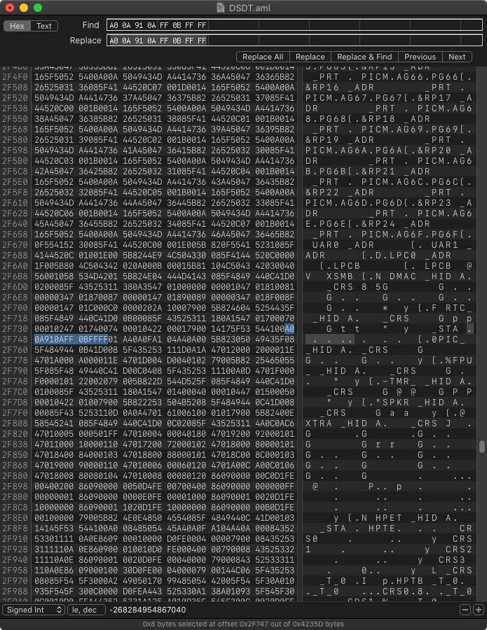

紫米 Posted January 7, 2020 Share Posted January 7, 2020 <dict> <key>ACPI</key> <dict> <key>DSDT</key> <dict> <key>Patches</key> <array> <dict> <key>Comment</key> <string>X299X-DSDT-RTC-Patch</string> <key>Find</key> <data>oAuTU1RBUwo=</data> <key>Replace</key> <data>oAqRCv8L//8=</data> </dict> </array> </dict> </dict> </dict> You can try add this DSDT patch to clover's config. Link to comment https://www.insanelymac.com/forum/topic/341694-x299x-designare-10g-build/#findComment-2703269 Share on other sites More sharing options...
Allubz Posted January 20, 2020 Share Posted January 20, 2020 (edited) Can confirm the above patch works for the X299X Designare-10G. Typical X299 BIOS settings for macOS applied. Much appreciated! Edited January 20, 2020 by Allubz Link to comment https://www.insanelymac.com/forum/topic/341694-x299x-designare-10g-build/#findComment-2705016 Share on other sites More sharing options...

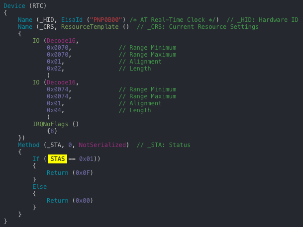

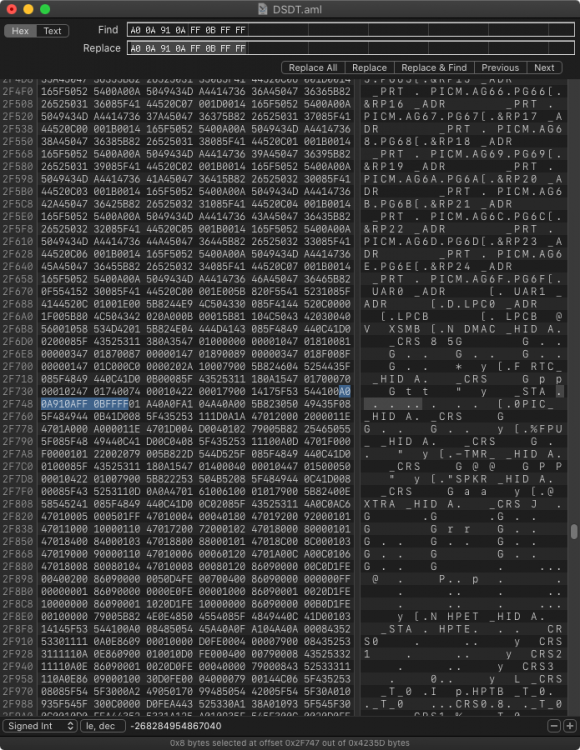

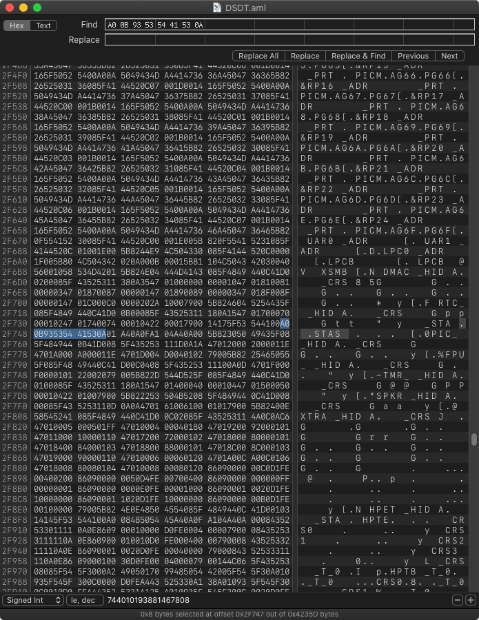

紫米 Posted January 31, 2020 Share Posted January 31, 2020 20 hours ago, dolgarrenan said: Oh yeah I know it works, I'm currently using it, I wanted to credit someone for the patch in another post. How did you managed to find out where to look to replace? In the ACPI patch post there isn't much explanation I think.. The issue is (RTC) _STA return 0x00 I Use Hex Fiend to search: and replace the code: But now has the new way to fix this issue, You can use SSDT to set STAS value. DefinitionBlock ("", "SSDT", 1, "HACK", "SET-STAS", 0x00000000) { External (STAS, IntObj) // (from opcode) Scope (_SB) { Method (_INI, 0, NotSerialized) // _INI: Initialize { STAS = One } } } 2 Link to comment https://www.insanelymac.com/forum/topic/341694-x299x-designare-10g-build/#findComment-2706481 Share on other sites More sharing options...
dolgarrenan Posted January 31, 2020 Share Posted January 31, 2020 3 hours ago, 紫米 said: The issue is (RTC) _STA return 0x00 I Use Hex Fiend to search: and replace the code: But now has the new way to fix this issue, You can use SSDT to set STAS value. DefinitionBlock ("", "SSDT", 1, "HACK", "SET-STAS", 0x00000000) { External (STAS, IntObj) // (from opcode) Scope (_SB) { Method (_INI, 0, NotSerialized) // _INI: Initialize { STAS = One } } } This is awesome work! SSDT much better than just clover on the fly dsdt patch, thanks for the explanation! Link to comment https://www.insanelymac.com/forum/topic/341694-x299x-designare-10g-build/#findComment-2706495 Share on other sites More sharing options...
