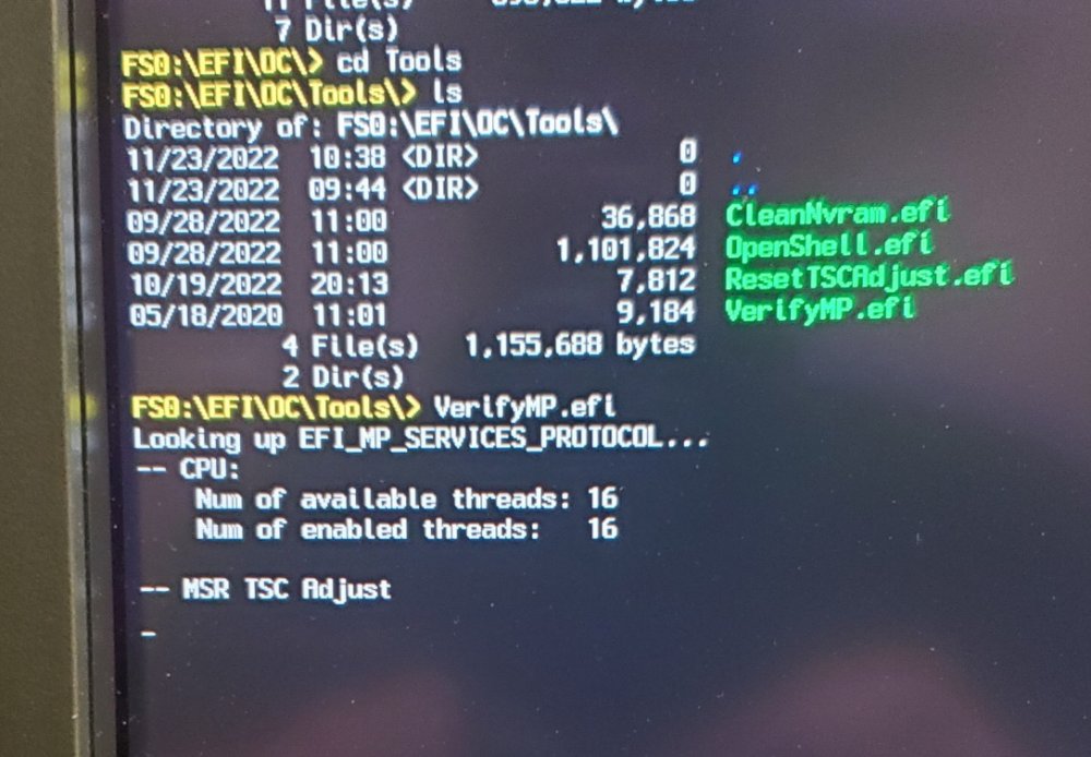

BillDH2k Posted November 23, 2022 Share Posted November 23, 2022 (edited) 20 hours ago, Slice said: I may propose next iteration. Test please. CpuMpDxe.efi.zip 8.36 kB · 1 download @Slice Tried this driver on a HP Z620 (X79, 1x 2650V2) with OC 0.8.4. OC boot up OK, no hang up, but when I tried to run ResetTSCAdjust.efi (as an EFI tool), it hanged on message "Looking up EFI_MP_SERVICES_PROTOCOL..." Edited November 23, 2022 by BillDH2k Link to comment https://www.insanelymac.com/forum/topic/341600-success-huananzhi-x79-zd3-xeon-e5-2689-mojave-10146-big-sur-1123-monterey-1201-sonoma-beta-7-sequoia-150-tahoe-beta-6/page/6/#findComment-2797659 Share on other sites More sharing options...

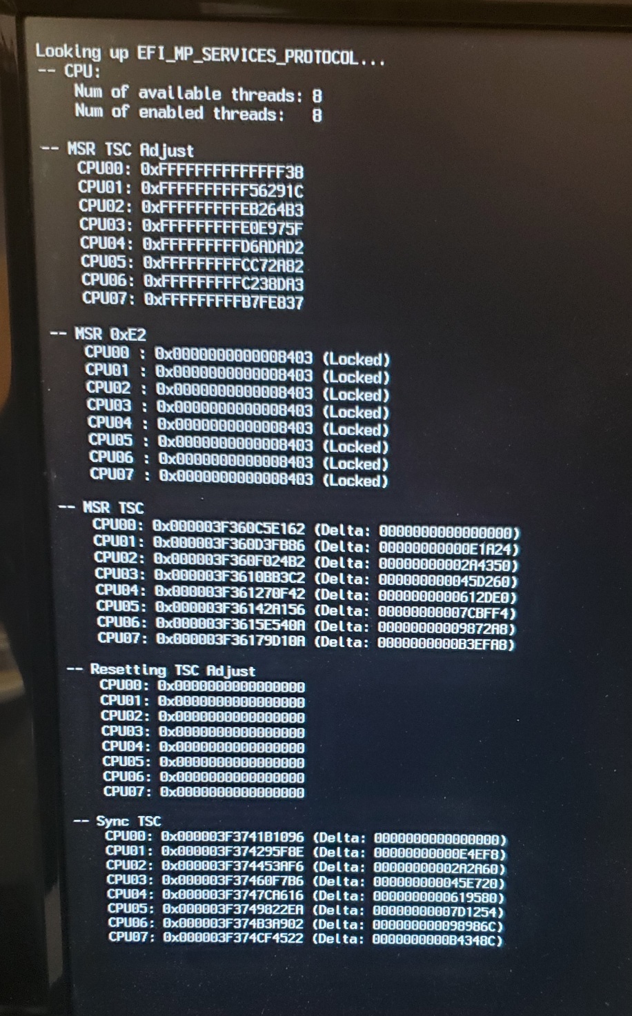

BillDH2k Posted November 23, 2022 Share Posted November 23, 2022 (edited) @Slice Also went a step further to test with the VerifyMP.efi tool (from the same source as ResetTSCAdjust.efi here). It checked the current TSC values, then perform a reset, and show new TSC after the reset. See screen capture below for results. On HP Z620 with your CpuMpExe.efi loaded as EFI driver, it appeared to have passed "looking up EFI_MP_SERVICES_PROTOCOL" and then stuck on next step "MSR TSC Adjust" (could only speculate what the script was trying to do). For comparison, I also showed the screen capture when the script was working on a HP Z440 (BIOS has support for EFI_MP_SERVICES_PROTOCOL). when running VerifyMP.efi on HP Z620 (with CpuMpExe.efi loaded as driver): When running VerifyMP.efi on HP Z440 (no extra driver loaded): Edited November 23, 2022 by BillDH2k Link to comment https://www.insanelymac.com/forum/topic/341600-success-huananzhi-x79-zd3-xeon-e5-2689-mojave-10146-big-sur-1123-monterey-1201-sonoma-beta-7-sequoia-150-tahoe-beta-6/page/6/#findComment-2797667 Share on other sites More sharing options...
BillDH2k Posted November 23, 2022 Share Posted November 23, 2022 1 hour ago, Slice said: Sorry, one bug removed CpuMpDxe.efi.zip 6.89 kB · 1 download Rerun my test with this newer version. Same result. Link to comment https://www.insanelymac.com/forum/topic/341600-success-huananzhi-x79-zd3-xeon-e5-2689-mojave-10146-big-sur-1123-monterey-1201-sonoma-beta-7-sequoia-150-tahoe-beta-6/page/6/#findComment-2797672 Share on other sites More sharing options...

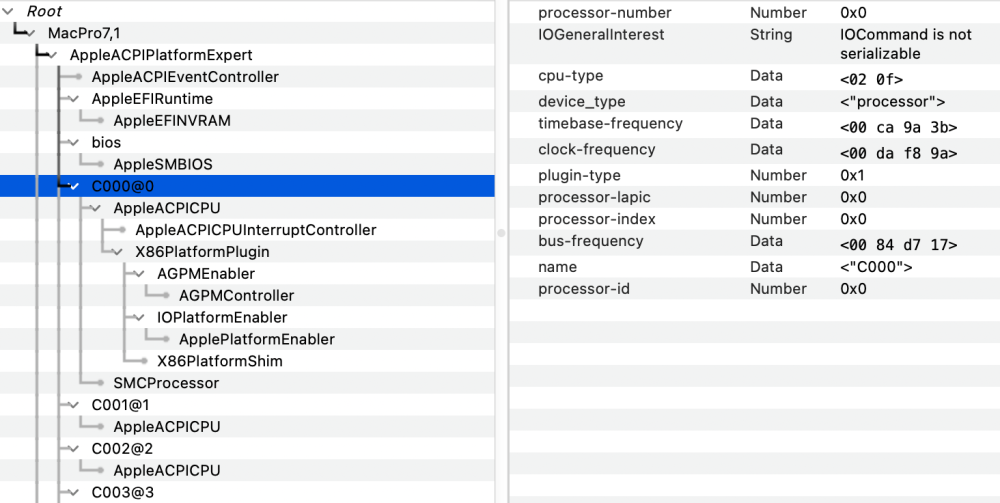

verdazil Posted September 14, 2023 Author Share Posted September 14, 2023 (edited) Sonoma 14 beta7 experimental installation 1. Installation completed with OCLP 2. Some special settings and files (OpenCore): - Native CpuPm.aml ACPI Table is deleted, a modified CpuPmMod.aml is used instead - AppleIntelCPUPowerManagement.kext, AppleIntelCPUPowerManagementClient.kext from macOS Monterey, patched for compatibility with Sonoma and added to OpenCore - For Turbo Boost operation used 3 patches in OC config section Kernel --> Patch - To ensure synchronization of CPU cores, a modified CpuTSCSyncM.kext is used - USBPorts.kext used for correct operation of the USB ports - Custom PowerPlay Tables for AMD Polaris Card RX 570 4G - Custom memory OC settings 3. What works? - Video: 4K x 60Hz on BENQ-BL2711U + Full HD x 60Hz on LG TV 42LF650V - Sound: audio jack + HDMI audio on both monitors - USB2 && USB3 ports - LAN - CPU SpeedStep and Turbo Boost - VDA Decoder Fully Supported 4. EFI folder available: https://drive.google.com/file/d/1iWEZOT9ORBZcHv-Se_u500GEyfXDI61H/view?usp=sharing 5. Test work images Edited September 14, 2023 by verdazil 1 Link to comment https://www.insanelymac.com/forum/topic/341600-success-huananzhi-x79-zd3-xeon-e5-2689-mojave-10146-big-sur-1123-monterey-1201-sonoma-beta-7-sequoia-150-tahoe-beta-6/page/6/#findComment-2811142 Share on other sites More sharing options...

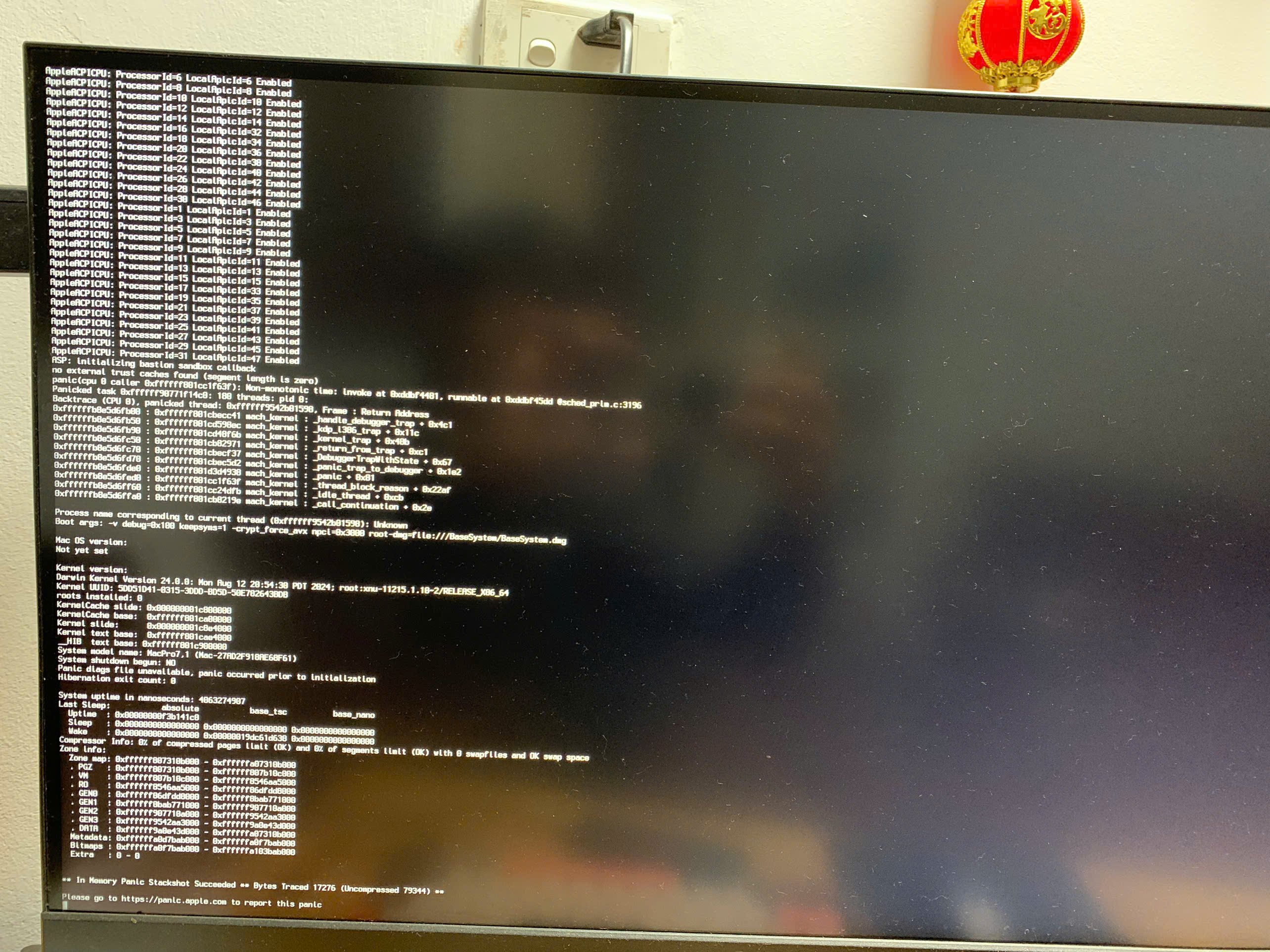

hoaug Posted October 29, 2024 Share Posted October 29, 2024 (edited) @verdazil Hello. Sorry for bothering you. I also have a machine with quite similar configuration but i cant make it working with macOS Sonoma 14.4 That is: CPU: E5-2689 Main: X79-8D RAM: 32GB SSD: 256GB NVME no brand GPU: RX570 I tried to install Sonoma but got the error as shown below. I think it is related to the TSC Sync error of the CPU so I tried to do as you and everyone discussed above. However, even though I did it, I could not Boot into the macOS installation. - I tried the VoodooTSCSync kext attached in this post + TscSyncTimeout = 525000 (also tried the kext in your latest EFI which is CPUTscSyncM + TscSyncTimeout = 525000 but all failed ) - I tried the DSDT Patch method but in the end I couldn't build it because it required Patching many other things. I don't have the ability so I had to leave it. Is it possible to build SSDT to spoof or drop SKC1,SKC2 or something. - In the end. I used the ResetTSCAdjust.efi driver but it hangs when booting with the error loaded ResetTSCAdjust.efi. My pictures about error: Spoiler Spoiler If you can. please help me or give me some suggestions Here is my EFI and my original DSDT. Thank you very much DSDT.aml EFI.zip opencore-2024-10-28-232119.txt Edited October 29, 2024 by kinhhoang161 Link to comment https://www.insanelymac.com/forum/topic/341600-success-huananzhi-x79-zd3-xeon-e5-2689-mojave-10146-big-sur-1123-monterey-1201-sonoma-beta-7-sequoia-150-tahoe-beta-6/page/6/#findComment-2827065 Share on other sites More sharing options...
verdazil Posted October 29, 2024 Author Share Posted October 29, 2024 (edited) Hi, @kinhhoang161 1. I have corrected the errors in the DSDT ACPI table. But one more table needs correction: SSDT-0-CpuPm.aml. With its loading instead of the native one. 2. "Not used SCK delete"ACPI patch not needed 3. Driver HfsPlus.efi not needed 4. The correct order of kexts: 1 - Lilu, 2- VirtualSMC... 5. Need kext CpuTscSyncM.kext DSDT.zip Edited October 29, 2024 by verdazil Link to comment https://www.insanelymac.com/forum/topic/341600-success-huananzhi-x79-zd3-xeon-e5-2689-mojave-10146-big-sur-1123-monterey-1201-sonoma-beta-7-sequoia-150-tahoe-beta-6/page/6/#findComment-2827077 Share on other sites More sharing options...

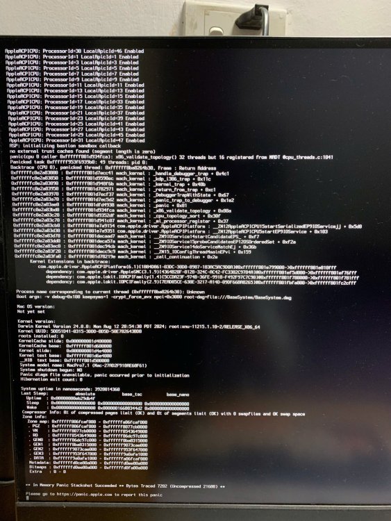

hoaug Posted October 31, 2024 Share Posted October 31, 2024 On 10/29/2024 at 9:03 PM, verdazil said: Hi, @kinhhoang161 1. I have corrected the errors in the DSDT ACPI table. But one more table needs correction: SSDT-0-CpuPm.aml. With its loading instead of the native one. 2. "Not used SCK delete"ACPI patch not needed 3. Driver HfsPlus.efi not needed 4. The correct order of kexts: 1 - Lilu, 2- VirtualSMC... 5. Need kext CpuTscSyncM.kext DSDT.zip 31.76 kB · 0 downloads Sorry for my late reply. The past few days I've been quite busy with my work. Only now can we continue to perform hackintosh. I will try them and will respond as soon as possible. Thank you very much Link to comment https://www.insanelymac.com/forum/topic/341600-success-huananzhi-x79-zd3-xeon-e5-2689-mojave-10146-big-sur-1123-monterey-1201-sonoma-beta-7-sequoia-150-tahoe-beta-6/page/6/#findComment-2827145 Share on other sites More sharing options...
hoaug Posted October 31, 2024 Share Posted October 31, 2024 @verdazil I just tried running DSDT and CpuTscSync again + timeout 525000 but it still crashes (there's a little picture below) Link to comment https://www.insanelymac.com/forum/topic/341600-success-huananzhi-x79-zd3-xeon-e5-2689-mojave-10146-big-sur-1123-monterey-1201-sonoma-beta-7-sequoia-150-tahoe-beta-6/page/6/#findComment-2827150 Share on other sites More sharing options...
verdazil Posted October 31, 2024 Author Share Posted October 31, 2024 On 10/29/2024 at 4:03 PM, verdazil said: But one more table needs correction: SSDT-0-CpuPm.aml. With its loading instead of the native one. 2. "Not used SCK delete"ACPI patch not needed 3. Driver HfsPlus.efi not needed 4. The correct order of kexts: 1 - Lilu, 2- VirtualSMC... Link to comment https://www.insanelymac.com/forum/topic/341600-success-huananzhi-x79-zd3-xeon-e5-2689-mojave-10146-big-sur-1123-monterey-1201-sonoma-beta-7-sequoia-150-tahoe-beta-6/page/6/#findComment-2827151 Share on other sites More sharing options...
