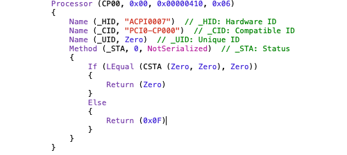

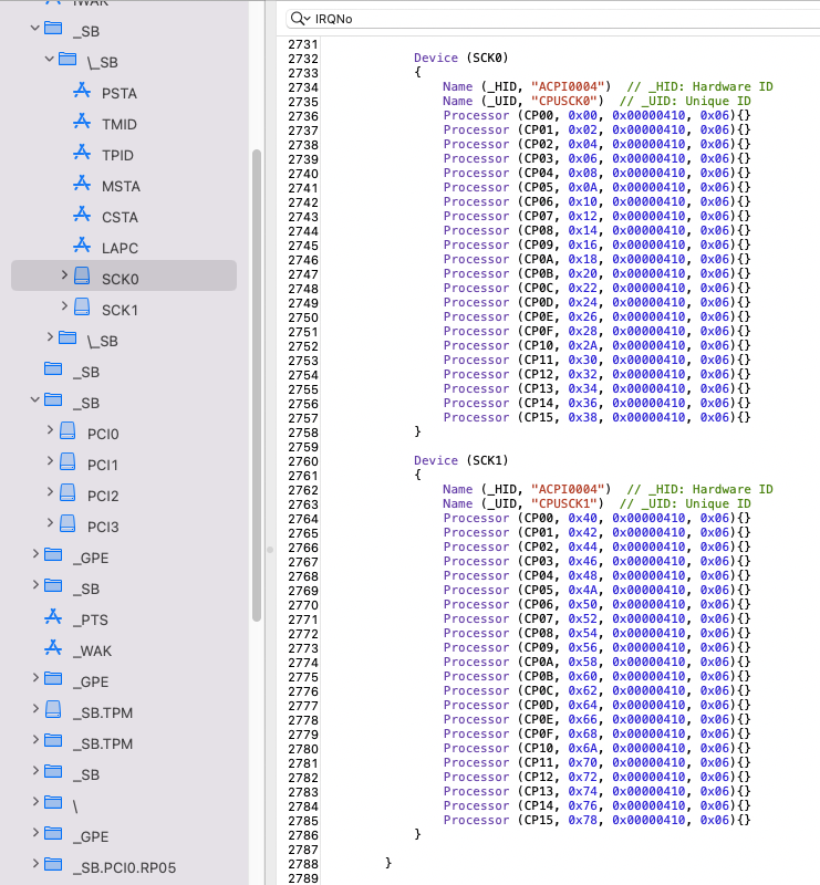

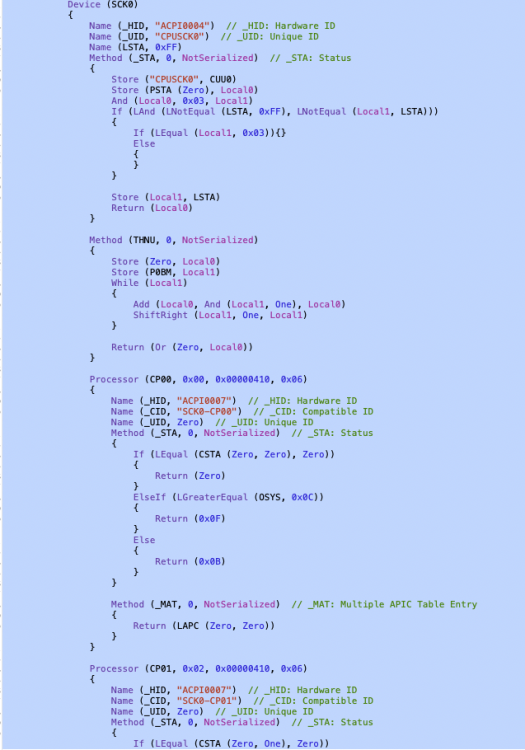

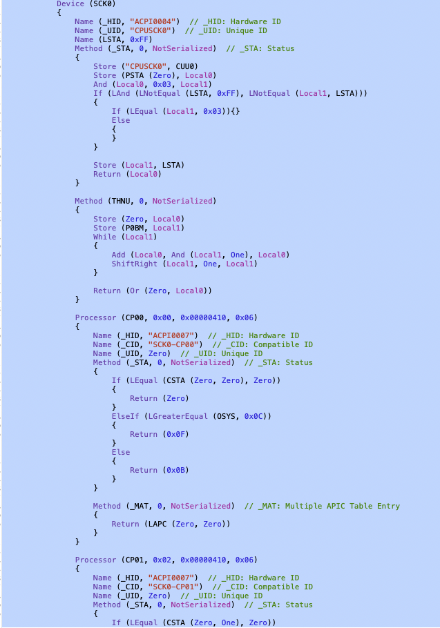

Zuja4701 Posted October 25, 2022 Share Posted October 25, 2022 On 10/11/2022 at 1:37 AM, verdazil said: A guaranteed solution has been found to resolve CPU core synchronization error when booting macOS 12 and newer. (Credits to @Slice) The solution is to edit DSDT.aml like this: 1. Remove "redundant" entries for non-existent CPUs 2. Remove "redundant" entries for non-existent CPUs threads 3. For all real CPU threads, do the following edit: Notes: - use attached VoodooTSCSync.kext version and DSDT sample. - use OpenCore parameter UEFI --> Quirks --> TscSyncTimeout (number) 500000 VoodooTSCSync.kext.zip 9.97 kB · 6 downloads DSDT.aml.zip 9.37 kB · 8 downloads hi @verdazil, I have followed your steps to modify the DSDT, but I can not change/remove "redundant" entries for non-existent CPUs threads as you mentioned above. Please let tell me how can do that. I'm sorry for bothering you. Thanks in advance! Link to comment https://www.insanelymac.com/forum/topic/341600-success-huananzhi-x79-zd3-xeon-e5-2689-mojave-10146-big-sur-1123-monterey-1201-sonoma-beta-7-sequoia-150-tahoe-beta-6/page/4/#findComment-2795915 Share on other sites More sharing options...
BillDH2k Posted October 25, 2022 Share Posted October 25, 2022 (edited) 8 hours ago, Zuja4701 said: hi @verdazil, I have followed your steps to modify the DSDT, but I can not change/remove "redundant" entries for non-existent CPUs threads as you mentioned above. Please let tell me how can do that. I'm sorry for bothering you. Thanks in advance! @Zuja4701 @verdazil It's simple edit of your DSDT.aml, use macIASL. Grab this version here (by RehabMan v1.31). This is the only version that worked for me, without compiling errors. Make sure you select output format "ACPI 6.2a" under Preference setting. If the DSDT.aml you posted on Oct 11 is the correct version, I made the changes for you (see attached files). I've also added a few more changes, by removing IRQ 0/8 for RTC/TMR, as well as HPET._CRS to XCRS rename. These patches (specified under your config.plist->ACPI->patch) must be included here when you do DSDT overwrite. DSDT-patched.aml Your T7910 is the Dual CPUs version of T5810 which I own (same BIOS), thus the result is unlikely different from mine: same kernel panic. But please go ahead and give it a try. Edited October 25, 2022 by BillDH2k 1 Link to comment https://www.insanelymac.com/forum/topic/341600-success-huananzhi-x79-zd3-xeon-e5-2689-mojave-10146-big-sur-1123-monterey-1201-sonoma-beta-7-sequoia-150-tahoe-beta-6/page/4/#findComment-2795945 Share on other sites More sharing options...
BillDH2k Posted October 25, 2022 Share Posted October 25, 2022 23 hours ago, Slice said: It looks like I have a success with another kext VoodooTSCSync.kext.zip 8.16 kB · 3 downloads Moreover, I am using Clover and FakeSMC. @Slice I am willing to give it a Clover a try. Last time I used Clover was two years ago. One question: is Clover Configurator (5.23.0.0 latest) uptodate to use? Thanks! Link to comment https://www.insanelymac.com/forum/topic/341600-success-huananzhi-x79-zd3-xeon-e5-2689-mojave-10146-big-sur-1123-monterey-1201-sonoma-beta-7-sequoia-150-tahoe-beta-6/page/4/#findComment-2795948 Share on other sites More sharing options...
Zuja4701 Posted October 26, 2022 Share Posted October 26, 2022 9 hours ago, BillDH2k said: @Zuja4701 @verdazil It's simple edit of your DSDT.aml, use macIASL. Grab this version here (by RehabMan v1.31). This is the only version that worked for me, without compiling errors. Make sure you select output format "ACPI 6.2a" under Preference setting. If the DSDT.aml you posted on Oct 11 is the correct version, I made the changes for you (see attached files). I've also added a few more changes, by removing IRQ 0/8 for RTC/TMR, as well as HPET._CRS to XCRS rename. These patches (specified under your config.plist->ACPI->patch) must be included here when you do DSDT overwrite. DSDT-patched.aml 169 kB · 1 download Your T7910 is the Dual CPUs version of T5810 which I own (same BIOS), thus the result is unlikely different from mine: same kernel panic. But please go ahead and give it a try. @BillDH2k thank you very much for your help. I will let you know the results this afternoon Link to comment https://www.insanelymac.com/forum/topic/341600-success-huananzhi-x79-zd3-xeon-e5-2689-mojave-10146-big-sur-1123-monterey-1201-sonoma-beta-7-sequoia-150-tahoe-beta-6/page/4/#findComment-2795980 Share on other sites More sharing options...

Zuja4701 Posted October 26, 2022 Share Posted October 26, 2022 20 hours ago, BillDH2k said: @Zuja4701 @verdazil It's simple edit of your DSDT.aml, use macIASL. Grab this version here (by RehabMan v1.31). This is the only version that worked for me, without compiling errors. Make sure you select output format "ACPI 6.2a" under Preference setting. If the DSDT.aml you posted on Oct 11 is the correct version, I made the changes for you (see attached files). I've also added a few more changes, by removing IRQ 0/8 for RTC/TMR, as well as HPET._CRS to XCRS rename. These patches (specified under your config.plist->ACPI->patch) must be included here when you do DSDT overwrite. DSDT-patched.aml 169 kB · 3 downloads Your T7910 is the Dual CPUs version of T5810 which I own (same BIOS), thus the result is unlikely different from mine: same kernel panic. But please go ahead and give it a try. Hello @BillDH2k, I tried to boot with your DSDT-patched above, but it is still the same kernel panic. I think that DSDT is correct, but the problem seems from something else. Please let me know if you have some new idea to solve this problem. Thanks a lot! Link to comment https://www.insanelymac.com/forum/topic/341600-success-huananzhi-x79-zd3-xeon-e5-2689-mojave-10146-big-sur-1123-monterey-1201-sonoma-beta-7-sequoia-150-tahoe-beta-6/page/4/#findComment-2796006 Share on other sites More sharing options...
pitrysha Posted October 26, 2022 Share Posted October 26, 2022 1 hour ago, Zuja4701 said: Hello @BillDH2k, I tried to boot with your DSDT-patched above, but it is still the same kernel panic. I think that DSDT is correct, but the problem seems from something else. Please let me know if you have some new idea to solve this problem. Thanks a lot! You need to add "Name(_HID, "ACPI0007"". It should turn out something like in the sample. CPU.dsl 1 Link to comment https://www.insanelymac.com/forum/topic/341600-success-huananzhi-x79-zd3-xeon-e5-2689-mojave-10146-big-sur-1123-monterey-1201-sonoma-beta-7-sequoia-150-tahoe-beta-6/page/4/#findComment-2796017 Share on other sites More sharing options...

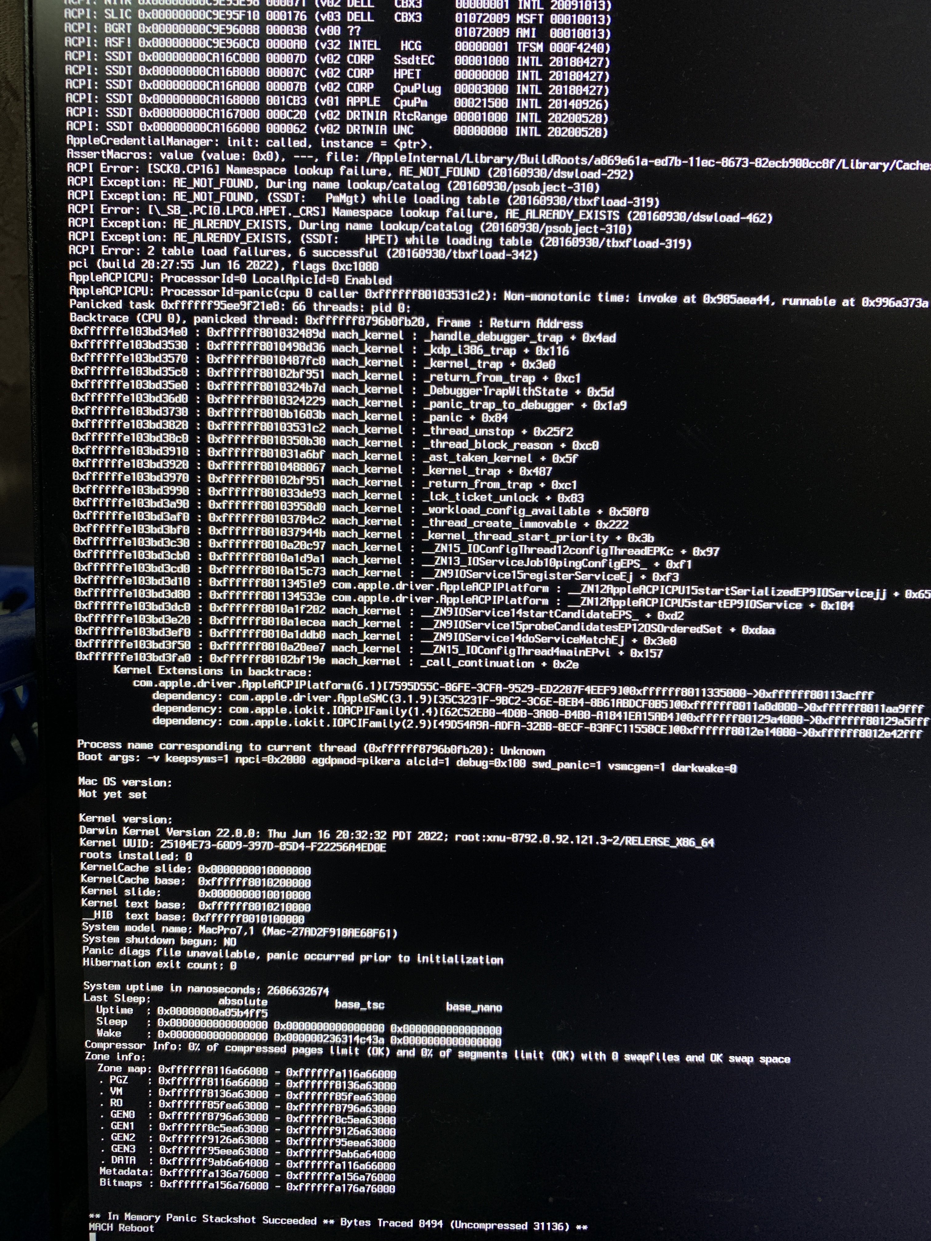

BillDH2k Posted October 27, 2022 Share Posted October 27, 2022 (edited) 7 hours ago, pitrysha said: DELL T5810 - Look here, maybe you will find a solution https://github.com/OreyM/Hackintosh-Dell-T5810-Xeon-E5-26xx-V3-OpenCore-PowerMac-G5 @pitrysha The issue with these DELL systems (like T5810/7910, possibly T5610 too) is the kernel panic ("non-monotonic time") during booting, under Monterey only, caused by out of sync TSC. This thread about Huananzhi X79 board having appeared to be similar issue but was resolved with CPU tables changes. I am trying to test if we could resolve it with similar approach. So far, no success. I will try Clover, per @Slice suggestion, as a last resort. Edited October 27, 2022 by BillDH2k Link to comment https://www.insanelymac.com/forum/topic/341600-success-huananzhi-x79-zd3-xeon-e5-2689-mojave-10146-big-sur-1123-monterey-1201-sonoma-beta-7-sequoia-150-tahoe-beta-6/page/4/#findComment-2796102 Share on other sites More sharing options...
Zuja4701 Posted October 27, 2022 Share Posted October 27, 2022 1 hour ago, BillDH2k said: @pitrysha The issue with these DELL systems (like T5810/7910, possibly T5610 too) is the kernel panic ("non-monotonic time") during booting, under Monterey only, caused by out of sync TSC. This thread about Huananzhi X79 board having appeared to be similar issue but was resolved with CPU tables changes. I am trying to test if we could resolve it with similar approach. So far, no success. I will try Clover, per @Slice suggestion, as a last resort. That's sound great @BillDH2k, please let me know if you have something news. Thank you! Link to comment https://www.insanelymac.com/forum/topic/341600-success-huananzhi-x79-zd3-xeon-e5-2689-mojave-10146-big-sur-1123-monterey-1201-sonoma-beta-7-sequoia-150-tahoe-beta-6/page/4/#findComment-2796107 Share on other sites More sharing options...
pitrysha Posted October 27, 2022 Share Posted October 27, 2022 3 hours ago, BillDH2k said: @pitrysha The issue with these DELL systems (like T5810/7910, possibly T5610 too) is the kernel panic ("non-monotonic time") during booting, under Monterey only, caused by out of sync TSC. This thread about Huananzhi X79 board having appeared to be similar issue but was resolved with CPU tables changes. I am trying to test if we could resolve it with similar approach. So far, no success. I will try Clover, per @Slice suggestion, as a last resort. If Big Sur was loaded, then this EFI should be enough for you. Perhaps you still need to emulate NVRAM. EFI.zip 1 Link to comment https://www.insanelymac.com/forum/topic/341600-success-huananzhi-x79-zd3-xeon-e5-2689-mojave-10146-big-sur-1123-monterey-1201-sonoma-beta-7-sequoia-150-tahoe-beta-6/page/4/#findComment-2796116 Share on other sites More sharing options...

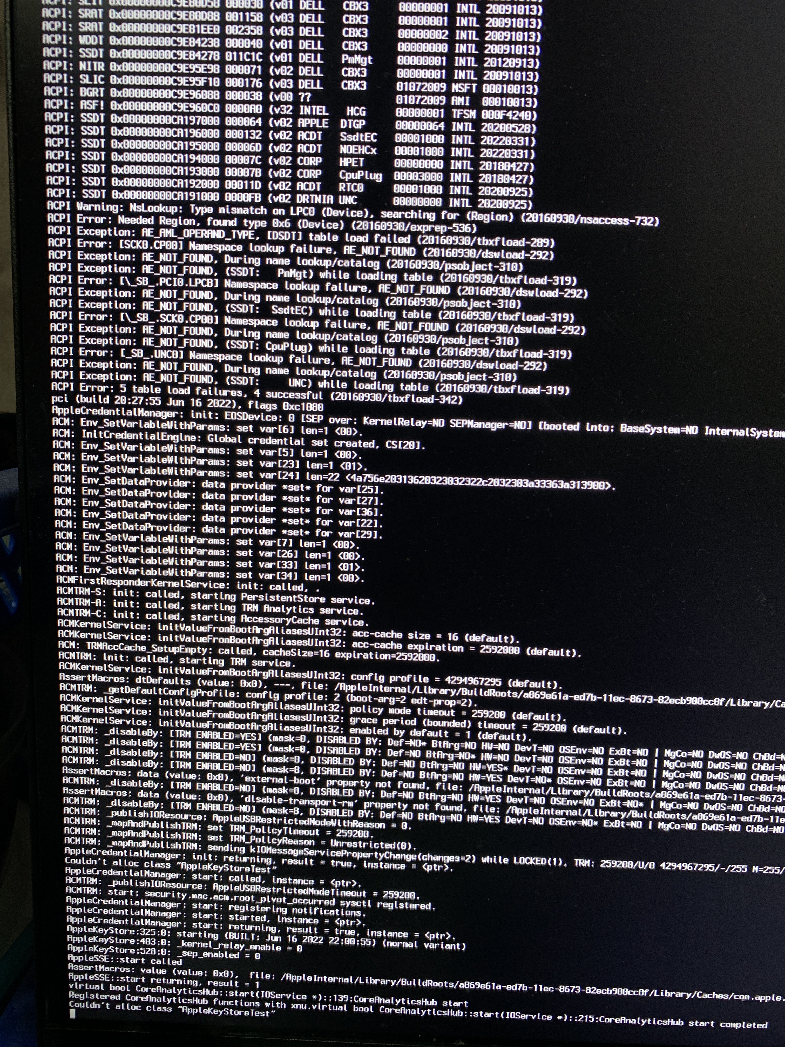

Zuja4701 Posted October 31, 2022 Share Posted October 31, 2022 On 10/28/2022 at 1:46 AM, pitrysha said: If Big Sur was loaded, then this EFI should be enough for you. Perhaps you still need to emulate NVRAM. EFI.zip 4.23 MB · 5 downloads Hello @pitrysha, there are some improvement when I use your modified EFI. It can boot without KP problems, but it is still some error such as "couldn't alloc class applekeystoretest". Please tell me how can I fix this problem. Thank you very much! Link to comment https://www.insanelymac.com/forum/topic/341600-success-huananzhi-x79-zd3-xeon-e5-2689-mojave-10146-big-sur-1123-monterey-1201-sonoma-beta-7-sequoia-150-tahoe-beta-6/page/4/#findComment-2796299 Share on other sites More sharing options...
