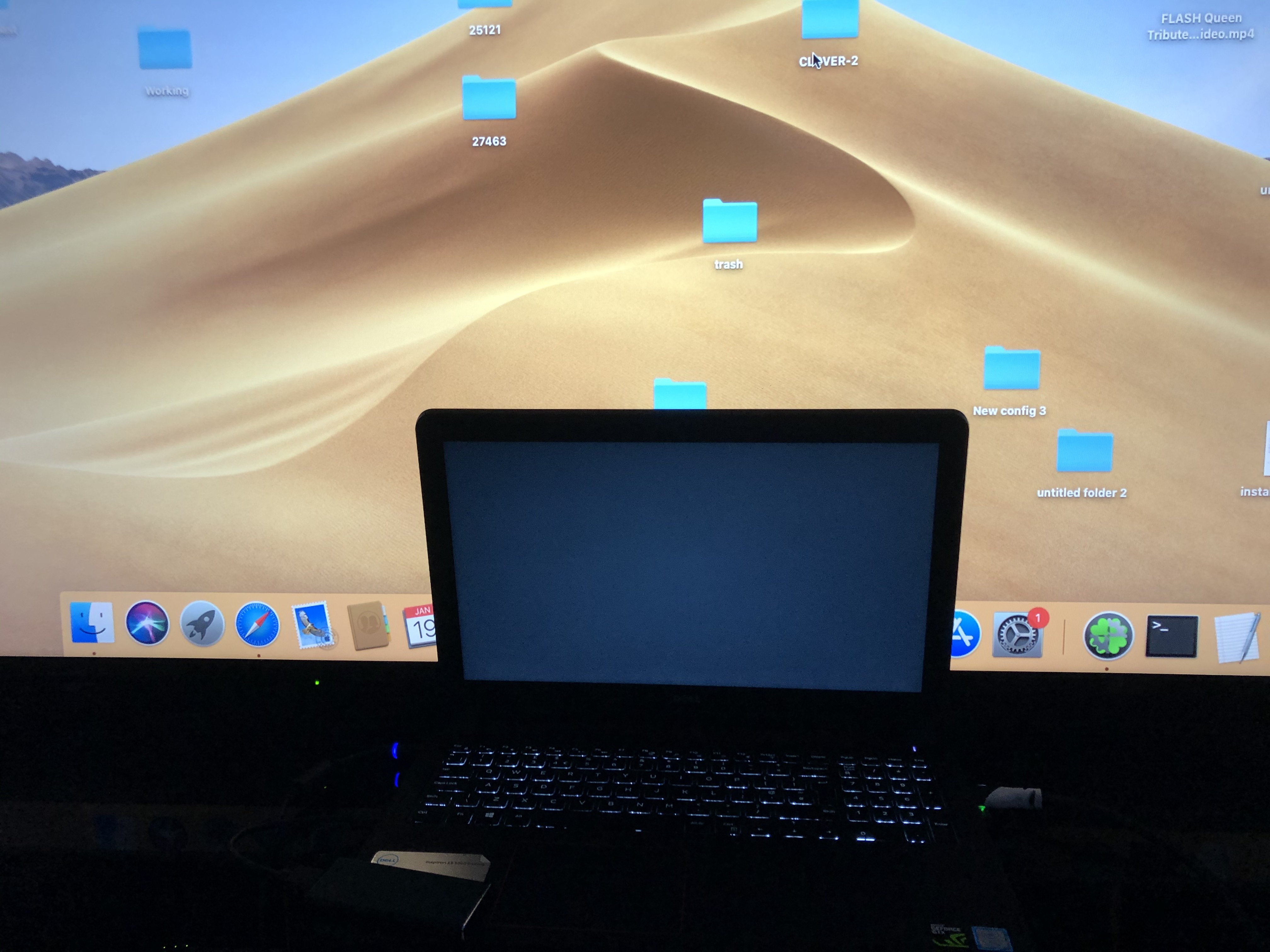

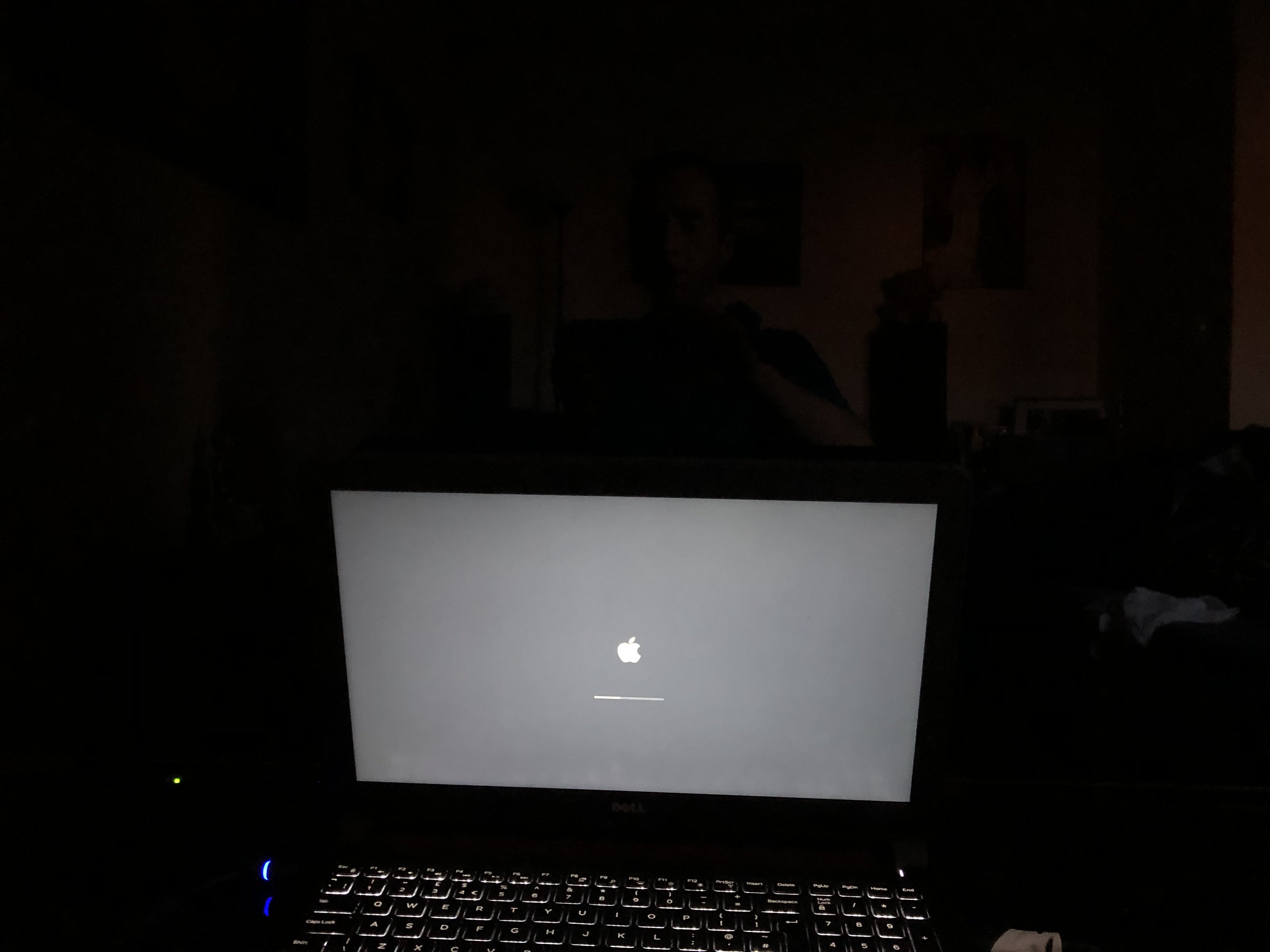

tomprescott_128 Posted January 19, 2020 Share Posted January 19, 2020 13 hours ago, ctich said: replace all. CLOVER.zip Good Morning, Thanks for this but the graphics card still boots up at 7MB. Someone from another forum as given me there files. Which the Intel HD graphics 630 card in the laptop works. So the problem now is when you boot up the apple logo boots half way and then goes to a black screen and continues to out put the graphics by the HDMI port as seen in the pictures and the laptop screen stays black. I have attached the new Debug files and a config file. I think the intel HD graphics 630 card should only push graphics to the laptop screen not the HDMI. If someone could help me with this I would be most greatful debug_24164.zip config.plist Link to comment https://www.insanelymac.com/forum/topic/341529-mojave-intel-uhd-630-7-mb-no-acceleration-please-help/page/2/#findComment-2704917 Share on other sites More sharing options...
AkimoA Posted January 19, 2020 Share Posted January 19, 2020 In your config.plist Device -> Properties your 1st Framebuffer port is set to HDMI framebuffer-con1-type 00 08 00 00 so u could go ahead and try changing that to LVDS framebuffer-con1-type 02 00 00 00 Link to comment https://www.insanelymac.com/forum/topic/341529-mojave-intel-uhd-630-7-mb-no-acceleration-please-help/page/2/#findComment-2704928 Share on other sites More sharing options...
