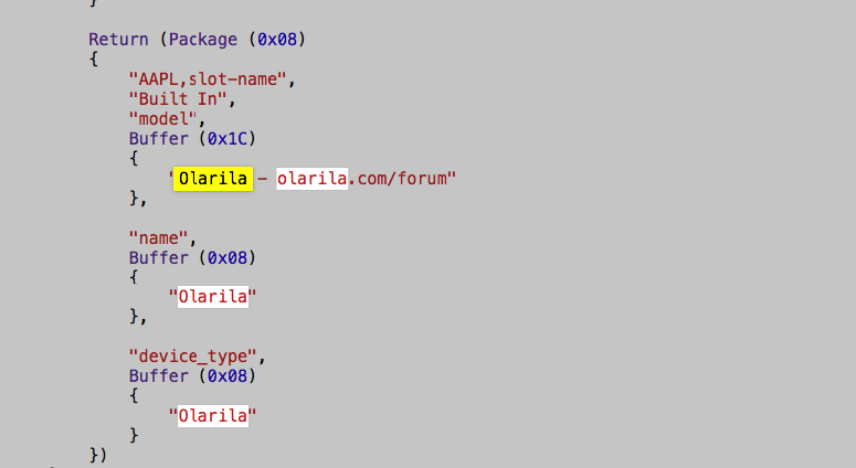

Guest Posted May 11, 2020 Share Posted May 11, 2020 (edited) Hey, Quick update.. it seems the EFI settings are using olarila, and it just brick my motherboard :-/ I got a noisy screen during boot sequence, so let's see how I can go over this now. Edited May 11, 2020 by Myfz Link to comment https://www.insanelymac.com/forum/topic/340936-audiogods-aorus-z390-master-patched-dsdt-efi-for-catalina-mini-guide-and-discussion/page/44/#findComment-2722023 Share on other sites More sharing options...
AudioGod Posted May 11, 2020 Author Share Posted May 11, 2020 (edited) 8 minutes ago, Myfz said: Hey, Quick update.. it seems the EFI settings are using olarila, and it just brick my motherboard :-/ I got a noisy screen during boot sequence, so let's see how I can go over this now. The dsdt was made by MaLD0n for me but the EFI and settings are not from Olarila no, they are done by me. your talking utter nonsense... p.s MaLD0n runs Olarila and marks he’s DSDTs that way. Edited May 11, 2020 by AudioGod 1 Link to comment https://www.insanelymac.com/forum/topic/340936-audiogods-aorus-z390-master-patched-dsdt-efi-for-catalina-mini-guide-and-discussion/page/44/#findComment-2722024 Share on other sites More sharing options...
Guest Posted May 11, 2020 Share Posted May 11, 2020 (edited) @Audiogod : Please apologize ! I'm still new on hackintosh (I started yesterday to be honest). I was talking with someone from the hackintosh discord.. and she just told me the motherboard is probably brick.. but I don't really have a clue lol Do you have an idea on how I can fix this issue ? :-/ PS: MacOS is still working, it's just during the boot sequence. Edited May 11, 2020 by Myfz Link to comment https://www.insanelymac.com/forum/topic/340936-audiogods-aorus-z390-master-patched-dsdt-efi-for-catalina-mini-guide-and-discussion/page/44/#findComment-2722025 Share on other sites More sharing options...
AudioGod Posted May 11, 2020 Author Share Posted May 11, 2020 (edited) 5 minutes ago, Myfz said: @Audiogod : Please apologize ! I'm still new on hackintosh (I started yesterday to be honest). I was talking with someone from the hackintosh discord.. and she just told me the motherboard is probably brick :-( (it wasn't the most nicest person to be fair) Do you have an idea on how I can fix this issue ? :-/ PS: MacOS is still working, it's just during the boot sequence. was this person your referring to happen to have a youtube channel and brag about having the most powerful ryzentosh hack in the world? she a total scammer if it is who I think it is? @Myfz is it Morgonaut?? Edited May 11, 2020 by AudioGod Link to comment https://www.insanelymac.com/forum/topic/340936-audiogods-aorus-z390-master-patched-dsdt-efi-for-catalina-mini-guide-and-discussion/page/44/#findComment-2722026 Share on other sites More sharing options...
Guest Posted May 11, 2020 Share Posted May 11, 2020 4 minutes ago, AudioGod said: was this person your referring to happen to have a youtube channel and brag about having the most powerful ryzentosh hack in the world? she a total scammer if it is who I think it is? @Myfz is it Morgonaut?? It's not her, someone from Hackintosh Paradise. Is there is a way to talk via private message, or is it ok to talk about this here ? Did you already face to this issue with your motherboard ? Link to comment https://www.insanelymac.com/forum/topic/340936-audiogods-aorus-z390-master-patched-dsdt-efi-for-catalina-mini-guide-and-discussion/page/44/#findComment-2722027 Share on other sites More sharing options...
AudioGod Posted May 11, 2020 Author Share Posted May 11, 2020 No because you can’t brick your board using mals dsdt or my Efi, thousands or people use my files and nobody’s ever bricked a board or anything else like that using my files. its fine to talk about it on here as you have been misinformed so it’s good for others to see what’s happened and understand and even help. 1 Link to comment https://www.insanelymac.com/forum/topic/340936-audiogods-aorus-z390-master-patched-dsdt-efi-for-catalina-mini-guide-and-discussion/page/44/#findComment-2722028 Share on other sites More sharing options...
AudioGod Posted May 11, 2020 Author Share Posted May 11, 2020 (edited) @Myfz Did this women you spoke to have a strong Russian accent? whats her user name?? when you say your board is bricked do you mean your getting a stop sign when you try to boot into macOS? if that’s the case then power off the system and then reset the bios using the bios reset button and then boot back up into the bios once it’s finished retesting itself because of the bios reset and load back in my bios profile and save and exit and all should be fine again. if your getting a Apple logo and nothing else is happening then your need to load in my unlocked profile again or tick kernelPM in the config.plist. Edited May 11, 2020 by AudioGod Link to comment https://www.insanelymac.com/forum/topic/340936-audiogods-aorus-z390-master-patched-dsdt-efi-for-catalina-mini-guide-and-discussion/page/44/#findComment-2722029 Share on other sites More sharing options...

Guest Posted May 11, 2020 Share Posted May 11, 2020 (edited) I'm gonna try to reset my bios, and I let you know! Thank for your help, I very appreciate! Edited May 11, 2020 by Myfz Link to comment https://www.insanelymac.com/forum/topic/340936-audiogods-aorus-z390-master-patched-dsdt-efi-for-catalina-mini-guide-and-discussion/page/44/#findComment-2722032 Share on other sites More sharing options...
Guest Posted May 11, 2020 Share Posted May 11, 2020 (edited) 1 hour ago, AudioGod said: Reset your bios, I left instructions on my last message, I just reset the Bios and it did the trick! Then I load the hackintosh profile (I save your profile in my bios), and I was able to boot on both OS again! Thank you so much for your help! Edited May 12, 2020 by Myfz Link to comment https://www.insanelymac.com/forum/topic/340936-audiogods-aorus-z390-master-patched-dsdt-efi-for-catalina-mini-guide-and-discussion/page/44/#findComment-2722041 Share on other sites More sharing options...
AudioGod Posted May 12, 2020 Author Share Posted May 12, 2020 8 hours ago, Myfz said: I just reset the Bios and it did the trick! Then I load the hackintosh profile (I save your profile in my bios), and I was able to boot on both OS again! Thank you so much for your help! Awesome, you see I told you that was bad Info telling you what they did over on discord. next time you have a problem just come on here for help as myself and many others will always be here to help you if we can. Link to comment https://www.insanelymac.com/forum/topic/340936-audiogods-aorus-z390-master-patched-dsdt-efi-for-catalina-mini-guide-and-discussion/page/44/#findComment-2722076 Share on other sites More sharing options...
