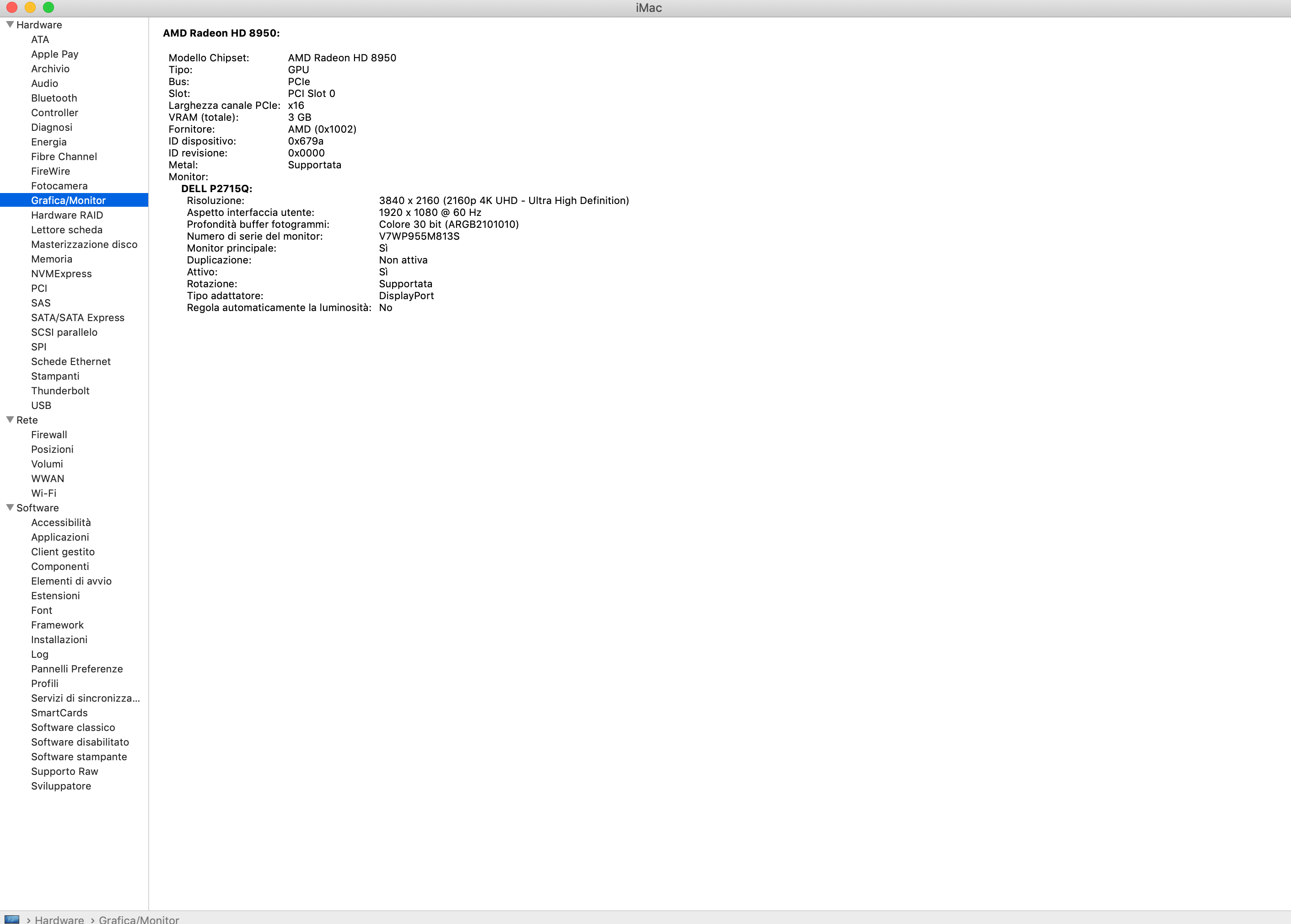

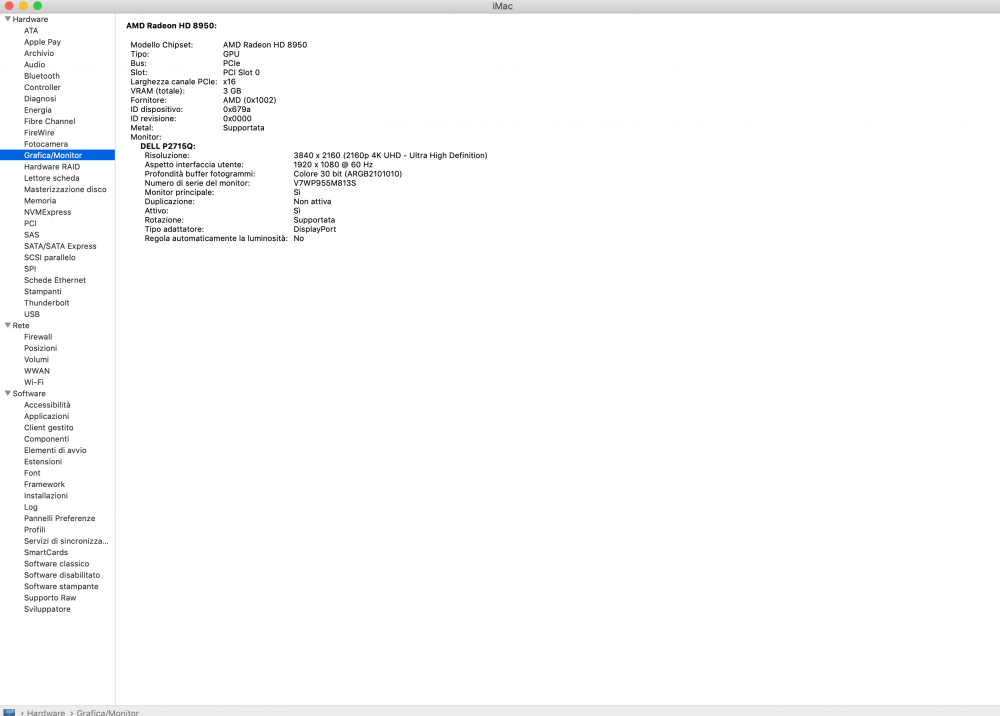

Patrick78 Posted September 5, 2019 Author Share Posted September 5, 2019 La scheda video non risulta la mia HD7950, non so se comporta qualcosa. pero sento che anche in standby la scheda lavora non capisco a che risoluzione sto lavorando, mi sembra 4K ma anche su YouTube non mi da l'opzione 4k se voglio vedere un video Link to comment https://www.insanelymac.com/forum/topic/339905-info-compatibilit%C3%A0-con-mojave/page/6/#findComment-2688890 Share on other sites More sharing options...

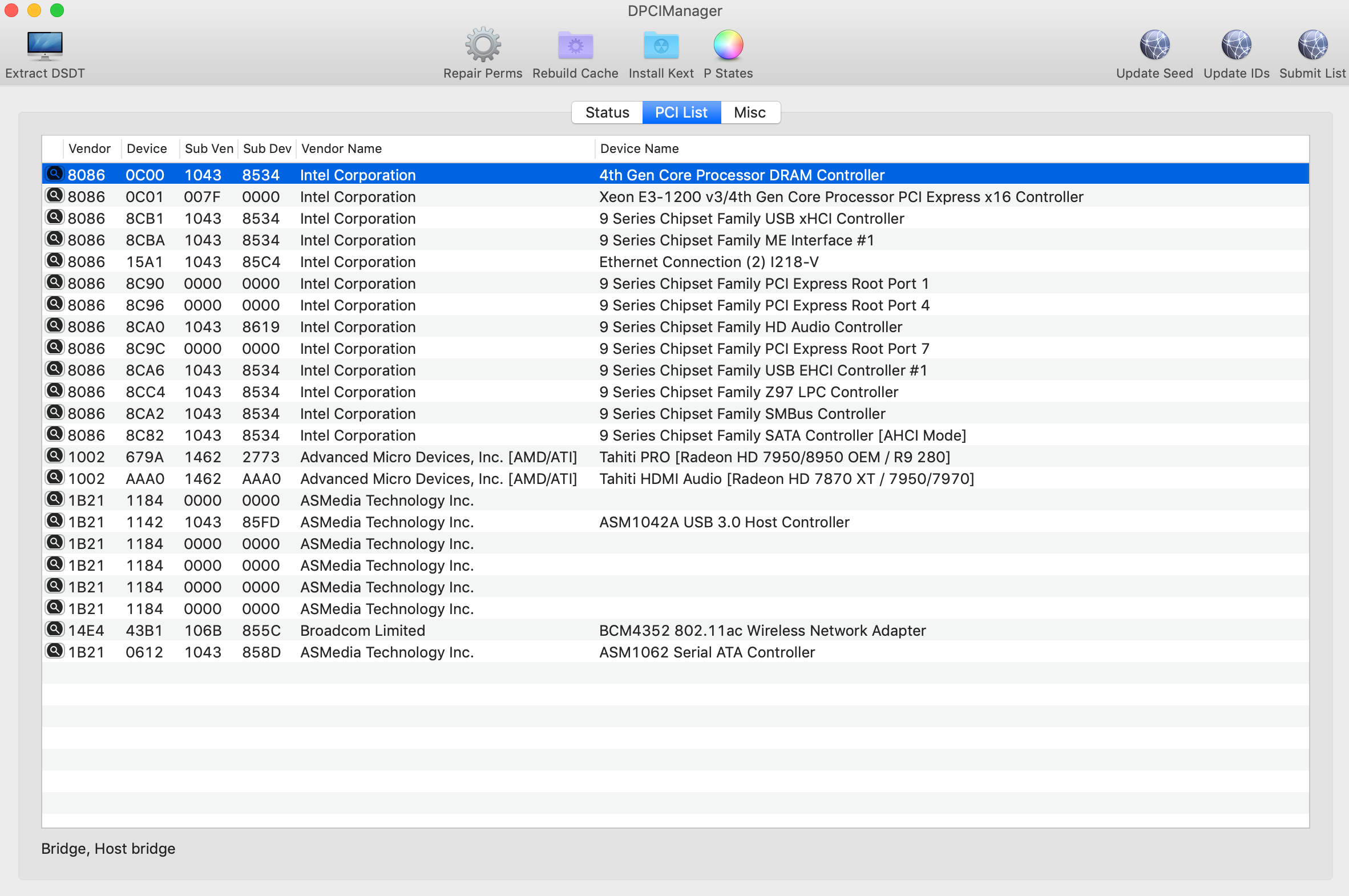

gengik84 Posted September 5, 2019 Share Posted September 5, 2019 il nome è estetica dato da WEG.kext allegami immagine di dpci manager parte status Link to comment https://www.insanelymac.com/forum/topic/339905-info-compatibilit%C3%A0-con-mojave/page/6/#findComment-2688891 Share on other sites More sharing options...
Patrick78 Posted September 5, 2019 Author Share Posted September 5, 2019 Link to comment https://www.insanelymac.com/forum/topic/339905-info-compatibilit%C3%A0-con-mojave/page/6/#findComment-2688895 Share on other sites More sharing options...

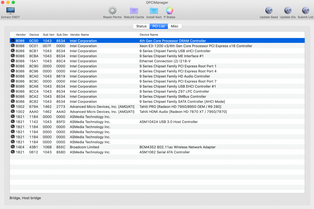

gengik84 Posted September 5, 2019 Share Posted September 5, 2019 scusa, pci list Link to comment https://www.insanelymac.com/forum/topic/339905-info-compatibilit%C3%A0-con-mojave/page/6/#findComment-2688896 Share on other sites More sharing options...
Patrick78 Posted September 5, 2019 Author Share Posted September 5, 2019 Link to comment https://www.insanelymac.com/forum/topic/339905-info-compatibilit%C3%A0-con-mojave/page/6/#findComment-2688897 Share on other sites More sharing options...
gengik84 Posted September 5, 2019 Share Posted September 5, 2019 come vedi anche tu dall'immagine ha stessi id della 8950 e R9 280 Link to comment https://www.insanelymac.com/forum/topic/339905-info-compatibilit%C3%A0-con-mojave/page/6/#findComment-2688900 Share on other sites More sharing options...
