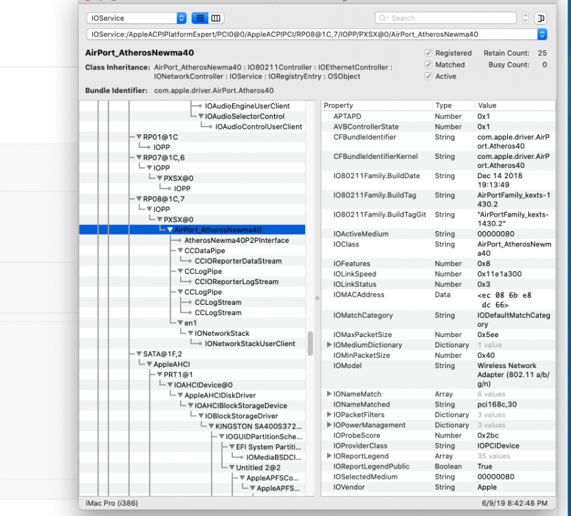

Gigamaxx Posted June 10, 2019 Share Posted June 10, 2019 (edited) Catalina seems to be a read only kext system so modifying kexts to make older hardware work doesn't seem to be possible at this point. However we have had success using Mojave kexts to get hardware to function. For bluetooth on Broadcom WiFi cards using injectorkext and adding the Mojave bluetooth kexts to System/Library/Extensions folder seems to have solved the connectability issue. Install Mojave kexts and use kext utility to repair permissions and caches before reboot. The Zip contains the Catalina original kexts as a backup in case you want to revert. Bluetooth kexts fix.zip For Atheros WiFi we are using Mojave modified with High Sierra kexts. Install in System/Library/Extensions folder and use kext utility to repair. Edited June 10, 2019 by Gigamaxx 2 Link to comment Share on other sites More sharing options...
