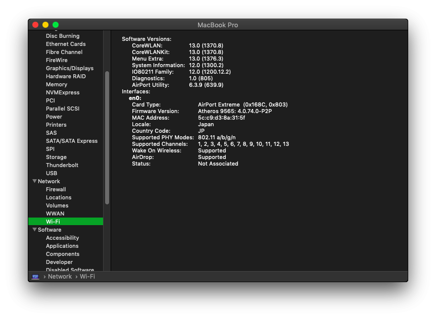

Ace2213 Posted May 2, 2019 Author Share Posted May 2, 2019 False alarm. Wifi doesn't show any networks or connect manually either. But the interface exists now, with a Mac address and configurations and everything Link to comment https://www.insanelymac.com/forum/topic/338539-acer-es1-572-laptop-hackintosh/page/2/#findComment-2672248 Share on other sites More sharing options...
Cyberdevs Posted May 2, 2019 Share Posted May 2, 2019 Replace the original kext in /S/L/E with this one and see how the wifi behaves IO80211Family.kext.zip Link to comment https://www.insanelymac.com/forum/topic/338539-acer-es1-572-laptop-hackintosh/page/2/#findComment-2672249 Share on other sites More sharing options...
Ace2213 Posted May 2, 2019 Author Share Posted May 2, 2019 I'm confused. I keep getting the same errors when rebuilding cache even after removing the problematic kexts. I removed them from /L/E, removed them from EFI/kexts/Others, even removed them from /S/L/E, same result. I rebooted and got a panic, probably due to removing kexts from /S/L/E. Rebooted again and it went fine. Is there another Kext cache directory? I'll reboot into Windows to download your kexts. Interestingly, if I create a wifi network, it is visible to other devices, even though it can't see or connect to other networks. But I can't connect to that network from other devices. Nothing happens when I click on it. Link to comment https://www.insanelymac.com/forum/topic/338539-acer-es1-572-laptop-hackintosh/page/2/#findComment-2672252 Share on other sites More sharing options...
Ace2213 Posted May 2, 2019 Author Share Posted May 2, 2019 I used the Atheros installer, it completed successfully. I rebooted and no change. I then replaced the system Kext with yours and also nothing changed. Link to comment https://www.insanelymac.com/forum/topic/338539-acer-es1-572-laptop-hackintosh/page/2/#findComment-2672253 Share on other sites More sharing options...

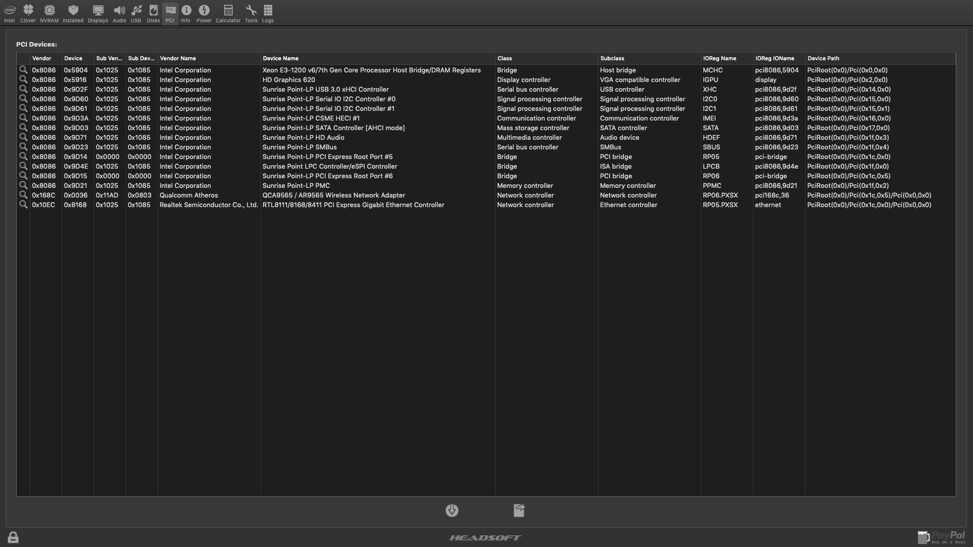

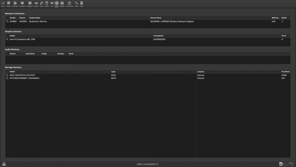

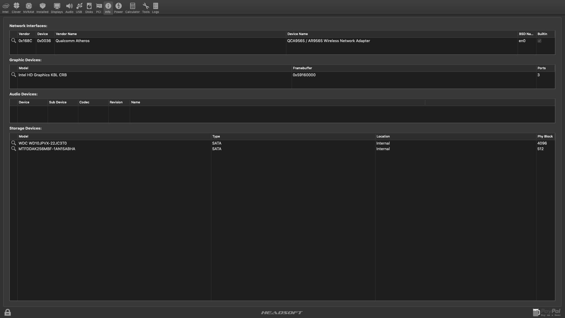

Cyberdevs Posted May 2, 2019 Share Posted May 2, 2019 25 minutes ago, Ace2213 said: I used the Atheros installer, it completed successfully. I rebooted and no change. I then replaced the system Kext with yours and also nothing changed. Use this tool and post a screenshot from the PCI section just make sure to justify the columns correctly so the contents are readable and let's see which WiFi chipset your laptop uses. Link to comment https://www.insanelymac.com/forum/topic/338539-acer-es1-572-laptop-hackintosh/page/2/#findComment-2672255 Share on other sites More sharing options...

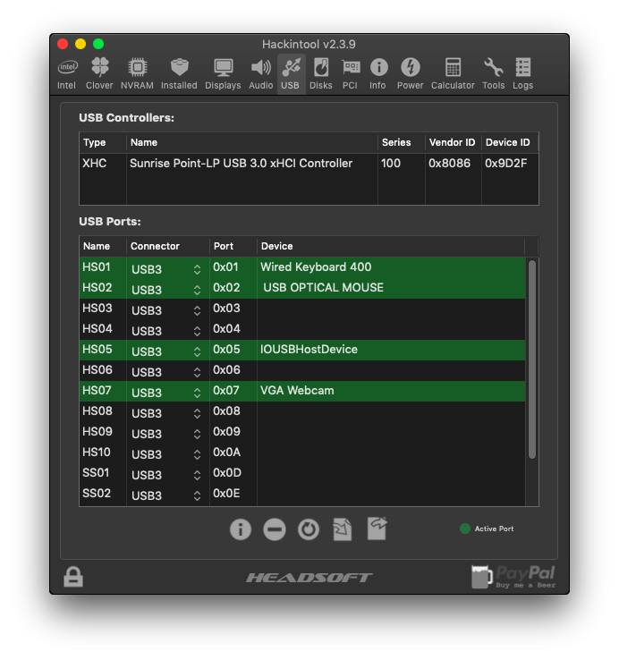

Ace2213 Posted May 2, 2019 Author Share Posted May 2, 2019 I don't have nearly this many USB ports. I only have 3, only one of them 3.0. But it is including things like my built-in webcam so maybe it's not just physical USB. That said, my webcam doesn't seem to be working in macOS Image Capture. Nothing detected under Ethernet or Audio. My other 4GB RAM stick arrived today, and is being detected in About this Mac, but graphics shared memory didn't update in macOS like it did in Windows. Also, the "Memory" tab that should show the two sticks is now missing. Possibly since the SMBIOS switch to Macbook. Link to comment https://www.insanelymac.com/forum/topic/338539-acer-es1-572-laptop-hackintosh/page/2/#findComment-2672315 Share on other sites More sharing options...
