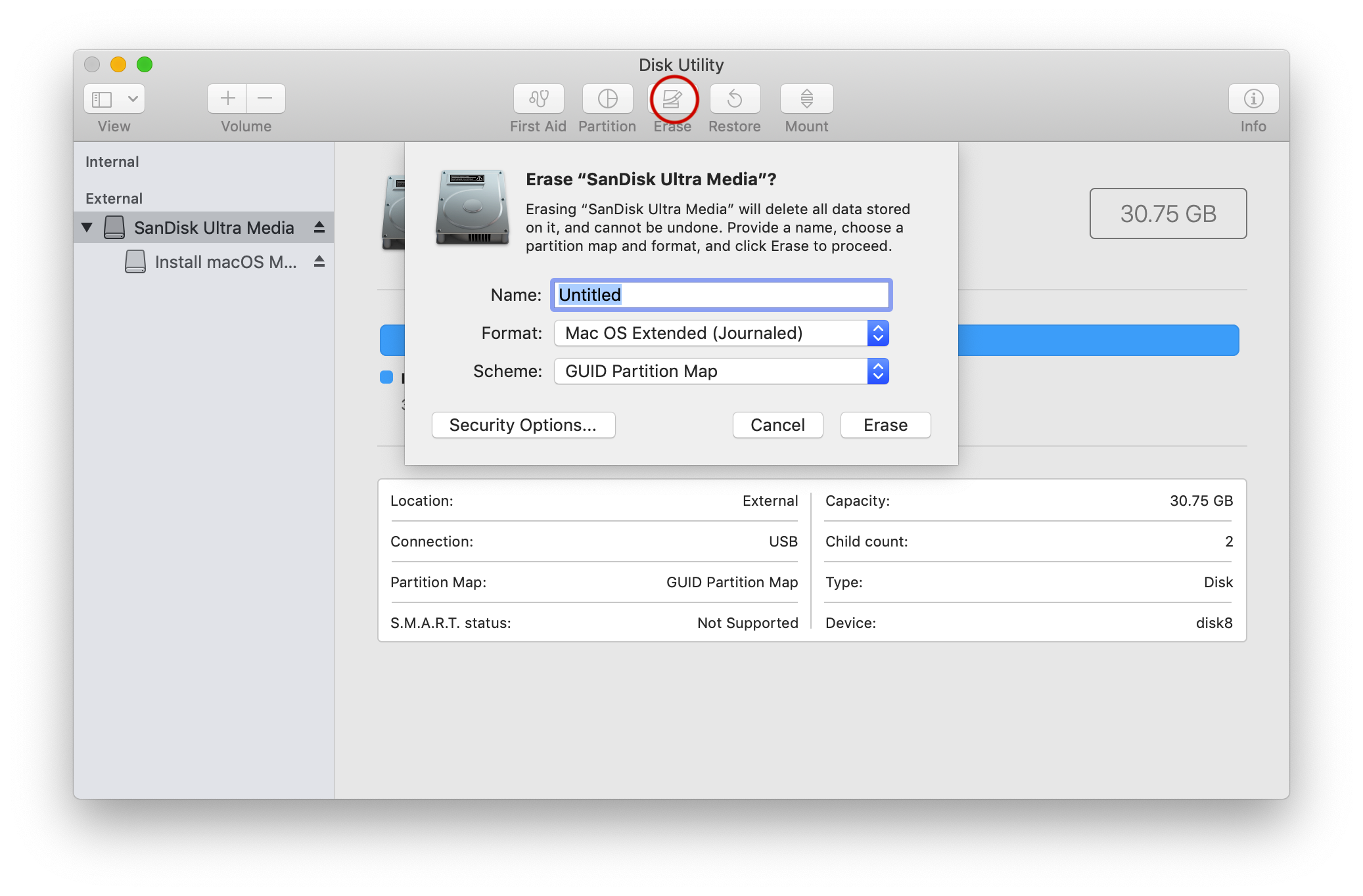

Cyberdevs Posted April 28, 2019 Share Posted April 28, 2019 Dual booting windows and macOS on a single HDD/SSD usually is a bit painful but try the following steps.: 1. Make sure that the USB disk for macOS is formatted with GUID partition scheme and the disk is formatted as Mac OS X Extended (Journaled) 2. Create the USB Disk using the Creatinstallmedia method or Terminal commands 2. install the latest Clover 3. Install Clover on your macOS USB installer disk in UEFI mode unless your Laptop boots in legacy check the BIOS to make sure 4. Install macOS and then install Windows (That's how I used to install macOS and Windows on a single HDD/SSD) 5. Make sure that you have the correct Config and Kexts in EFI folder in USB disk. For more info you can use the following link on osxlatitude.com Link to comment https://www.insanelymac.com/forum/topic/338539-acer-es1-572-laptop-hackintosh/#findComment-2671766 Share on other sites More sharing options...

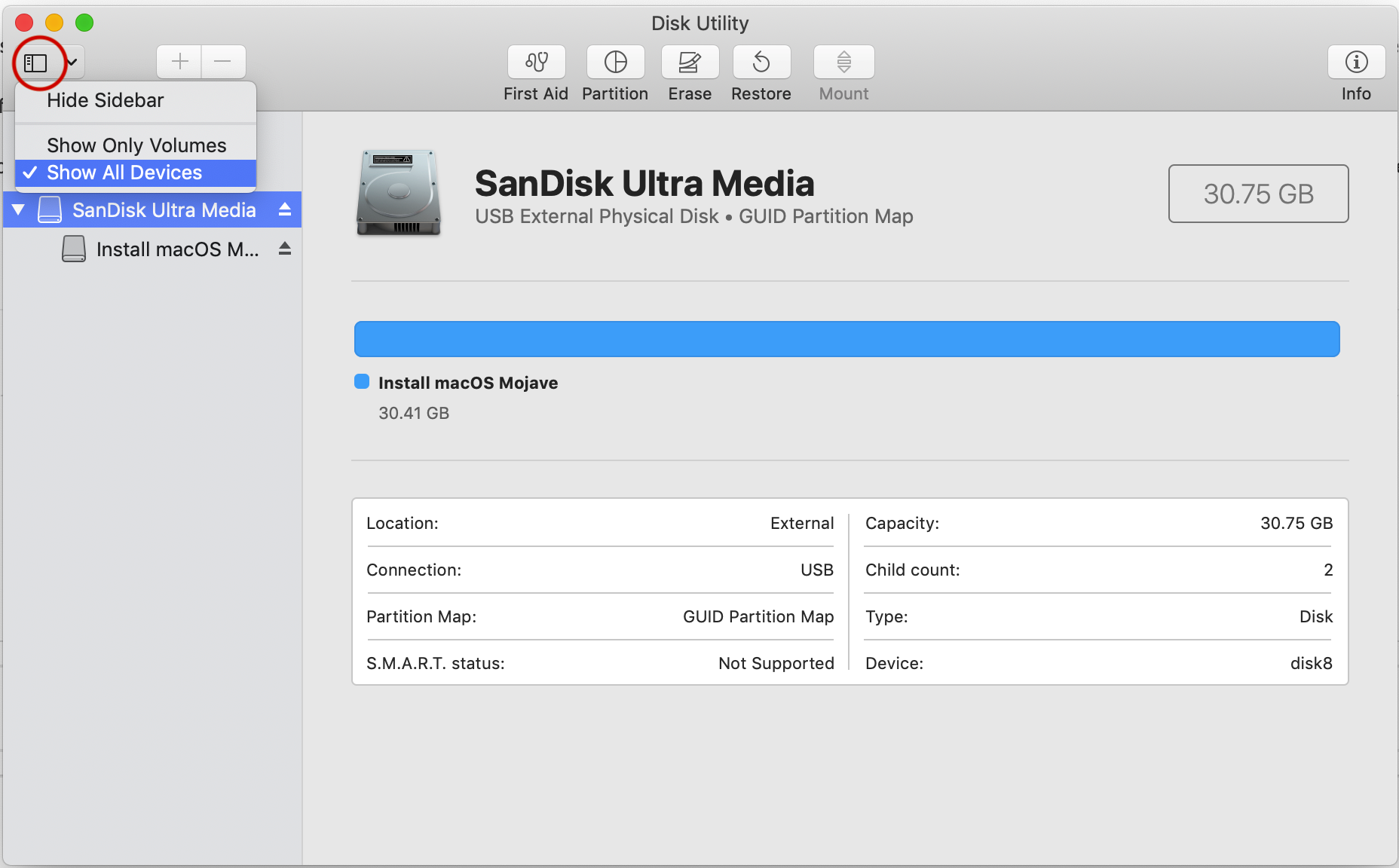

Cyberdevs Posted April 29, 2019 Share Posted April 29, 2019 Well for formatting the USB disk you can follow these instructions: (if you haven't found it already) 1. Open Disk Utility 2. Click on the small icons on the left like in the picture: 3. Select Show All Devices 4. Select the name of the USB disk vendor (In my case it's a SanDisk Ultra....) 5. Then you can use the Erase Button to erase the disk and change the Partition Scheme like in the picture below: Once that's done you are ready to use the Creatinstallmedia command. As far as I know the Createinstallmedia command doesn't change the partition scheme so if you partition it in MBR it won't be changed to GPT to GUID, the command will erase the existing partition and then copy the installer files into it. 1 Link to comment https://www.insanelymac.com/forum/topic/338539-acer-es1-572-laptop-hackintosh/#findComment-2671887 Share on other sites More sharing options...

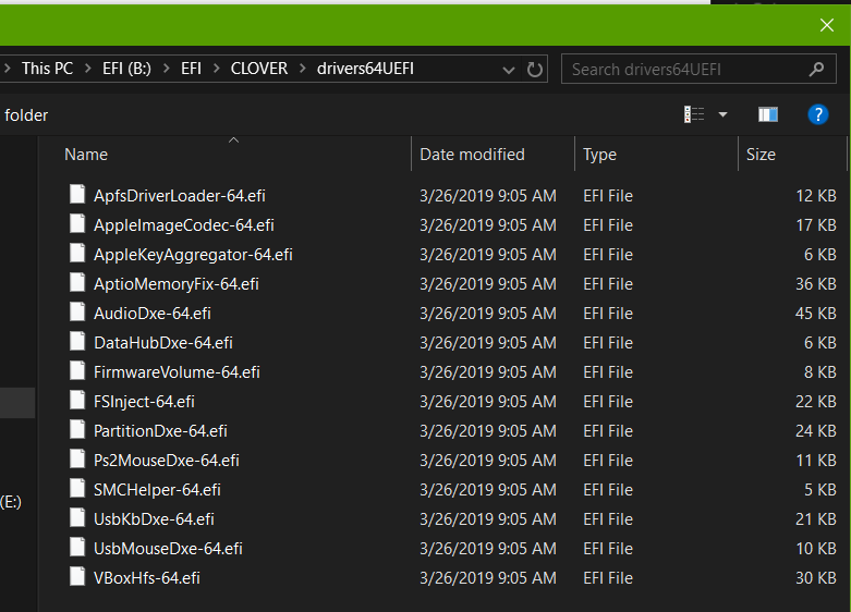

Ace2213 Posted April 30, 2019 Author Share Posted April 30, 2019 (edited) Update: I repeated the Rufus process except with MBR/UEFI instead of GPT/UEFI like I had previously done and now I was able to access the drive. So I manually installed all the drivers and kexts I could, and now Clover shows my Mojave installation! among other boot option. However it doesn't boot into it. I select it and it goes to boot but it stops soon after and then it just restarts. With boot argument - V, I'm unable to catch what it says. Upon reboot, it shows some lines above the Acer logo that I am able to read, but don't seem to contain anything critical. The same thing happens when choosing recovery and filevault. Choosing prebooter gives me a blocked/forbidden symbol and then just freezes there until I manually reboot. Edited April 30, 2019 by Ace2213 Link to comment https://www.insanelymac.com/forum/topic/338539-acer-es1-572-laptop-hackintosh/#findComment-2671967 Share on other sites More sharing options...

Ace2213 Posted May 1, 2019 Author Share Posted May 1, 2019 (edited) 18 hours ago, Cyberdevs said: You can use the "Gear icon" or the "Option" in clover's GUI before you boot into macOS to adjust the setting temporarily the changes won't be added to the config.plist though. For adding the permanent changes you need to either use Clover Configurator or TextEdit or any other plist editor apps. I meant full-on configuring Clover, as in to emulate the function of the Clover Configurator. 17 hours ago, ricoc90 said: I always make a video recording of my screen so that if anything goes wrong, i can play back the video to see what happened. My phone's camera isn't working for some reason. I know, I have the perfect set of circumstances! I ended up performing the whole process again. Set up a macOS VM on my work computer, redownloaded the system image, reconfigured the USB flash drive with Clover and the kext. Plugged it in, hoping to bypass the install process by simply booting into the existing Mojave installation, but it failed. I then tried to reinstall macOS, but got stuck at the same point. The Clover Configuration was pretty minimal in the guide I was following this time around (basically just set some properties for igfx) so I also enabled some options to enable the injection of kexts. I couldn't find the original guide I followed with the thorough Clover Configuration. Could this be relevant? One of the boot flags I must have set in the Configurator are now causing the process to stop indefinitely so I can actually read the logs. I typed them out: Start Start OSName Start InitDeviceTree Start InitDeviceTree End InitDeviceTree Start InitMemoryConfig End InitMemoryConfig Start CheckHibernate End CheckHibernate efiboot loaded from device: Acpi< efiboot file path: \System\Library\CoreServices\boot.efi Start OpenVolume End OpenVolume Start ProcessOptions End ProcessOptions RegisterRestartDataProtocol: called. 0x79285f18 RestartData protocol installed successfully. Start SetConsoleMode End SetConsoleMode Start ReadKernelCache End ReadKernelCache Start UncompressKernelCache End UncompressKernelCache Start CalculateAdler32 End CalculateAdler32 Start LoadKernelFromStream Emd LoadKernelFromStream Start InitBootStruct root device uuid is ´ End InitBootStruct Start LoadRAMDisk End LoadRAMDisk Start FinalizeBootStruct Start RandomSeed End RandomSeed ****************************************** Edited May 1, 2019 by Ace2213 Link to comment https://www.insanelymac.com/forum/topic/338539-acer-es1-572-laptop-hackintosh/#findComment-2672069 Share on other sites More sharing options...

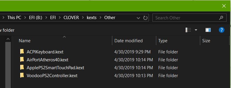

Ace2213 Posted May 1, 2019 Author Share Posted May 1, 2019 It was indeed a misconfigured Clover. I set it up correctly as per the other guide and now everything is back on track. Trackpad, keyboard, Ethernet and Wifi still don't work. Haven't gotten around to testing anything else yet but these are the main things I need to fix to at least stop relying on external mouse/keyboard/computer. I installed Clover on the SSD, copied over the config.plist file, installed a few kexts via Kext Wizard but it doesn't seem to have changed anything. I should note: 1. During the initial setup of the OS, my built-in keyboard was stuck with the down arrow key pressed (and still is, even though it's working fine in Clover). As a result, I was forced to choose "This computer does not connect to the internet". Under Network in System Preferences, I only see Bluetooth. Trying to add a PPoE connection shows a drop down menu titled "Ethernet", but clicking on it does nothing. 2. Due to the keyboard problem, I have disconnected it from the motherboard so that it doesn't interfere with usage, until I'm able to fix its Kext. 3. During boot, there's a iGPU problem that it keeps "retrying", but it eventually boots successfully. Everything is working fine though. About this Mac shows "Intel HD Graphics KBL CRB 1536MB". The memory seems about right, considering my total system memory is 4GB (another 4GB sodimm should arrive tomorrow. Hopefully vram increases accordingly automatically) 4. System performance isn't great. It's not painfully slow, but it does take a second, particularly when Finder is trying to access files on the USB drive. It doesn't seem to have hickups with my internal SSD or HDD. 5. /System/Libraries/Extensions has a TON of kexts, most of which I have no use for, including some Nvidia drivers. Now, as I understand it, macOS automatically installs/runs all kexts in that folder, right? If that's true, then I should remove most of these as to not cause conflicts. If not, I should install the ones in there that I do need. Might be helpful. Link to comment https://www.insanelymac.com/forum/topic/338539-acer-es1-572-laptop-hackintosh/#findComment-2672083 Share on other sites More sharing options...
Cyberdevs Posted May 1, 2019 Share Posted May 1, 2019 I strongly suggest to live the kexts in the Extensions folder alone don’t touch the system folder and you don’t need to install the 3rd party kext in the /S/LE you can simply add the kexts in clover’s EFI folder under /EFI/Clover/kexts/Other this way you have a vanilla MacOS and then you can easily add or remove the kext without damaging macOS. Link to comment https://www.insanelymac.com/forum/topic/338539-acer-es1-572-laptop-hackintosh/#findComment-2672092 Share on other sites More sharing options...
Ace2213 Posted May 1, 2019 Author Share Posted May 1, 2019 1 hour ago, Cyberdevs said: I strongly suggest to live the kexts in the Extensions folder alone don’t touch the system folder and you don’t need to install the 3rd party kext in the /S/LE you can simply add the kexts in clover’s EFI folder under /EFI/Clover/kexts/Other this way you have a vanilla MacOS and then you can easily add or remove the kext without damaging macOS. Ok but that's not working. Either I'm not installing kexts properly, or all of the kexts are being successfully installed but aren't working. I'm not worried about damaging macOS. I can simply reinstall it. Making my hardware work is much more important. I even tried /L/E, with some sudo commands for permissions. Nothing. It seems that my L2c touchpad will require patching the DSDT and my wifi card also requires very specific instructions to work under Mojave, but the keyboard and Ethernet kexts should work with no additional tinkering required. I really think I may have accidentally disabled all connectivity options for my device during setup. It's also not working on battery. Only on AC power. I've installed Windows on the second partition for now and will read up on DSDT patching. Link to comment https://www.insanelymac.com/forum/topic/338539-acer-es1-572-laptop-hackintosh/#findComment-2672101 Share on other sites More sharing options...

Ace2213 Posted May 1, 2019 Author Share Posted May 1, 2019 These are the kexts I've been trying to install. And these are the installed drivers, in case it's relevant. Link to comment https://www.insanelymac.com/forum/topic/338539-acer-es1-572-laptop-hackintosh/#findComment-2672105 Share on other sites More sharing options...
