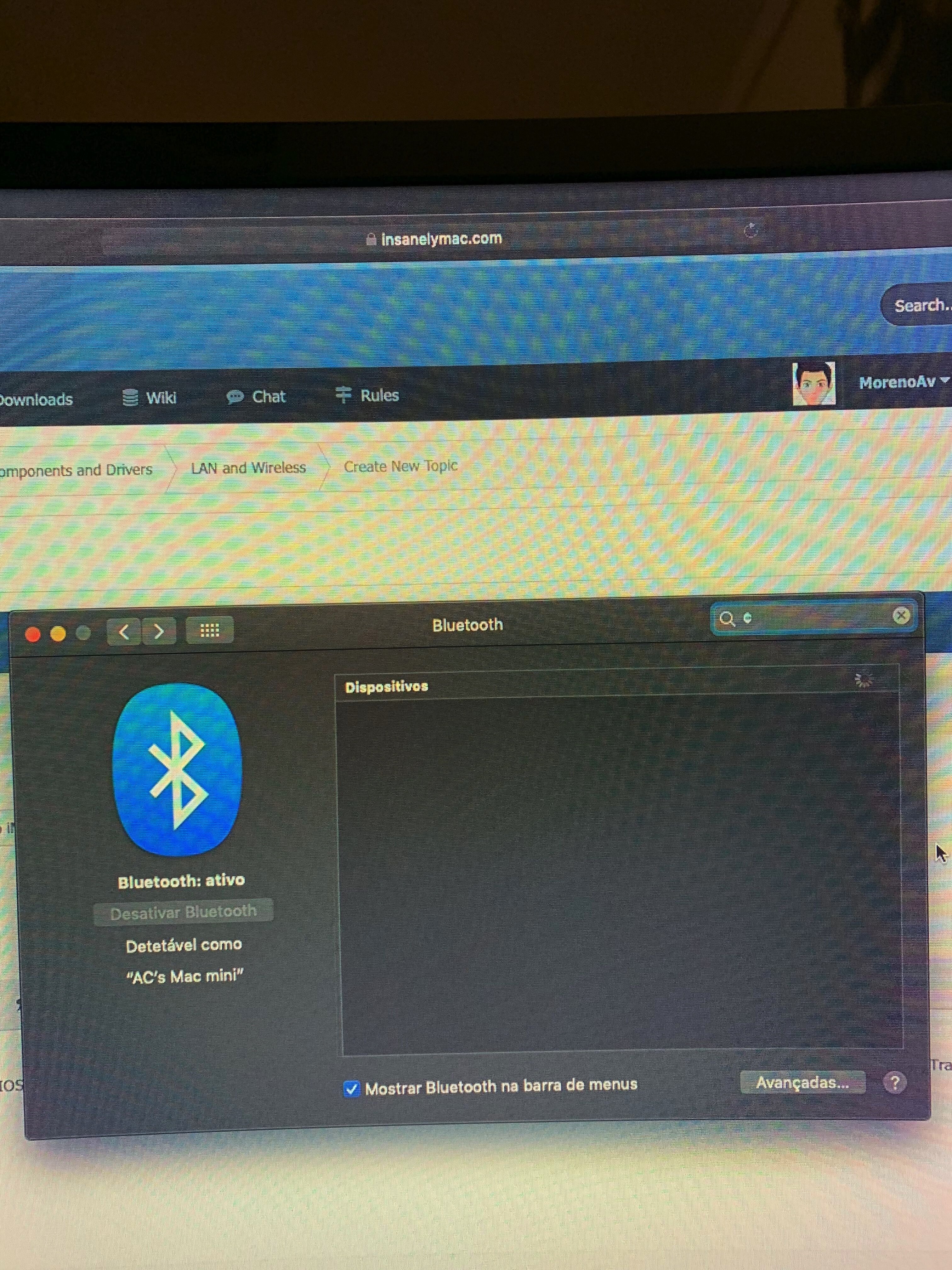

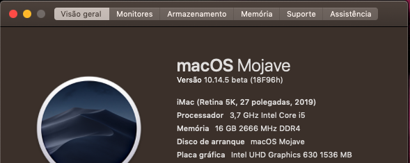

MorenoAv Posted April 5, 2019 Share Posted April 5, 2019 (edited) Good Night, Today I decided to change the SMBIOS to the new one iMac 19,2, from macmini 8,1 and all is well except from the fact that I lost my bluetooth and for that reason my Trackpad, Magic Mouse and Magic Keyboard, doesn't work. Could someone help me CLOVER.zip Edited April 5, 2019 by MorenoAv Link to comment Share on other sites More sharing options...

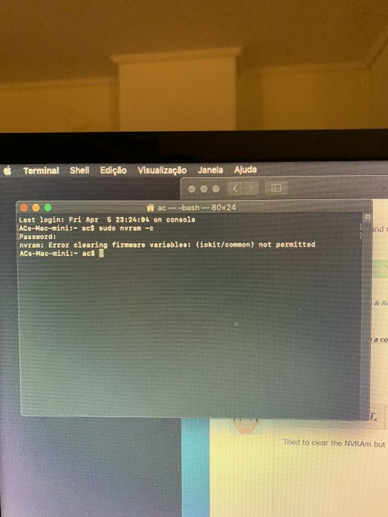

MorenoAv Posted April 5, 2019 Author Share Posted April 5, 2019 Tried to clear the NVRAm but it didn't work as you can see in the photo... Link to comment Share on other sites More sharing options...
pico joe Posted April 5, 2019 Share Posted April 5, 2019 Rev 4299Support Reset NVRAM with F11 in Clover GUI. 1 Link to comment Share on other sites More sharing options...
MorenoAv Posted April 6, 2019 Author Share Posted April 6, 2019 Hi @pico joe, thanks for your suggestion but where do I find clover Rev 4299 ? Link to comment Share on other sites More sharing options...
pico joe Posted April 6, 2019 Share Posted April 6, 2019 its mean from > rev 4299 .. clover has feature nvram resetter .. Link to comment Share on other sites More sharing options...
MorenoAv Posted April 6, 2019 Author Share Posted April 6, 2019 I tried that and it didn't work... thanks anyway Link to comment Share on other sites More sharing options...

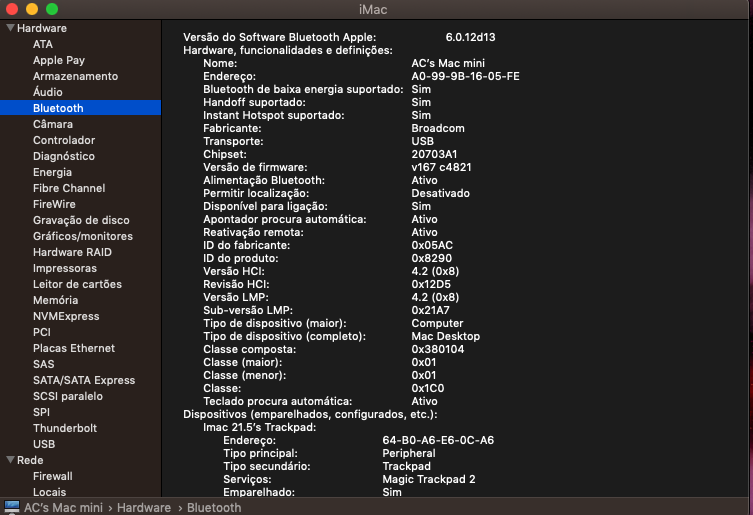

telepati Posted April 6, 2019 Share Posted April 6, 2019 (edited) Delete com.apple.Bluetooth.plist from /Macintosh HD/Library/Preferences and restart. Also, you can try these; Hold down the Shift and Option keys, and then click the Bluetooth menu item. Once the menu is displayed, you can release the Shift and Option keys. The drop-down menu will be different, now showing a few hidden items. Select Debug, Remove all devices. Now that the Bluetooth device table is cleared out, we can reset the Bluetooth system. Hold down the Shift and Option keys once again, and click on the Bluetooth menu. Select Debug, Reset the Bluetooth Module. Edited April 6, 2019 by telepati 1 Link to comment Share on other sites More sharing options...
MorenoAv Posted April 6, 2019 Author Share Posted April 6, 2019 Thanks @telepati, I solved the issue, going back to Mac mini 8,1, and now my bluetooth and wifi work again, I don't know why because the cpu is equal in Mac mini 8,1 and iMac 19,2, but what matters right now is that all works again... Thanks to all of you that helped... 1 Link to comment Share on other sites More sharing options...

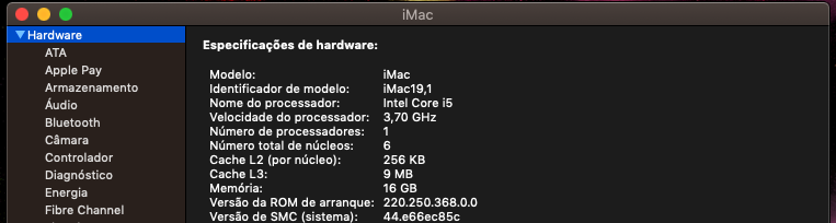

MorenoAv Posted April 7, 2019 Author Share Posted April 7, 2019 Hi guys, It's only to tell you all that after going back to macmini 8.1 yesterday and solving my bluetooth problems, this morning I changed one more time the SMBIOS to 19,1 and this time I solved my boot but the bluetooth problem with the mentioned SMBIOS. Cheers 2 Link to comment Share on other sites More sharing options...
Blu3Box Posted September 2, 2019 Share Posted September 2, 2019 I had the same problem, found the solution by updating usb_inject_all kext to the latest that supports 19.x Link to comment Share on other sites More sharing options...
