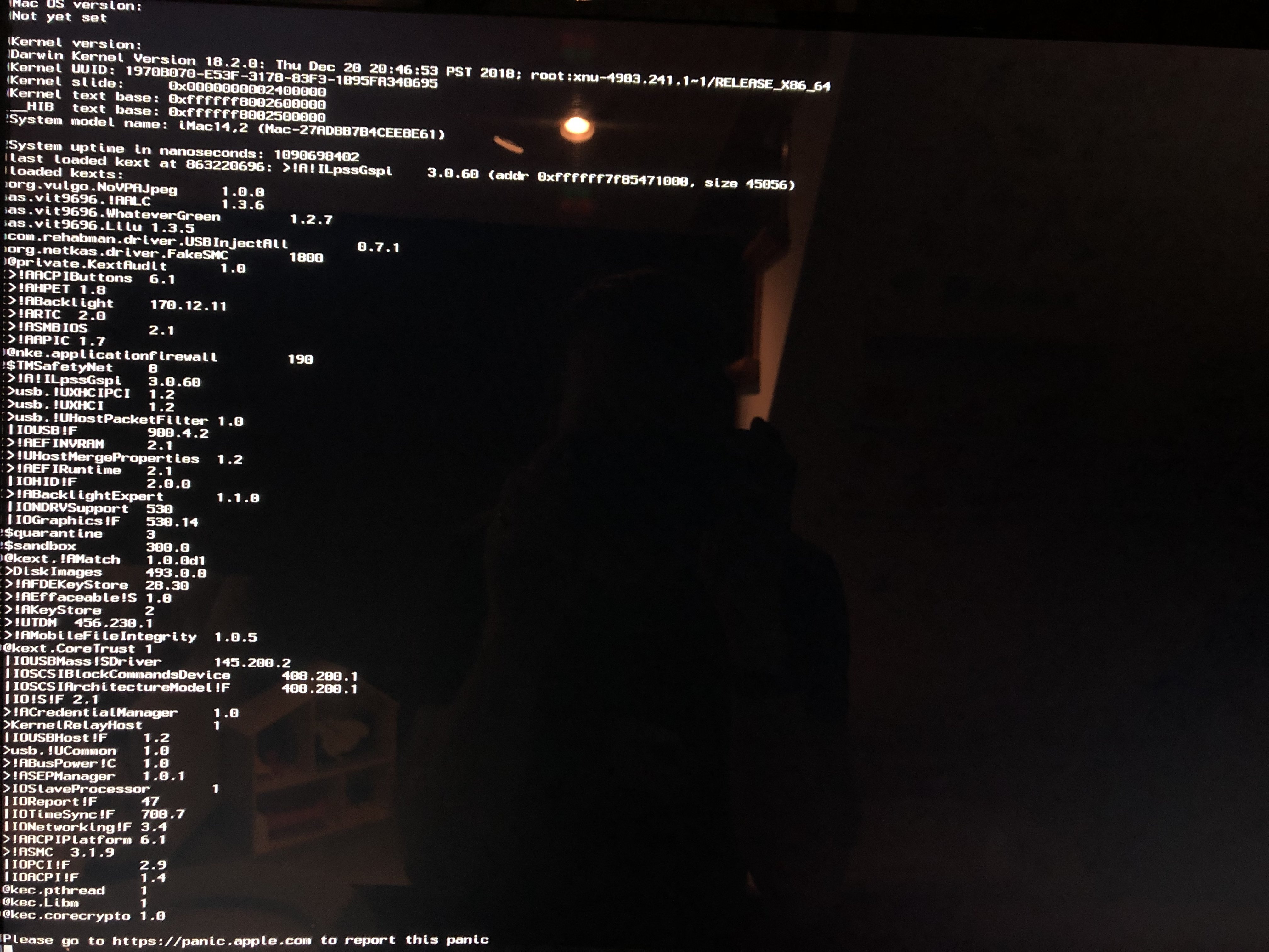

licorice_whip Posted March 23, 2019 Author Share Posted March 23, 2019 Hey @MaLd0n, thanks, I added the USB entries and have USB 3 working. Now the only issue I'm having is that the computer sometimes has a kernel panic when attempting to sleep. Half the time it sleeps and wakes up fine, but the other half it seems to wake up when I push the power button, but nothing comes up on the screen. When I reboot in verbose mode, it says it rebooted from a kernel panic. Any pointers? Thank you for everything! Link to comment https://www.insanelymac.com/forum/topic/337931-gigabyte-z87x-ud4h-with-i7-4770k/#findComment-2667769 Share on other sites More sharing options...
MaLd0n Posted March 23, 2019 Share Posted March 23, 2019 9 minutes ago, licorice_whip said: Hey @MaLd0n, thanks, I added the USB entries and have USB 3 working. Now the only issue I'm having is that the computer sometimes has a kernel panic when attempting to sleep. Half the time it sleeps and wakes up fine, but the other half it seems to wake up when I push the power button, but nothing comes up on the screen. When I reboot in verbose mode, it says it rebooted from a kernel panic. Any pointers? Thank you for everything! post one photo with -v Link to comment https://www.insanelymac.com/forum/topic/337931-gigabyte-z87x-ud4h-with-i7-4770k/#findComment-2667770 Share on other sites More sharing options...
licorice_whip Posted March 23, 2019 Author Share Posted March 23, 2019 This is what the error report shows... does this have any useful information? Anonymous UUID: 7AF5B311-D0C3-2754-53B0-6FF1488259C7 Sat Mar 23 12:00:36 2019 *** Panic Report *** panic(cpu 7 caller 0xffffff801de01e33): "a freed zone element has been modified in zone kalloc.48: expected 0xdeadbeefdeadbeef but found 0xdeadbeefccadbeef, bits changed 0x12000000, at offset 8 of 48 in element 0xffffff8061991810, cookies 0x3f0011af7944a812 0x53521dfe04c4305"@/BuildRoot/Library/Caches/com.apple.xbs/Sources/xnu/xnu-4903.241.1/osfmk/kern/zalloc.c:1168 Backtrace (CPU 7), Frame : Return Address 0xffffff8204d9b960 : 0xffffff801ddaeb0d 0xffffff8204d9b9b0 : 0xffffff801dee8653 0xffffff8204d9b9f0 : 0xffffff801deda07a 0xffffff8204d9ba60 : 0xffffff801dd5bca0 0xffffff8204d9ba80 : 0xffffff801ddae527 0xffffff8204d9bba0 : 0xffffff801ddae373 0xffffff8204d9bc10 : 0xffffff801de01e33 0xffffff8204d9bd60 : 0xffffff801ddbb0c4 0xffffff8204d9bdd0 : 0xffffff801e3c6b07 0xffffff8204d9be00 : 0xffffff801e3ca334 0xffffff8204d9be20 : 0xffffff801e41e475 0xffffff8204d9be40 : 0xffffff801e4234da 0xffffff8204d9be80 : 0xffffff801e42c00d 0xffffff8204d9bf00 : 0xffffff801e42bcb7 0xffffff8204d9bf50 : 0xffffff801e42d786 0xffffff8204d9bfa0 : 0xffffff801dd5b0ce BSD process name corresponding to current thread: kernel_task Boot args: dart=0 debug=0x100 shikigva=60 Mac OS version: 18D109 Kernel version: Darwin Kernel Version 18.2.0: Thu Dec 20 20:46:53 PST 2018; root:xnu-4903.241.1~1/RELEASE_X86_64 Kernel UUID: 1970B070-E53F-3178-83F3-1B95FA340695 Kernel slide: 0x000000001da00000 Kernel text base: 0xffffff801dc00000 __HIB text base: 0xffffff801db00000 System model name: iMac14,2 (Mac-27ADBB7B4CEE8E61) System uptime in nanoseconds: 5248223819221 last loaded kext at 245582763616: com.apple.filesystems.msdosfs 1.10 (addr 0xffffff7fa2bd2000, size 69632) last unloaded kext at 305787159340: com.apple.filesystems.msdosfs 1.10 (addr 0xffffff7fa2bd2000, size 61440) loaded kexts: at.obdev.nke.LittleSnitch 5267 com.insanelymac.IntelMausiEthernet 2.4.1d1 org.vulgo.NoVPAJpeg 1.0.0 as.vit9696.AppleALC 1.3.6 as.vit9696.WhateverGreen 1.2.7 as.vit9696.Lilu 1.3.5 com.rehabman.driver.USBInjectAll 0.7.1 org.netkas.driver.FakeSMC 1800 com.apple.fileutil 18.306.12 com.apple.filesystems.autofs 3.0 com.apple.driver.AppleTopCaseHIDEventDriver 138.2 com.apple.driver.AGPM 110.23.46 com.apple.driver.ApplePlatformEnabler 2.7.0d0 com.apple.driver.AppleMikeyHIDDriver 131 com.apple.driver.X86PlatformShim 1.0.0 com.apple.driver.AppleUpstreamUserClient 3.6.5 com.apple.driver.AppleMCCSControl 1.5.6 com.apple.kext.AMDFramebuffer 2.0.4 com.apple.driver.AppleGFXHDA 100.1.40 com.apple.driver.AppleOSXWatchdog 1 com.apple.kext.AMDRadeonX4000 2.0.4 com.apple.AGDCPluginDisplayMetrics 3.28.4 com.apple.driver.AppleHV 1 com.apple.iokit.IOUserEthernet 1.0.1 com.apple.driver.AppleMikeyDriver 282.10 com.apple.iokit.IOBluetoothSerialManager 6.0.10f1 com.apple.driver.pmtelemetry 1 com.apple.Dont_Steal_Mac_OS_X 7.0.0 com.apple.kext.AMD9500Controller 2.0.4 com.apple.driver.AppleLPC 3.1 com.apple.driver.AppleSMCLMU 212 com.apple.driver.AppleIntelSlowAdaptiveClocking 4.0.0 com.apple.filesystems.apfs 945.241.4 com.apple.driver.AppleVirtIO 2.1.3 com.apple.filesystems.hfs.kext 407.200.4 com.apple.AppleFSCompression.AppleFSCompressionTypeDataless 1.0.0d1 com.apple.BootCache 40 com.apple.AppleFSCompression.AppleFSCompressionTypeZlib 1.0.0 com.apple.AppleSystemPolicy 1.0 com.apple.driver.AirPort.BrcmNIC 1400.1.1 com.apple.driver.AppleAHCIPort 329.200.2 com.apple.private.KextAudit 1.0 com.apple.driver.AppleHPET 1.8 com.apple.driver.AppleACPIButtons 6.1 com.apple.driver.AppleBacklight 170.12.11 com.apple.driver.AppleRTC 2.0 com.apple.driver.AppleSMBIOS 2.1 com.apple.driver.AppleAPIC 1.7 com.apple.nke.applicationfirewall 190 com.apple.security.TMSafetyNet 8 com.apple.driver.AppleHIDKeyboard 208 com.apple.kext.triggers 1.0 com.apple.driver.AppleMultitouchDriver 2410.5 com.apple.driver.AppleInputDeviceSupport 2410.2 com.apple.driver.AppleHSBluetoothDriver 138.2 com.apple.driver.IOBluetoothHIDDriver 6.0.10f1 com.apple.kext.AMDRadeonX4000HWLibs 1.0 com.apple.iokit.IOAcceleratorFamily2 404.2.2 com.apple.kext.AMDRadeonX4000HWServices 2.0.4 com.apple.iokit.IOAVBFamily 710.1 com.apple.plugin.IOgPTPPlugin 700.7 com.apple.iokit.IOEthernetAVBController 1.1.0 com.apple.driver.AppleSSE 1.0 com.apple.iokit.IOSurface 255.1 com.apple.driver.AppleSMBusController 1.0.18d1 com.apple.iokit.IOSMBusFamily 1.1 com.apple.AppleGPUWrangler 3.28.4 com.apple.driver.AppleSMBusPCI 1.0.14d1 com.apple.driver.X86PlatformPlugin 1.0.0 com.apple.driver.IOPlatformPluginFamily 6.0.0d8 com.apple.kext.AMDSupport 2.0.4 com.apple.AppleGraphicsDeviceControl 3.28.4 com.apple.iokit.IOSlowAdaptiveClockingFamily 1.0.0 com.apple.iokit.IOUSBHIDDriver 900.4.2 com.apple.iokit.BroadcomBluetoothHostControllerUSBTransport 6.0.10f1 com.apple.iokit.IOBluetoothHostControllerUSBTransport 6.0.10f1 com.apple.iokit.IOBluetoothHostControllerTransport 6.0.10f1 com.apple.iokit.IOBluetoothFamily 6.0.10f1 com.apple.driver.AppleUSBAudio 315.6 com.apple.driver.usb.IOUSBHostHIDDevice 1.2 com.apple.iokit.IOAudioFamily 206.5 com.apple.vecLib.kext 1.2.0 com.apple.driver.usb.networking 5.0.0 com.apple.driver.usb.AppleUSBHostCompositeDevice 1.2 com.apple.driver.usb.AppleUSBHub 1.2 com.apple.iokit.IOAHCIBlockStorage 301.200.2 com.apple.iokit.IOSerialFamily 11 com.apple.filesystems.hfs.encodings.kext 1 com.apple.iokit.IO80211Family 1200.12.2 com.apple.driver.mDNSOffloadUserClient 1.0.1b8 com.apple.driver.corecapture 1.0.4 com.apple.iokit.IOAHCIFamily 288 com.apple.driver.usb.AppleUSBXHCIPCI 1.2 com.apple.driver.usb.AppleUSBXHCI 1.2 com.apple.driver.usb.AppleUSBHostPacketFilter 1.0 com.apple.iokit.IOUSBFamily 900.4.2 com.apple.driver.AppleUSBHostMergeProperties 1.2 com.apple.driver.AppleEFINVRAM 2.1 com.apple.driver.AppleEFIRuntime 2.1 com.apple.iokit.IOHIDFamily 2.0.0 com.apple.driver.AppleBacklightExpert 1.1.0 com.apple.iokit.IONDRVSupport 530 com.apple.iokit.IOGraphicsFamily 530.14 com.apple.security.quarantine 3 com.apple.security.sandbox 300.0 com.apple.kext.AppleMatch 1.0.0d1 com.apple.driver.DiskImages 493.0.0 com.apple.driver.AppleFDEKeyStore 28.30 com.apple.driver.AppleEffaceableStorage 1.0 com.apple.driver.AppleKeyStore 2 com.apple.driver.AppleUSBTDM 456.230.1 com.apple.driver.AppleMobileFileIntegrity 1.0.5 com.apple.kext.CoreTrust 1 com.apple.iokit.IOUSBMassStorageDriver 145.200.2 com.apple.iokit.IOSCSIBlockCommandsDevice 408.200.1 com.apple.iokit.IOSCSIArchitectureModelFamily 408.200.1 com.apple.iokit.IOStorageFamily 2.1 com.apple.driver.AppleCredentialManager 1.0 com.apple.driver.KernelRelayHost 1 com.apple.iokit.IOUSBHostFamily 1.2 com.apple.driver.usb.AppleUSBCommon 1.0 com.apple.driver.AppleBusPowerController 1.0 com.apple.driver.AppleSEPManager 1.0.1 com.apple.driver.IOSlaveProcessor 1 com.apple.iokit.IOReportFamily 47 com.apple.iokit.IOTimeSyncFamily 700.7 com.apple.iokit.IONetworkingFamily 3.4 com.apple.driver.AppleACPIPlatform 6.1 com.apple.driver.AppleSMC 3.1.9 com.apple.iokit.IOPCIFamily 2.9 com.apple.iokit.IOACPIFamily 1.4 com.apple.kec.pthread 1 com.apple.kec.Libm 1 com.apple.kec.corecrypto 1.0 EOF Model: iMac14,2, BootROM 133.0.0.0.0, 4 processors, Intel Core i7, 3.49 GHz, 16 GB, SMC 2.15f7 Graphics: Radeon Pro 580, AMD Radeon Pro 580, PCIe Memory Module: BANK 0/DIMM1, 8 GB, DDR3, 1866 MHz, Crucial Technology, BLT8G3D1869DT1TX0. Memory Module: BANK 1/DIMM1, 8 GB, DDR3, 1866 MHz, Crucial Technology, BLT8G3D1869DT1TX0. AirPort: spairport_wireless_card_type_airport_extreme (0x14E4, 0x111), Broadcom BCM43xx 1.0 (7.77.61.1 AirPortDriverBrcmNIC-1305.2) Bluetooth: Version 6.0.10f1, 3 services, 27 devices, 1 incoming serial ports Network Service: Wi-Fi, AirPort, en1 PCI Card: Intel Corporation, Series Chipset USB xHCI Host Controller, USB Controller, Built In PCI Card: Intel Corporation, Series Chipset MEI Controller, IMEI Controller, Built In PCI Card: Intel PCI Express Gigabit Ethernet, Ethernet Controller, Built In PCI Card: AMD Radeon Pro 580, Display Controller, PCIe PCI Card: Intel Corporation, Series Chipset SATA Controller, AHCI Controller, Built In PCI Card: Apple SATA Controller, SATA Controller, Built In PCI Card: Broadcom BCM43xx Wireless Network Adapter, AirPort Extreme, Built In Serial ATA Device: Samsung SSD 840 EVO 250GB, 250.06 GB USB Device: USB 3.0 Bus USB Device: Hub USB Device: Hub USB Device: Mobius USB Device: Hub USB Device: Hub USB Device: Scarlett 2i2 USB USB Device: BRCM20702 Hub USB Device: Bluetooth USB Host Controller USB Device: USB Receiver Thunderbolt Bus: Link to comment https://www.insanelymac.com/forum/topic/337931-gigabyte-z87x-ud4h-with-i7-4770k/#findComment-2667779 Share on other sites More sharing options...
licorice_whip Posted March 23, 2019 Author Share Posted March 23, 2019 (edited) Here's a photo of the panic: Edited March 23, 2019 by licorice_whip Link to comment https://www.insanelymac.com/forum/topic/337931-gigabyte-z87x-ud4h-with-i7-4770k/#findComment-2667784 Share on other sites More sharing options...
