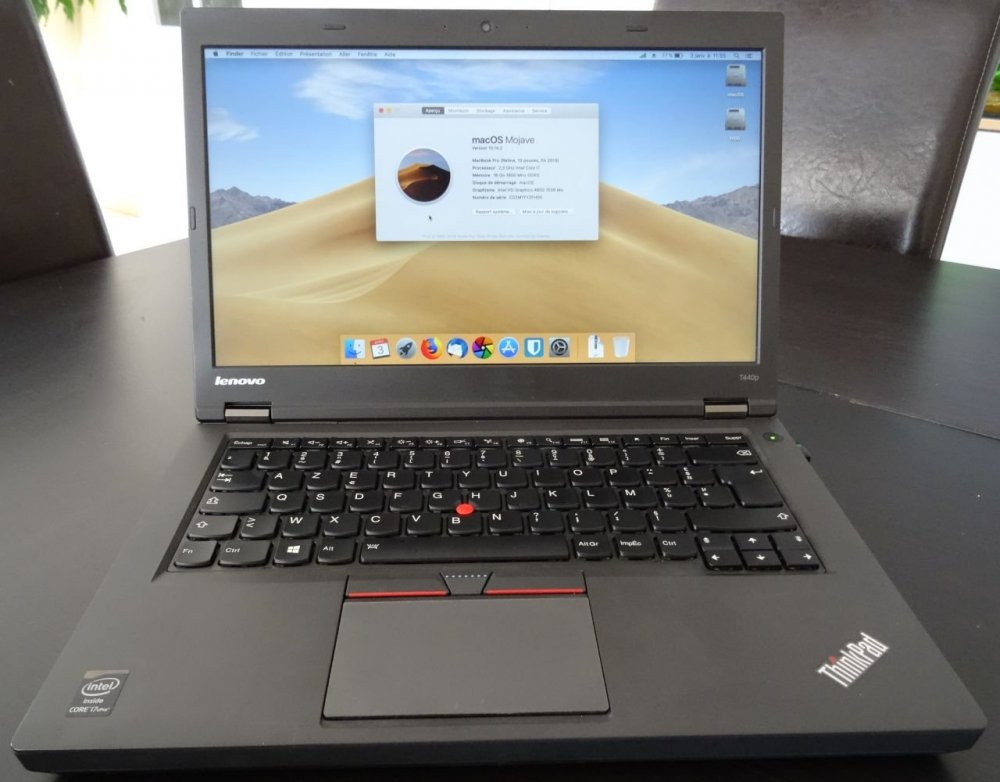

vanadium Posted January 4, 2019 Share Posted January 4, 2019 (edited) Lenovo Thinkpad T440p Hackintosh (Tested on High Sierra 10.13.6 and Mojave 10.14.3) Latest Release 2019-06-18 No problem with MacOS Mojave 10.14.5 2019-01-23 MacOS Mojave 10.14.3 works fine! Upgraded from Mojave 10.14.2 without any issue. After update, I just had to rebuild kexts cache: sudo kextcache -i / Tutorial The zip file contains everything you need to have a Thinkpad T440p Hackintosh work flawlessly: - Brightness control (with keyboard shortcuts), - HD4600 graphical acceleration (QE/CI), - power management (sleep, CPU thermal control), - secondary HDD in ultrabay, (requires AHCI kexts in `/Library/Extensions`) - Audio (internal speakers ok, but 3.5mm jack not working) - T450 Trackpad driver from T460 guide written by @tluck - Intel Ethernet controller, - USB ports custom mapping, - Wifi using TP-Link wn725n USB Adapter (much cheaper than Broadcom mini-pci cards), - and battery management. I initially followed the guide provided on TonyMacX86, but it was sadly a bit out of date. So I worked a couple of days on it to use the latest kexts and config.plist settings available. It runs very well on mine with the following configuration: - Intel Core I7 4712MQ, - Motherboard with HD4600 only (but the patched SSDT automatically disables the Nvidia GT730M if any found) - 16GB RAM Samsung Sodimm DDR3L 1600Mhz, - 2.5 inches Western Digital Blue 500GB SSD in primary SATA bay, (TRIM enabled forcefully using Terminal) - 2.5 inches Western Digital Blue 1TB HDD in ultrabay (replaces the optical drive), - Synaptics T450 Trackpad, - FullHD (1920x1080) IPS Panel. A french guide is available here: Thinkpad T440p Hackintosh Edited June 18, 2019 by vanadium 2 Link to comment https://www.insanelymac.com/forum/topic/337099-guide-thinkpad-t440p-mojave-1014x/ Share on other sites More sharing options...

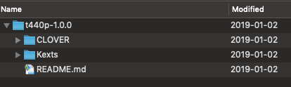

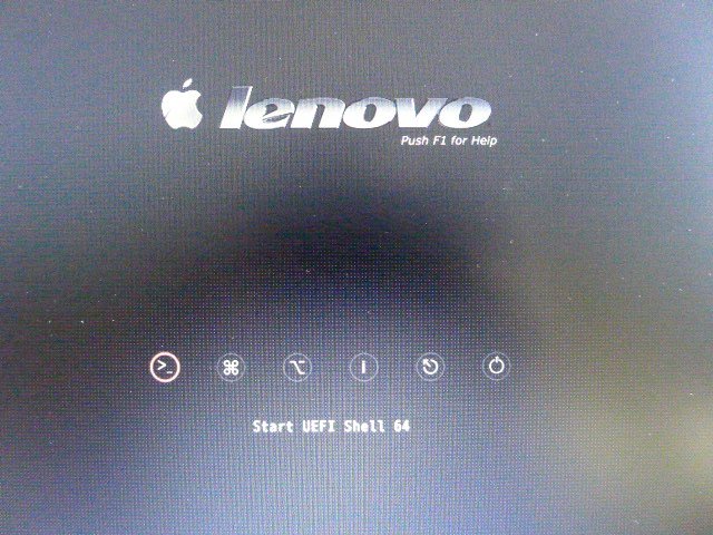

gwn Posted January 14, 2019 Share Posted January 14, 2019 (edited) Hello, Noticed the Boot folder is not included in the zip only Clover. Could you please check and add. Many thanks, Art Edited January 15, 2019 by gwn Fix image Link to comment https://www.insanelymac.com/forum/topic/337099-guide-thinkpad-t440p-mojave-1014x/#findComment-2658998 Share on other sites More sharing options...
gwn Posted January 14, 2019 Share Posted January 14, 2019 I created a Mojave Install usb drive then mounted EFI partition and created EFI folder with your Clover folder. Next I copied Boot folder from my own EFI folder on a T430 with Mojave. When I booted the usb on T440p the boot menu appeared with Clover options but the actual Install Mojave was not visible. Would you mind checking this as well. Link to comment https://www.insanelymac.com/forum/topic/337099-guide-thinkpad-t440p-mojave-1014x/#findComment-2659005 Share on other sites More sharing options...
gwn Posted January 15, 2019 Share Posted January 15, 2019 I may have narrowed the problem down to the files in Drivers64UEFI folder. Your files are ApfsDriverLoader-64.efi AppleImageLoader-64.efi AppleUISupport-64.efi AptioInputFix-64.efi AptioMemoryFix-64.efi DataHubDxe-64.efi FSInject-64.efi SMCHelper-64.efi When I substituted my T430 files the USB volume finally appeared in the boot. They are FSInject-64.efi HFSPlus-64.efi NTFS-64.efi OsxAptioFix2Drv-64.efi OsxFatBinaryDrv-64.efi SMCHelper-64.efi apfs.efi Now booting the Mojave Install option it reaches the Mac OS Install menu and when I tried to install to the hard drive it progresses to two minutes left then screen blanks out and reboots back to the Clover menu. Note the hard drive was initialized with Mac OS Extended (Journaled) and GUID partition. Link to comment https://www.insanelymac.com/forum/topic/337099-guide-thinkpad-t440p-mojave-1014x/#findComment-2659061 Share on other sites More sharing options...
gwn Posted January 16, 2019 Share Posted January 16, 2019 Stupid me. It was caused by HFSPlus-64.efi being omitted. Link to comment https://www.insanelymac.com/forum/topic/337099-guide-thinkpad-t440p-mojave-1014x/#findComment-2659216 Share on other sites More sharing options...
vanadium Posted January 17, 2019 Author Share Posted January 17, 2019 Right, I have included the Apfs driver but not the HFS one (as most install on SSD which is going to be converted to APFS by MacOs Mojave anyway). I'm going to include the boot folder too, thanks! Link to comment https://www.insanelymac.com/forum/topic/337099-guide-thinkpad-t440p-mojave-1014x/#findComment-2659555 Share on other sites More sharing options...

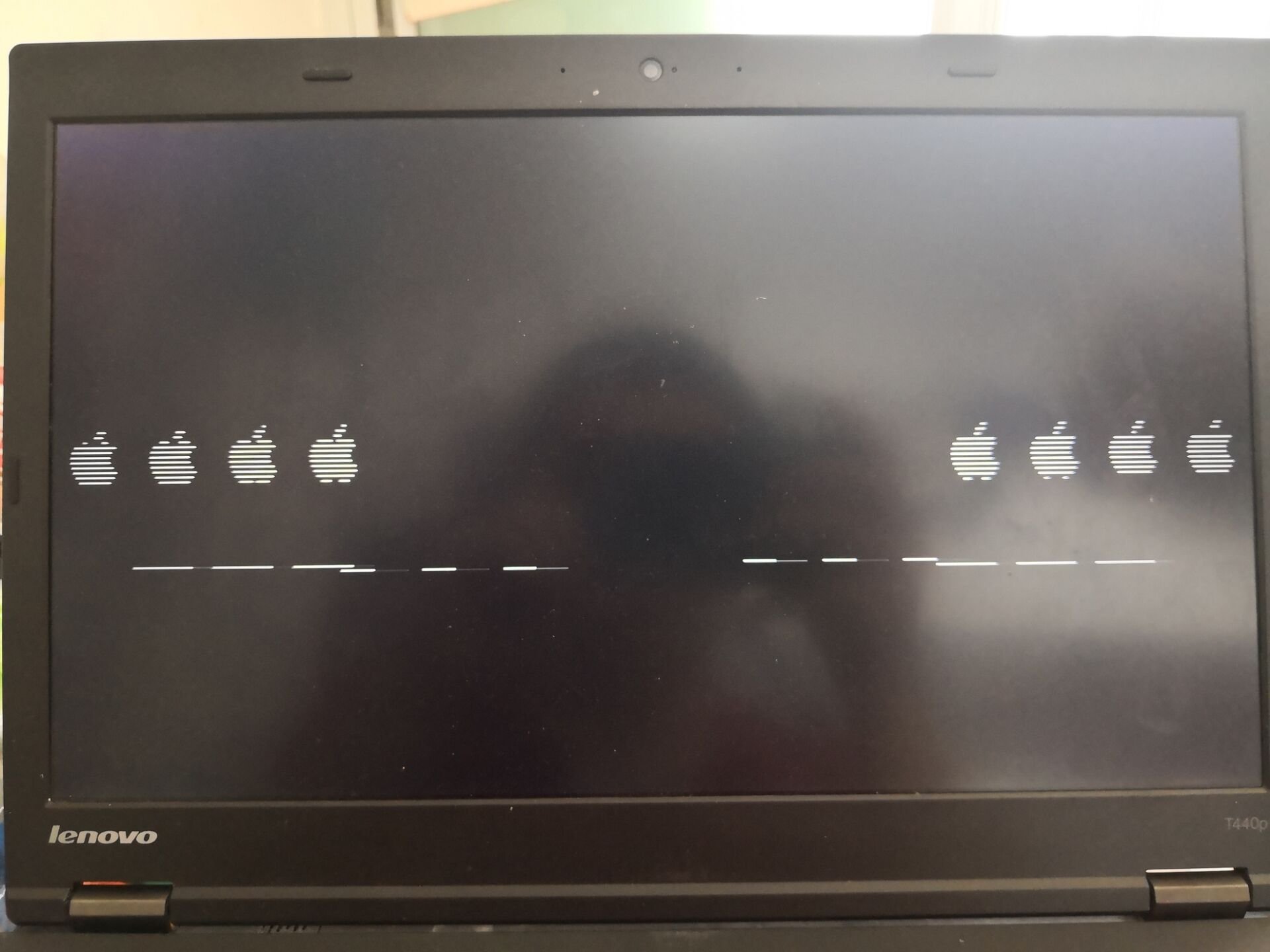

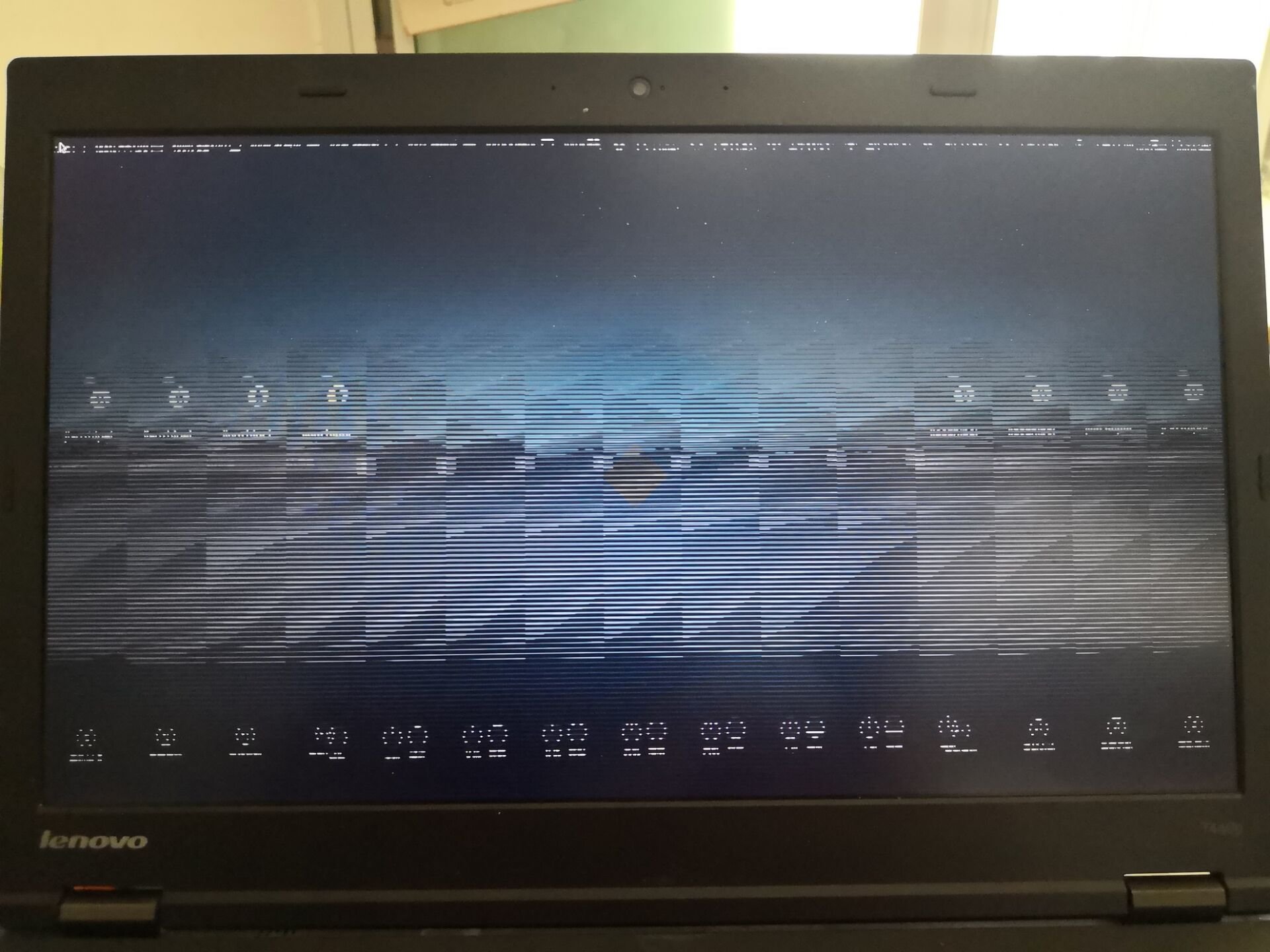

p369029292 Posted February 16, 2019 Share Posted February 16, 2019 Using the clover you installed on github, the screen will display 8 apples when starting up. Do you have any Suggestions? thx Link to comment https://www.insanelymac.com/forum/topic/337099-guide-thinkpad-t440p-mojave-1014x/#findComment-2664197 Share on other sites More sharing options...
vanadium Posted February 25, 2019 Author Share Posted February 25, 2019 Strange, what's your hardware / software configuration? Which OS version? Link to comment https://www.insanelymac.com/forum/topic/337099-guide-thinkpad-t440p-mojave-1014x/#findComment-2665331 Share on other sites More sharing options...
testubabe Posted February 25, 2019 Share Posted February 25, 2019 On 2/16/2019 at 5:07 AM, p369029292 said: Using the clover you installed on github, the screen will display 8 apples when starting up. Do you have any Suggestions? thx BIOS options ? UEFI only , cms support enabled, boot with fingers crossed :-) Link to comment https://www.insanelymac.com/forum/topic/337099-guide-thinkpad-t440p-mojave-1014x/#findComment-2665335 Share on other sites More sharing options...

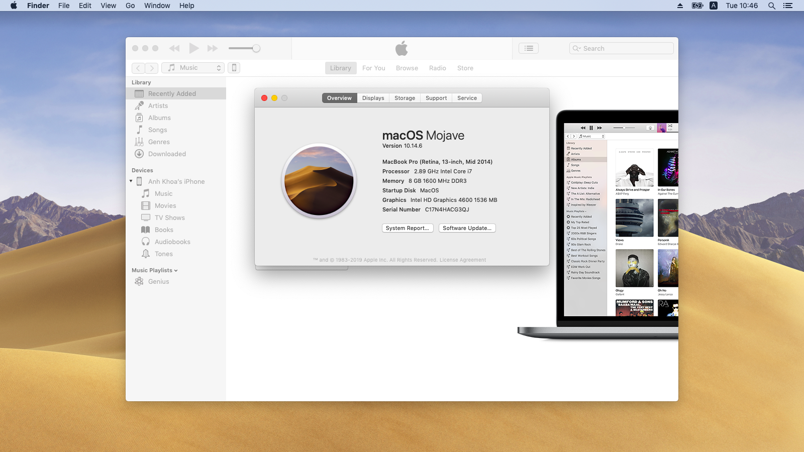

AnhKhoa Posted August 20, 2019 Share Posted August 20, 2019 Thanks @vanadium This works perfectly on my t440p - Mojave 10.14.6 (Performance is even better in v1.3 EFI) Laptop specs: - Intel Core I7 4600M - Intel graphic HD4600 (Nvidia GT730M disabled) - 500Gb HDD TOSHIBA MQ01ACF050 (Had to swap HDD to built in SATA because Installer shows Uninitialized status in ultrabay) - Samsung SSD 860 EVO 250GB in ultrabay - HD+ (1600x900) IPS Panel. - All USB ports - Camera, mic, audio (speaker + jack phone) - Sleep, wake up, restart, shutdown, ... Things don't work: - Wifi, bluetooth (bluetooth occasionally works, don't know why/how) - 3 finger gestures Link to comment https://www.insanelymac.com/forum/topic/337099-guide-thinkpad-t440p-mojave-1014x/#findComment-2686685 Share on other sites More sharing options...

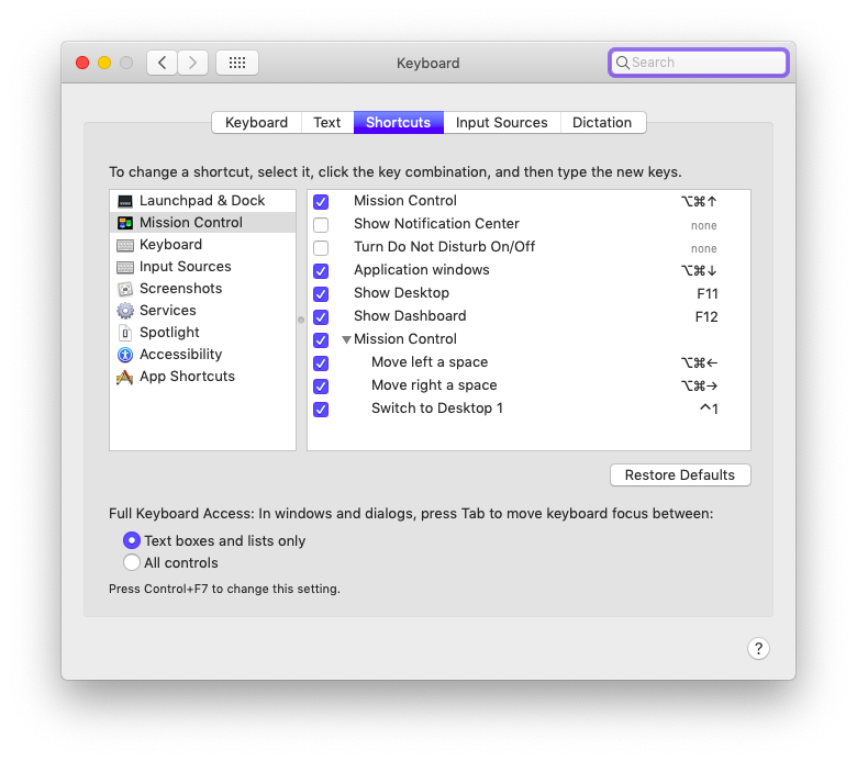

AnhKhoa Posted August 20, 2019 Share Posted August 20, 2019 Update: 3-fingers gestures work using keyboard shortcuts hack. Simply replace keyboard shortcuts in System Preferences/Keyboard/Shortcuts with appropriates gestures. Link to comment https://www.insanelymac.com/forum/topic/337099-guide-thinkpad-t440p-mojave-1014x/#findComment-2686712 Share on other sites More sharing options...

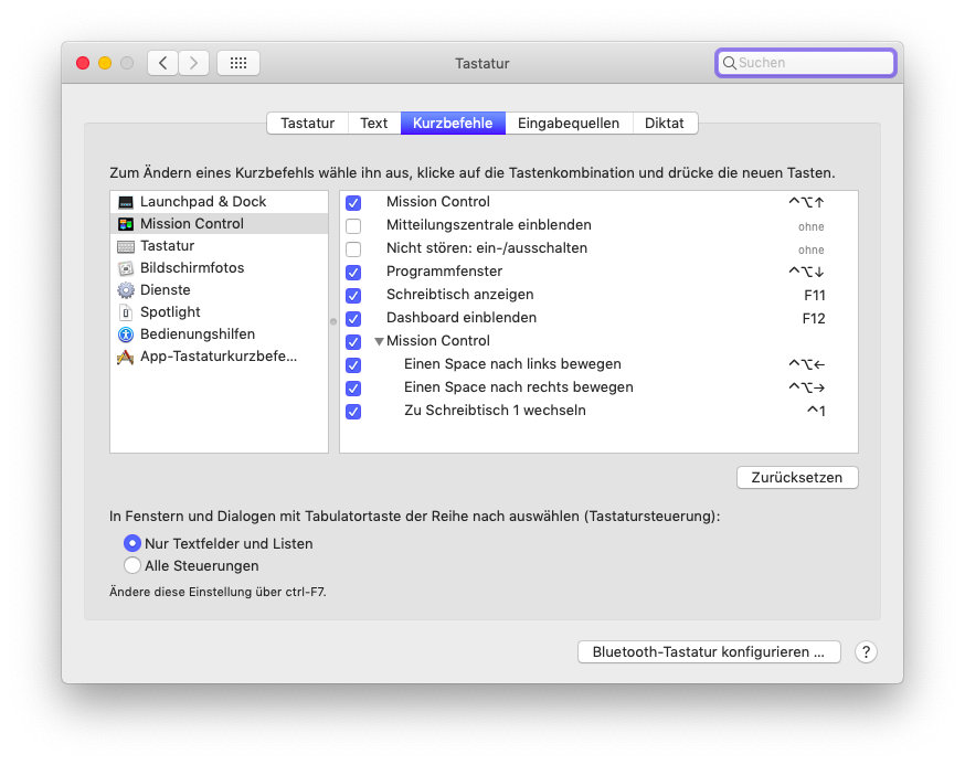

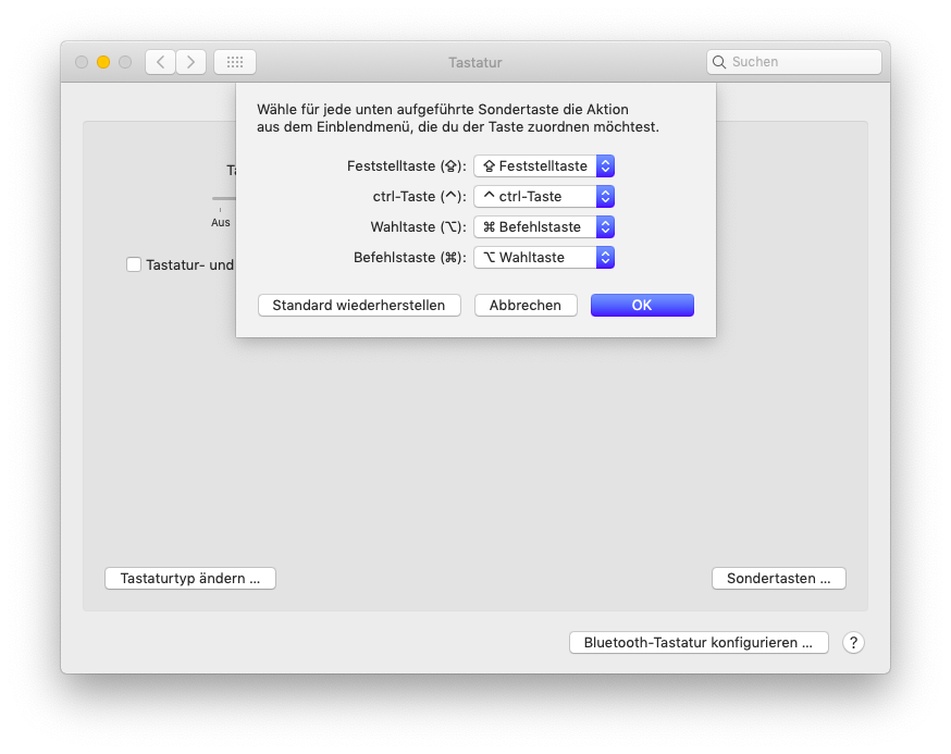

Internet Larry Posted September 6, 2019 Share Posted September 6, 2019 Hello, i have a problem with the 3 finger gestures. The original T440p Trackpad is installed. I set the shortcuts in the Keyboard settings, and installed the kexts like in the readme. Using 10.14.6. When i try to performe the gestures, i hear the sound for invalid input. The error sound Is there something i miss? Thanks Link to comment https://www.insanelymac.com/forum/topic/337099-guide-thinkpad-t440p-mojave-1014x/#findComment-2688960 Share on other sites More sharing options...
Internet Larry Posted September 7, 2019 Share Posted September 7, 2019 On 9/6/2019 at 2:41 AM, Internet Larry said: Hello, i have a problem with the 3 finger gestures. The original T440p Trackpad is installed. I set the shortcuts in the Keyboard settings, and installed the kexts like in the readme. Using 10.14.6. When i try to performe the gestures, i hear the sound for invalid input. The error sound Is there something i miss? Thanks Edit, i got the problem. I needed different shortcuts. For me i swapped the Keys and the shortscuts. Link to comment https://www.insanelymac.com/forum/topic/337099-guide-thinkpad-t440p-mojave-1014x/#findComment-2689173 Share on other sites More sharing options...
