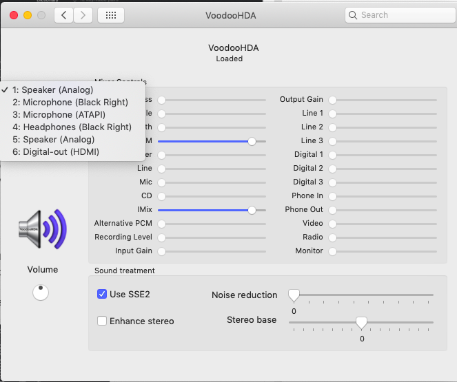

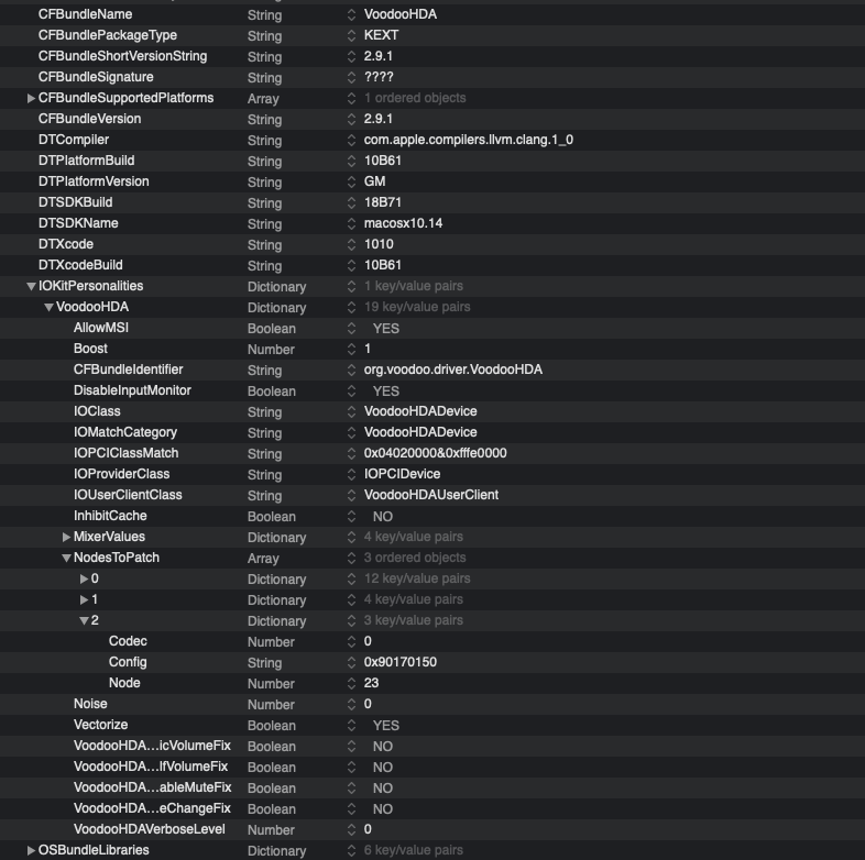

Thanks for the reply! So I've tried to add this to my nodes in the Info.plist of VoodooHDA but it seems this did not work - I still don't see the device listed, even in my MIDI Config. I believe this is the right way to do this, is this correct? I've attached a screenshot of my Info.plist from the kext.
Edit:
Actually, now I see another device in my VoodooHDA audio settings, but it is not adjustable and doesn't come up in the MIDI Devices. Also, after a few reboots I'm seeing HDMI audio output enabled. I'm not sure how that happened. Perhaps that was what that setting enabled. Either way the subwoofer is still not functional.
Edited by markilark
