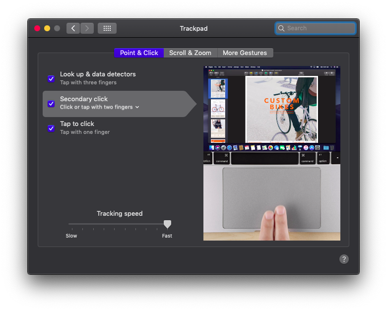

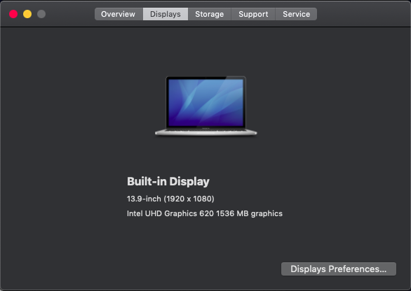

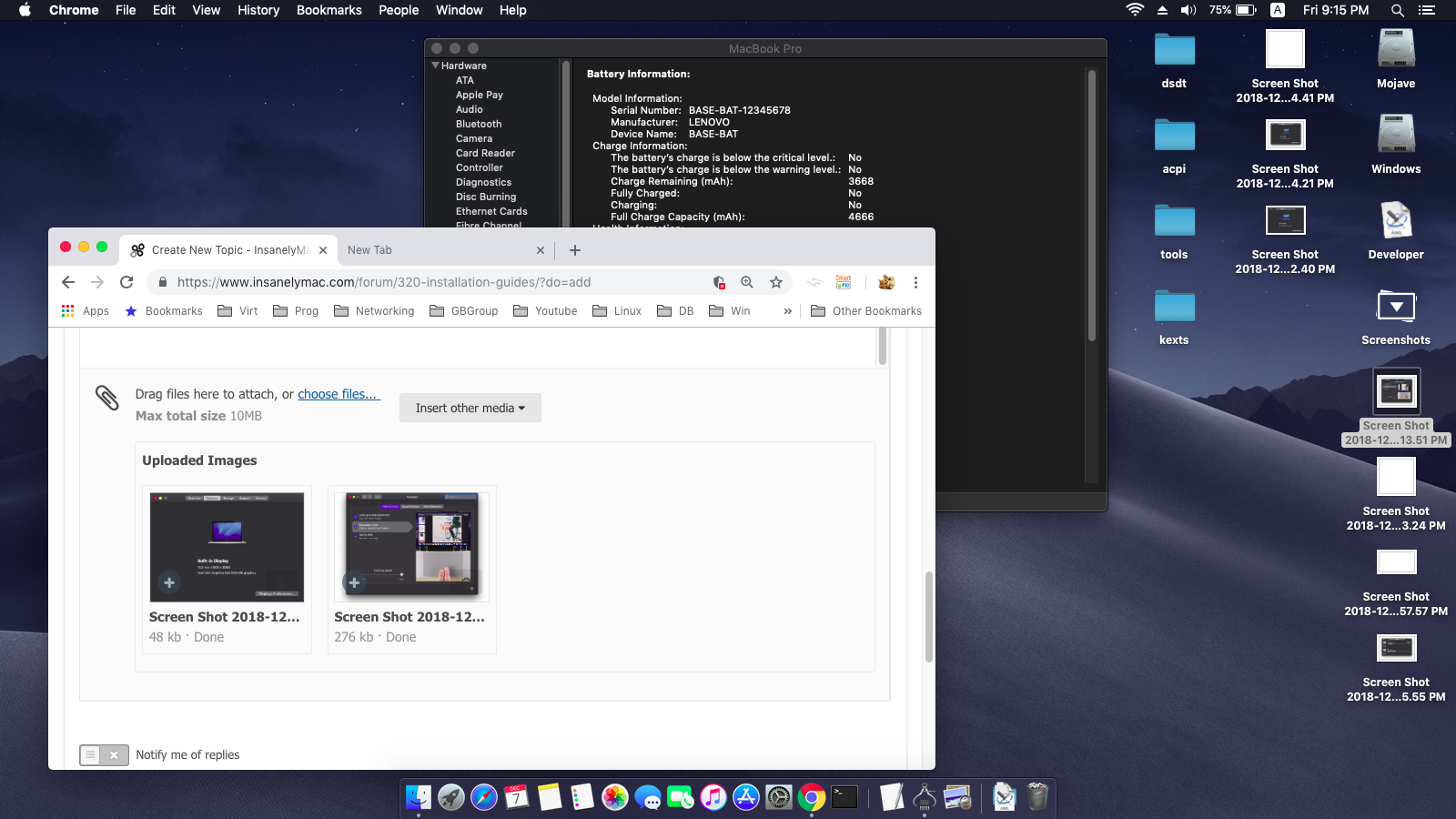

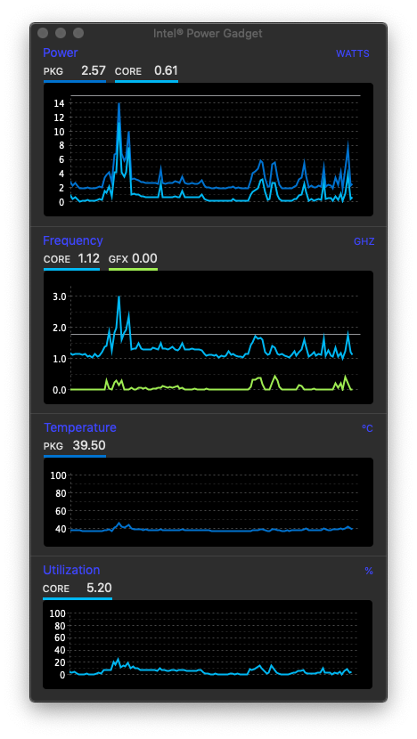

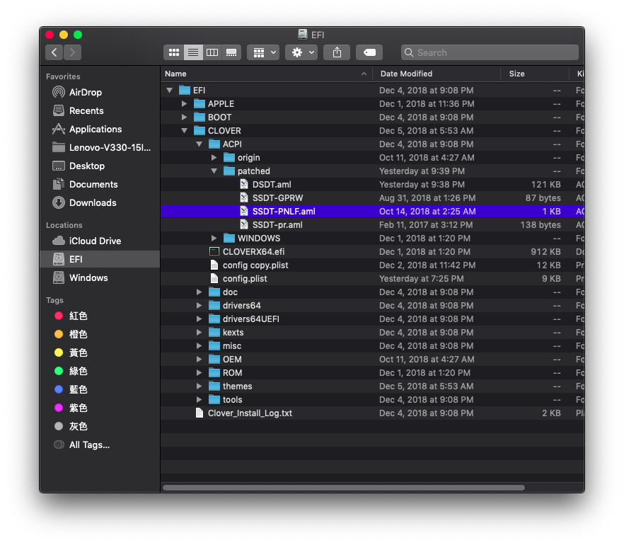

brandonh4693 Posted December 7, 2018 Share Posted December 7, 2018 Spec: CPU: Intel i5-8250u RAM: 4GB DDR4 on board, 8G in additional slot disk: 128GB NVMe SSD(comes with Windows 10 Home) disk2: 1TB HDD(replaced with Patriot Burst 480GB SATA SSD and install Mojave on it) 2 USB3 ports 1 USB Type-C HDMI Card-Reader(havn't tested yet) 14" display 1920x1080 weight: around 1.6KG Intel wifi, I replaced it with BCM94350Zae I havn't tried Bluetooth yet because it's not a necessity for me, but wifi works well. battery works after following Rehabman's guide, a lot of work but worth it ELAN touchpad also works after DSDT patching, no GPIO pinning required need to install VoodooI2C, VoodooI2CHID in /Library/Extensions and rebuild cache you might also need to remove AppleIntelLpssI2C.kext and AppleIntelLpssI2CController.kext as well sleep/wake works fine, but the system drains about 8% of power during 20 hours of sleep, it also drains power more quickly than expected when I'm using it. I wonder if I could do anything thing to improve power consumption. sometimes it would take up to 15 seconds to fall asleep, sometimes less than 5 seconds (I mean when the power button goes from "on" to "flashing slowly", indicating it's sleeping) please help me improve clover config or DSDT if u can. overall, i think this is a good choice for hackintosh laptop DSDT final.aml DSDT final.dsl config.plist SSDT-PNLF.aml Link to comment Share on other sites More sharing options...

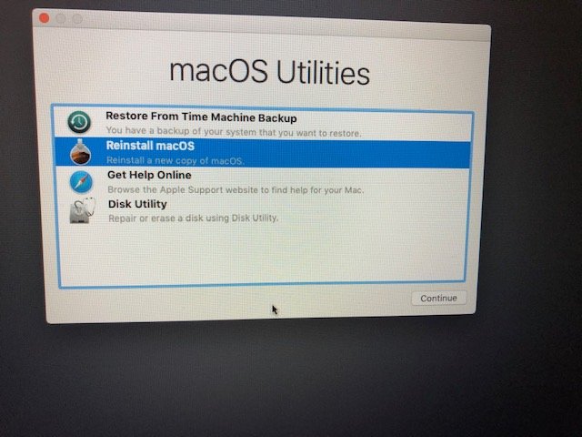

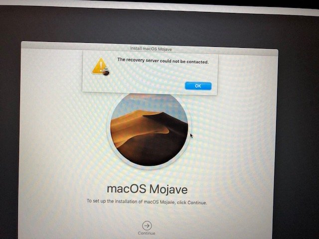

Galla Posted January 2, 2019 Share Posted January 2, 2019 I have 330s-15IKB which does not have ethernet port, wifi only. I boot off usb just nice (clover) to installer. First strange thing is that in installer, in listed MacOS Utilities I have an option to Reinstall macOS where I would expect an option to Install macOS. When I click on it I got error message (see below) since it needs an internet connection which I don't have (yet) since I don't have ethernet nor can set up usb wifi in installer (or I can?). So can somebody please explain my options here - maybe getting usb to ethernet adapter with appropriate kexts? Is there a way to install it without internet connection - I don't get it why internet connection is really needed as I have full installer on usb stick? No need to download anything I believe. Is it normal to have Reinstall option instead of Install? all help appreciated, thanks Link to comment Share on other sites More sharing options...

brandonh4693 Posted April 30, 2019 Author Share Posted April 30, 2019 folks, here's my latest files. most importantly, I found a new version of VoodooI2C that solved my jumpy mouse cursor problem when using trackpad. https://drive.google.com/open?id=1UNNiZY_IWrS4O5bfhivI4p7mDFugRIl3 pls ignore OpenVanilla, it's just a tool for Chinese input method Link to comment Share on other sites More sharing options...

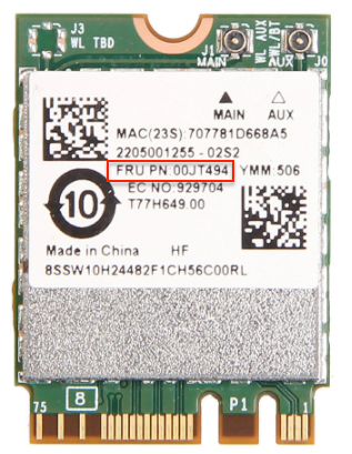

slowTerminal Posted June 29, 2019 Share Posted June 29, 2019 (edited) Where did you get your new wifi (BCM94350ZAE) card? Can you confirm your FRU? @brandonh4693 Edited June 29, 2019 by slowTerminal Added image Link to comment Share on other sites More sharing options...
aden16rus Posted July 2, 2019 Share Posted July 2, 2019 (edited) On 6/29/2019 at 3:16 AM, slowTerminal said: Where did you get your new wifi (BCM94350ZAE) card? Can you confirm your FRU? @brandonh4693 Many sellers from china write that BCM94350ZAE dont work with lenovo and IBM because these mobules not in whitelist. I'm confused how topic starter made it work. I have 330s-14ikb and have problem with touchpad its works without right button and taps as click, only hard button from bottom side of touchpad. In settings touchpad not found. Still freezes every some seconds. Anybody knows these symptoms? Edited July 3, 2019 by aden16rus Link to comment Share on other sites More sharing options...
