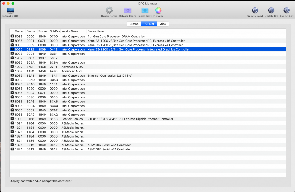

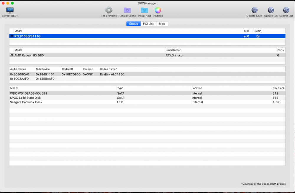

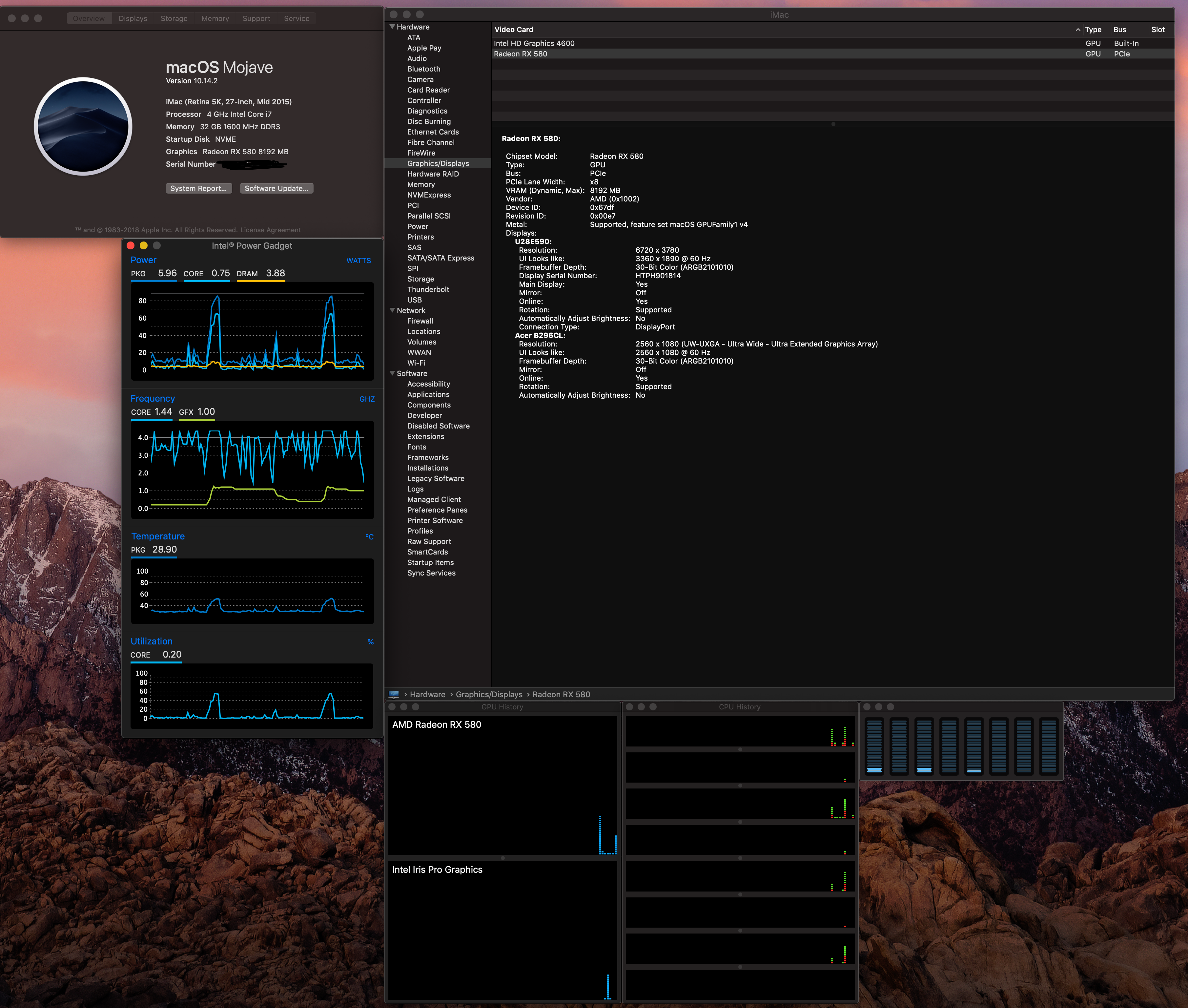

tikizondo94 Posted December 4, 2018 Share Posted December 4, 2018 I'm in a similar situation. When I enable quicksync via enabling my iGPU in BIOS and leave all my graphics setting blank in my config list my iGPU and RX580 show correctly in system profiler. Activity monitor shows both gpus working and iGPU idles correctly. "0.20Ghz". But the second I try to export files via FCXP the system crashes and reboots. If I add 0x04128086 to fakeID and 0x04120004 to my platformID and inject Intel my iGPU stays running at a constant "1.25Ghz" even at idle. But, I can export files in FCXP without crashing. And it seems to work quite fast. Any ideas on getting the iGPU to idle down? Using smbios iMac 15,1. Sent from my ONEPLUS A5010 using Tapatalk Link to comment https://www.insanelymac.com/forum/topic/336213-mojave-stops-to-respond-when-using-gpu-hw-encoding/#findComment-2651918 Share on other sites More sharing options...

tikizondo94 Posted December 13, 2018 Share Posted December 13, 2018 I'm currently using whatevergreen and lilu Also tried "shikigva=60" with the above values. Always runs my iGPU at 1.25Ghz. No if I leave fakeID and PlatformID blank and just use inject Intel. My iGPU idles correctly. But crashes anytime I try to export with FCPX. Strange... Link to comment https://www.insanelymac.com/forum/topic/336213-mojave-stops-to-respond-when-using-gpu-hw-encoding/#findComment-2653598 Share on other sites More sharing options...

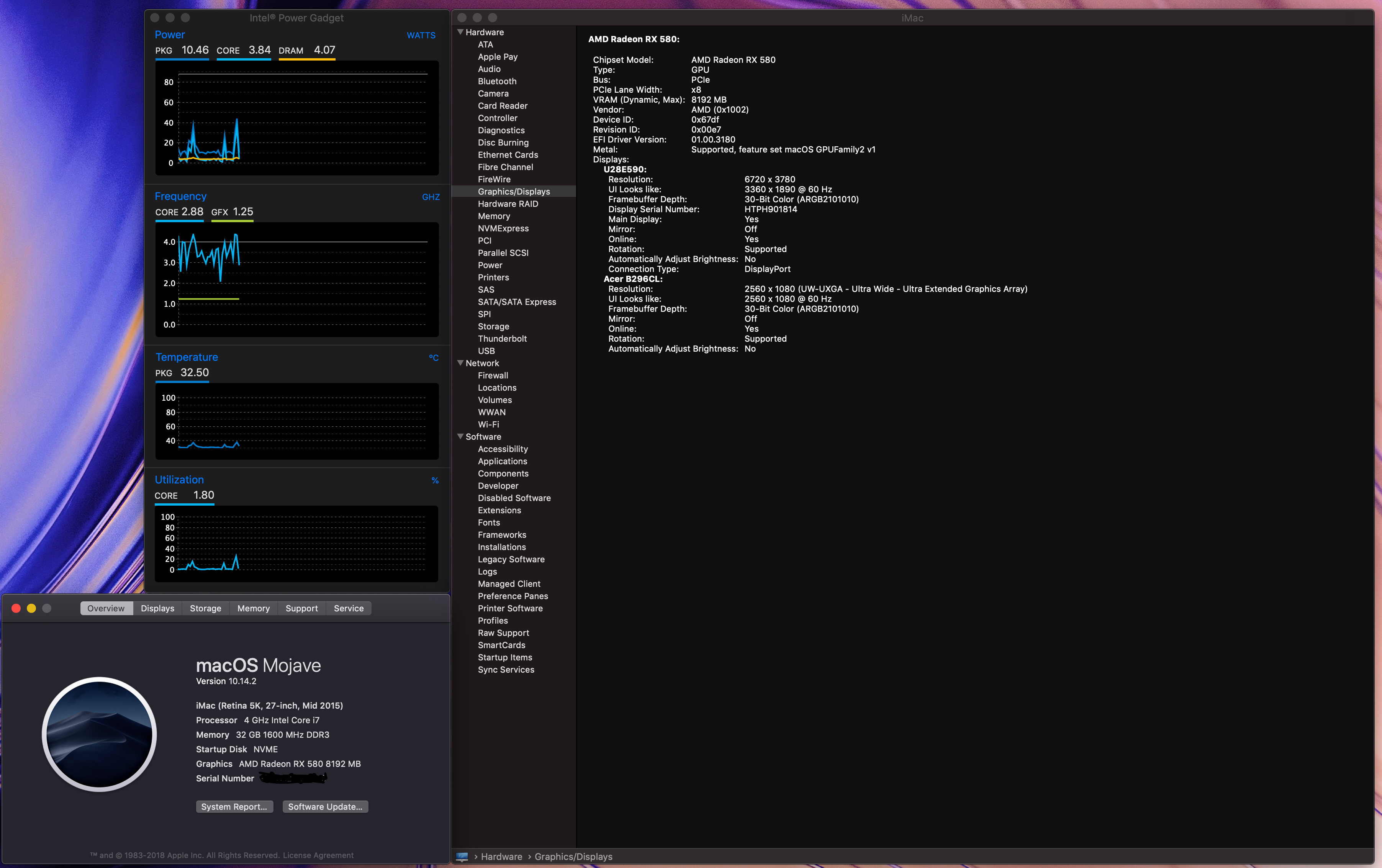

tikizondo94 Posted December 16, 2018 Share Posted December 16, 2018 2 hours ago, MacNB said: Looks like your are slipanot from the TM site. Last suggestion I had there was to remove the DSDT and try using ssdtPRGen.sh for CPU/IGPU power management. Basically, to get rid of the DSDT, you need the right patches for your Haswell in the Clove ACPI/DSDT/Patches section (e.g. GFX0->IGPU, PEGP->GFXO, etc, etc); in the SSDT section set Generate to NO and PlugInType=NO; and put the SSDT generated by ssdtprgen.sh into patched folder. I finally got it working. Method that finally worked was New extract and patch of my DSDT Remove all settings in Clover/Graphics section. Only using Inject Intel = true PlatformID blank, FakeID - 0x0 Intel QuickSync enabled now in VideoProc and MacX. iGPU idles at 0.20Ghz and scales to 1.25Ghz when encoding. CLOVER.zip 1 Link to comment https://www.insanelymac.com/forum/topic/336213-mojave-stops-to-respond-when-using-gpu-hw-encoding/#findComment-2654137 Share on other sites More sharing options...
