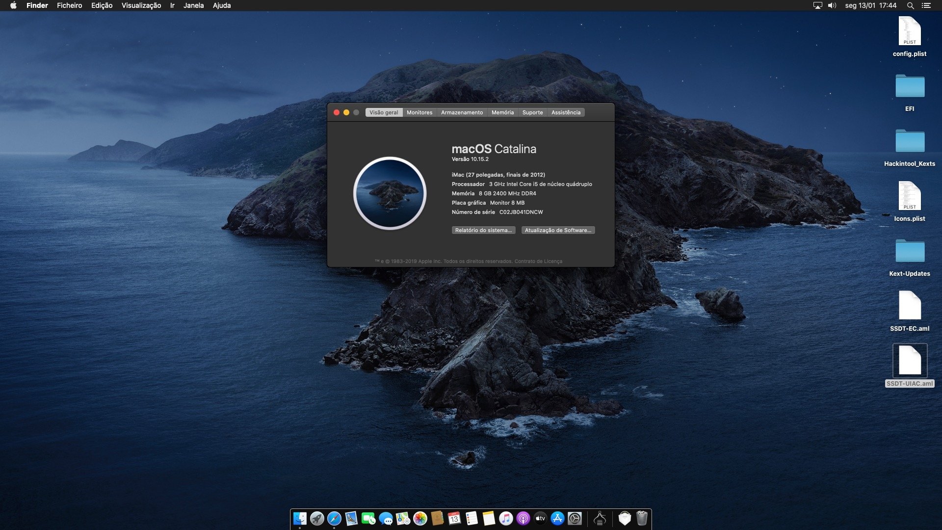

will_impulso Posted January 13, 2020 Share Posted January 13, 2020 can you help me ? I can't make my RX580 4gb work with Catalina. First I had a GTX 1050 TI that was not working and after reading in some forums that the card was not compatible, after completing the installation of Catalina 10.15.2 with immenseger, Apple Store, audio, all working. After I changed the graphics, but still can not detect the card rx580. I leave here the link from my EFI folder: https://drive.google.com/open?id=1MIce-0AEhMNWeihtpCb24U7U3z_P8_z2 My setup: Asus B250M-plus Asus rx580 4gb intel i5 8gb ram Link to comment https://www.insanelymac.com/forum/topic/335805-forget-intel-quicksync-how-to-make-your-rx-580-act-like-a-vega/#findComment-2704054 Share on other sites More sharing options...
mitch_de Posted January 14, 2020 Share Posted January 14, 2020 First you must disable (or remove those renames) all GPU related renames in the ACPI /DSDT section if you use WEG. WEG does all needed - much more clever. Complete your SMBIOS , i can only see Macmodell 18,1. Also setup your IGPU with an ig-platform ID which is connectorless (means no more an display device anymore). Even better (mire easy to handle setup) disable IGPU in BIOS , remove inject intel and use an iMacPro1,1 MacModell. Link to comment https://www.insanelymac.com/forum/topic/335805-forget-intel-quicksync-how-to-make-your-rx-580-act-like-a-vega/#findComment-2704219 Share on other sites More sharing options...
