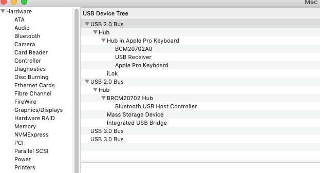

djeans Posted October 26, 2018 Author Share Posted October 26, 2018 10 minutes ago, MaLd0n said: the config looks very good about Power management u need read one tread, IM have one, use Stinga any usb 3 work? all is load in ioreg I did not understand what you wrote about power management. Can you explain further? In system profiler, it "sees" usb 3, but if I plug a usb drive into a USB3 port it does not mount, and there is no blinking LED on the drive. Link to comment https://www.insanelymac.com/forum/topic/336043-no-usb-at-all-after-updating-os/page/3/#findComment-2643116 Share on other sites More sharing options...

djeans Posted October 26, 2018 Author Share Posted October 26, 2018 18 minutes ago, MaLd0n said: Here https://www.insanelymac.com/forum/topic/324270-sandy-bridge-e-ivy-bridge-e-power-management-1013-appstore-release/ the USB fresco logic is native try this version https://bitbucket.org/RehabMan/os-x-generic-usb3/downloads/RehabMan-Generic-USB3-2015-1215.zip I followed the steps at: Here https://www.insanelymac.com/forum/topic/324270-sandy-bridge-e-ivy-bridge-e-power-management-1013-appstore-release/ but when i got to step 5 5. Download InsanelyRepairPermission and repair and touch with sudo InsanelyRepairPermission -rt / I got this error: Error: can't repair perssion on apfs formatted Volume, exiting! Sierramacpro-2:AICPMPatch djeans$ I downloaded RehabMan-Generic-USB3 link. What do I do with it? Do I run the executable, or just put the GenericUSBXHCI.kext in my Other folder? Link to comment https://www.insanelymac.com/forum/topic/336043-no-usb-at-all-after-updating-os/page/3/#findComment-2643118 Share on other sites More sharing options...

djeans Posted October 27, 2018 Author Share Posted October 27, 2018 I'm beginning to wonder if my Motherboard is going bad. Today when I tried to boot it up, NONE of the USB ports on the board worked. I couldn't get it to work to go into BIOS or in the Clover boot screen. Switching my KB and Mouse to the pci card USB port let me continue booting. Once the computer booted into Mojave, my USB 2 ports worked again, but no the USB 3 still. Weird. Link to comment https://www.insanelymac.com/forum/topic/336043-no-usb-at-all-after-updating-os/page/3/#findComment-2643349 Share on other sites More sharing options...
SavageAUS Posted October 27, 2018 Share Posted October 27, 2018 I'm beginning to wonder if my Motherboard is going bad. Today when I tried to boot it up, NONE of the USB ports on the board worked. I couldn't get it to work to go into BIOS or in the Clover boot screen. Switching my KB and Mouse to the pci card USB port let me continue booting. Once the computer booted into Mojave, my USB 2 ports worked again, but no the USB 3 still. Weird. As dumb as it sounds have you tried to factory reset your bios? Like properly? Turn off, pull bios battery, switch jumper etc. Sent from my iPhone using Tapatalk Link to comment https://www.insanelymac.com/forum/topic/336043-no-usb-at-all-after-updating-os/page/3/#findComment-2643353 Share on other sites More sharing options...
djeans Posted October 27, 2018 Author Share Posted October 27, 2018 13 minutes ago, SavageAUS said: As dumb as it sounds have you tried to factory reset your bios? Like properly? Turn off, pull bios battery, switch jumper etc. Sent from my iPhone using Tapatalk I didn't pull the battery, but I did just short the CMOS jumper. After, when I booted I had to reset some of the BIOS settings, but USB still didn't work. Link to comment https://www.insanelymac.com/forum/topic/336043-no-usb-at-all-after-updating-os/page/3/#findComment-2643355 Share on other sites More sharing options...
