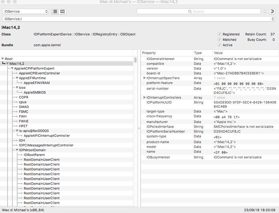

MikixIT Posted September 23, 2018 Author Share Posted September 23, 2018 9 minutes ago, Baio77 said: Ok Posta Ioreg avviando con i miei file ... Ancora TUTTO è migliorabile ......... Ci sarebbe da attivare l'audio con ALC e fare procedure x poterlo attivare , ci sono migliorie in fix ACPI da mettere e da sistemare USB e reparto SATA in DSDT , mi serve Ioreg x avere un'idea di come viene visto il tuo HW dall'OS e apportare le giuste modifiche Ioreg intendi IOregistryExplorer? Link to comment https://www.insanelymac.com/forum/topic/335602-problemi-dualboot-con-clover/page/2/#findComment-2636328 Share on other sites More sharing options...
Baio77 Posted September 23, 2018 Share Posted September 23, 2018 Esatto lui Link to comment https://www.insanelymac.com/forum/topic/335602-problemi-dualboot-con-clover/page/2/#findComment-2636329 Share on other sites More sharing options...
MikixIT Posted September 23, 2018 Author Share Posted September 23, 2018 Link to comment https://www.insanelymac.com/forum/topic/335602-problemi-dualboot-con-clover/page/2/#findComment-2636330 Share on other sites More sharing options...
Baio77 Posted September 23, 2018 Share Posted September 23, 2018 DEVI salvare il report , comprimerlo e postarlo , cosi NON è utile 1 Link to comment https://www.insanelymac.com/forum/topic/335602-problemi-dualboot-con-clover/page/2/#findComment-2636331 Share on other sites More sharing options...
MikixIT Posted September 23, 2018 Author Share Posted September 23, 2018 (edited) Scusami.. *facepalm* http://www.mediafire.com/file/r90q2sd2bd4nl73/iMac di Michael's (2).ioreg Edited September 23, 2018 by MikixIT 1 Link to comment https://www.insanelymac.com/forum/topic/335602-problemi-dualboot-con-clover/page/2/#findComment-2636332 Share on other sites More sharing options...

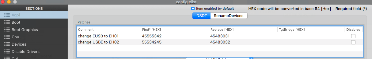

Baio77 Posted September 24, 2018 Share Posted September 24, 2018 @MikixIT eccoci qua , grazie a gengik84 abbiamo corretto il DSDT e quindi possiamo vedere se riusciamo a migliorare il sistema ........ Questi sono i file da sovrascrivere nella USB con cui fai prove ..... Potrebbe dare problemi ho modificato il DSDT e NON poco , se avvia rispondi con Ioreg ..... MODIFICHE DSDT: Patch varie e vari reneme ....... USB:In DSDT sono nominate EUSB ed USBE quindi il rename EHC1\EHC2 to EH01\EH02 in configplist NON va bene è di gran lunga migliore quello ho messo adesso , almeno è il più idoneo ....... Sono prove da fare al fine di migliorare l'OS A dopo Archivio.zip 1 Link to comment https://www.insanelymac.com/forum/topic/335602-problemi-dualboot-con-clover/page/2/#findComment-2636418 Share on other sites More sharing options...
