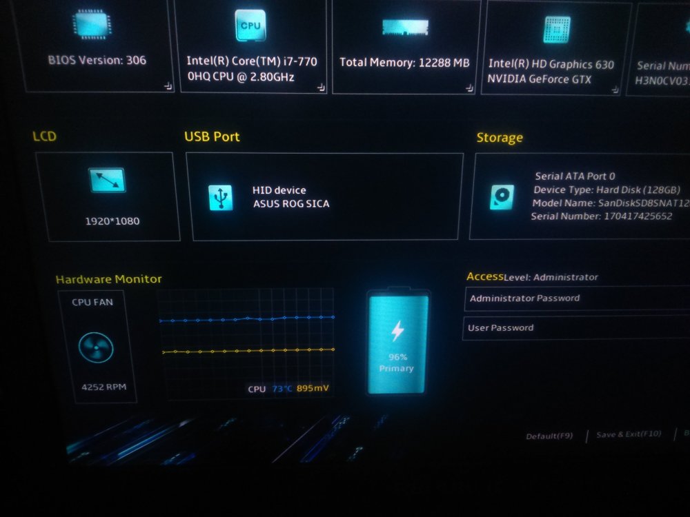

darkbluecode Posted June 29, 2018 Share Posted June 29, 2018 (edited) Overview Hi . i was working hard for full use this laptop on mac . It's so easy but you most install mac os high sierra for use my file .Hardware Specs Intel i7-7700HQ CPU Intel HD Graphics 630 / nVidia GTX 1050 Ti (the nVidia card is disabled due to its Optimus configuration) 12GB 2400MHz DDR4 RAM 15.6” 1080p matte display 128GB SSD 1TB 7200RPM HDD Intel AC 7265 Wireless card: You WILL need to replace this to get wireless functionality! or use usb wifi What’s Working: cpu intel gpu touch pad brightness usb speker with out noise and so loud battery* number in setting fake ( 100 = 97 or 96 - i used HWMonitor for show true number ) keyboard lan fn only for sound hdmi NVIDIA Chip Model ( only for see necessary for work hdmi ) Step 1 : how can i install ???you most block gtx1050m but how ? you most use my clover file. --------------------------------------------Step 2 : after install i have so bad graphic you most install kext ( IntelGraphicsFixup.kext and Lilu.kext ) in s/l/e with kext unity . ------------------------------------------------------------------------------------------------------- Step 3 : i haven't audio you should install kext ( AppleALC.kext and CodecCommander.kext ) in l/e --------------------------------------------------------------------------------------------------------Step 4: how can i use touch pad ?? for install touch pad i use dsdt patch (Elan 1200) and voodooi2c one !!! you most remove kext (AppleIntelLpssL2C.kext and AppleIntelLpssI2CController.kext ) you most install kext ( VoodooI2C.kext and VoodooI2CHID.kext ) in s/l/e but after install kexts touch pad doesn't worked ?? you most use my clover file in clover file i inserted dsdt patch for i2c elan 1200 ------------------------------------------------------------------------------------------------------- Step 5 : tell about the battery ? install kext (ACPIBatteryManager.kext) in s/l/e --------------------------------------------------------------------------------------------------------Step 6 : i can't control Backlight ? install kext (AppleBacklightInjector.kext) in l/e ------------------------------------------------------------------------------------------------------- Step 7 : but other item ?? for other item only use my clover file in EFI partition . ----------------------------------------------------------------------------------------------------------------- for temp i installed HWMonitor.dmg ( kext install in l/e ) after all Steps open terminal in use code (sudo kextcache -i /) ***** for install kext in s/l/e you most use kext unity ***** for Backlight fn key go to the setting - keyboard - shortcuts - display and set f5 and f6 ) ------------------------------------------------------------------------ New step ! = hdmi for use hdmi port we most use Nvidia but how ?? ( use HDMI zip file ) not really work that chip . install NvidiaGraphicsFixup.kext on s/l/e copy NvidiaGraphicsFixup.kext on EFI/CLOVER/kexts/Other remove old config.plist on EFI/CLOVER/ and replace with new config.plist file remove SSDT-DiscreteSpoof on EFI/CLOVER/ACPI/patched install WebDriver-387.10.10.10.35.106 ( link ) now reboot your mac os !! CLOVER.zip kexts.zip HDMI.zip Edited June 29, 2018 by darkbluecode Link to comment Share on other sites More sharing options...

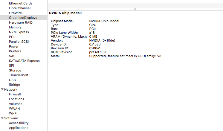

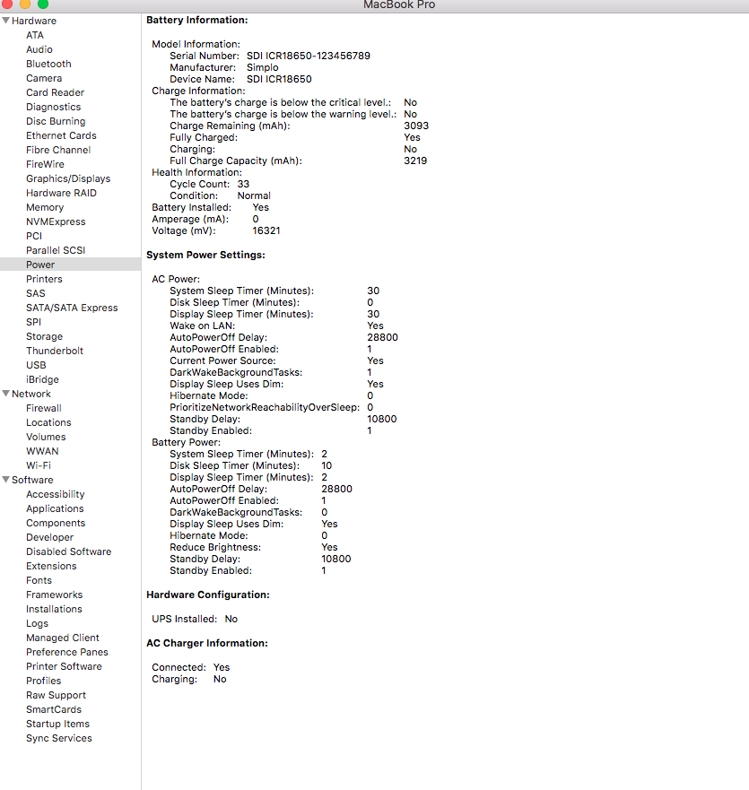

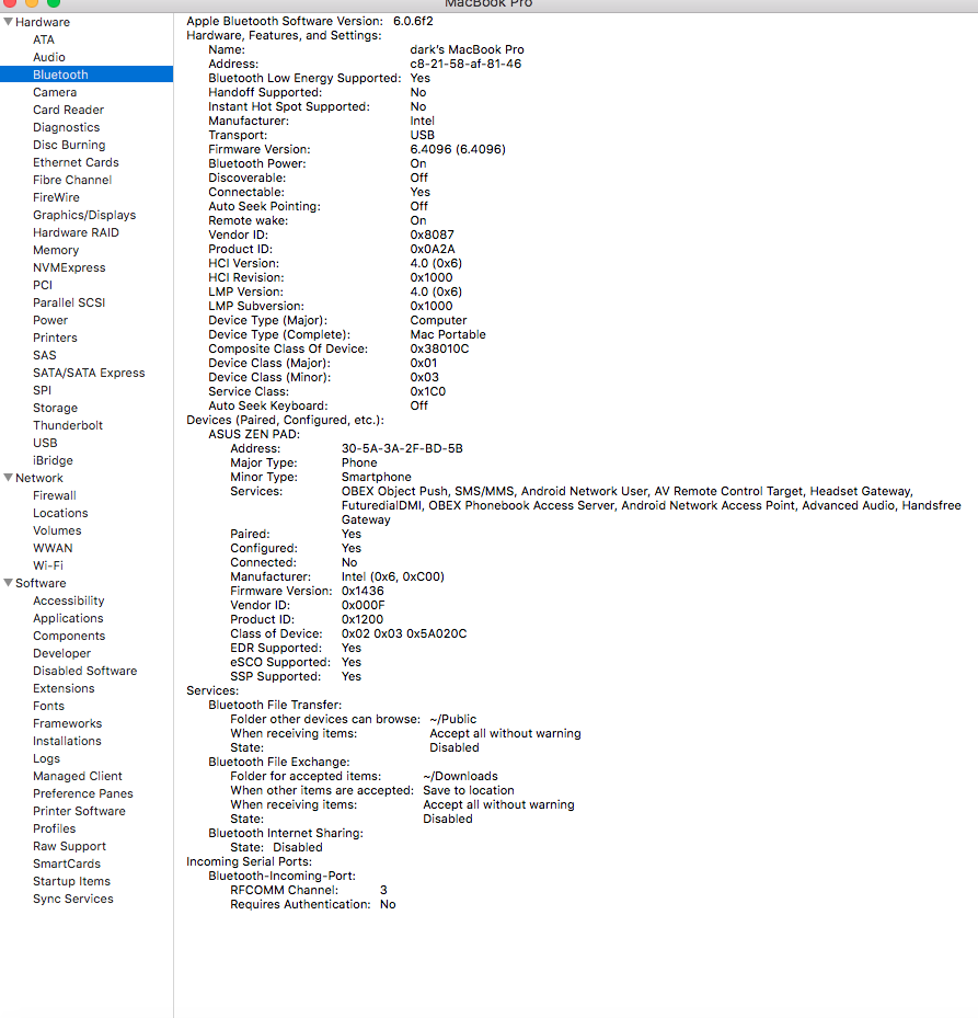

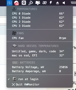

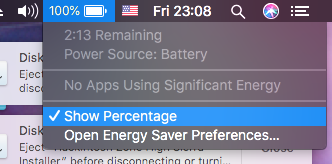

darkbluecode Posted June 29, 2018 Author Share Posted June 29, 2018 (edited) HI the guide doesn't complete ! please help me to complete this guide. Problems ::: 1 : buttery number fake ( IMG ) 2 : Nvidia chip ( doesn't M model !!! please watch IMG ) 3 : Internal Microphone 4 : find cpu fan by system 5 : cpu temp ( base 50 degrees centigrade ) ! 6 : buttery work only for 2H or 3H ! and so fast use by system 7 : control keyboard backlit ( asus aura ) 8 : tern off bluetooth ( please watch IMG ) Edited June 29, 2018 by darkbluecode Link to comment Share on other sites More sharing options...

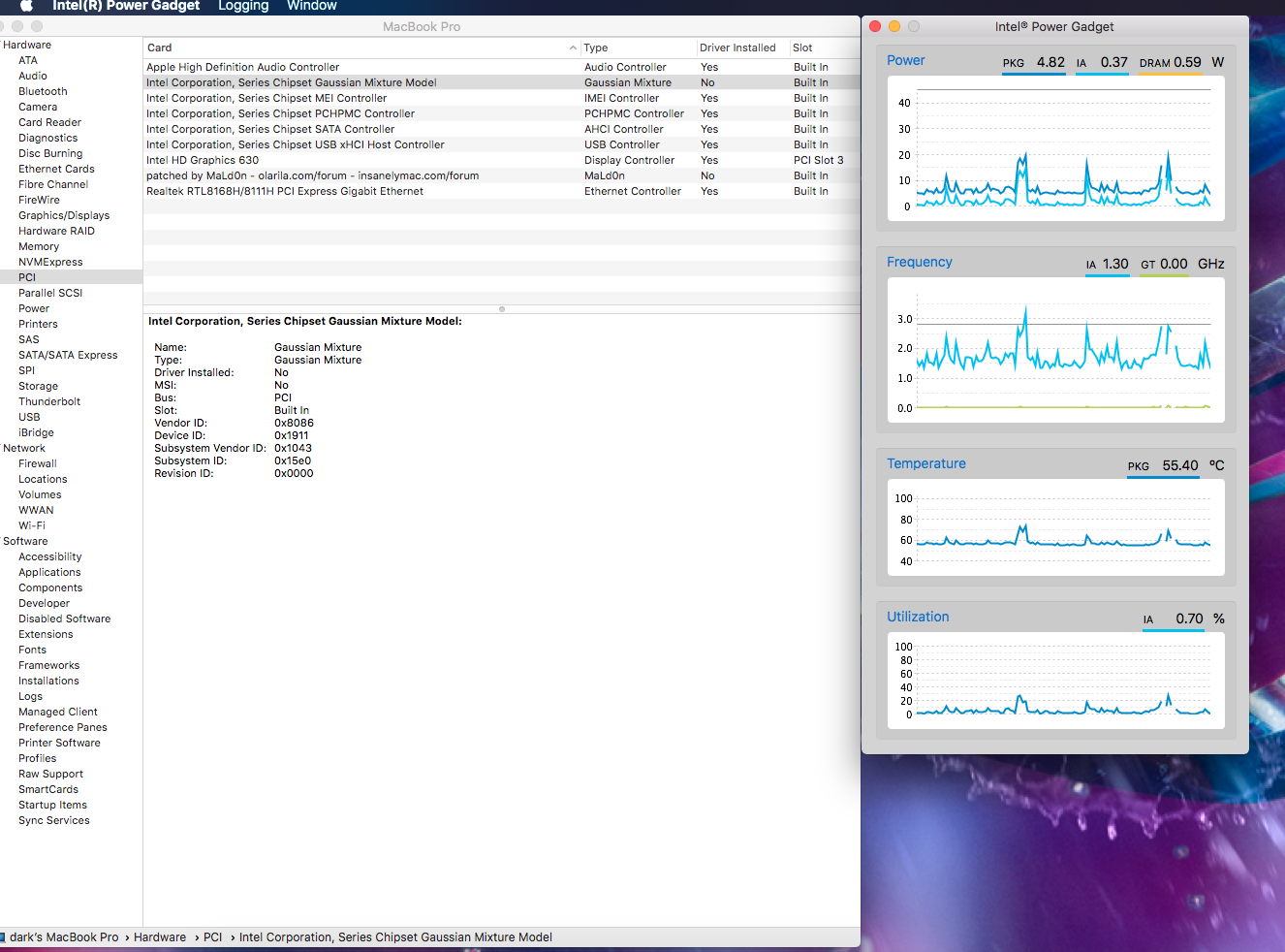

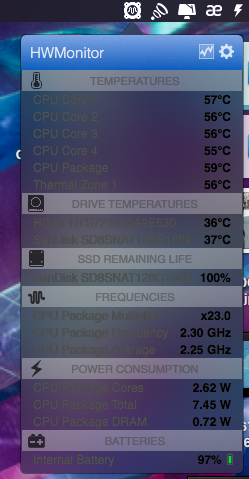

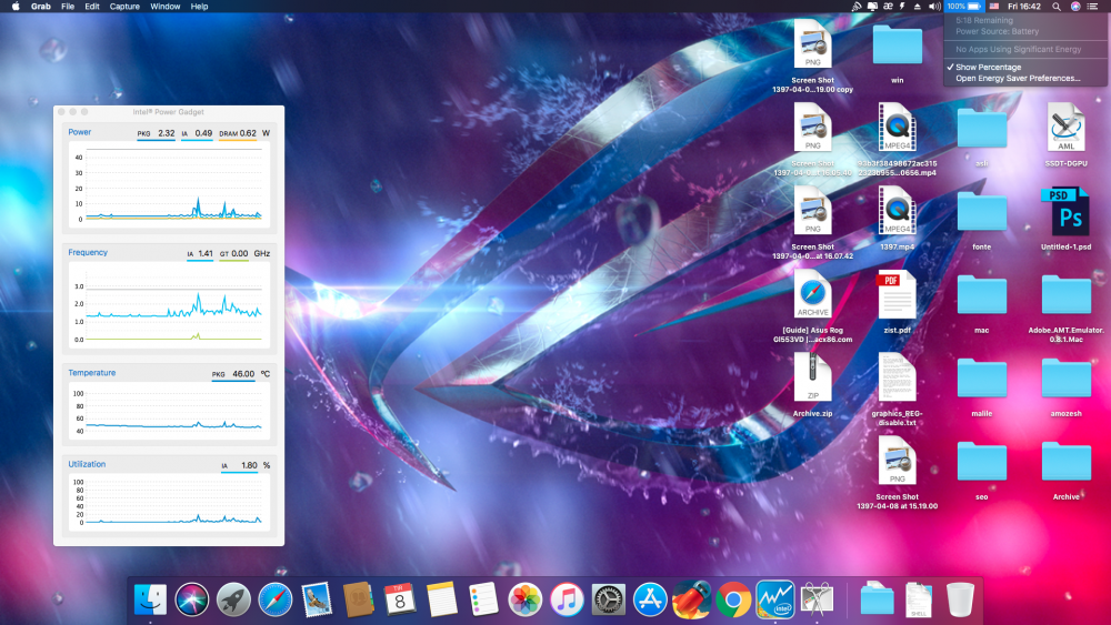

darkbluecode Posted June 29, 2018 Author Share Posted June 29, 2018 (edited) 20 minutes ago, MaLd0n said: stay with ur usb stick for rescue if fail CLOVER.zip thank you work ( on usb boot) but battery number fake !! ( system tell 100 % but in really 97 % ) and cpu doesn't fixed - SSDT-DGPU.aml fix cpu using but fan speed go to max !!! now my battery work doesn't changed because only work for 2H and cpu doesn't good work and eat many power ( W ) ----------------------------------- in img we can see so good work cpu and eat small power Edited June 29, 2018 by darkbluecode Link to comment Share on other sites More sharing options...

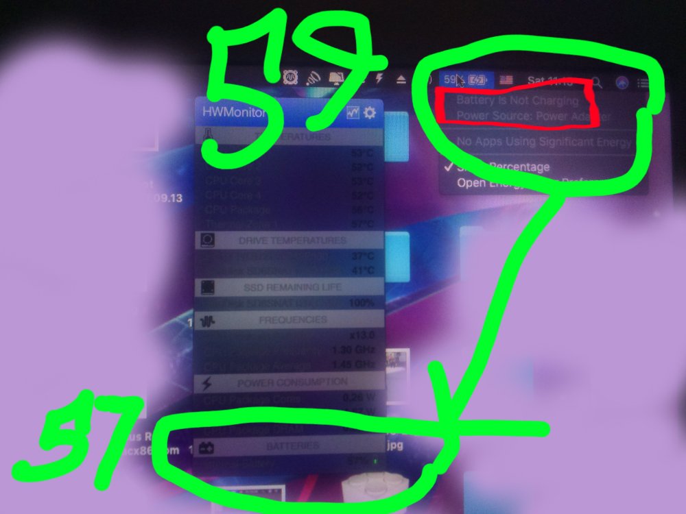

darkbluecode Posted June 30, 2018 Author Share Posted June 30, 2018 (edited) It's so amazing ! Bois sys battery level is 97 ! But system 59 And monitor app says 57 Edited June 30, 2018 by darkbluecode Link to comment Share on other sites More sharing options...
