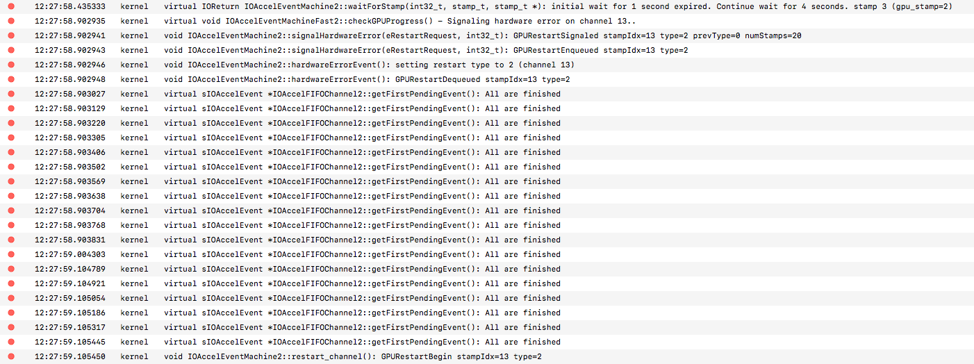

Roscoep77 Posted July 2, 2018 Author Share Posted July 2, 2018 (edited) Thanks again for the prompt replies and offers of help - I am blown away by the offer of help Here’s what I have found from using the advice that you have both provided: The only SMBIOS setting that seems to work for me is iMac14,2. Anything else (iMac18,3. iMac18,2 etc..) just means that the boot hangs I have seen a fair range of posts for the same chipset and similar coffeecake mobos where these SMBIOS setting work well… The Orinoco framebuffer setting is spot on This frame buffer works well and matches my hardware and its ports well (I have manually checked) Not sure whether this has fixed the frame rate issue I have reported - it can be quite intermittent I am still getting the graphics card issue I have use Console and have a better idea of what’s causing it I have attached the output of the console around the time when the error occurs: To my eyes this looks like a kernel panic caused by a graphics card compatibility issue but I haven't been able to see similar faults when I have Googled the issue The only settings I have found that seem to work at this stage are: No Lilu or Whatevergreen kexts In clover under Graphics: In FB Name select Orinoco Select Inject Intel ig-platform-id insert 0x59120003 Select RadeonInt I have yet to put the graphics card through its paces though so I am worried it will only happen again I am really flying blind here though… not sure if its a hardware or software thing, but it’s starting to drive me crazy… Thanks again for your assistance. Any additional insights would be really welcome. Edited July 2, 2018 by Roscoep77 1 Link to comment https://www.insanelymac.com/forum/topic/334680-possible-frame-rate-issues-with-amd-sapphire-pulse-rx-580-4gb-and-10135/#findComment-2623779 Share on other sites More sharing options...
