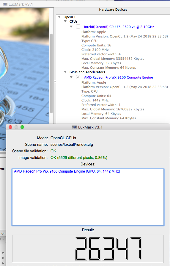

Without any Kernal to patch additions I had its power tweaks working and XCPM appeared to work fine. My Radeon Pro WX9100 worked well with the radeon fan speed kext and ran (as per one of the two Luxmark screenshots) at 1442mhz quite successfully.

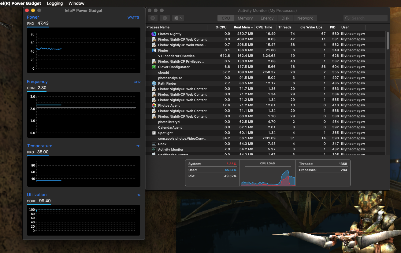

I’m up to the part in your guide where your going through SSDT and device implementations. I tried to get XCPM working in 10.14.4 but have given up for the time being. As per the screenshot with the intel power app, and me testing XCPM in terminal and getting 0 back (so not working) it appears that my Xeon is running locked at full clock speed and is reporting wrong. I tried using just the additions to the kernalToPatch that you had in the section but couldn’t get my machine to start so had to go back to the full set I found in the file you shared to another earlier user to get it booting. I’m not sure what is best to tweak to get my v5 Xeon working fully from there. I have the suggested options turned on in bios (and the power one off as recommended) but no joy. If I try the options I used in 10.13.6 (none) then I can’t get it to boot past ‘end randomseed’

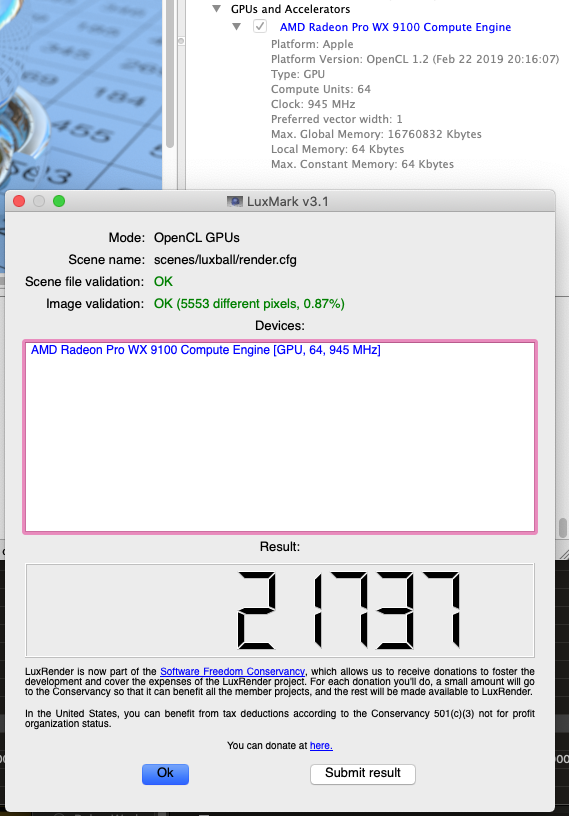

My other primary concern is my Vega card. My Radeon Pro WX9100 is being reported by Luxmark as running currently on 945mhz. And feels slow in games and FCPX.
I've stuck the  VegaTab_9100.kext into the kext folder in clover and also tried adding SSDT-X99-Vega-Fontier.aml (changing the name) but it still feels slow. How might I use the powerplay table to set my WX9100 to 1500mhz and aiming for 55deg Celsius? (I don’t mind a louder card, but I don’t want it too hot as it does long render sessions and long gaming sessions). the Vegatab kext appears to be affecting my fan speed (which is nice) but its not helping the power. If I try running vanilla, I get slow speed 945mhz still.

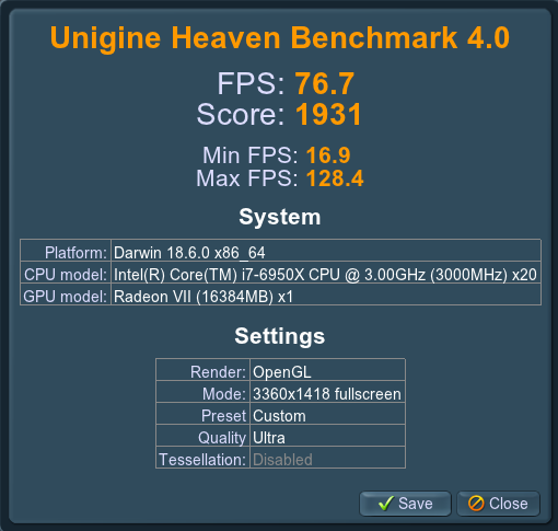

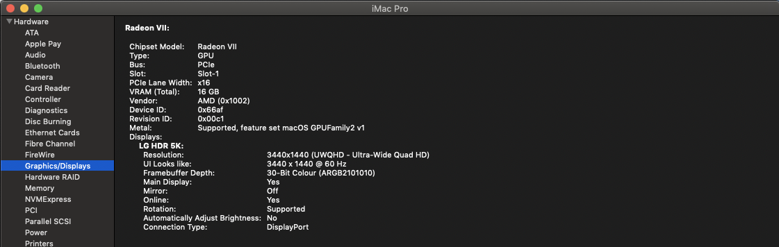

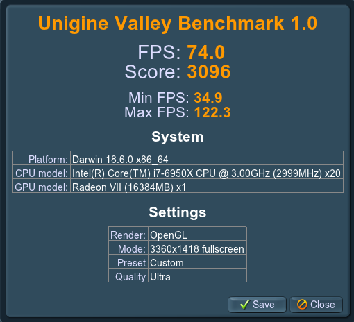

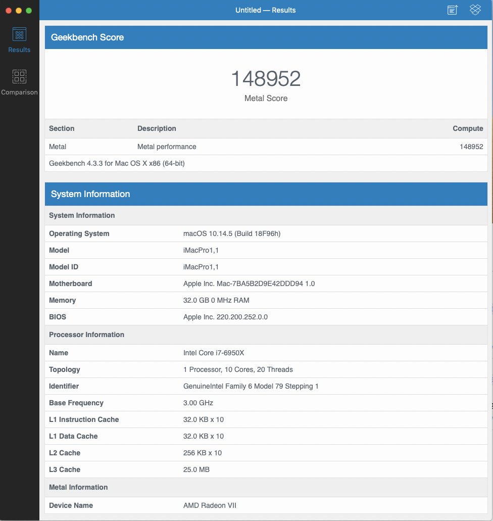

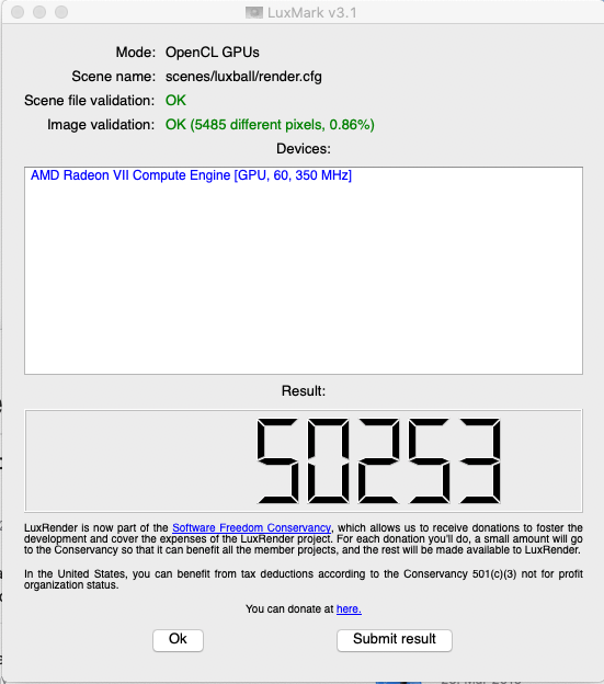

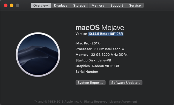

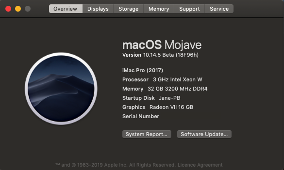

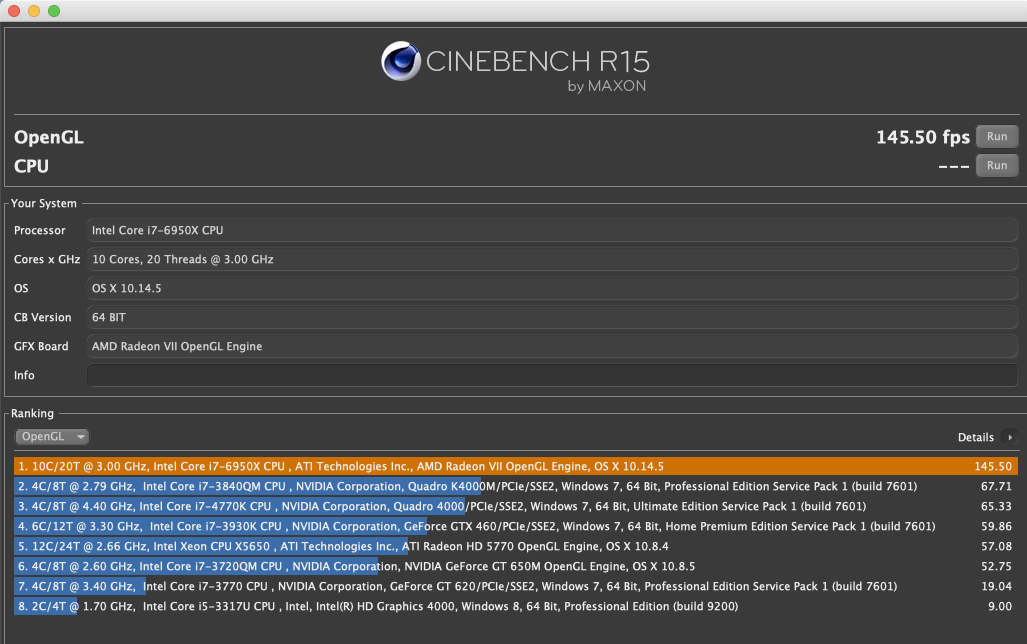

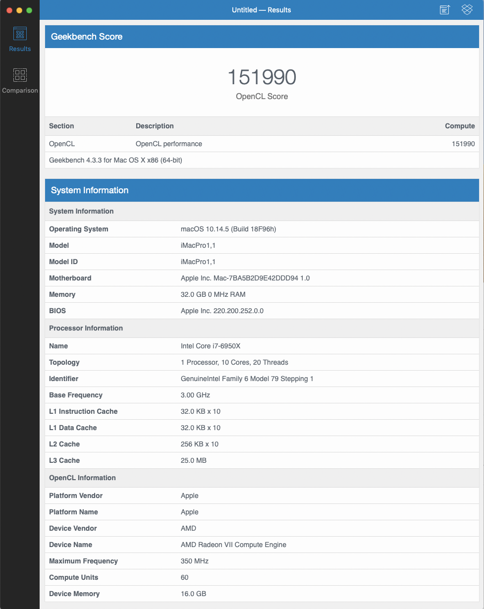

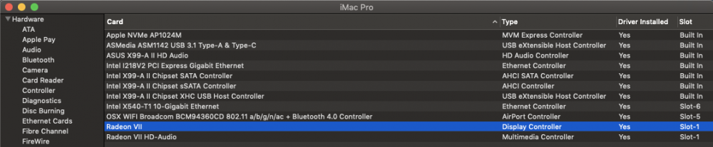

Back from Rome and quick update to 10.14.5 Beta on X99 with Radeon VII
1.) New macOS 10.14.5 Beta X99 EFI-Folder Source distribution
2.) SSDT-X99-Radeon-VII.aml + SSDT-X99-HDEF.aml + SSDT-DTPG.aml
3.) Lilu.kext v.1.3.5 + AppleALC.kext v1.3.6 + Whatevergreen.kext v.1.2.7
4.) Clover_v2.4k_r4918

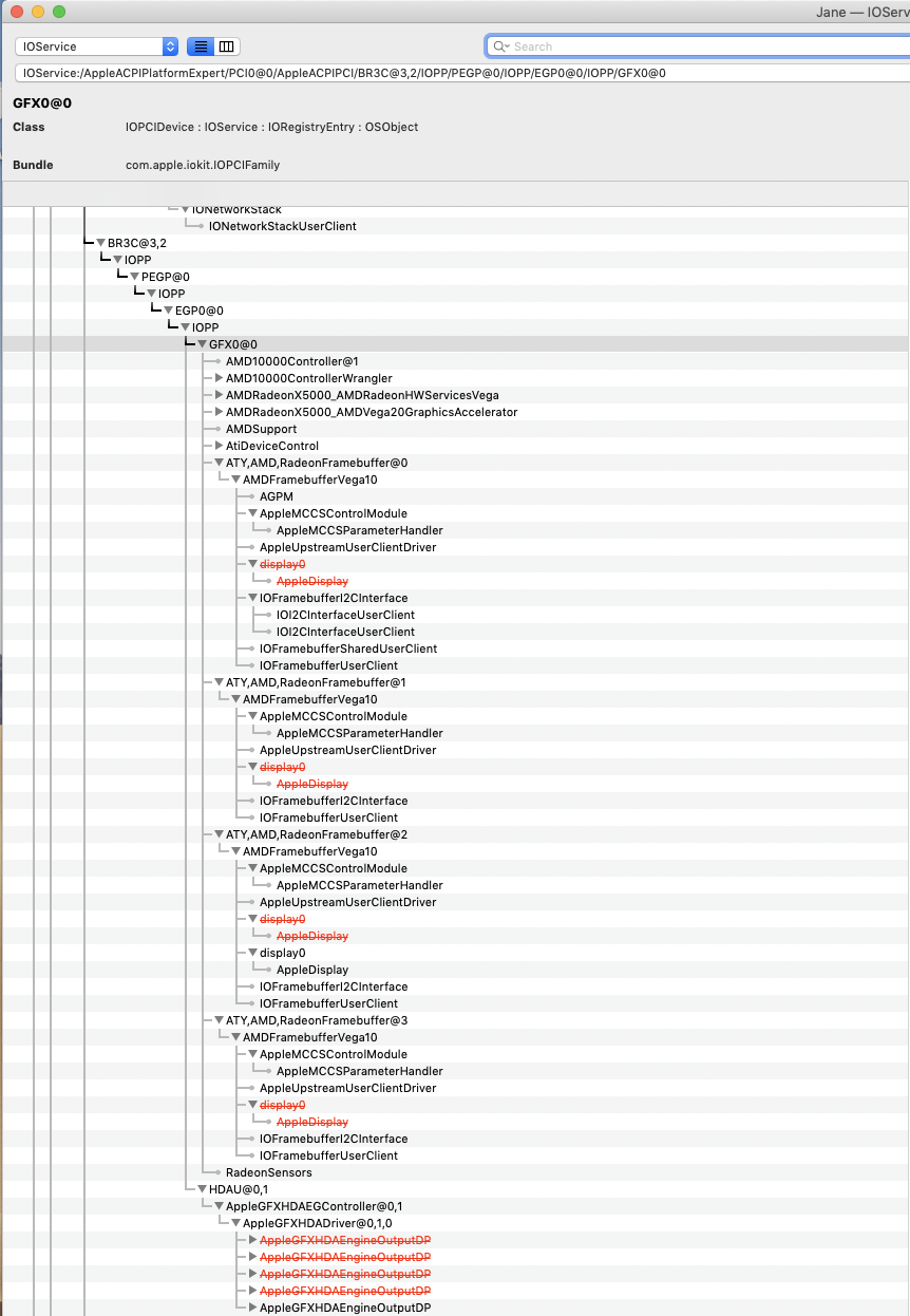

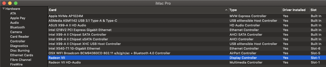

Perfect Radeon VII implementation, including Hardware Acceleration, Display HotPlug, multi-monitor support, DP/HDMI Audio and system sleep/wake.
651837081_Screenshot2019-04-04at14_10_51.thumb.png.4cfb8f8e575821acd9e87a09271ffe5d.png
624488481_Screenshot2019-04-04at14_11_21.thumb.png.7adcd762ca6b872710ce4666d860c2fc.png
830957145_Screenshot2019-04-04at14_07_08.thumb.png.88b6bdbc6ddbb520bd047c9040e97b2e.png
1938380334_Screenshot2019-04-04at13_49_12.thumb.png.a211cc3170d4d703afab26583f8af934.png
245099525_Screenshot2019-04-04at13_50_40.thumb.png.3facd36e85f7f942e7700411d813da63.png
1773488948_Screenshot2019-04-04at13_54_03.thumb.png.c7ef02e7546d745412909f0de82a9f0b.png
Apart from Luxmark, all other Radeon VII macOS benchmark scores are not optimal at present, mainly due to a yet to be optimised Radeon VII macOS driver implementation or some missing update of respective GPU benchmark programs, although I use a briefly adapted Radeon VII load table in my respective SSDTs. With the current Radeon VII macOS implementation, GPU temps keep low (40-50 deg C) even during Heaven and Valley benchmarks and even in case of the air flow Radeon VII, I am currently employing for testing purposes.

Important additional comment for all Vega users with 4K monitors though: when connecting a Vega with e.g. the LG 38UC99-W (WUHD, 3840 pix x 1600 pix) via one of the Display Ports (DPs), the screen resolution is fine under both Windows 10 and macOS High Sierra but is totally at odd during boot (VGA like boot screen resolution). The VEGA DP 4K boot screen resolution issue is neither related with the fact that the LG 38UC99-W is an ultra-wide (3840x1600) and not a true UHD (3840x2160) monitor nor related to any likely apparent issue with the ASUS X99-A II firmware. It is definitely a Vega firmware problem in combination with most 4K displays, as the DP 4K boot screen resolution issue is totally absent with my Nvidia GPU and the problem also does not only affect the ASUS Splash Screen but also spreads over the entire boot process until the login screen is reached (Windows and macOS). Splash Screen, Apple logo or verbose boot messages are not stretched but rather have VGA like resolution. Any fix of the AMD vBIOS would be highly appreciated. It is more than disappointing to witness such issues with 600-1000$ GPUs... Fortunately, the 4K boot screen issue is restricted to the Vega DP ports and likely due to the fact that the LG 38UC99-W only supports DP 1.2. Solution: Connect your Vega and your 4K display via the HDMI port. The 30 Hz HDMI monitor frequency issue under 10.13 is successfully removed under Mojave: monitor frequency of 60 Hz with the display connected via HDMI (in contrary to 75 Hz via DP).
Great benchmarks with Radeon VII :thumbsup_anim:
Is the Radeon VII react the same with the boot splash screen as you described here? I mean by the that the screen resolution of the boot screen.
I am now using the LG5K2K, which boot resolution works fine with Vegas. With the VII, the boot resolution is ok although not optimal or perfect.

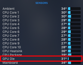

New X99 10.14.5 Beta EFI-Folder distribution adding Radeon VII GPU Temp sensor information for iStatMenus.
EFI-X99-10.14.5-Beta-iMacPro1,1-050419.zip
I just modified Kozlek/Interferenc FakeSMC/HWSensor source code distribution for adding Radeon VII GPU Temp sensor information and subsequently added new FakeSMC.kext and HWSensor.kexts to /EFI/Clover/kexts/Other. The new GPU Sensor kext should now support all Vegas and also the new Radeon VII, when using iStatMenus.
Enjoy and have fun,

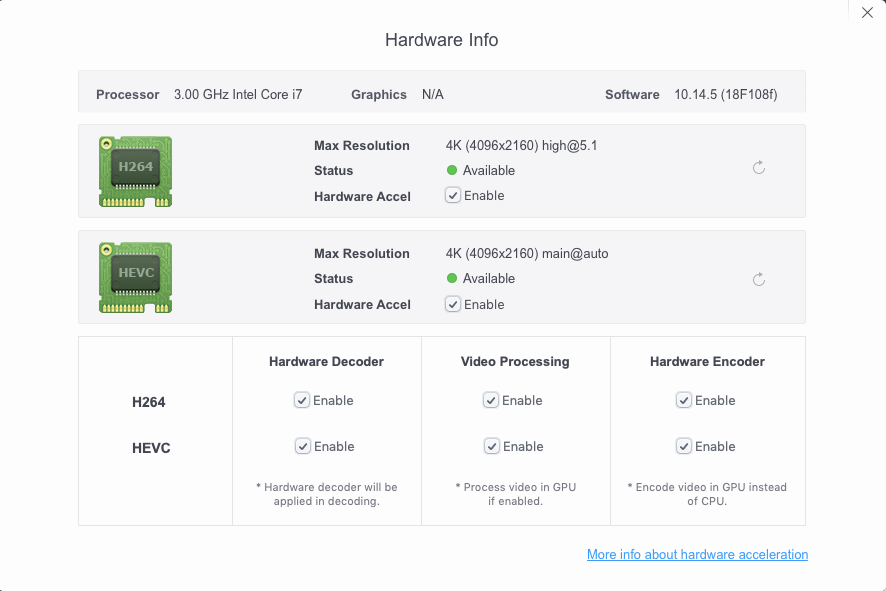

Flawless update to 10.14.5 Beta 2 (18F108f)
No further improvements in Radeon VII performance so far (quite identical overall benchmark scores when compared with Beta 1) but H264 and HEVC support.
