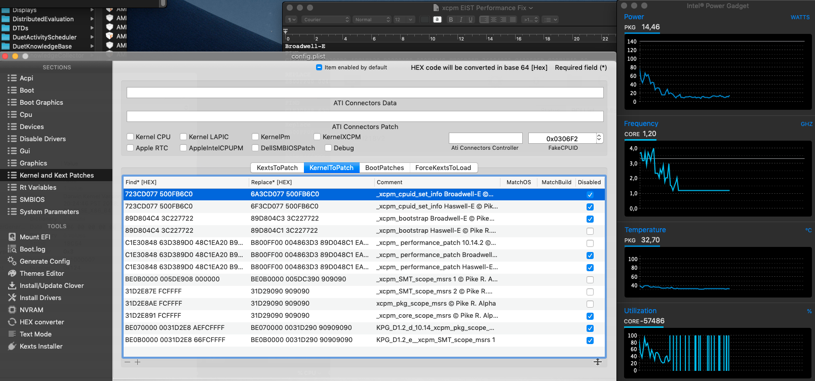

Still I dont think im done with XCPM Performance

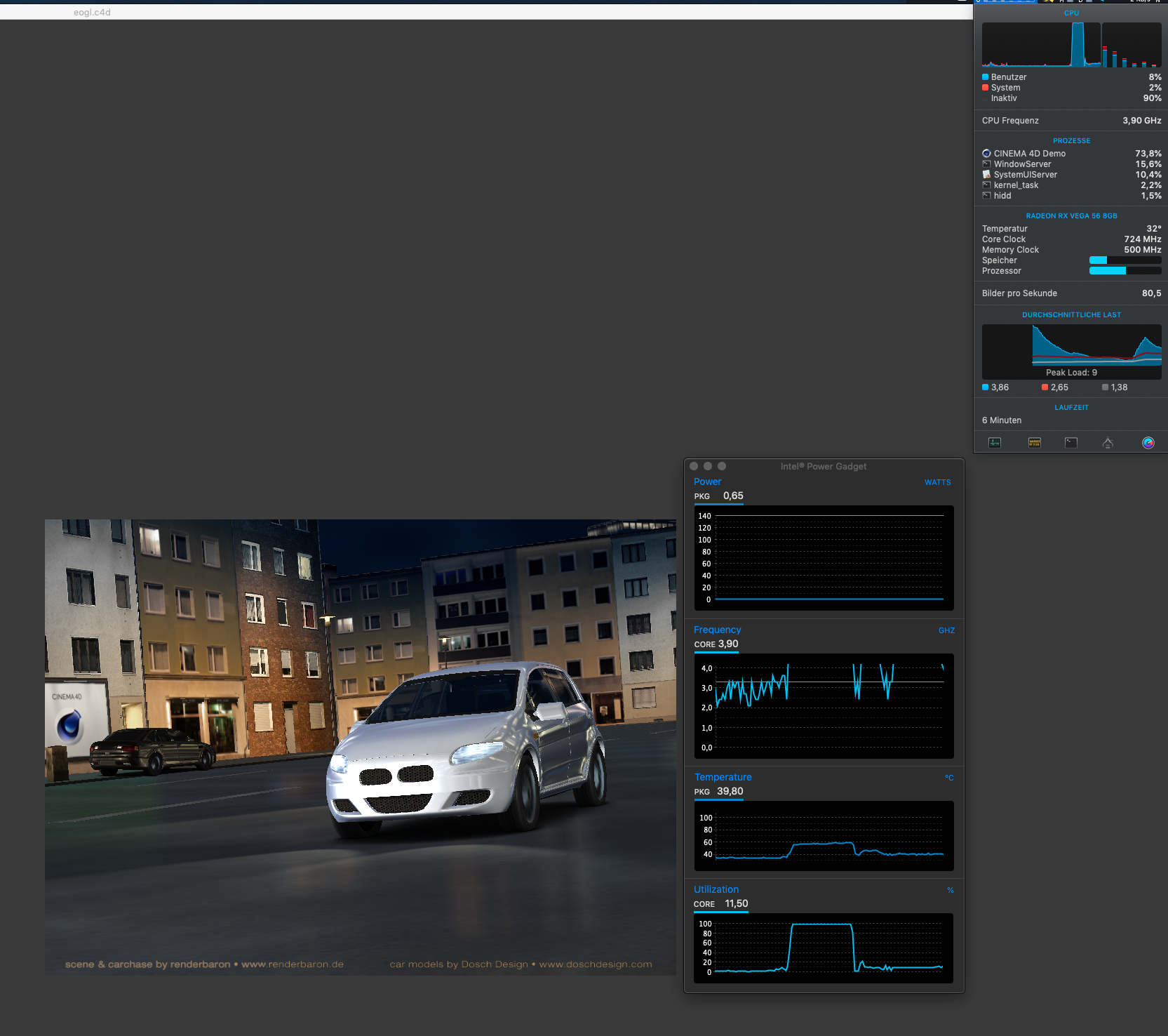

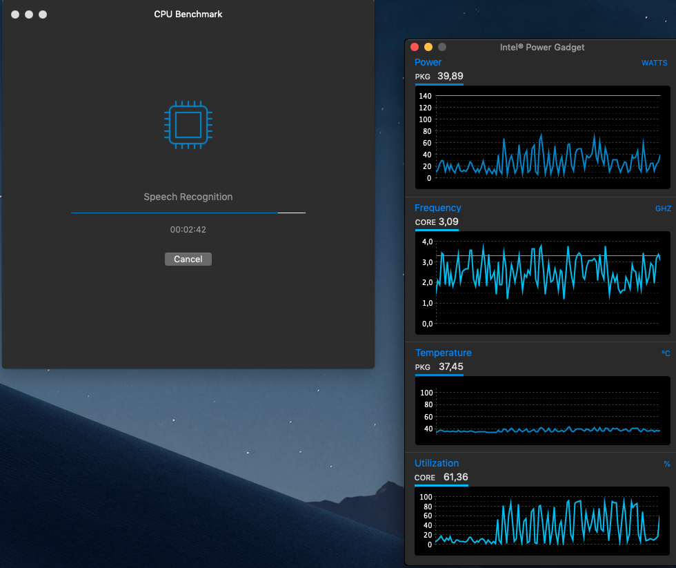

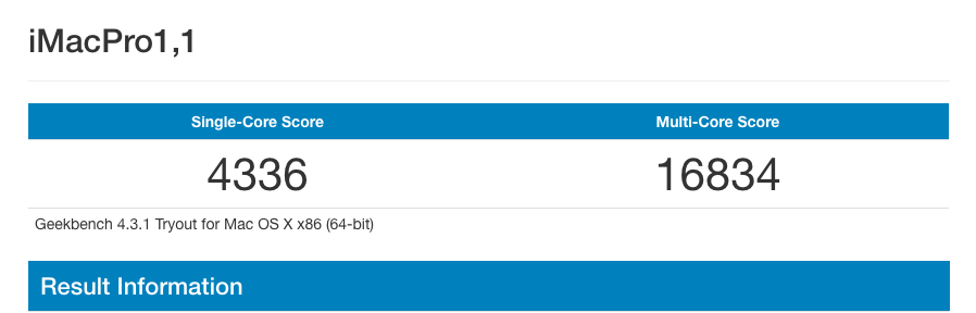

Geekbench 4 Results with 5820k at 4GHz low, and intel power gadget cpu frequency curve is low:
779594130_Bildschirmfoto2018-12-06um18_48_45.thumb.png.47c903d950f6e43fbf763121579f4d4c.png
1705538016_Bildschirmfoto2018-12-06um18_49_14.png.e4d3595e6e6db65a827fdbf5fc51c028.png
P-States etc:
607738175_Bildschirmfoto2018-12-08um10_15_47.thumb.png.89268e662ea3ff78e91870699f651953.png

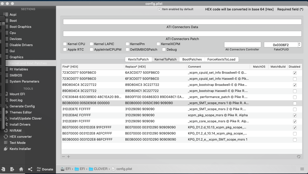

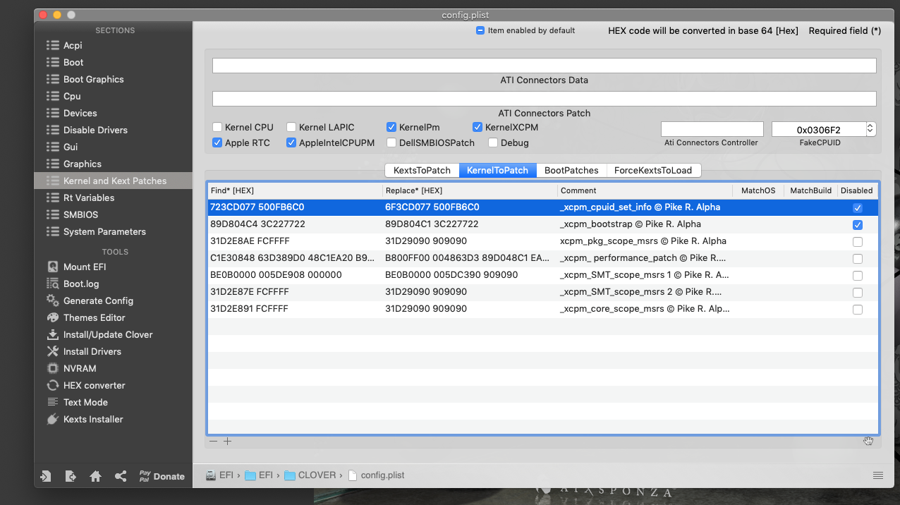

1.) You have SMT_scope_msrs1 enabled twice. KGP-D1.2_e_xcpm_SMT-scope_msr1 is certainly not the patch of my 10.14 EFI-Folder and is wrong!
2.) Also KGP_d1.2_10.13_xcpm_pkg_scope and KGP_d1.2_10.13_xcpm_pkg_scope are not from my 10.14 EFi-Folder and are wrong! The correct patch is xcpm_pkg-scope_msrs, which you disabled!
3.) Up to my knowledge there is just one common performance patch valid for both Broadwell-E and Haswell-E.
The correct performance patch for 10.14.2 is:
Find: C1E3084863D389D048C1EA20B9990100000F3048FF05C37276004883C4085B5DC30F1F4000
Repl: B800FF00004863D389D048C1EA20B9990100000F3048FF05C37276004883C4085B5DC39090
4.) You do not need the cupid_set_info kernel patch.
Hope this helps.

Hi KGP,

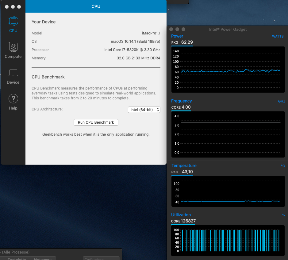

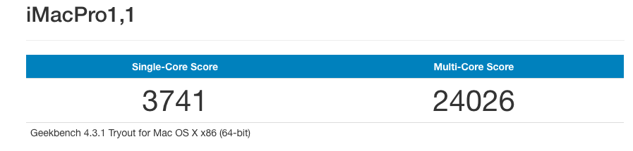

thanks for your feedback. Ive gone through your recommendations ones more and disabled my kerneltopatch entries which I found for haswell-E in various topics (insanelymac.com, most of them from nmano):
with your recommended patches i dont get xcpm speedsteping on 10.14.1, this is the bootstraß patch, the performance patch and smt scope 1/2 patches you recommend in your tutorial.
1338554350_Bildschirmfoto2018-12-15um16_09_51.thumb.png.4336199812512a1bf68621fe7a0b5e4a.png
my geekbench score is at the level I would say is max. for 4gh 5820k with slow 32gb ddr4 2133 mhz ram, but the cpu does not idle anymore, all the time full 4ghz frequency.
1735717491_Bildschirmfoto2018-12-15um16_12_50.png.fb14f0e721e2e7df86f960bfc0e683e7.png
1669113580_Bildschirmfoto2018-12-15um16_14_53.thumb.png.069bb3e4b39416183cb7f7d970a5ff4a.png

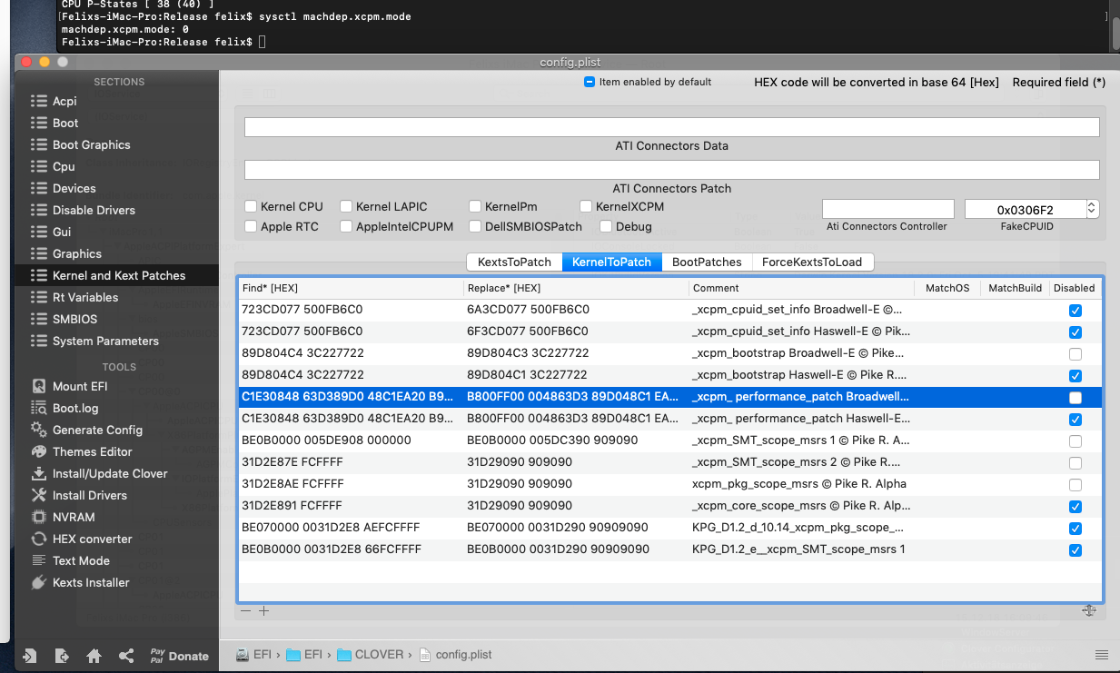

Because you have to change the bootstrap patch to Haswell-E! The one implemented in my EFI-Folder distrubution is for Broadwell-E! I told you that the correct bootstrap patch for Haswell-E  and further guidelines for the 5820K you can find in the README.md of my X99 EFI-Folder repository!
Edited by KGP-iMacPro
Hi KGP
ok next round after update to 10.14.2 with fakecpuid 0x0306F2
1) cpuid_set_info disabled
2) xcpm_bootstrap haswell-e enabled (from your readme.md on x99 repository
3) xcpm_performance_patch for 10.14.2 as posted above enabled
4) smt_scope_msrs 1/2 enabled
5) xcpm_pkg_scope_msrs enabled
no with xcpm mode 1 but just base frequency. the cpu does push to higher frequencies after boot:

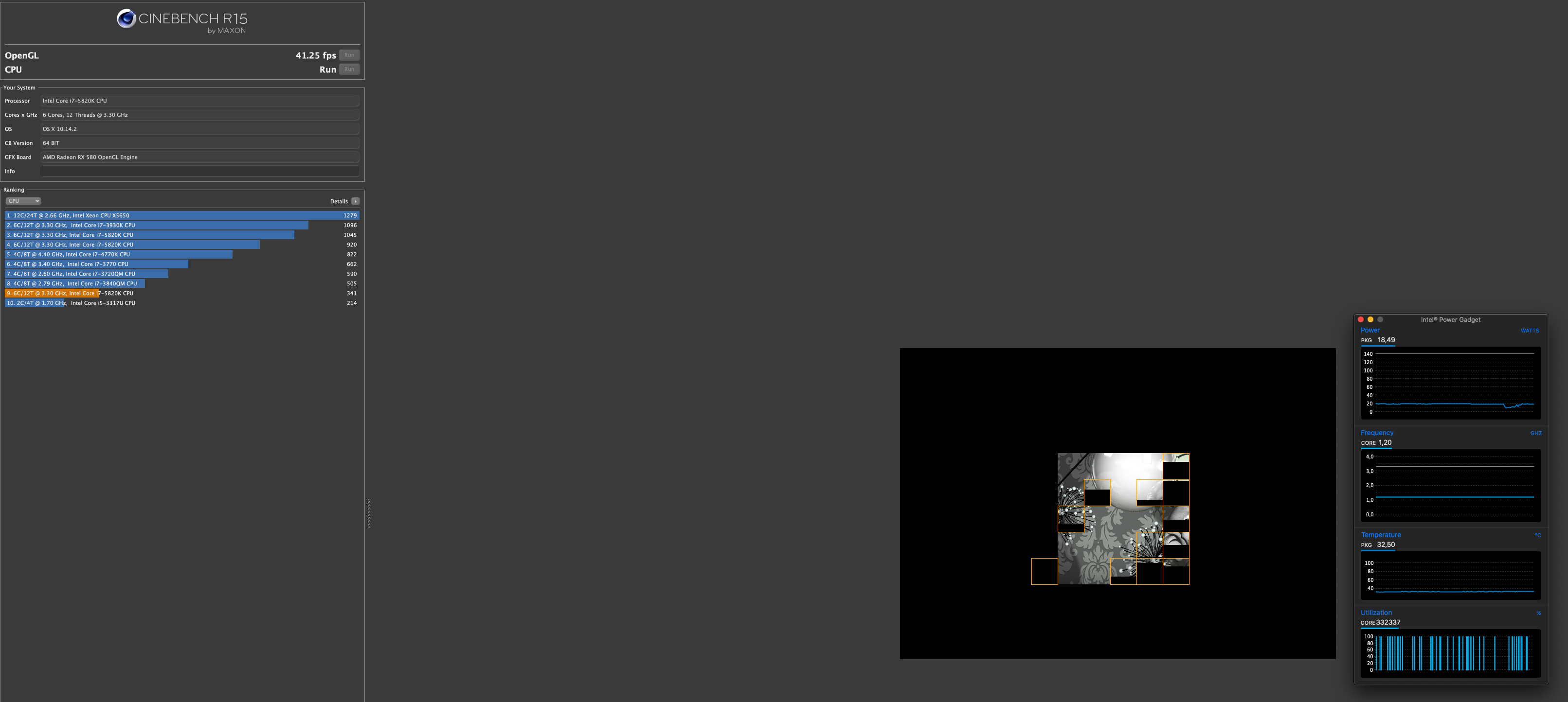

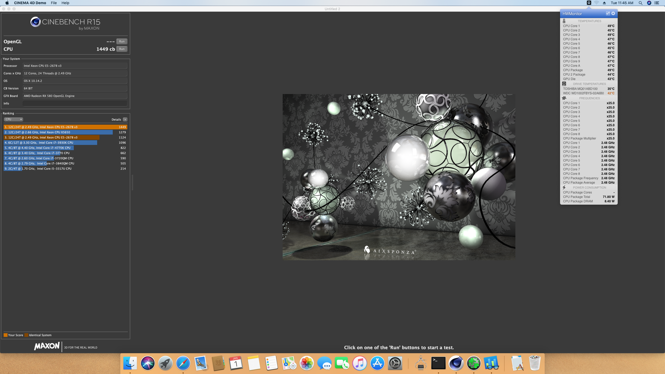

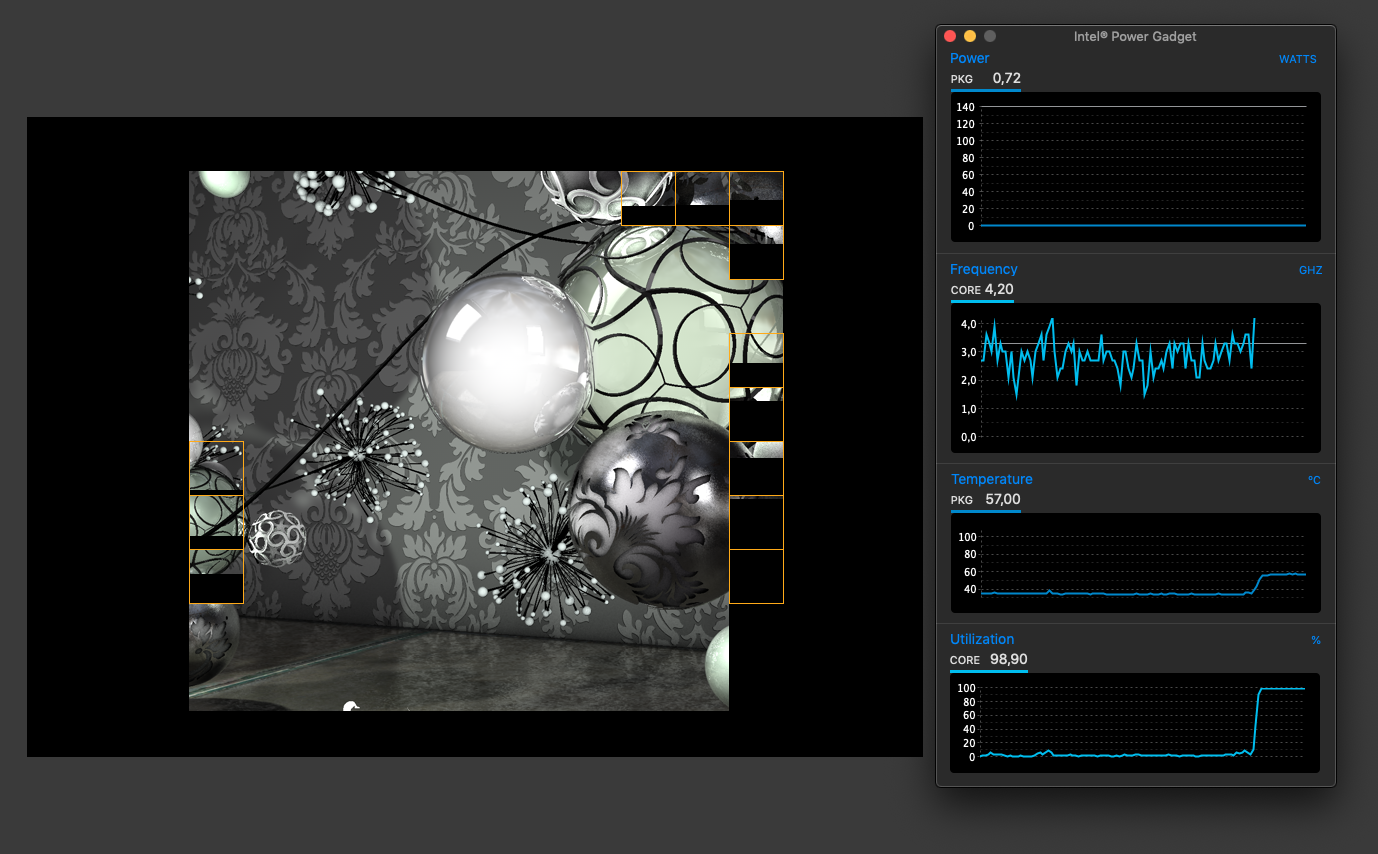

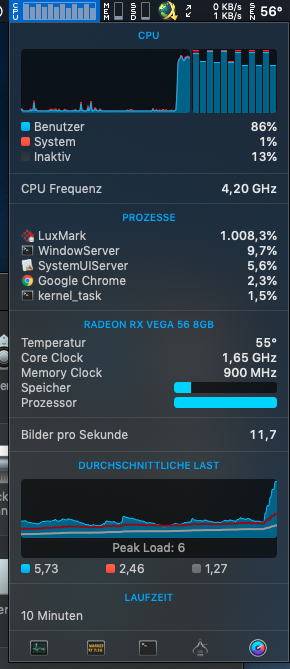

But the CPU goes above 4 GHz.. Show IPG snapshot for CPU IDLE and CPU max. Load (2-3 cinebench runs) conditions!
yes right at startup the cpu goes to 4ghz and than idles back as all the chrome windows etc. are loaded.
sorry what is an IPG snapshot?
cinebench does not wake the cpu up:
1032908315_Bildschirmfoto2018-12-15um17_50_15.thumb.png.93ba895972fa049e616a05f3775e7d5e.png

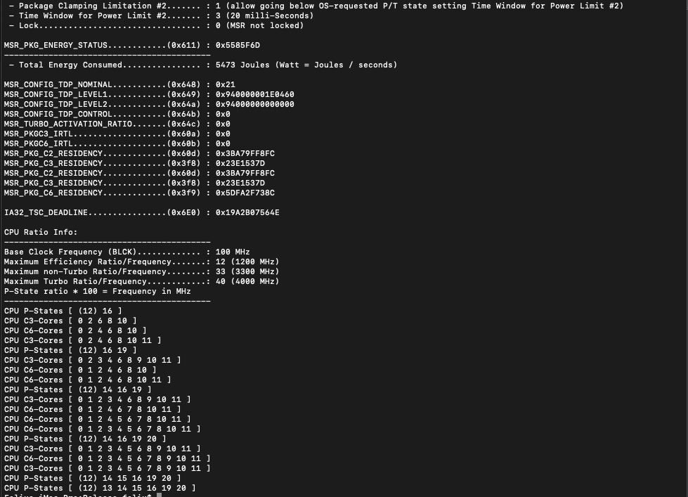

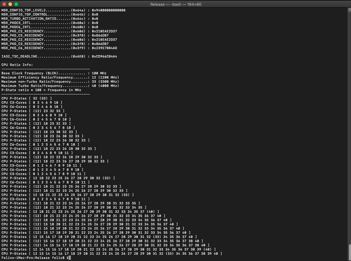

appleintelinfo does not find pstates of 40 etc.:
1329596964_Bildschirmfoto2018-12-15um17_51_43.png.3a51d9acb335dcb7774585a211560ce9.png

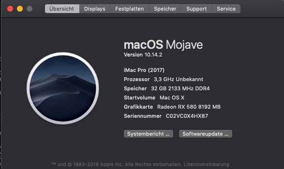

also switched to a sapphire pulse rx580 8GB, but no displayport out, only hdmi 30hz 4k (i know i need to follow your instructions on that).
CPU is unkown:
2076680564_Bildschirmfoto2018-12-15um17_54_08.png.31ed59b4b1d384be517a14966daac1c5.png

Plugintype checked in config.plist? TSCAdjustReset.kext in EFI-Folder?
Revise BIOS settings and play enabling, disabling the xcpm patches.
You do have different board but also CPU. I cannot help you further. However, there are several people successfully running the 5820K based on my guidelines.

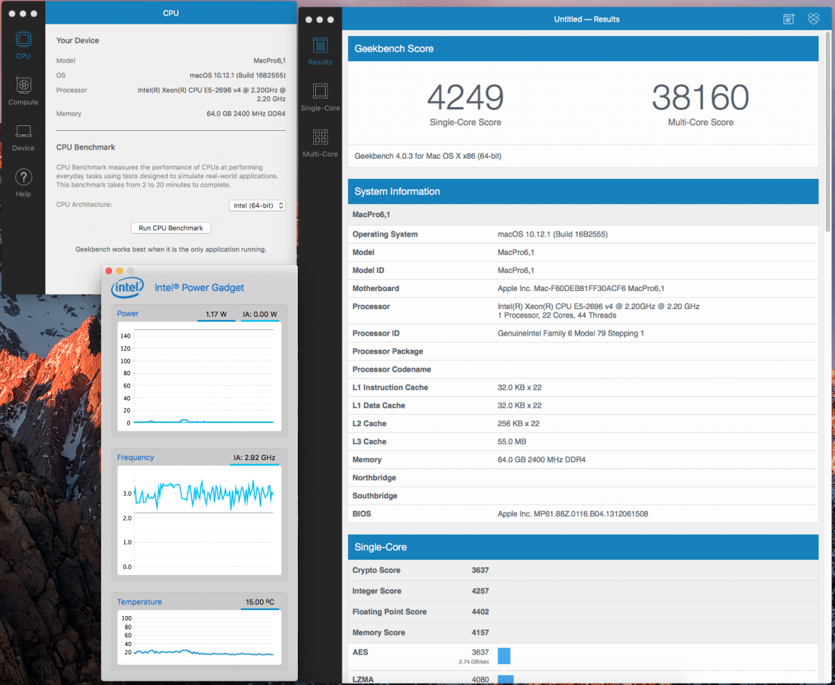

Hi KGP,i have same problem like Multisaft
i use your guide since 10.12.
my hardware
2696v3(haswell ep)
asrock x99 taichi
xcpm is loaded,pstate ok(12-38).bios patched.
update from 10.13.2 to 10.14.2
with your guide.
all cpu core will lock to 1.2Ghz after pc run some hours.
if i disable xcpm bootstrap patch,xcpm won't load,all core lock to 2.8Ghz.
if i use xcpm performance patch and xcpm msr patch in this post
the cpu freq will vary from 1.2 to 2.8,even i force run some heaveload program(cb r15),there may some core still keep 1.2-2.0.this make cb r15 score vary from 1000-2000(normal is 1900-2100) points in multi test.
make me feel like i'm using a 18 cores low freq notebook...
i think haswell-ep need another eist performance patch or xcpm msr patch.but these info is too less.
does anyone else with haswell-ep has cpu freq issue?
i'm not use this pc now,if u have time,need some info to help,i'll post info late.

yours
the _xcpm_pkg_scope_msrs _xcpm_SMT_scope_msrs 1 & 2 patch is different.
your patch will cause my cpu lock to 1.2Ghz after some hours.
his patch will cause my cpu freq vary from 1.2-2(half cores),2-2.8(half cores),random,which cause cinebench r15 score vary from 1000-2000.(normal 1900-2100).IGP package freq vary from 1.x to 2.x(below 2.5 even high load...)
in your guide post in another forum,i noticed someone(id:torock) use xeon 2660v3 also has same problem(xcpm ok,but freq not stable).
I guess some inaccurate kernel to patch entities cause these.and there's no much info about these thing.
now my pc like a 18 cores notebook with low freq,not fluence.the performance even worst than my i7 8700(mojave).
I consider change cpu to xeon 1680v3|v4.i use recc memory.i need xeon.
thanks your nice guide again.

thanks your reply.i read your guide and git readme carefuly.
I'm sure i set the right xcpm_bootstrap,FakeCPUID to haswell ep version(2696v3),disable or not the set_cpu_info patch not influence these.
and TSCAdjustRest,bios microcode patch,etc... set to right.
in  nmano's post,
he use
C1E3084863D389D048C1EA20B9990100000F3048FF05238376004883C4085B5DC30F1F4000
BB00FF00004863D389D048C1EA20B9990100000F3048FF0593AE76004883C4085B5DC39090
yours
Well my patches are exactly those of @PMheart. The SMT and pkg_scope patches are different between 10.13 and 10.14. The performance patch nearly changes for each macOS version. Are you sure you are using the correct patches for your macOS version? Between Broadwell and Haswell there is just a difference in the cpu_set_info and bootstrap patch. While both are obsolete for Broadwell-E, some Haswell CPU s still need the bootstrap patch. Else your CPU behavior will also strongly depend on your BIOS settings. If you have locked MSR, you also need to enable the core scope patch.
I guess you already considered all these advices. Unfortunately, I am not able to provide further help in this case.
With my i7-6950X everything works flawless with the patches implemented in my respective EFI-Folders. I can absolutely exclude that some of the patches do not meet the requirements.
Good luck,
KGP

Well thanks to this aweson guide well prepared and the TIME consume of this elite member, after a while my self been inactive on the Hackintosh hobbit, I got a succesed results first shot with this guide, it can not be no more precise of what it is already. Thanks a lot KGP for your kindness.
GB3-3925-61953
SS-1
SS-2
SS-3
SS-4
Well on GB-4 on Mojave I got a pretty preatty good result I think, in comparison the one I got in Sierra withe the same system setup. I never test this this system with High Sierra cause I was out of the hobbit for a while, but this are the results for Mojave.
SIERRA
GB4-4472-5139
Mojave
Edited by The Veteran

In addition, I found out that my pkg Power delivery is not monitored in intel power gadget. See attached my config.plist and screenshots.
1836298329_Bildschirmfoto2019-01-11um18_19_31.thumb.png.8064e5208388ad560994e02183b1ee03.png
711332083_Bildschirmfoto2019-01-11um18_20_52.png.8419f10698fd121d77b3a6894ba849c0.png

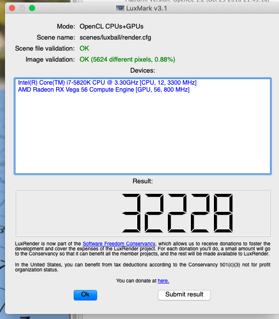

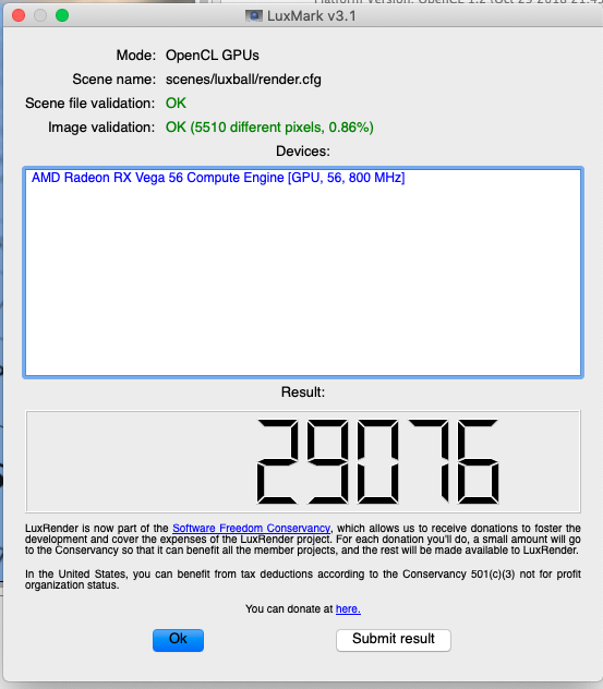

Luxmark gives me even 1.65GHz at GPU speed, nice.
1946240719_Bildschirmfoto2019-01-11um18_41_22.png.cd4fda6906636d52868f1fd4df0d5112.png
1149732332_Bildschirmfoto2019-01-11um18_42_22.png.cab0caedb1256af219bd4cc92a83b2c8.png
1010799040_Bildschirmfoto2019-01-11um18_45_26.png.5e40c5d9e4b5485cf45d6b1360d776a7.png

undervolted and oced to 1.66ghz with 900mhz ram clock, lowest possible idle rpm (0rpm does not work?)
results almost the same as above
