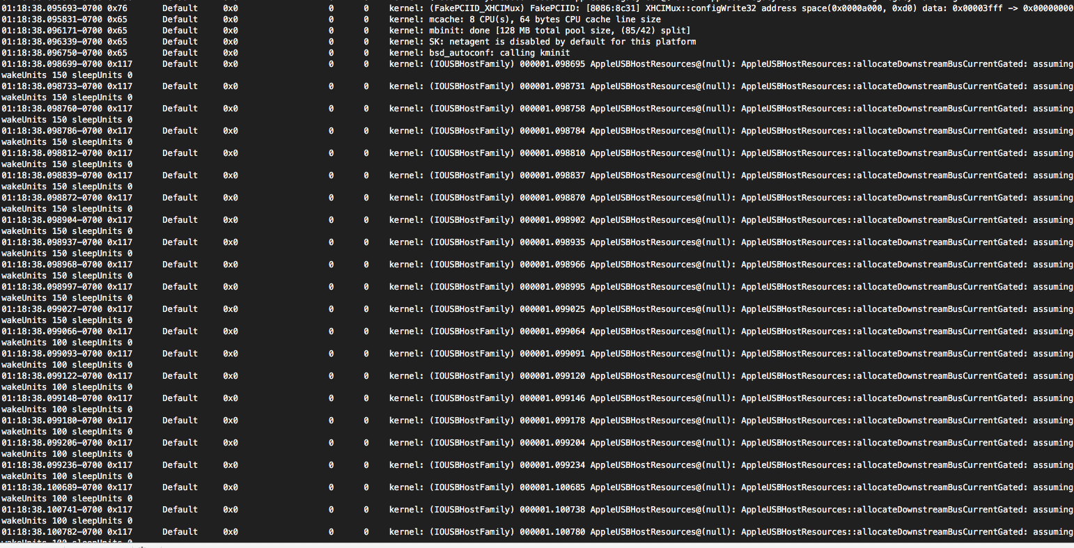

MaLd0n Posted June 3, 2018 Share Posted June 3, 2018 post a full dump and ppl try help u RunMe.app.zip 2 1 Link to comment Share on other sites More sharing options...
HBP Posted June 3, 2018 Author Share Posted June 3, 2018 here is the requested file, having looked at them, most of the area's that people have errors in are not present do to using Ozmosis boot loader instead of Clover. I have included my custom DSDT-SSDT's, and the archive of the last 4 panics. Send me Johns-iMac.zip Archive.zip DSDT-SSDT.zip HBP 1 Link to comment Share on other sites More sharing options...

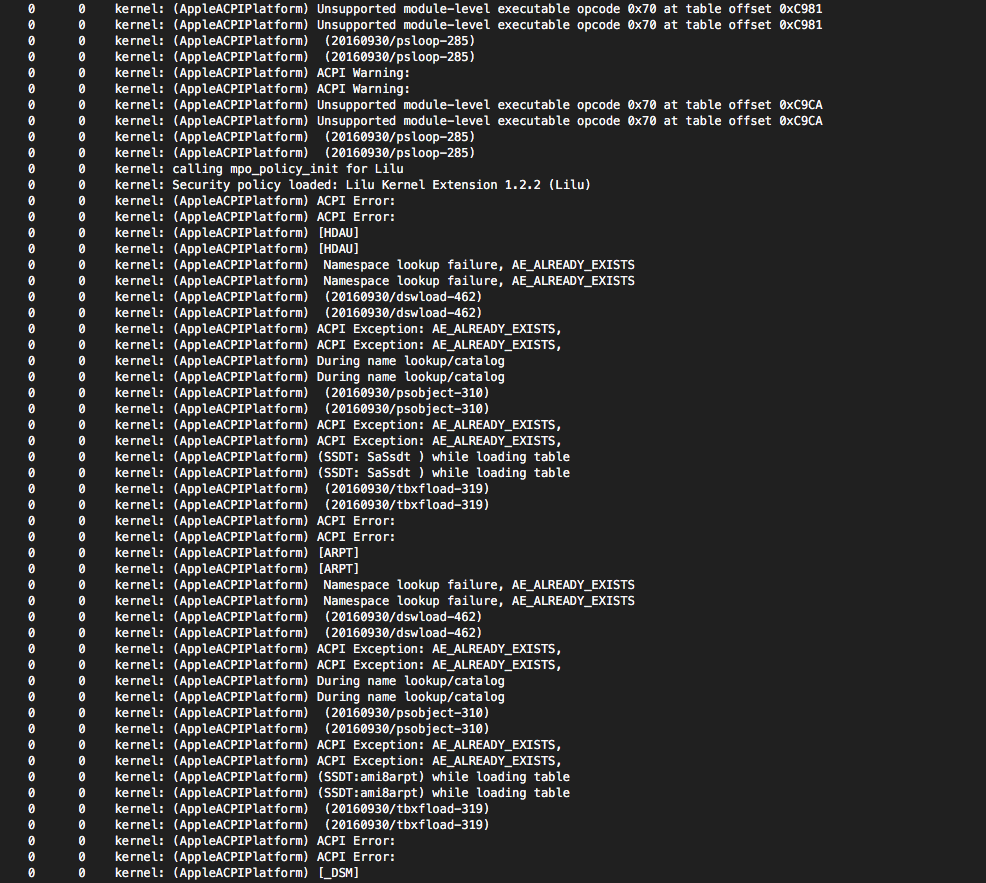

MaLd0n Posted June 3, 2018 Share Posted June 3, 2018 many many acpi errors wrong usb 2 1 Link to comment Share on other sites More sharing options...
ammoune78 Posted June 4, 2018 Share Posted June 4, 2018 Man, you're doing completely wrong things, the bios i've made have everything for, and i've noticed it! Remove everything from Load folder except ARPT SSDT, because your rom have DSDT, CpuSSDT and Graphics SSDT patched already, remove kexts also from Common folder. I see now why you have the problems from the screenshot, and good that i didn't replied with a new bios. 13 hours ago, MaLd0n said: post a full dump and ppl try help u RunMe.app.zip Absolutely in the right time with the right reply, thanks dude 1 Link to comment Share on other sites More sharing options...
