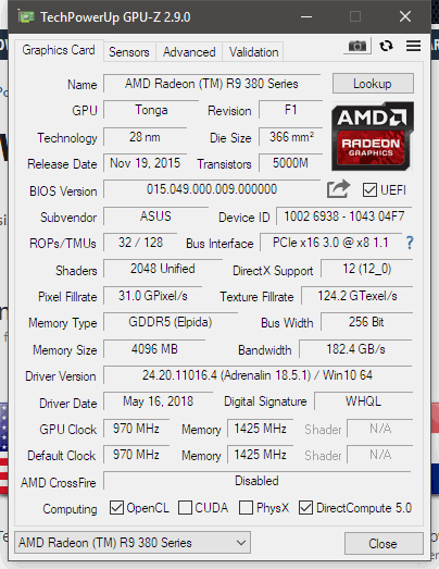

Cyberdevs Posted June 3, 2018 Share Posted June 3, 2018 1 minute ago, Pink Waters said: right ? I am going crazy over this. Actually i bought this VGA used. I wonder if it is not having the default bios on it and that is causing it ? There is a slight chance that the VBIOS might be changed. does it have a dual BIOS switch so you can switch it back to the original settings? You can also perform a VBIOS update which is a risky procedure and can brick your GPU if you're not careful or if something goes wrong in the process. Just to make sure: You don't try to boot into the macOS that was already installed are you? if so can you access the contents of the hdd and remove some files from it? These are the folders and files that you can remove: \Library\Caches Users\User\Library\Chaches \System\Library\Caches \System\Library\PrelinkedKernels\ don't remove this folder just remove the contents which should be : immutavlekernel, immutablekernel.whatever and prelikiedkernel By removing these files and folders macOS will create a new cache for the kext files that need to be loaded and it will create a new prelinkedkernel file as well. Link to comment https://www.insanelymac.com/forum/topic/334254-r9-380x-and-high-sierra-help/page/3/#findComment-2616444 Share on other sites More sharing options...
Pink Waters Posted June 3, 2018 Author Share Posted June 3, 2018 4 minutes ago, Cyberdevs said: There is a slight chance that the VBIOS might be changed. does it have a dual BIOS switch so you can switch it back to the original settings? You can also perform a VBIOS update which is a risky procedure and can brick your GPU if you're not careful or if something goes wrong in the process. Just to make sure: You don't try to boot into the macOS that was already installed are you? if so can you access the contents of the hdd and remove some files from it? These are the folders and files that you can remove: \Library\Caches Users\User\Library\Chaches \System\Library\Caches \System\Library\PrelinkedKernels\ don't remove this folder just remove the contents which should be : immutavlekernel, immutablekernel.whatever and prelikiedkernel By removing these files and folders macOS will create a new cache for the kext files that need to be loaded and it will create a new prelinkedkernel file as well. sadly it doesn't have a dual bios switch :/ not to mention i don't even know where to get the default bios... asus website doesn't have it i am not sure how to check if it has a bios update, probably it doesn't have. and yes i was trying to boot the installer not the system. and not sure if I need to delete these files, as the installer itself goes to black screen :/ This is what GPU-Z shows: Link to comment https://www.insanelymac.com/forum/topic/334254-r9-380x-and-high-sierra-help/page/3/#findComment-2616445 Share on other sites More sharing options...
Cyberdevs Posted June 3, 2018 Share Posted June 3, 2018 1 minute ago, Pink Waters said: sadly it doesn't have a dual bios switch :/ not to mention i don't even know where to get the default bios... asus website doesn't have it i am not sure how to check if it has a bios update, probably it doesn't have. and yes i was trying to boot the installer not the system. and not sure if I need to delete these files, as the installer itself goes to black screen :/ You can download the latest VBIOS for your GPU from Techpowerup.com's VBIOS collection is this your GPU? https://www.techpowerup.com/vgabios/182843/asus-r9380x-4096-151129 or https://www.techpowerup.com/vgabios/?architecture=AMD&manufacturer=Asus&model=R9+380X&interface=&memType=&memSize=&since= there are two GPUs that match yours check them out. From what I see it's the same issue that I had few years ago with my AMD Radeon 7790, it was getting the black screen even on elcappitan because of the customized BIOS that it had, so I had to patch the framebuffer and create the connectors patch to get it to work properly. It was pain in the neck and took me a while to figure it out. But the HDMI port always worked ok. I had two displays and it was working perfectly fine with one LED connected but when I was connecting the second display it wasn't working. Just search AMD Framebuffer modification in insanelymac.com and you'll find the topic. Link to comment https://www.insanelymac.com/forum/topic/334254-r9-380x-and-high-sierra-help/page/3/#findComment-2616446 Share on other sites More sharing options...
Pink Waters Posted June 3, 2018 Author Share Posted June 3, 2018 (edited) 1 hour ago, Cyberdevs said: You can download the latest VBIOS for your GPU from Techpowerup.com's VBIOS collection is this your GPU? https://www.techpowerup.com/vgabios/182843/asus-r9380x-4096-151129 or https://www.techpowerup.com/vgabios/?architecture=AMD&manufacturer=Asus&model=R9+380X&interface=&memType=&memSize=&since= there are two GPUs that match yours check them out. From what I see it's the same issue that I had few years ago with my AMD Radeon 7790, it was getting the black screen even on elcappitan because of the customized BIOS that it had, so I had to patch the framebuffer and create the connectors patch to get it to work properly. It was pain in the neck and took me a while to figure it out. But the HDMI port always worked ok. I had two displays and it was working perfectly fine with one LED connected but when I was connecting the second display it wasn't working. Just search AMD Framebuffer modification in insanelymac.com and you'll find the topic. I managed to flash the card and the card is working fine, but still get black screen after boot :/ I should just give up on this... Edit: I will check the framebuffer patching, even though it looks like it needs quite a study.. Edited June 3, 2018 by Pink Waters Link to comment https://www.insanelymac.com/forum/topic/334254-r9-380x-and-high-sierra-help/page/3/#findComment-2616461 Share on other sites More sharing options...
Cyberdevs Posted June 3, 2018 Share Posted June 3, 2018 Well sometimes things get complicated for no good reason. If you can try installing another version of macOS like El Capitan just to make sure that the card can perform ok under macOS which it should, that could be helpful. If you are up to the task!Few weeks ago I was working on a PC and it was giving me hell and the macOS installer couldn’t even start. I did a BIOS update and after that I installed macOS with no problem.You can also try something else. Let the macOS reach the point of the black screen and then unplug the cable from you GPU and the after few seconds replug it to the same port or the other one.Sent from my iPhone using Tapatalk Link to comment https://www.insanelymac.com/forum/topic/334254-r9-380x-and-high-sierra-help/page/3/#findComment-2616468 Share on other sites More sharing options...
Pink Waters Posted June 3, 2018 Author Share Posted June 3, 2018 43 minutes ago, Cyberdevs said: Well sometimes things get complicated for no good reason. If you can try installing another version of macOS like El Capitan just to make sure that the card can perform ok under macOS which it should, that could be helpful. If you are up to the task! Few weeks ago I was working on a PC and it was giving me hell and the macOS installer couldn’t even start. I did a BIOS update and after that I installed macOS with no problem. You can also try something else. Let the macOS reach the point of the black screen and then unplug the cable from you GPU and the after few seconds replug it to the same port or the other one. Sent from my iPhone using Tapatalk you mean, making a bootable USB installer of el capitan ? and see if the installer will boot ?, I can do that! you mean i should reinstall the same version of my bios again? becasue mine is the latest version. I tried replugging, doesn't work :/ Link to comment https://www.insanelymac.com/forum/topic/334254-r9-380x-and-high-sierra-help/page/3/#findComment-2616470 Share on other sites More sharing options...

Pink Waters Posted June 4, 2018 Author Share Posted June 4, 2018 14 minutes ago, Cyberdevs said: Yeah that’s what I meant. But honestly I’m just thinking out loud. It’s 4:40 AM and I’m running out of ideas! Sent from my iPhone using Tapatalk well turned out there is a new update for the bios, did it, but nothing changed, same black screen... well go get some sleep man Link to comment https://www.insanelymac.com/forum/topic/334254-r9-380x-and-high-sierra-help/page/3/#findComment-2616473 Share on other sites More sharing options...
Cyberdevs Posted June 4, 2018 Share Posted June 4, 2018 Is that the f11 BIOS version or a newer one?f12c is a beta BIOS which revising are you using after the update? It’s ok I can’t sleep right now I’m on a road trip Sent from my iPhone using Tapatalk Link to comment https://www.insanelymac.com/forum/topic/334254-r9-380x-and-high-sierra-help/page/3/#findComment-2616475 Share on other sites More sharing options...
Pink Waters Posted June 4, 2018 Author Share Posted June 4, 2018 hahaha, safe trip man yeah i updated to the beta f12c one. Link to comment https://www.insanelymac.com/forum/topic/334254-r9-380x-and-high-sierra-help/page/3/#findComment-2616489 Share on other sites More sharing options...
