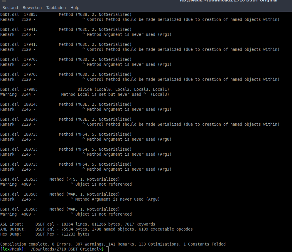

WaldMeister Posted April 10, 2018 Share Posted April 10, 2018 Hi, There was an extra }. I removed: Method (_QC6, 0, NotSerialized) // _Qxx: EC Query { CreateField (^^^PEG0.PEGP.TGPC, 0x0A, 0x02, PRGE) If ((ToInteger (PRGE) == Zero)) { ^^^PEG0.LNKD = One } ^^^PEG0.PEGP.SGPO (^^^PEG0.PEGP.HLRS (One, ^^^PEG0.PEGP.SGPO (^^^PEG0.PEGP.PWEN (Zero), If ((ToInteger (PRGE) == 0x02)) { ^^^PEG0.LNKD = One }))) And it compiles fine now. To disable the Nvidia card you should not need the method QC6. Unfortunatly i have no easy way to merge DSDT and SSDT under Linux, use MacIASL, gives a nice overview and trees also on the left. DSDT.dsl 2 Link to comment Share on other sites More sharing options...

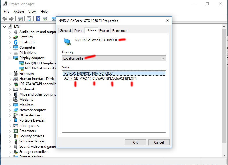

Allan Posted April 10, 2018 Share Posted April 10, 2018 Run this app, and upload the file result here. RunMe For disable your dGPU, use this SSDT: SSDT-DGPU.aml (1).zip But before you use this SSDT, you'll need find the address using Windows, look here: According to the image above device is PEGP inside PEG0, _SB.PCI0.PEG0.PEGP, modify the SSDT-DGPU for disable correct device and put the SSDT in Clover/Acpi/Patched folder. Credits: @MaLd0n 1 1 Link to comment Share on other sites More sharing options...
