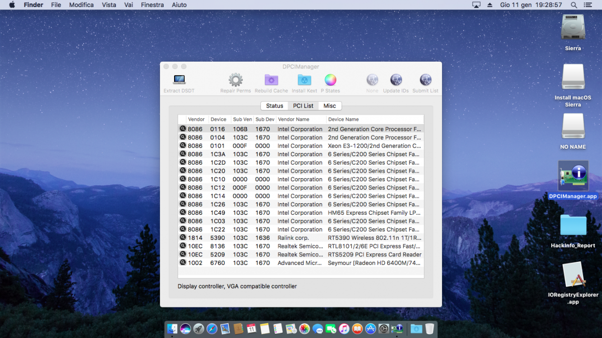

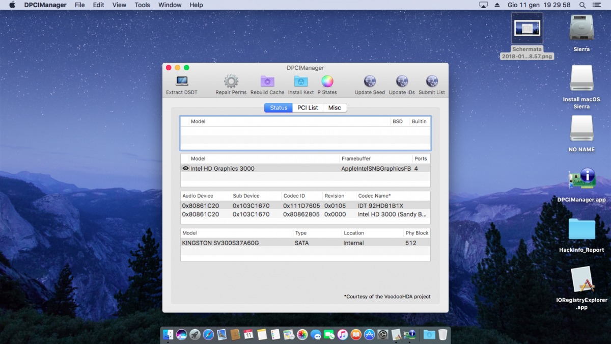

fabio8v Posted January 11, 2018 Share Posted January 11, 2018 (edited) Ho appena installato Sierra ecco le foto DPCI Manager Edited January 11, 2018 by gengik84 Link to comment https://www.insanelymac.com/forum/topic/331513-post-installazione-sierra-su-hp-g6/ Share on other sites More sharing options...

gengik84 Posted January 11, 2018 Share Posted January 11, 2018 fabio8v ti ho aggiunto io le foto che avevi inserito sulla guida allega anche il resto post #2 della guida Intanto..per la ethernet prova questo kext da collocare in EFI riavvia e controlla su preferenze/network se è riconosciuta Link to comment https://www.insanelymac.com/forum/topic/331513-post-installazione-sierra-su-hp-g6/#findComment-2567170 Share on other sites More sharing options...

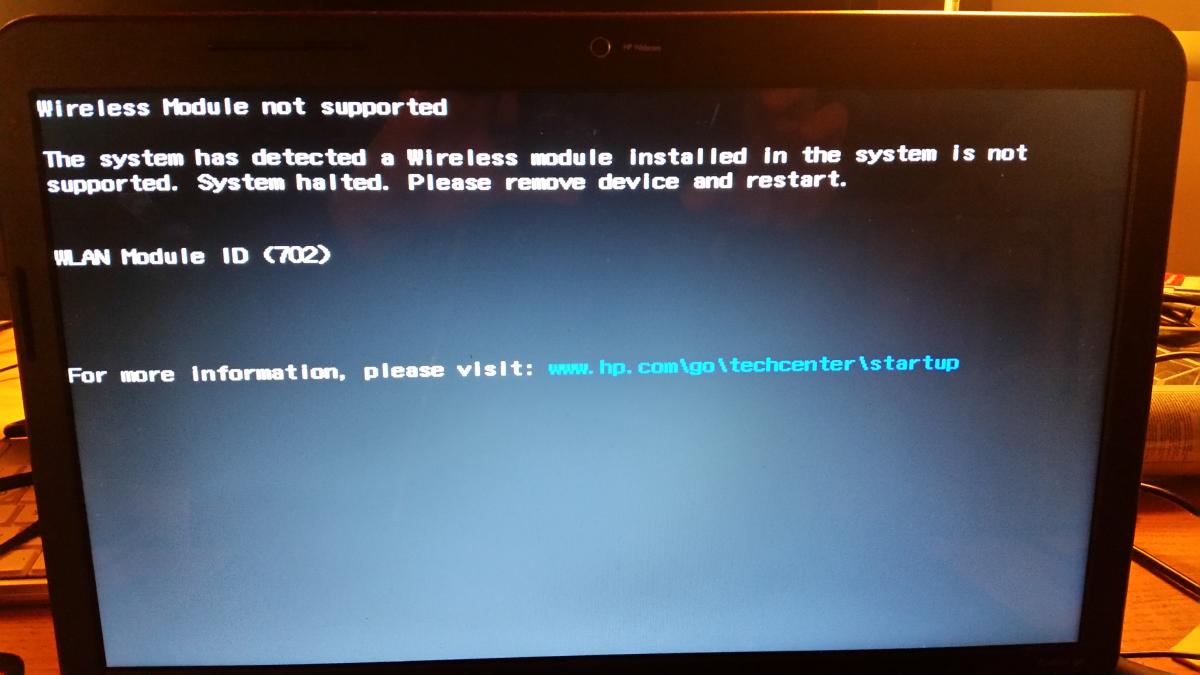

Jolly Posted January 11, 2018 Share Posted January 11, 2018 WiFi non compatibile Link to comment https://www.insanelymac.com/forum/topic/331513-post-installazione-sierra-su-hp-g6/#findComment-2567171 Share on other sites More sharing options...

fabio8v Posted January 11, 2018 Author Share Posted January 11, 2018 no..la scheda wired va..devo poi mettere l'audio intant aggiorno per il wifi cosa prendere? mi è venuta in mente una cosa...e se provassi a sostituire la ralink con una compatibile? Link to comment https://www.insanelymac.com/forum/topic/331513-post-installazione-sierra-su-hp-g6/#findComment-2567197 Share on other sites More sharing options...

fabio8v Posted January 11, 2018 Author Share Posted January 11, 2018 ho una ar5b195...andrà bene? Link to comment https://www.insanelymac.com/forum/topic/331513-post-installazione-sierra-su-hp-g6/#findComment-2567203 Share on other sites More sharing options...
Jolly Posted January 11, 2018 Share Posted January 11, 2018 Potrebbe andare bene, probabilmente ti serve toledaarpt e il kext per il firmware bluetooth Link to comment https://www.insanelymac.com/forum/topic/331513-post-installazione-sierra-su-hp-g6/#findComment-2567206 Share on other sites More sharing options...
fabio8v Posted January 11, 2018 Author Share Posted January 11, 2018 per la radeon? per il wifi mi ero illuso Link to comment https://www.insanelymac.com/forum/topic/331513-post-installazione-sierra-su-hp-g6/#findComment-2567243 Share on other sites More sharing options...
gengik84 Posted January 11, 2018 Share Posted January 11, 2018 la ati è disattivata...userai la HD3000 per il wifi...hai la whitelist sul bios... dovresti prendere quella che ha in firma @Jolly Link to comment https://www.insanelymac.com/forum/topic/331513-post-installazione-sierra-su-hp-g6/#findComment-2567270 Share on other sites More sharing options...
fabio8v Posted January 11, 2018 Author Share Posted January 11, 2018 quella che ho messo è compatibile mac...non è compatibile con il mio laptop..credo che ci vada solo la sua Link to comment https://www.insanelymac.com/forum/topic/331513-post-installazione-sierra-su-hp-g6/#findComment-2567273 Share on other sites More sharing options...
gengik84 Posted January 11, 2018 Share Posted January 11, 2018 leggi quanto ho scritto... Link to comment https://www.insanelymac.com/forum/topic/331513-post-installazione-sierra-su-hp-g6/#findComment-2567278 Share on other sites More sharing options...
fabio8v Posted January 11, 2018 Author Share Posted January 11, 2018 sì..avevo letto...non so se jolly l'ha cambiata oppure è nativa Link to comment https://www.insanelymac.com/forum/topic/331513-post-installazione-sierra-su-hp-g6/#findComment-2567281 Share on other sites More sharing options...
Jolly Posted January 11, 2018 Share Posted January 11, 2018 Cambiata quella originale non era compatibile Link to comment https://www.insanelymac.com/forum/topic/331513-post-installazione-sierra-su-hp-g6/#findComment-2567293 Share on other sites More sharing options...
