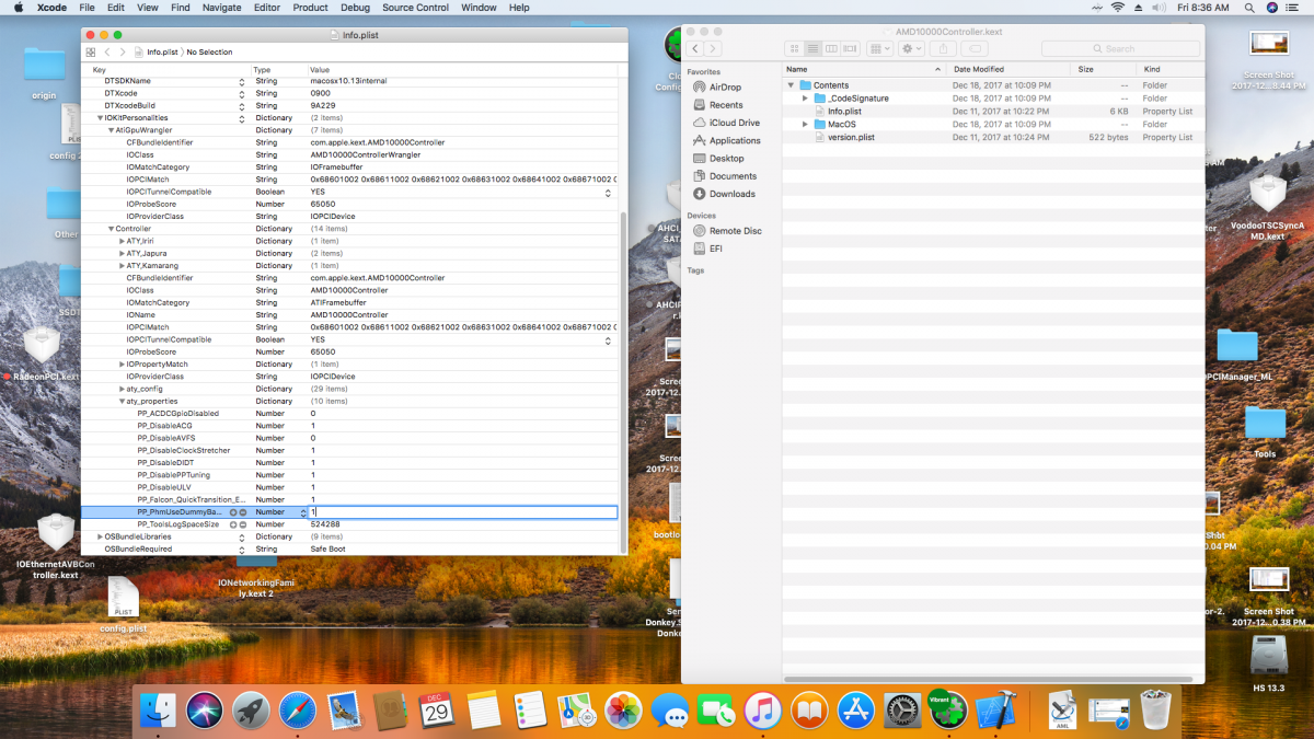

kn6600 Posted December 28, 2017 Share Posted December 28, 2017 Hi, I managed to fix fun issue on Vega card with modification of Info.plist from AMD10000Controller.kext. Change value for "PP_PhmUseDummyBackEnd" from 0 to 1 ( to enable Dummy Backend). With this I don't have flashing power leds and fans are normal. - edit Fans are ok but youtube is hanging on 1440p , please check. 4 Link to comment https://www.insanelymac.com/forum/topic/331063-possible-fix-for-rx-vega-fan-speed-issue/ Share on other sites More sharing options...

Gigamaxx Posted December 29, 2017 Share Posted December 29, 2017 This method works well. My vega 64 does not flash, the fan is normal. Thank you! Do not know whether to use clover to achieve change safari only supports 1440p youtube 4K Please use Chrome Fix this file, GPU up to 1Ghz Geekbench Score 136XXX This seems regrettable No fix, GPU up to 1.765Ghz Geekbench Score 209XXX (I can not upload pictures) So its dropping your frequency? Wonder if another value could be used or if following this edit to source and looking in the RadeonxController to adjust values manually? Here is a pic of the fix using xCode. Link to comment https://www.insanelymac.com/forum/topic/331063-possible-fix-for-rx-vega-fan-speed-issue/#findComment-2558119 Share on other sites More sharing options...

wyhtc Posted January 20, 2018 Share Posted January 20, 2018 So its dropping your frequency? Wonder if another value could be used or if following this edit to source and looking in the RadeonxController to adjust values manually? Here is a pic of the fix using xCode. Screen Shot 2017-12-29 at 8.36.54 AM.png Bad news,if you use amd graphics driver from bootcamp driver in Windows,the fan also in high speed like it in macOS 10.13.2 It seems that the apple is doing this on purpose. Link to comment https://www.insanelymac.com/forum/topic/331063-possible-fix-for-rx-vega-fan-speed-issue/#findComment-2572699 Share on other sites More sharing options...
