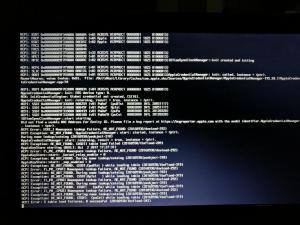

felixaa Posted December 7, 2017 Share Posted December 7, 2017 Hi there! I had been trying install High Sierra in a working Laptop with ElCapitan.The model is an "Acer Aspire 5741g with ATI Mobility Radeon HD 5470 and Core i3-330M"As I've said before, this setup is working realy fine with ElCapitan:- ATI Radeon HD 5470 framebuffer/InjectEDID/... set in Clover- SMBIOS MacBookPro6,2- sleep/wakeup- Fn keys: Volume, Mute, BrightnessI trying to boot with High Sierra USB Installer but always it's stuck on this point ...ACPI Exception: AE_NOT_FOUND ...What I can do next??Thanks pals. config.plist.zip Link to comment https://www.insanelymac.com/forum/topic/330401-stuck-on-acpi-exception-ae_not_found-in-a-acer-aspire-5741g/ Share on other sites More sharing options...
artur_pt Posted December 7, 2017 Share Posted December 7, 2017 hello try this config config.plist.zip is a mess that config https://clover-wiki.zetam.org/Configuration#config-plist-structure good hack Link to comment https://www.insanelymac.com/forum/topic/330401-stuck-on-acpi-exception-ae_not_found-in-a-acer-aspire-5741g/#findComment-2546101 Share on other sites More sharing options...
felixaa Posted December 8, 2017 Author Share Posted December 8, 2017 wow! @artur_pt thanks!!!, your config.plist do the trick ... I could boot and install macOS I compare your config.plist with mine and just wanna know what make it work. In yours: -- Fixes are disable -- Patches are disable -- DropTables are disable -- HaltEnabler has Generate > CStates and PStates to "true" -- Removed BootGraphics -- Removed ScreenResolution -- CsrActiveConfig is at 0x67 from original (0x3E7) Which are the settings that prevent the "ACPI Exception AE_NOT_FOUND" error?? Thanks a ton man 1 Link to comment https://www.insanelymac.com/forum/topic/330401-stuck-on-acpi-exception-ae_not_found-in-a-acer-aspire-5741g/#findComment-2546282 Share on other sites More sharing options...
artur_pt Posted December 8, 2017 Share Posted December 8, 2017 hello maybe is all the patches and fixes u have apply to the config ... before u are using a general config .. clover need a custom config for the specific hardware he try to boot that's why I post the link to the clover wiki .. make a easy config .. what u don't know .. don't use or enable .. clover will do that for u .. good hack Link to comment https://www.insanelymac.com/forum/topic/330401-stuck-on-acpi-exception-ae_not_found-in-a-acer-aspire-5741g/#findComment-2546443 Share on other sites More sharing options...
