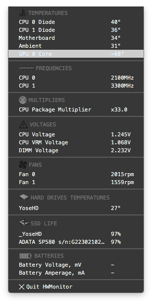

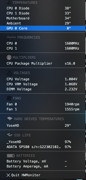

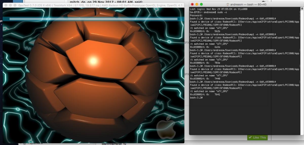

Sir, you want heavy GPU  load?!, Sir :)
Then you get it :)
running Geeks3D Tessmark X64 -
Before (idle, Desktop):
RadeonDump1 -n 6b0,c0300014 ... 0xc0300014: 0x    562b (43 Celsius?)
Start GPU stress:
0xc0300014: 0x    6a3a > 0xc0300014: 0x    703e (62 C)
Near Eend of GPU Test:   0xc0300014: 0x    7641 (65 C)
Very short after gpu load ends :
0xc0300014: 0x    6a36 (54 C) > 0xc0300014: 0x    6633 (51 C)
Now, after about 3 Min idle:
0xc0300014: 0x    5028 (40 C)

doesn't crash anymore, but GPU 0 Core Temp -127° C ?!? (and NO, it is NOT cooled by liquid oxygen, just a one mile diameter fan with a million RpS)
but anyway... nice job.
Can you, please, look into system.log or dmesg to find messages from RadeonMonitor?
HD 7790  GPU 0
17    0 0xffffff7f8397a000 0x5000     0x5000     org.slice.RadeonMonitor (1.3.1) A388BA0F-9378-333A-8061-C9FE496C5B40

Picos-Mac-Pro:radeon pico$  ./RadeonDump1 -n 6b0,c0300e0c
Found a device of class RadeonPCI: IOService:/AppleACPIPlatformExpert/PCI0@0/AppleACPIPCI/PEGP@1/IOPP/GFX1@0/RadeonPCI
it matched on name "ATY_GPU"
0xc0300e0c: 0x       0
It looks like HD7790 is other family. I see no a good method to get temperature for it.

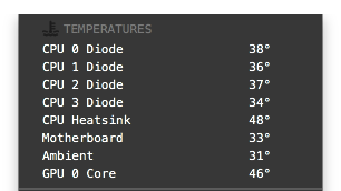

I found the mistake
Here
https://sourceforge.net/p/hwsensors/hwsensors3/code3/HEAD/tree/trunk/plugins/GPUSensors/RadeonMonitor/ATICard.cpp#l21
line:
IOPhysicalAddress bar = (IOPhysicalAddress)((VCard->configRead32(0x20)) & ~0x3f);
Must be 0x24 instead of 0x20
