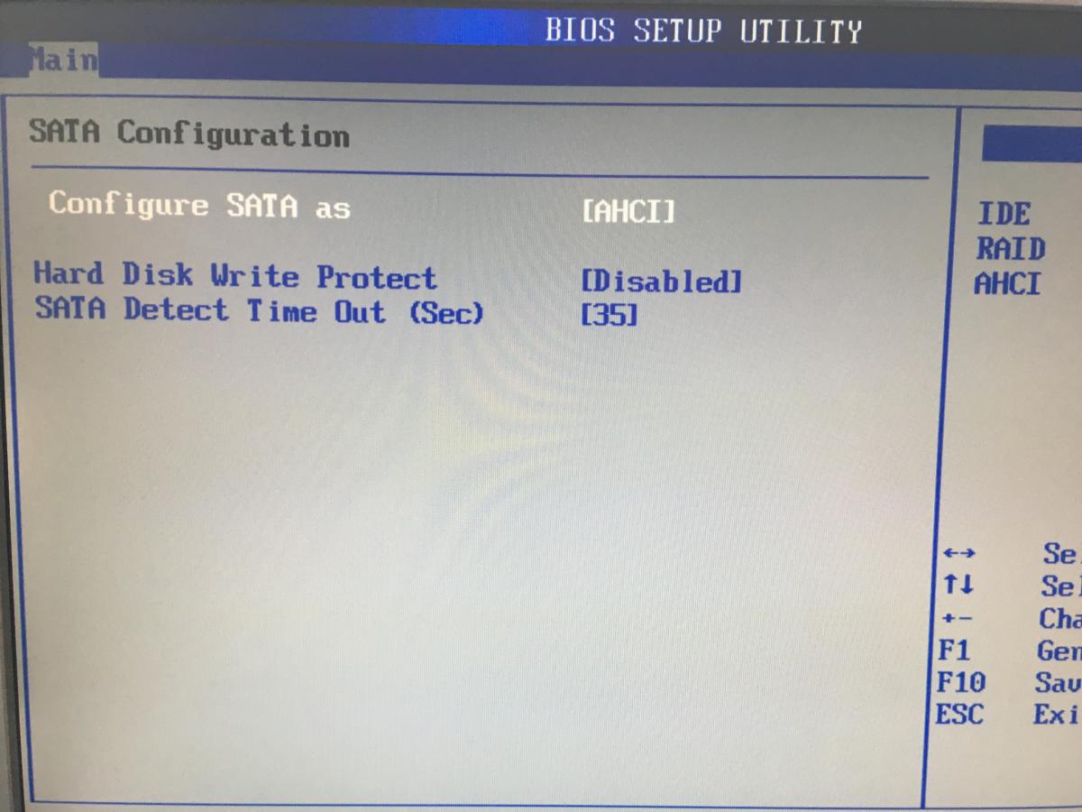

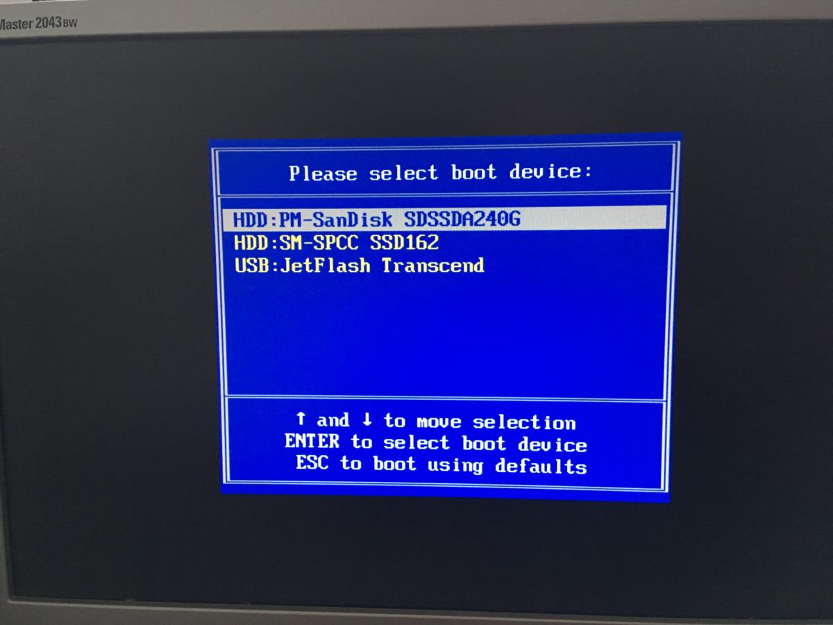

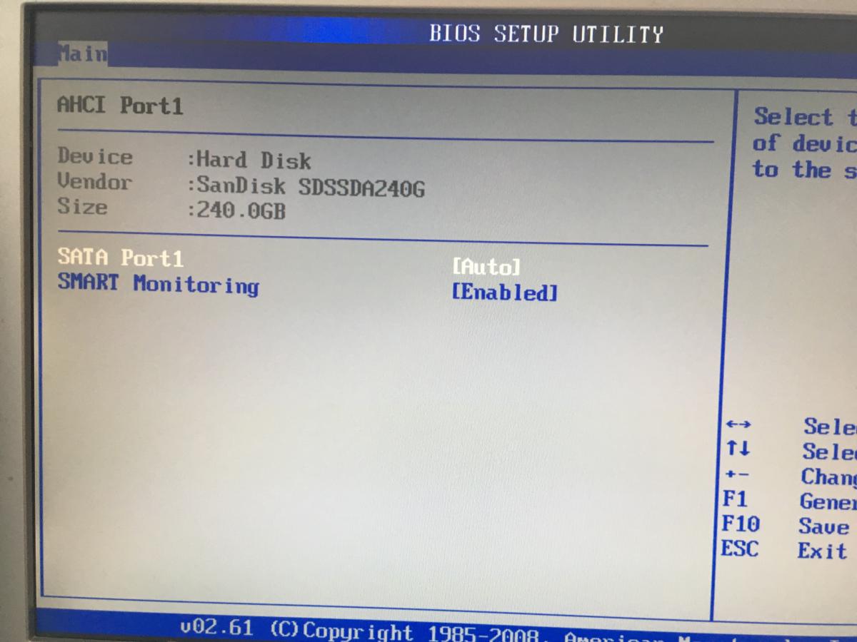

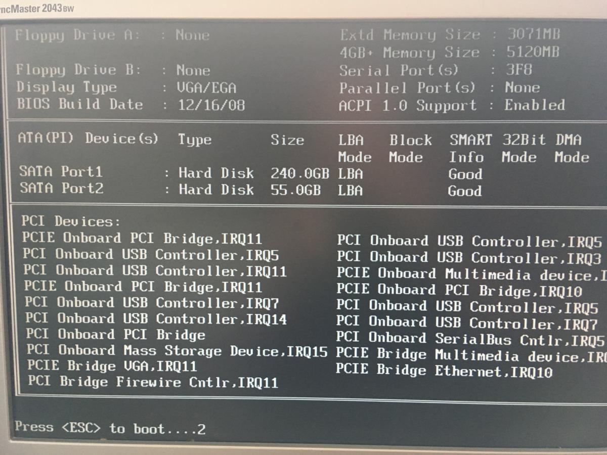

fgtd2 Posted November 19, 2017 Share Posted November 19, 2017 Hello friends, High Sierra installer doesn't recognize any SATA SSD drives on my machine. Both SSD drives show up in BIOS and Clover. I can even do a boot from Clover when I select an SSD drive (but I need to do a fresh install, that's why I ask this question). How do I make High Sierra recognize SSD? I am running necro setup ASUS P5K-PRO (775 socket) with XEON E5450 on board. Latest BIOS is 1303 with 771 socket microcodes and AHCI support added. AHCI enabled for both SATA drives. I am using FakeSMC, NullCPUPowerManagement kexts. Command line argument I need to boot to installer is ncpi=0x2000 One drive is brand new, the other one works fine on another machine. Link to comment https://www.insanelymac.com/forum/topic/329794-high-sierra-installer-doesnt-see-ssd-drives-asus-p5k-pro-xeon-e5450/ Share on other sites More sharing options...

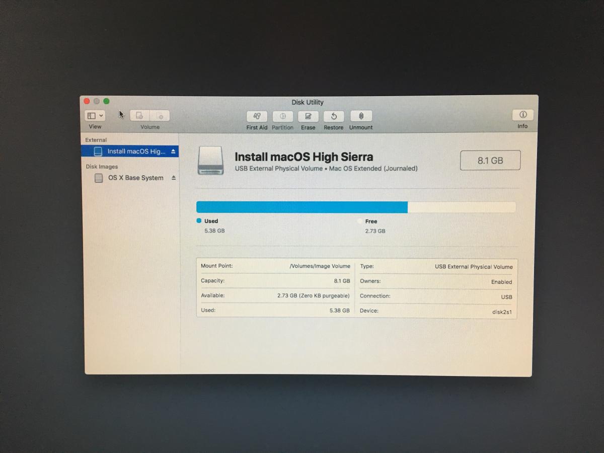

fgtd2 Posted November 19, 2017 Author Share Posted November 19, 2017 Thank you, I will try that. Just wanted to add that my SSD drive appears in a diskutil list output in the installer. Link to comment https://www.insanelymac.com/forum/topic/329794-high-sierra-installer-doesnt-see-ssd-drives-asus-p5k-pro-xeon-e5450/#findComment-2536877 Share on other sites More sharing options...
fgtd2 Posted November 19, 2017 Author Share Posted November 19, 2017 @artur_pt, No luck, unfortunately. SSD drive didn't appear in disk utility GUI. Link to comment https://www.insanelymac.com/forum/topic/329794-high-sierra-installer-doesnt-see-ssd-drives-asus-p5k-pro-xeon-e5450/#findComment-2536892 Share on other sites More sharing options...

fgtd2 Posted November 19, 2017 Author Share Posted November 19, 2017 Thank you very much for your cooperation. The solution turned out to be really simple. I had to format SSD to HFS+ GUID on another machine after that installer's disk utility was able to recognize my SSD. Link to comment https://www.insanelymac.com/forum/topic/329794-high-sierra-installer-doesnt-see-ssd-drives-asus-p5k-pro-xeon-e5450/#findComment-2536970 Share on other sites More sharing options...
