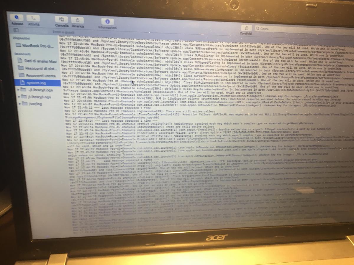

Jolly Posted November 17, 2017 Share Posted November 17, 2017 Devi cliccare su syslog per vedere quello e poi premere i pulsanti che ti interessano Link to comment https://www.insanelymac.com/forum/topic/328961-installazione-high-sierra/page/3/#findComment-2536085 Share on other sites More sharing options...

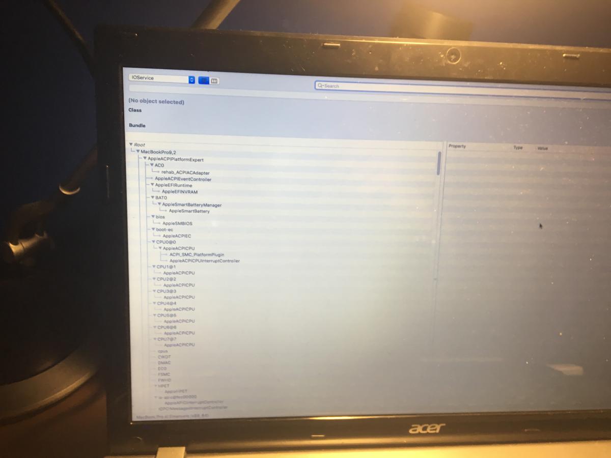

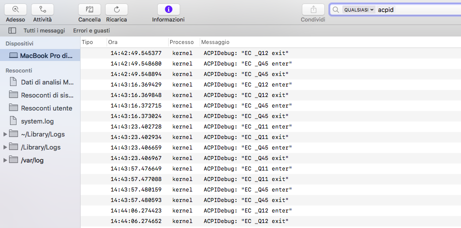

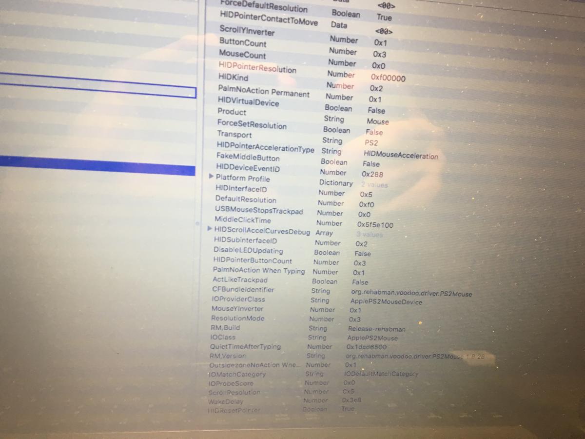

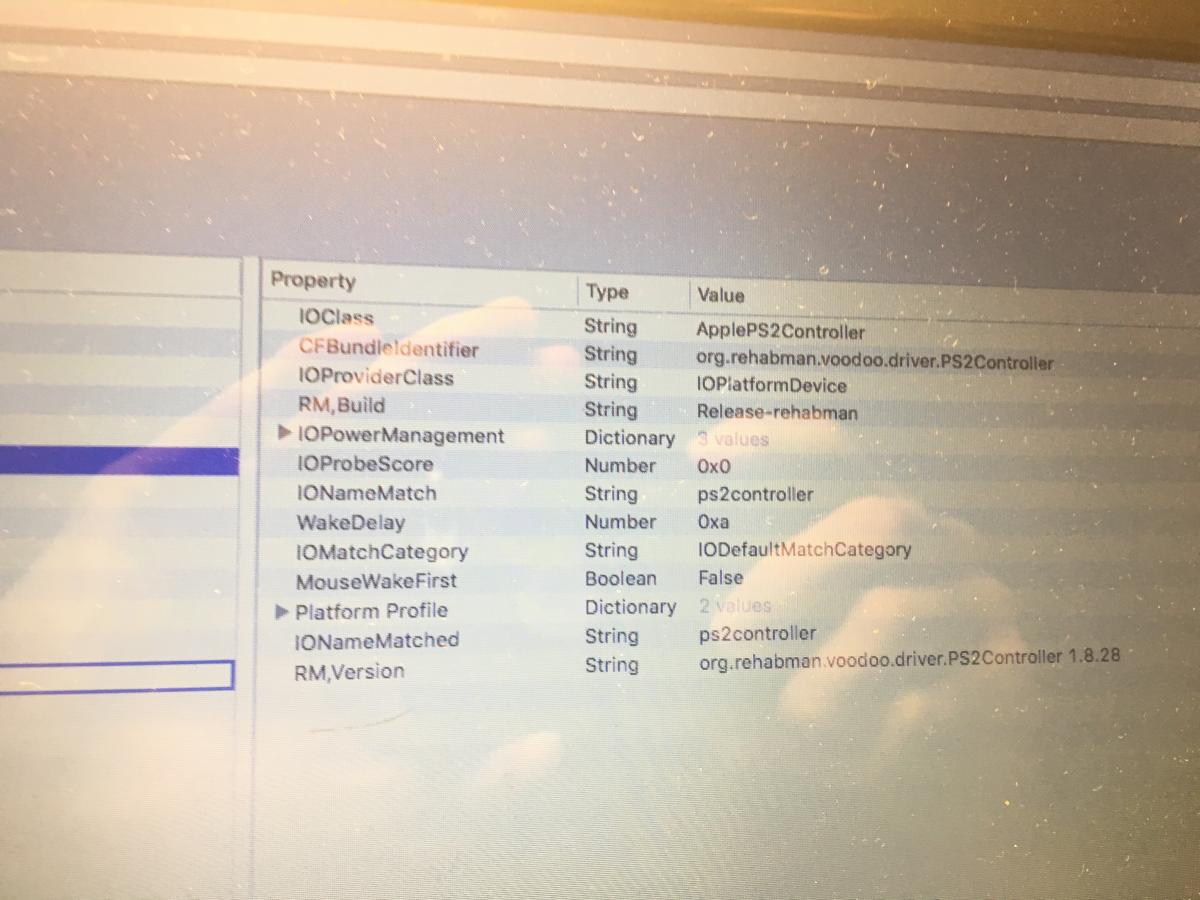

Emanuele-1998 Posted November 17, 2017 Author Share Posted November 17, 2017 Come devo scrivere per trovare l'ioreg del trackpad? Link to comment https://www.insanelymac.com/forum/topic/328961-installazione-high-sierra/page/3/#findComment-2536090 Share on other sites More sharing options...

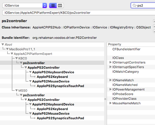

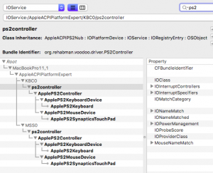

foskvs Posted November 17, 2017 Share Posted November 17, 2017 Metti PS2 nel campo di ricerca. Fai uno screen a quello che ti mostra. Link to comment https://www.insanelymac.com/forum/topic/328961-installazione-high-sierra/page/3/#findComment-2536096 Share on other sites More sharing options...
Emanuele-1998 Posted November 17, 2017 Author Share Posted November 17, 2017 Quale devo fotografare? Link to comment https://www.insanelymac.com/forum/topic/328961-installazione-high-sierra/page/3/#findComment-2536099 Share on other sites More sharing options...
foskvs Posted November 17, 2017 Share Posted November 17, 2017 Ti faccio un esempio. Edit: Ecco qua: Link to comment https://www.insanelymac.com/forum/topic/328961-installazione-high-sierra/page/3/#findComment-2536100 Share on other sites More sharing options...

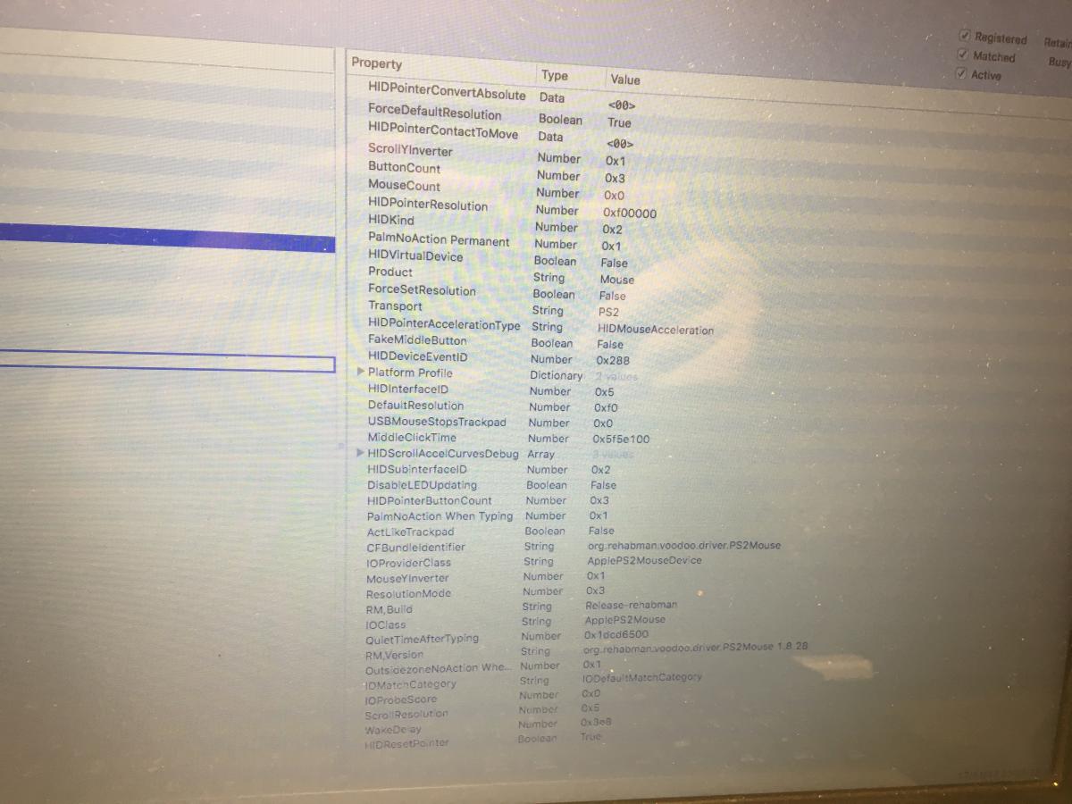

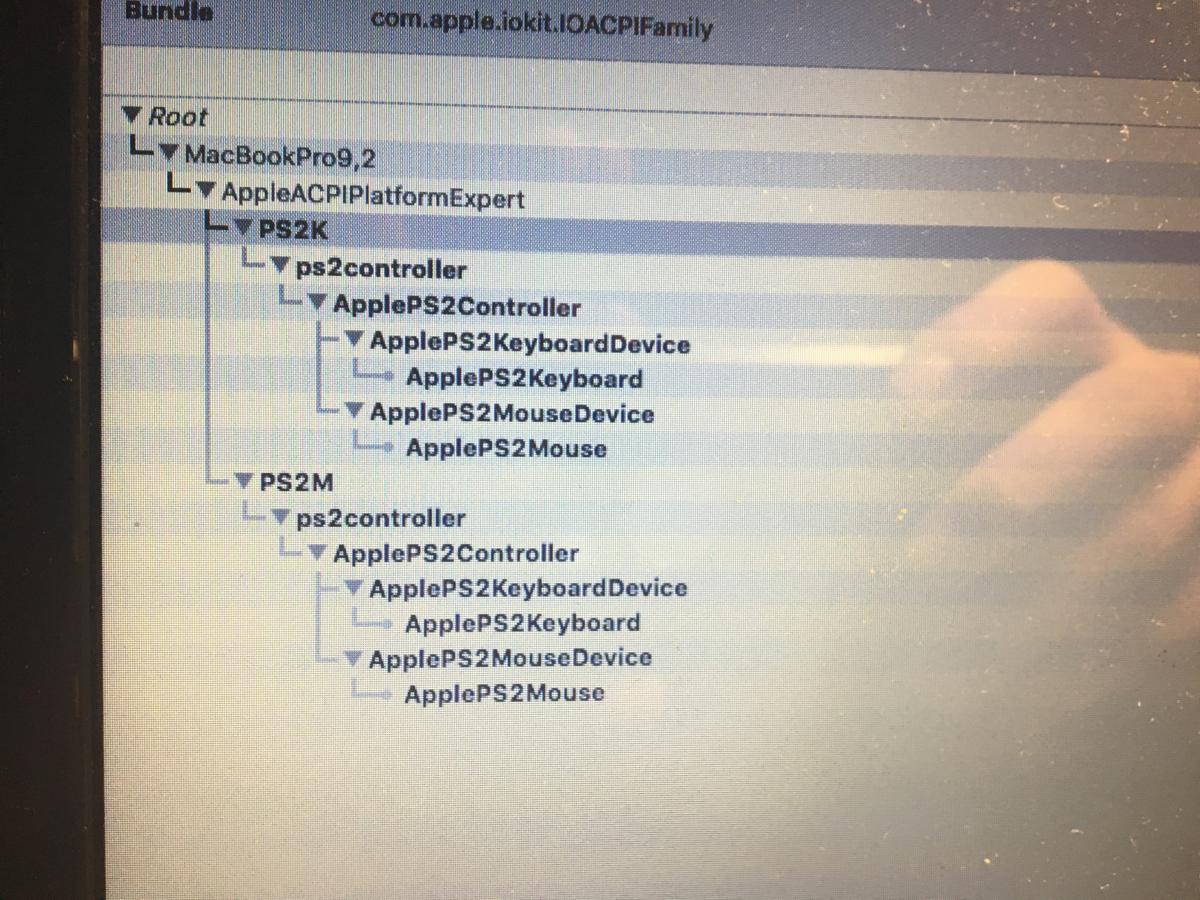

Emanuele-1998 Posted November 17, 2017 Author Share Posted November 17, 2017 ma non so quale Ho allegato tutto dalle foto foskvsk Link to comment https://www.insanelymac.com/forum/topic/328961-installazione-high-sierra/page/3/#findComment-2536102 Share on other sites More sharing options...
foskvs Posted November 17, 2017 Share Posted November 17, 2017 Da IORegistryExplorer vai su File -> Save As... e allega il file generato. Link to comment https://www.insanelymac.com/forum/topic/328961-installazione-high-sierra/page/3/#findComment-2536112 Share on other sites More sharing options...

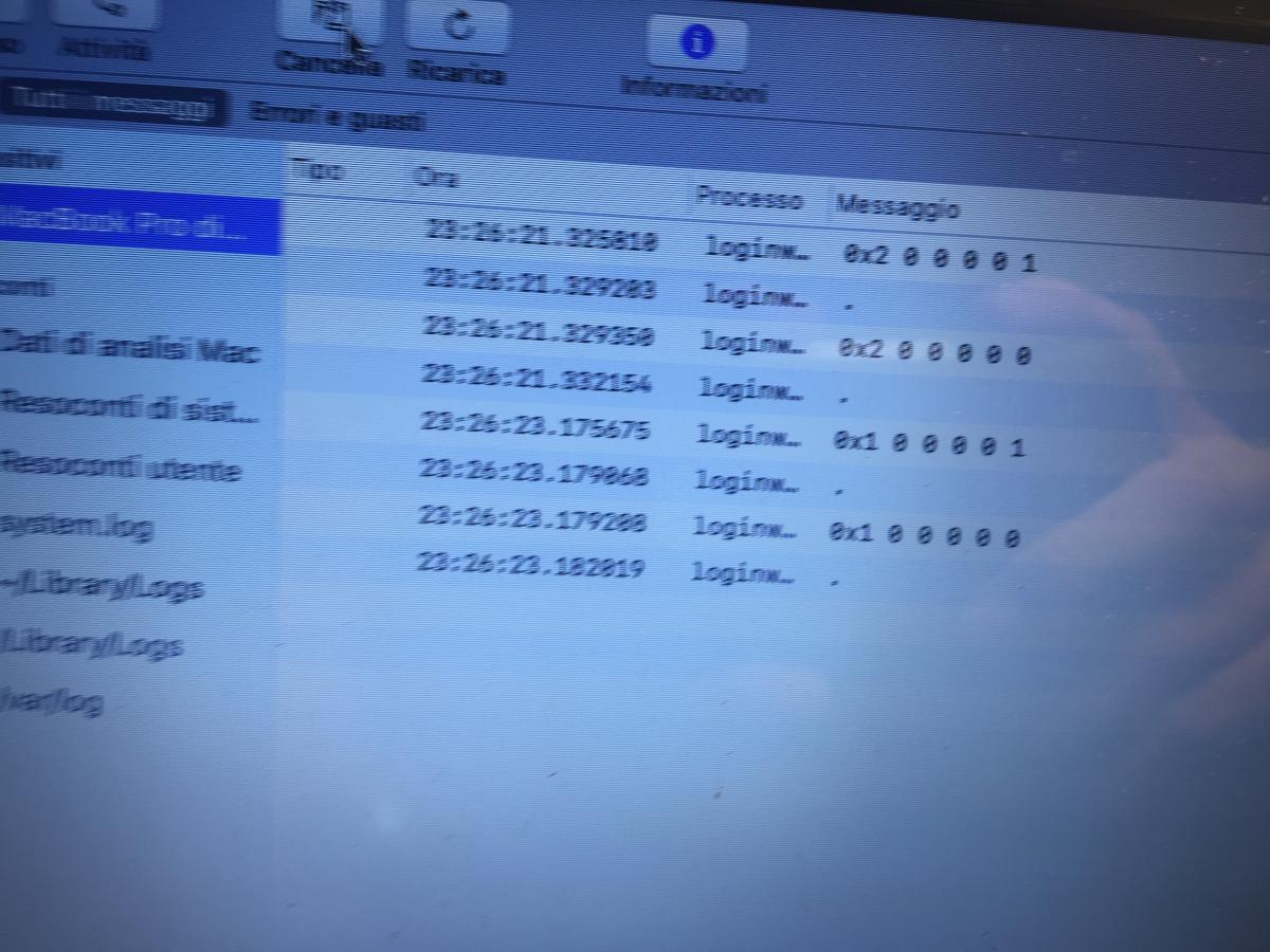

Emanuele-1998 Posted November 17, 2017 Author Share Posted November 17, 2017 Ok,grazie! Mentre per la luminosità non ho capito cosa devo fare Link to comment https://www.insanelymac.com/forum/topic/328961-installazione-high-sierra/page/3/#findComment-2536118 Share on other sites More sharing options...

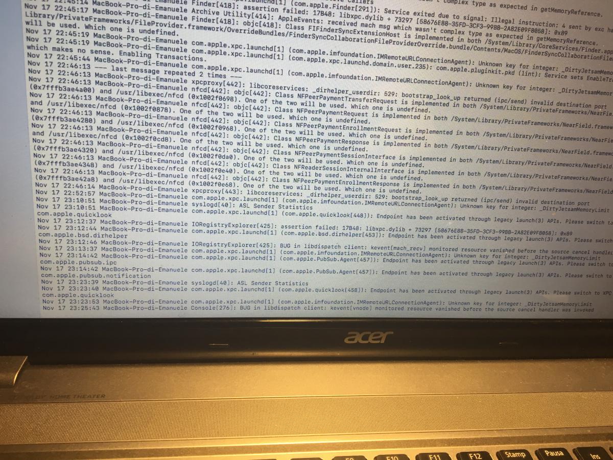

foskvs Posted November 17, 2017 Share Posted November 17, 2017 Devi premere i tasti della luminosità mentre guardi il system.log e subito dopo fai uno screen. Con quello che hai allegato non ti posso aiutare perché non ci sono i metodi chiamati. Link to comment https://www.insanelymac.com/forum/topic/328961-installazione-high-sierra/page/3/#findComment-2536124 Share on other sites More sharing options...
Emanuele-1998 Posted November 17, 2017 Author Share Posted November 17, 2017 Ok ho capito ma quando vado nel system log e premo i tasti non succede niente mentre de vado sul dispositivo mi escono e sono questi. Altrimenti mi potresti fare un video mentre tu lo fai con il tuo computer per farmi capire Link to comment https://www.insanelymac.com/forum/topic/328961-installazione-high-sierra/page/3/#findComment-2536127 Share on other sites More sharing options...

Emanuele-1998 Posted November 17, 2017 Author Share Posted November 17, 2017 grazie, ho condiviso sul link perché mi diceva che non potevo caricarlo perché è un formato non riconosciuto dall'uploader https://www.dropbox.com/s/g0ku7cs9ql9rsc8/MacBook%20Pro%20di%20Emanuele.ioreg?dl=0 Link to comment https://www.insanelymac.com/forum/topic/328961-installazione-high-sierra/page/3/#findComment-2536132 Share on other sites More sharing options...

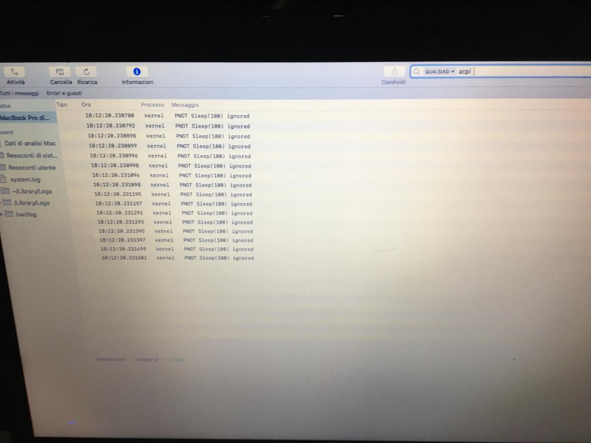

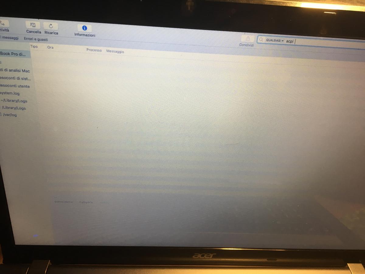

foskvs Posted November 18, 2017 Share Posted November 18, 2017 Il trackpad è visto come mouse: probabilmente non è Synaptics, quindi con VoodooPS2 non si può fare di più. Per i tasti della luminosità, apri la Console e premi i tasti. Nel campo di ricerca metti acpid (devi cercare i messaggi di ACPIDebug): Ad esempio, nel mio caso _Q11 abbassa la luminosità (Fn+freccia a sinistra) e _Q12 alza la luminosità (Fn+freccia a destra): Link to comment https://www.insanelymac.com/forum/topic/328961-installazione-high-sierra/page/3/#findComment-2536432 Share on other sites More sharing options...
Emanuele-1998 Posted November 19, 2017 Author Share Posted November 19, 2017 Ho premuto i tasti, poi ho cercato acpid ma non compare niente Link to comment https://www.insanelymac.com/forum/topic/328961-installazione-high-sierra/page/3/#findComment-2537002 Share on other sites More sharing options...

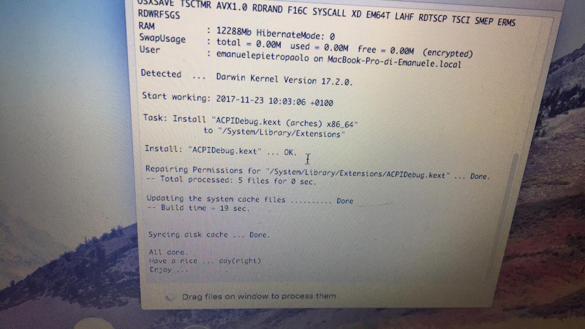

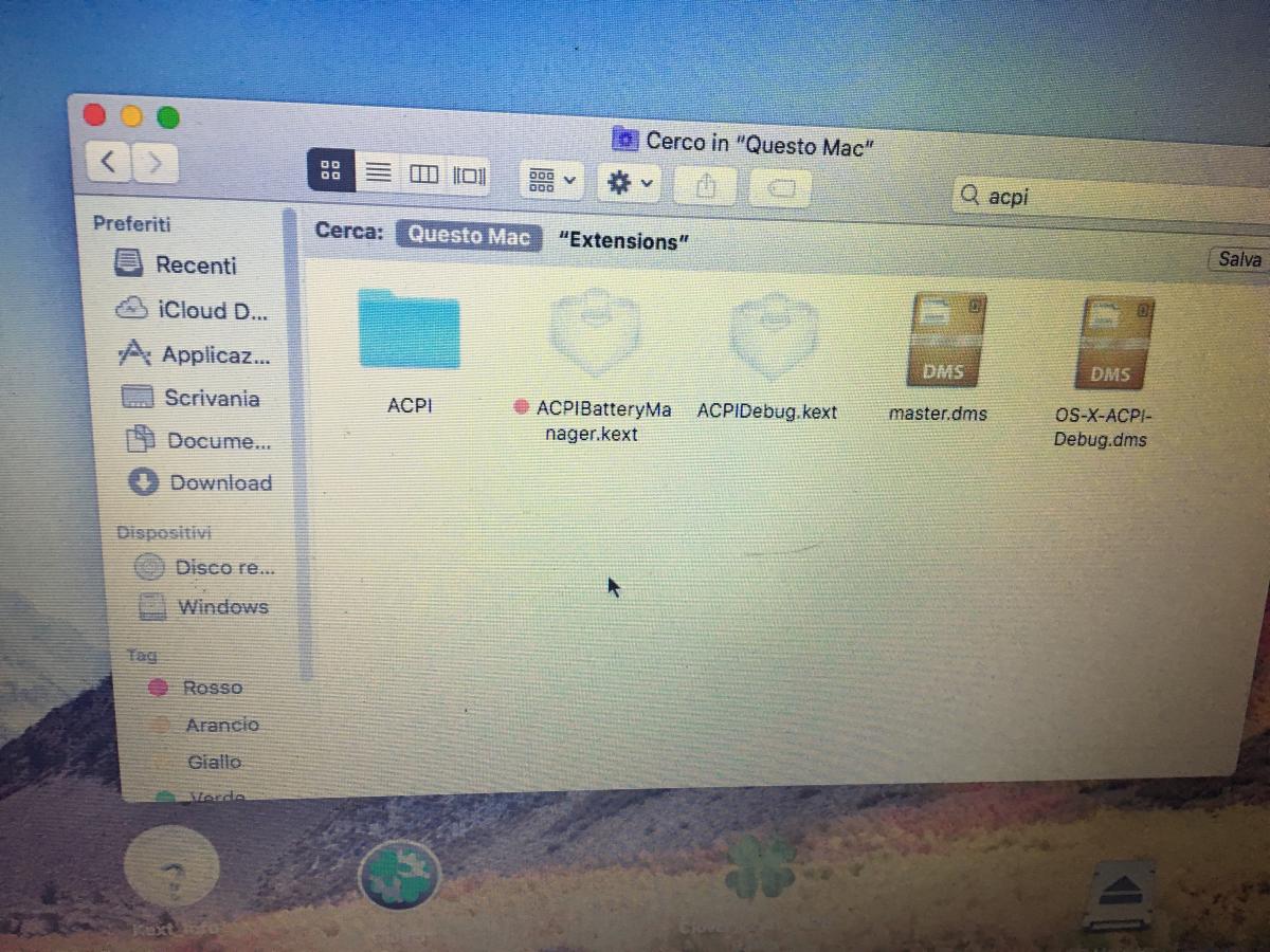

foskvs Posted November 19, 2017 Share Posted November 19, 2017 Controlla che ACPIDebug.kext sia in S/L/E. Se sì, apri il terminale e scrivi: kextstat | grep -i acpid Se non ti mostra nulla, scrivi cd /System/Library/Extensions sudo kextload ACPIDebug.kext Riavvia e riprova. Link to comment https://www.insanelymac.com/forum/topic/328961-installazione-high-sierra/page/3/#findComment-2537075 Share on other sites More sharing options...
Emanuele-1998 Posted November 20, 2017 Author Share Posted November 20, 2017 Se non li ho, dopo che li copio in quella cartella devo riparare i permessi dei file e ricostruire la kernel cache, e per queste cose uso un'app che si chiama sierra kext utility? Giusto ? Link to comment https://www.insanelymac.com/forum/topic/328961-installazione-high-sierra/page/3/#findComment-2537216 Share on other sites More sharing options...
foskvs Posted November 20, 2017 Share Posted November 20, 2017 Se per "sierra kext utility" intendi questo, va benissimo. Link to comment https://www.insanelymac.com/forum/topic/328961-installazione-high-sierra/page/3/#findComment-2537246 Share on other sites More sharing options...
Emanuele-1998 Posted November 23, 2017 Author Share Posted November 23, 2017 Ho fatto quello che mi hai chiesto e provato anche entrambi i comandi da terminale ma quando vado su console e premo i tasti poi metto nella ricerca acpid non esce nulla Link to comment https://www.insanelymac.com/forum/topic/328961-installazione-high-sierra/page/3/#findComment-2538592 Share on other sites More sharing options...

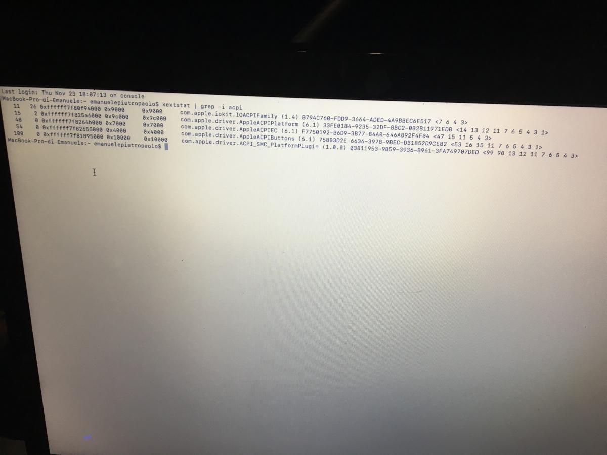

foskvs Posted November 23, 2017 Share Posted November 23, 2017 Controlla che ACPIDebug sia caricato. Dal terminale, scrivi kextstat | grep -i acpi Cosa ti esce? Link to comment https://www.insanelymac.com/forum/topic/328961-installazione-high-sierra/page/3/#findComment-2538689 Share on other sites More sharing options...
Emanuele-1998 Posted November 23, 2017 Author Share Posted November 23, 2017 Mi esce questo ma dopo un paio di secondi non subito quando scrivo nella barra di ricerca acpi Link to comment https://www.insanelymac.com/forum/topic/328961-installazione-high-sierra/page/3/#findComment-2538754 Share on other sites More sharing options...
foskvs Posted November 23, 2017 Share Posted November 23, 2017 ACPIDebug.kext non è caricato, quindi in Console non puoi vedere a cosa corrispondono i tasti fn. Ripeti i passaggi del post #66. Link to comment https://www.insanelymac.com/forum/topic/328961-installazione-high-sierra/page/3/#findComment-2538767 Share on other sites More sharing options...
Emanuele-1998 Posted November 24, 2017 Author Share Posted November 24, 2017 ho rifatto quello che mi hai chiesto ma non va cioè non mi compare niente quando scrivo i comandi anche nel terminale Link to comment https://www.insanelymac.com/forum/topic/328961-installazione-high-sierra/page/3/#findComment-2539093 Share on other sites More sharing options...
