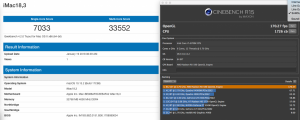

Ignite Pro Posted January 19, 2018 Share Posted January 19, 2018 Core Build —————— Intel i7-8700k 3.7 GHz — O.C. 5.4 GHz. <<<< I appear to have lucked out with the Silicon Lottery. Gigabyte Z370 Aorus Gaming 7 rev. 1.0 F4a Hey man, I have the same CPU 8700K Delidded from Silicon and they guarantee OC @5.3. (Also same Gaming 7 board, newest BIOS F5l) I am trying to push the OC to 5.4, got question for ya, what VCore you using? Also what AVX Offset number you have, What about "Uncore Ratio" you set in BIOS, Thanks in advance, IgnitePro Link to comment https://www.insanelymac.com/forum/topic/328819-hs-on-8700k-coffee-lake/page/2/#findComment-2571937 Share on other sites More sharing options...
Brumbaer Posted January 19, 2018 Author Share Posted January 19, 2018 Vcore 1.43 Turbo Ratio 51 all Cores Uncore 50 AVX Offset 0 What Geebench 4.0 or Luxmark (CPU only) scores do you get ? Cheers Link to comment https://www.insanelymac.com/forum/topic/328819-hs-on-8700k-coffee-lake/page/2/#findComment-2571973 Share on other sites More sharing options...
Ignite Pro Posted January 19, 2018 Share Posted January 19, 2018 Vcore 1.43 Turbo Ratio 51 all Cores Uncore 50 AVX Offset 0 What Geebench 4.0 or Luxmark (CPU only) scores do you get ? Cheers Currently Vcore 1.44 Ratio 53 All Cores Uncore 45 AVX Offset 0 (I try Auto too, nothing much different) Link to comment https://www.insanelymac.com/forum/topic/328819-hs-on-8700k-coffee-lake/page/2/#findComment-2572214 Share on other sites More sharing options...
