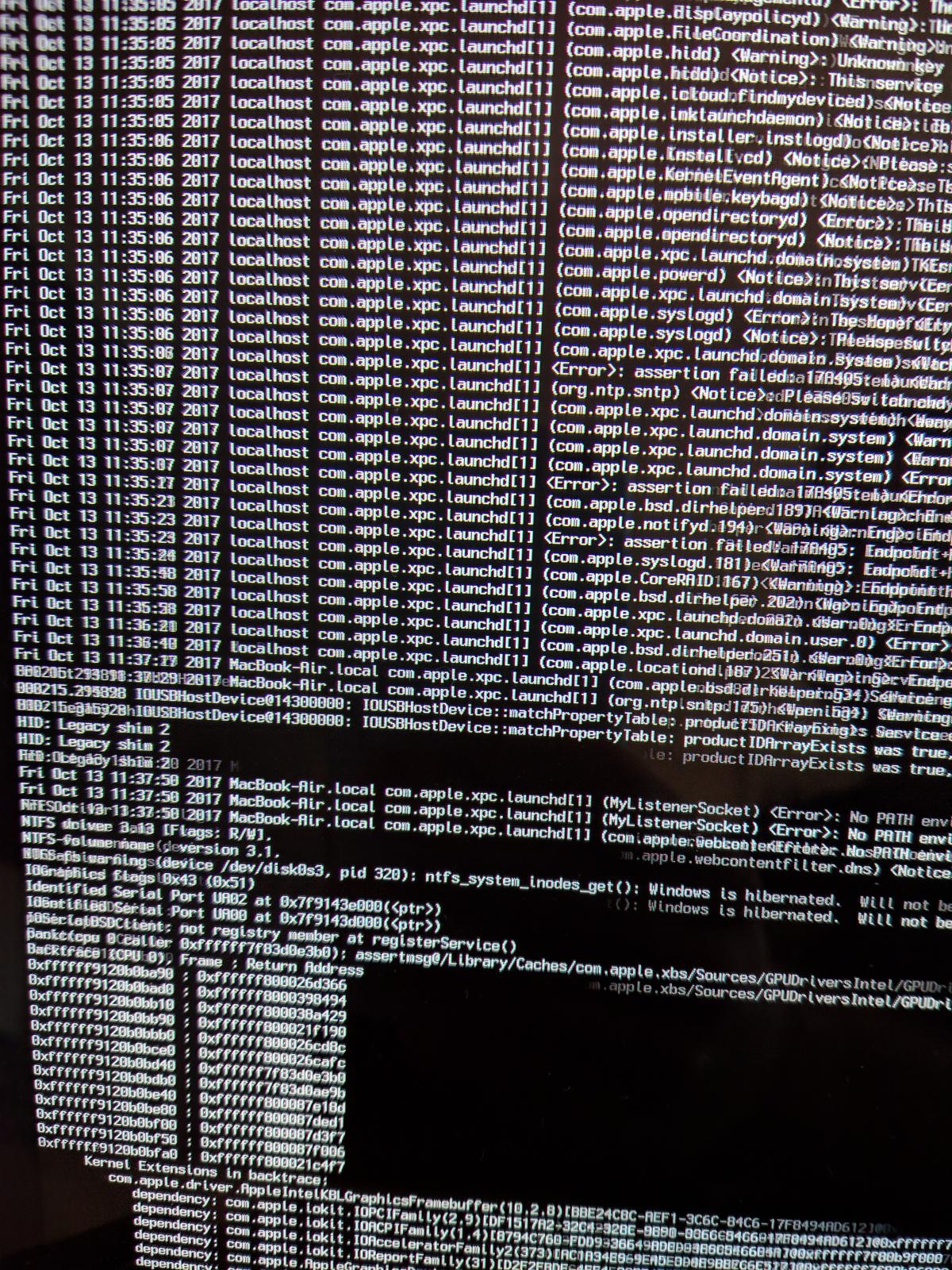

neterosensei Posted October 13, 2017 Share Posted October 13, 2017 Hey there ! I would like to install sierra on my Galaxy Book 12 inch!! Specs i5 7200u HD 620 1440p res SSD sata3 USB c ports WIFI ATHEROS/QUALCOMM QCA6174 Its a 2 in 1 convertible laptop! So its detachable and also i can use it with a keyboard! Can i install osx sierra or high sierra on this? Actually im tryinh to install but i get thoose errors cartellaEFI.zip Link to comment Share on other sites More sharing options...
Jolly Posted October 19, 2017 Share Posted October 19, 2017 Installing HS is quite possible but your configurations is lacking something. You ave to add apfs.efi in driver64uefi and this kext in other: IntelGraphicsDVMTFixUP lilu and IntelGraphicsFixup.kext are outdated, change with the newer versions: Lilu IntelGraphicsFixUP In EFI/CLOVER/ACPI/patched put the attached DSDT and SSDT- You have to trim your config.plist: In the ACPI section enable change H_EC to EC In the Boot section enable "-disablegfxfirmware" In the SMBIOS section create a profile for MacBookPro14,1 and click some times on Generate New Serial Number. Now you can installa HS on your hybrid but remember that other then OS X nothing is working and no solution till now. No audio, backlight, batterymangement, incompatible WiFi DSDT.aml.zip SSDT.aml.zip apfs.efi.zip 1 Link to comment Share on other sites More sharing options...

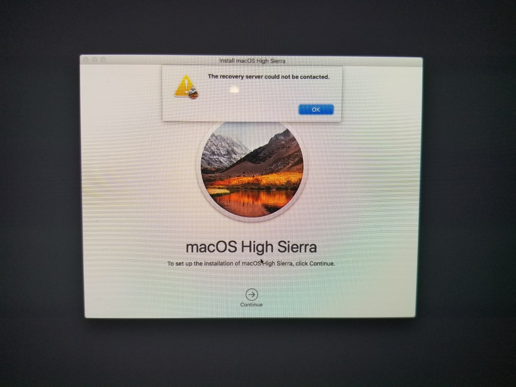

briwil Posted March 20, 2018 Share Posted March 20, 2018 (edited) I got to the installation screen here, but then I get the error about recovery server not connected. How do you get past this since this computer can't connect to the internet? Edited March 20, 2018 by briwil Added photo Link to comment Share on other sites More sharing options...
