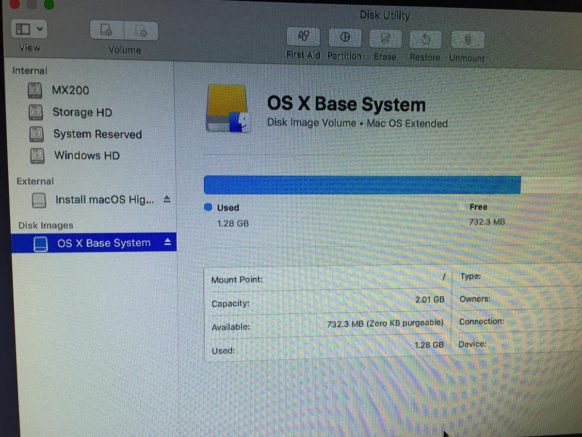

fallen00sniper Posted October 9, 2017 Share Posted October 9, 2017 So I got my HS usb installer made, dropped my kexts into the Other folder (a folder named 10.13 didn't work?) using the latest clover as of Friday. Booted successfully into the installer, everything seems fine, opened Disk Utility to format my test drive to APFS and what do you know only my windows partitions are showing. I have 3 NTFS drives, 2 SSD are on SATA3, 1 HDD on SATA2, 1 HFS SSD on SATA2 and 1 HDD with a backup of this install and a partition for clean installing HS, I plan to also test a direct upgrade on the backup. This leaves me a bit confused as to why the native filesystem drives aren't showing up at all, the SATA2 ports are clearly working. So what gives? When I try to do a direct upgrade on my test drive, I get 'Still waiting for root device'. Link to comment Share on other sites More sharing options...

snifferdog Posted October 9, 2017 Share Posted October 9, 2017 The problem is that there is a bug in the High Sierra version of AppleAHCIPort.kext which means it only sees the first drive attached to the SATA controller. I don't know how to replace this kext in an installation environment so I installed HS to a partition on my first drive and then replaced this kext with the one from 10.12.6 after installation. You can probably swap around the disk drive connections in your machine temporarily during installation to get it installed. 1 Link to comment Share on other sites More sharing options...

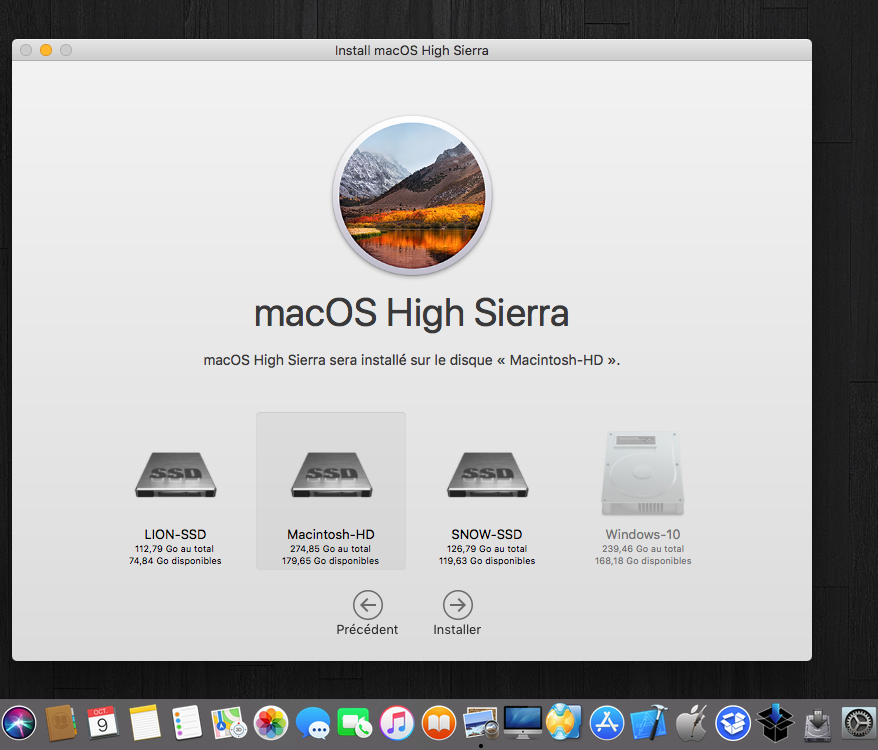

chris1111 Posted October 9, 2017 Share Posted October 9, 2017 Reading two different posts kind of makes it seem overly complicated. Also, when looking at the version in the info.plist of the installer app I see... <key>DTPlatformBuild</key> <string>9M189u</string> <key>DTPlatformVersion</key> <string>GM</string> <key>DTSDKBuild</key> <string>17A403</string> Maybe I am being seeded an old version? I'll try following these guides again later today when my brain has a chance to wake up. Did you try simple here http://www.insanelymac.com/forum/topic/328247-high-sierra-only-sees-windows-drives/?p=2511988 Link to comment Share on other sites More sharing options...
fallen00sniper Posted October 9, 2017 Author Share Posted October 9, 2017 Did you try simple here http://www.insanelymac.com/forum/topic/328247-high-sierra-only-sees-windows-drives/?p=2511988 I unplugged all drives except the one holding HS and the install usb, same error showed. I could try a reinstall with only that drive connected, but I have a suspicion that it will have the same results. Worth a try. Edit: No change, I will have to try the guide later today. Link to comment Share on other sites More sharing options...
