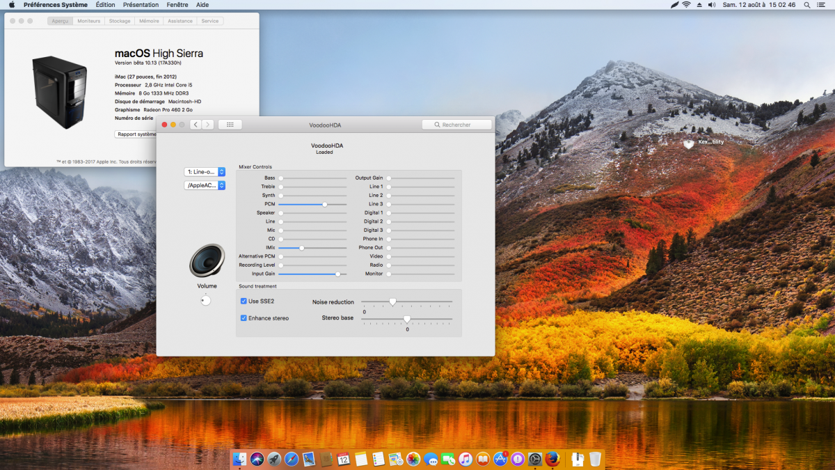

Loloflat6 Posted August 12, 2017 Share Posted August 12, 2017 I had yesterday an issue with lilu and applealc : I used this working solution : - AppleHDA-276.26-ALC887VD - Patched DSDT with layout to 11 - VoodooHDA-v2.8.8 - VoodooTSCSync-8 And all is good : Woodoo HDA offers many sound configs and more than Apple ALC. Notice that you can choose the layout corresponding to 3 or 5 audio chanels : . Layout_ID 11 = 3 ports supported (Pink, Green, Blue). Layout_ID 12 = 5/6 ports supported (Grey, Black, Laranja, Pink, Green, Blue). Layout_ID 13 = 5/6 ports supported (Grey, Black, Laranja, Pink, Green, Blue, See here : https://github.com/insanelydeepak/Patched-AppleHDA-for-Mac-OS-Sierra-10.12/blob/master/Desktop's/AppleHDA-276.26-ALC887VD.zip Link to comment https://www.insanelymac.com/forum/topic/326086-audio-issues/#findComment-2478133 Share on other sites More sharing options...
Loloflat6 Posted August 12, 2017 Share Posted August 12, 2017 Here screen shot : Link to comment https://www.insanelymac.com/forum/topic/326086-audio-issues/#findComment-2478187 Share on other sites More sharing options...
