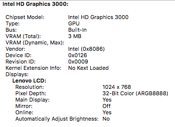

Guest Posted July 5, 2017 Share Posted July 5, 2017 If you got only 3mb of RAM that is because graphics kexts are not loaded . Check your Intel Hd3000 ID May be 0x01128086 or 0x1168086 , Then modify plist inside kexts to mach the same id. Cheers Which kexts am I editing? Sorry, I am fairly new to this. Intel HD Graphics 3000: Chipset Model: Intel HD Graphics 3000 Type: GPU Bus: Built-In VRAM (Total): 3 MB VRAM (Dynamic, Max): Vendor: Intel (0x8086) Device ID: 0x0126 Revision ID: 0x0009 Kernel Extension Info: No Kext Loaded Displays: Display: Resolution: 1024 x 768 Pixel Depth: 32-Bit Color (ARGB8888) Main Display: Yes Mirror: Off Online: Yes Automatically Adjust Brightness: No Link to comment https://www.insanelymac.com/forum/topic/325007-t520-sierra-hd3000-3mb-1024x768-clover-bootloader/page/2/#findComment-2457331 Share on other sites More sharing options...

PippoX0 Posted July 5, 2017 Share Posted July 5, 2017 Ok your Id is 0x01268086. 1) copy AppleIntelHD3000Graphics.kext and AppleIntelSNBGraphics.kext to desktop. 2) Modify info.plist inside these two kexts to add 0x01268086 id 3) reinstall kexts with kext utility back to S/L/E. and reboot. Link to comment https://www.insanelymac.com/forum/topic/325007-t520-sierra-hd3000-3mb-1024x768-clover-bootloader/page/2/#findComment-2457338 Share on other sites More sharing options...
JasonC Posted July 5, 2017 Author Share Posted July 5, 2017 Ok your Id is 0x01268086. 1) copy AppleIntelHD3000Graphics.kext and AppleIntelSNBGraphics.kext to desktop. 2) Modify info.plist inside these two kexts to add 0x01268086 id 3) reinstall kexts with kext utility back to S/L/E. and reboot. Thank you, oh holy one. I realized my distro didn't have those kexts, I found some at: https://forums.macrumors.com/threads/2011-intel-hd-3000-macbook-pro-1024mb-vram-kext-work.1977308/ They already have the device IDs in them so no need for modding, just installed with kext wiz and it worked. :ihw_wow: :ihw_wow: 1 Link to comment https://www.insanelymac.com/forum/topic/325007-t520-sierra-hd3000-3mb-1024x768-clover-bootloader/page/2/#findComment-2457346 Share on other sites More sharing options...

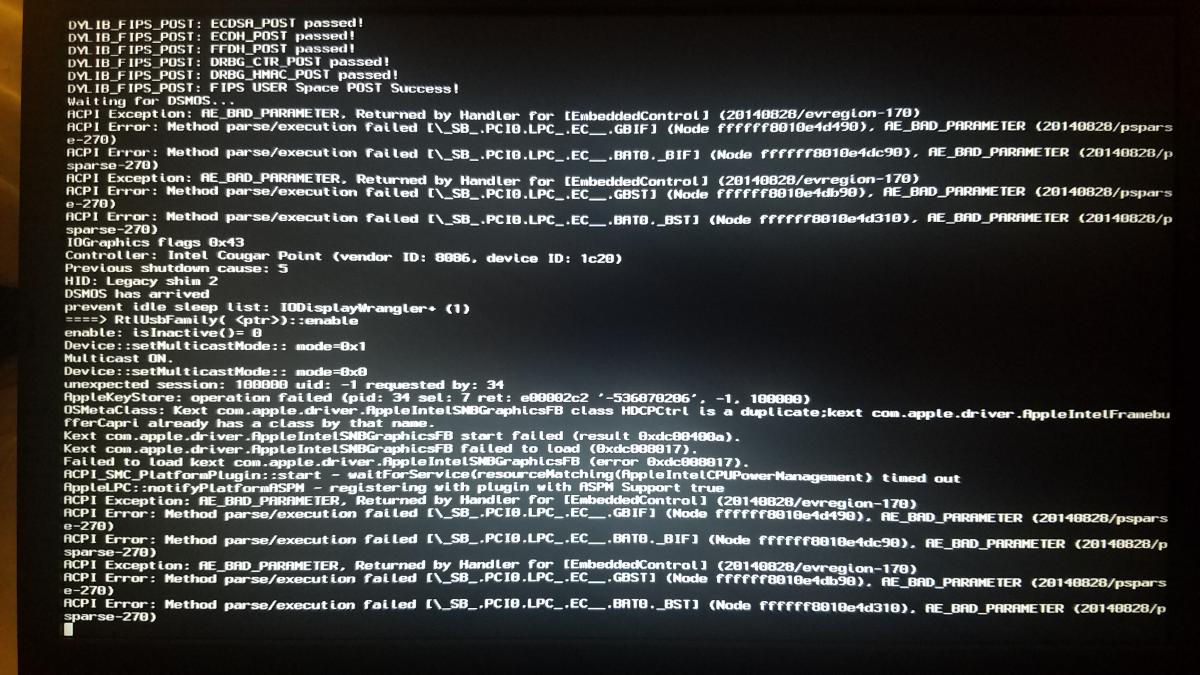

Guest Posted July 5, 2017 Share Posted July 5, 2017 So your all fixed then? Sent from my SM-G930F using Tapatalk I keep getting this error ever since last night when I changed my config file, it booted fine the first few times but now I continue to get this error. Link to comment https://www.insanelymac.com/forum/topic/325007-t520-sierra-hd3000-3mb-1024x768-clover-bootloader/page/2/#findComment-2457454 Share on other sites More sharing options...
SavageAUS Posted July 5, 2017 Share Posted July 5, 2017 I suggest now that you know how to fix your graphics you start fresh, clean install, updated clover, updated kexts. Use ssdtprgen for power management. AppleALC.kext + Lilu.kext for sound. Correctly disassemble your acpi files and patch them where needed then compile them. You could also start with a new config.plist from RehabMan for HD3000 1366x768. These are my recommendations, you don't have to but seeing as you followed an out dated guide for the wrong laptop it's best to start over. Edit. I see in previous comments you said your "distro" what are you using? Best install method is a USB created with createinstallmedia then install clover to the USB. Use a real mac or working hack to download the installer, not a distro. Sent from my SM-G930F using Tapatalk Link to comment https://www.insanelymac.com/forum/topic/325007-t520-sierra-hd3000-3mb-1024x768-clover-bootloader/page/2/#findComment-2457458 Share on other sites More sharing options...
