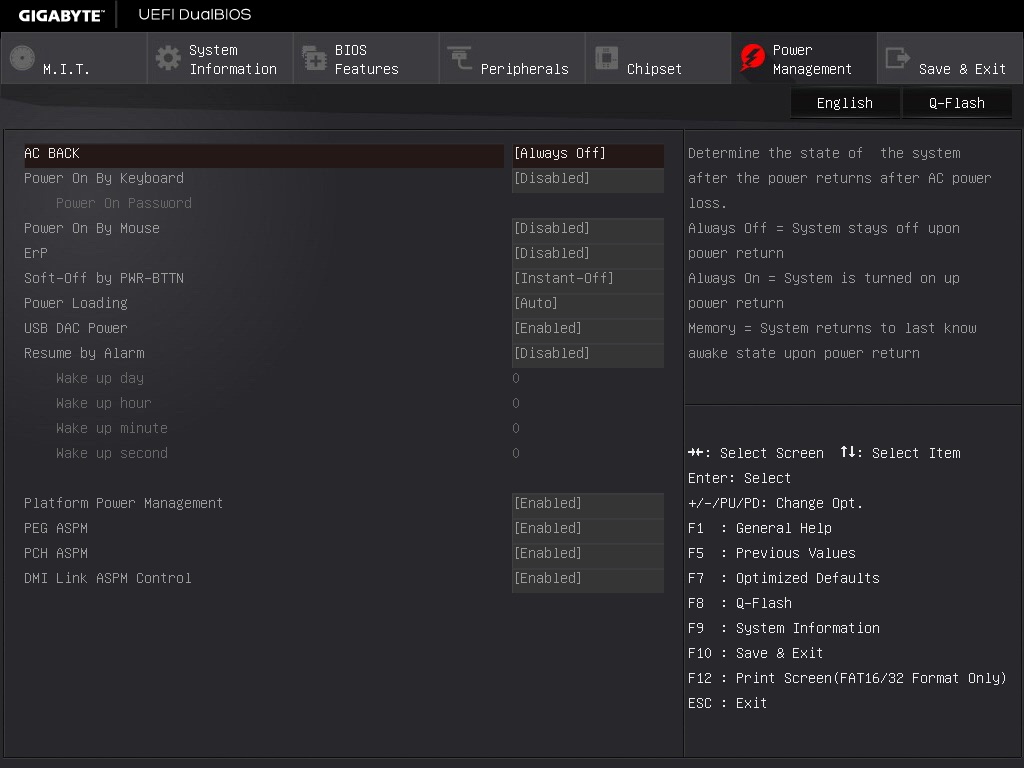

sad_Vamp Posted September 19, 2017 Author Share Posted September 19, 2017 Maybe I was not clear enough (sorry not a native speaker). I'll try to describe it better. The USB still charges even when the PC is off. Thus my external soundcard (and everything else on USB) stays ON. I don't want this. I want to completely shut down the machine, even the USB. Is there any known method for these Gigabyte MOBO's to do it or no (and I have to turn off the PSU everytime I turn off the machine)? Link to comment https://www.insanelymac.com/forum/topic/324780-sierra-on-ga-z170x-designare-gpu-2x-hd5850/page/4/#findComment-2496859 Share on other sites More sharing options...
Cyberdevs Posted September 19, 2017 Share Posted September 19, 2017 Well I guess you need to disable USB DAC Power in the BIOS as well if ErP didn't work. I thought you didn't turn off the ErP yet when I made my previous post. Link to comment https://www.insanelymac.com/forum/topic/324780-sierra-on-ga-z170x-designare-gpu-2x-hd5850/page/4/#findComment-2496865 Share on other sites More sharing options...
sad_Vamp Posted September 19, 2017 Author Share Posted September 19, 2017 I just tried it.I mean the ErP thingy... But I did not see any option fot this USB DAC. Nothing seems to be related with this thing in BIOS. Not in the power managemant nor in the USB settings. Link to comment https://www.insanelymac.com/forum/topic/324780-sierra-on-ga-z170x-designare-gpu-2x-hd5850/page/4/#findComment-2496892 Share on other sites More sharing options...
Cyberdevs Posted September 19, 2017 Share Posted September 19, 2017 on my Z170X-Gaming 5 I have USB DAC Power, maybe it's a feature on my mobo. I have the latest BIOS installed (f22a) Link to comment https://www.insanelymac.com/forum/topic/324780-sierra-on-ga-z170x-designare-gpu-2x-hd5850/page/4/#findComment-2496895 Share on other sites More sharing options...
sad_Vamp Posted September 19, 2017 Author Share Posted September 19, 2017 Sadly my designare bios looks nothing like that. it looks like on these pictures: https://www.tonymacx86.com/media/img_3248.188130/full but as I see from this picture, maybe I should try to upgrade my BIOS (currently -if I remember correctly- I have no BACK AC option):https://imagescdn.tweaktown.com/content/7/8/7836_49_gigabyte-z170x-designare-motherboard-review.png Link to comment https://www.insanelymac.com/forum/topic/324780-sierra-on-ga-z170x-designare-gpu-2x-hd5850/page/4/#findComment-2496905 Share on other sites More sharing options...
Cyberdevs Posted September 19, 2017 Share Posted September 19, 2017 Sadly my designare bios looks nothing like that. You need to check the settings under "Power" my USB DAC Power is under "Power" not the "Peripherals" Link to comment https://www.insanelymac.com/forum/topic/324780-sierra-on-ga-z170x-designare-gpu-2x-hd5850/page/4/#findComment-2496911 Share on other sites More sharing options...
sad_Vamp Posted September 19, 2017 Author Share Posted September 19, 2017 Damn I've put a wrong link .... so I mean this https://imagescdn.tweaktown.com/content/7/8/7836_49_gigabyte-z170x-designare-motherboard-review.pngIt seems this motherboard is so {censored} I cannot even turn off the USB DAC. The "BACK AC" is not related (According to the bios help), and the ErP does not helps either.I did not find any clues on the other parts of the internet either.... So it seems I will have to turn of the PSU every time. Link to comment https://www.insanelymac.com/forum/topic/324780-sierra-on-ga-z170x-designare-gpu-2x-hd5850/page/4/#findComment-2497445 Share on other sites More sharing options...
Cyberdevs Posted September 20, 2017 Share Posted September 20, 2017 I looked up your mainboard and the USB Power DAC is not present in your BIOS because there are no USB DAC ports on your mainboard, USB DAC ports are yellow in color. But the problem with the USB ports being active has nothing with those ports or your hackintosh, it's a pure PC BIOS settings related issue. you need to check all settings under Power tab like "Power Loading: to see what other options are available if you change the "Auto" mode to other settings available. Link to comment https://www.insanelymac.com/forum/topic/324780-sierra-on-ga-z170x-designare-gpu-2x-hd5850/page/4/#findComment-2497648 Share on other sites More sharing options...
sad_Vamp Posted September 20, 2017 Author Share Posted September 20, 2017 I will try. update:Tried it.... almost everything... the LED still lights on the external sound card.... Link to comment https://www.insanelymac.com/forum/topic/324780-sierra-on-ga-z170x-designare-gpu-2x-hd5850/page/4/#findComment-2498054 Share on other sites More sharing options...
