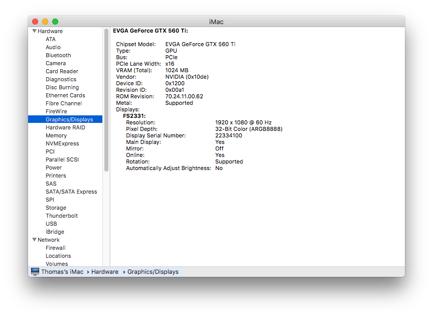

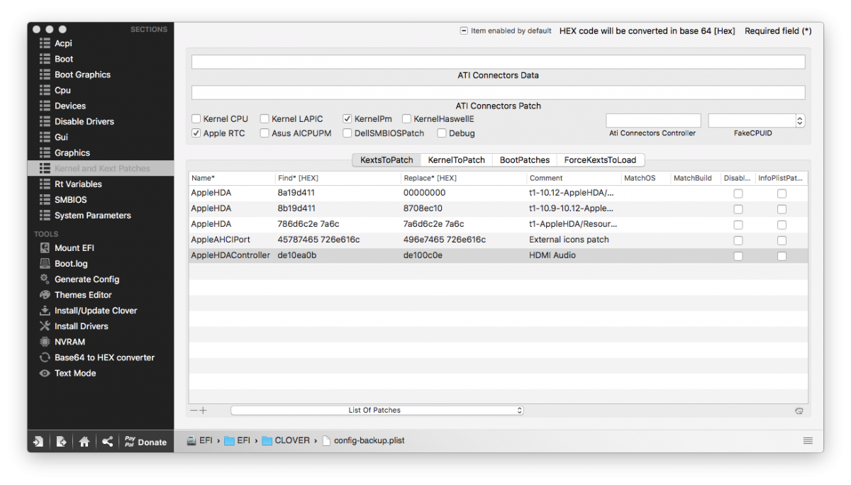

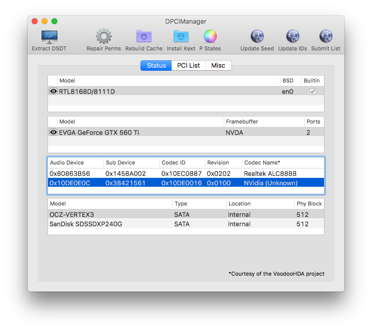

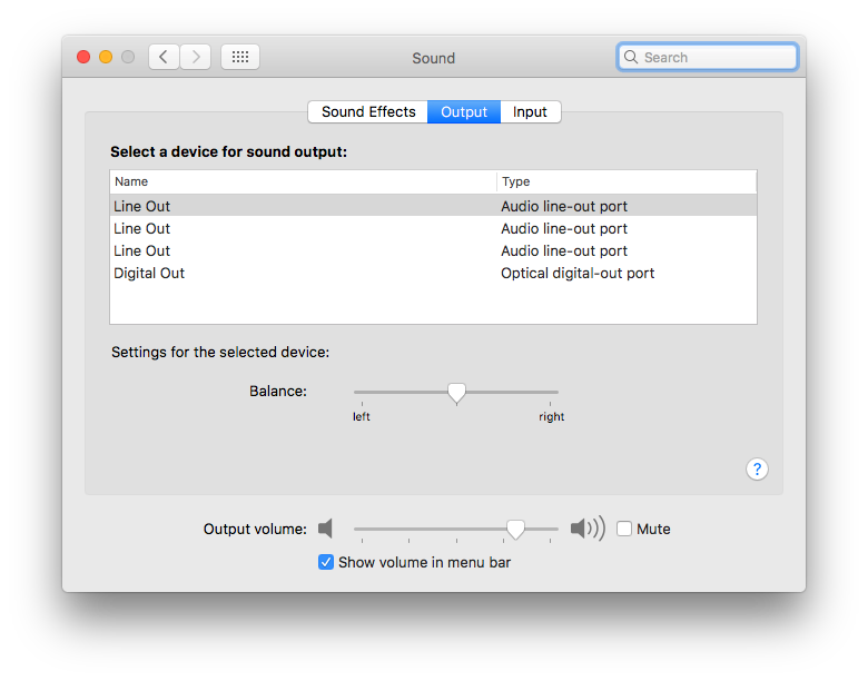

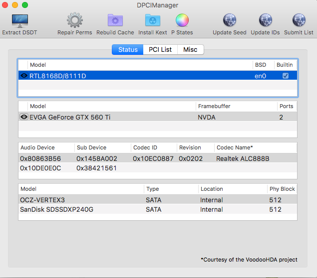

Sharky04 Posted July 11, 2017 Share Posted July 11, 2017 1. Description of problem No HDMI Audio Device (only 3x Realtek Line Out and 1x Realtek Digital Output) 2. OS/Hardware Sierra 10.12.5, GA-P55M-UD2 Rev 1.0 F11, Core i7 860 Lynnfield, Geforce 560 Ti Fermi 3. Procedure Used this guide: http://www.insanelymac.com/forum/topic/324635-applehda-hdmi-audio/ Patched this in Clover Configurator: AppleHDAController binary Find: de 10 ea 0b Rplc: de 10 e5 0b Then used the audio_cloverHDMI script (output attached). The script downloaded and installed a kext. After reboot still no hdmi audio device. 4. AppleHDA.kext S/L/E/AppleHDA.kext is installed with added patches by audio_cloverALC-130 to make Realtek Sound functional 5. IOReg is attached 6. Screenshots attached 7. Boot log attached 8. MaciASL I was not sure here if I had to load my DSDT.aml into MaciASL before exporting, I did! 9. Terminal audio_cloverHDMI output attached 10. Chameleon not installed 11. config.plist, boot log, dsdt.aml all attached (ssdt.aml not on system) audio_cloverHDMI-120.txt ioreg_iMac.zip bootlog.txt MaciASL_iMac_acpi.zip config_plist.zip DSDT.zip Link to comment https://www.insanelymac.com/forum/topic/324635-applehda-hdmi-audio/#findComment-2460974 Share on other sites More sharing options...

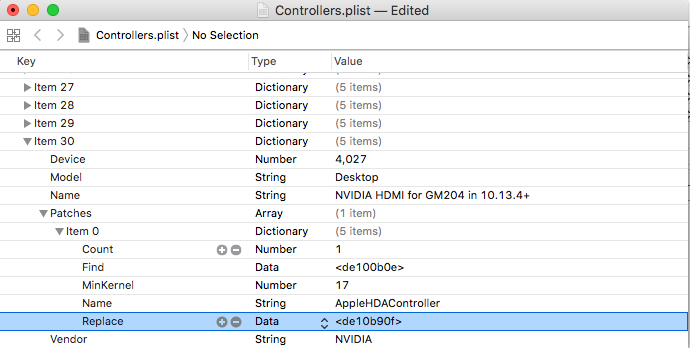

toleda Posted July 14, 2017 Author Share Posted July 14, 2017 No HDMI Audio Device Patched this in Clover Configurator: AppleHDAController binary Find: de 10 ea 0b Rplc: de 10 e5 0b Try: AppleHDAController binary Find: de 10 ea 0b Rplc: de 10 0c 0e Link to comment https://www.insanelymac.com/forum/topic/324635-applehda-hdmi-audio/#findComment-2462312 Share on other sites More sharing options...

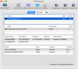

Sharky04 Posted July 15, 2017 Share Posted July 15, 2017 Thanks for the suggestion. After changing the bytes in the patch the DCPI manager now displays Nvidia (unknown) in the second row instead of nothing as before, but unfortunately there is still no HDMI audio device in settings. Link to comment https://www.insanelymac.com/forum/topic/324635-applehda-hdmi-audio/#findComment-2463356 Share on other sites More sharing options...

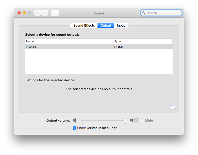

Sharky04 Posted July 18, 2017 Share Posted July 18, 2017 Got it finally working by disabling AppleHDA patches in configurator! RealTek analog devices are now gone, but HDMI sound device is present and working! Link to comment https://www.insanelymac.com/forum/topic/324635-applehda-hdmi-audio/#findComment-2465161 Share on other sites More sharing options...
toleda Posted July 22, 2017 Author Share Posted July 22, 2017 Got it finally working by disabling AppleHDA patches in configurator! Not related, more likely a kernel cache problem. Back up config.plist, run cloverALC, add back HDMI patch, restart. Link to comment https://www.insanelymac.com/forum/topic/324635-applehda-hdmi-audio/#findComment-2467114 Share on other sites More sharing options...
Sharky04 Posted July 23, 2017 Share Posted July 23, 2017 You are right! Done as you have suggested, and now both RealTek and HDMI devices are available! Link to comment https://www.insanelymac.com/forum/topic/324635-applehda-hdmi-audio/#findComment-2467847 Share on other sites More sharing options...
toleda Posted July 23, 2017 Author Share Posted July 23, 2017 both RealTek and HDMI devices are available! Thanks, Post #1 updated with correct Controller edit. Link to comment https://www.insanelymac.com/forum/topic/324635-applehda-hdmi-audio/#findComment-2468212 Share on other sites More sharing options...

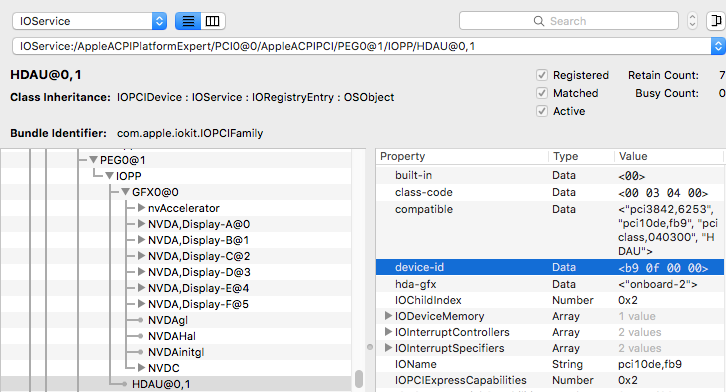

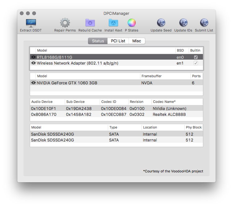

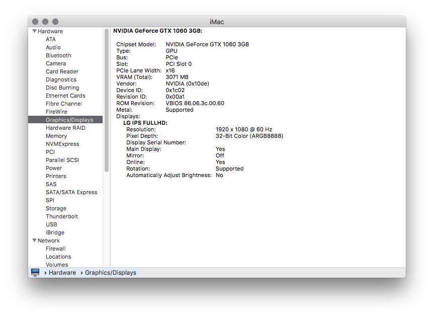

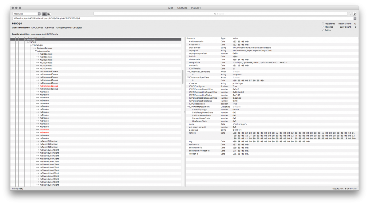

RhanCandia Posted August 31, 2017 Share Posted August 31, 2017 1. No HDMI Audio on GTX 1060 (used to work on my 960, upgraded, now it’s not working) 2. 10.12.6 / H110M-H DDR4 / F20a / i3-6100 / GTX 1060 3. http://www.insanelymac.com/forum/topic/324635-applehda-hdmi-audio/ 4. S/L/E/AppleHDA.kext is installed with added patches by audio_cloverALC-120 to make Realtek Sound functional * Everything else is attached. iMac.ioreg.txt bootlog.txt clover_HDMI_output.txt iMac.acpi.txt ssdt.aml.txt Link to comment https://www.insanelymac.com/forum/topic/324635-applehda-hdmi-audio/#findComment-2487967 Share on other sites More sharing options...
toleda Posted September 1, 2017 Author Share Posted September 1, 2017 1. No HDMI Audio on GTX 1060 Nvidia web driver/Pascal: HDMI audio on HDMI port does not work on boot. Fixes: 1. DP2HDMI adapter 2. DVI2HDMI adapter 3. Hot plug HDMI connector after boot ioreg.txt is not helpful See Post #1/Problem Reporting/5. Copy of IOReg - IOReg_v2.1/File/Save a Copy As…, verify file (Tools 1.) Attach new IOReg Link to comment https://www.insanelymac.com/forum/topic/324635-applehda-hdmi-audio/#findComment-2488579 Share on other sites More sharing options...
RhanCandia Posted September 2, 2017 Share Posted September 2, 2017 Nvidia web driver/Pascal: HDMI audio on HDMI port does not work on boot. Fixes: 1. DP2HDMI adapter 2. DVI2HDMI adapter 3. Hot plug HDMI connector after boot ioreg.txt is not helpful See Post #1/Problem Reporting/5. Copy of IOReg - IOReg_v2.1/File/Save a Copy As…, verify file (Tools 1.) Attach new IOReg Tried hot plugging HDMI but no luck. Haven't tried and cant settle with workaround 1 and 2. I can't figure out how IOReg tool works. Will s screenshot help? See attached. Link to comment https://www.insanelymac.com/forum/topic/324635-applehda-hdmi-audio/#findComment-2488609 Share on other sites More sharing options...
toleda Posted September 3, 2017 Author Share Posted September 3, 2017 can't figure out how IOReg tool works. Will s screenshot help? See attached. Menu Bar IORegistryExplorer/ File/ Save a Copy As… Attach the saved file. Link to comment https://www.insanelymac.com/forum/topic/324635-applehda-hdmi-audio/#findComment-2489090 Share on other sites More sharing options...
RhanCandia Posted September 3, 2017 Share Posted September 3, 2017 That's exactly how did it for the first ioreg file I attached. Here's another attempt. PS: Just remove the .txt extension. Couldn't upload an IOreg file directly. iMac.ioreg.txt Link to comment https://www.insanelymac.com/forum/topic/324635-applehda-hdmi-audio/#findComment-2489120 Share on other sites More sharing options...
toleda Posted September 5, 2017 Author Share Posted September 5, 2017 Just remove the .txt extension. Couldn't upload an IOreg file directly. Useless. Attach .zip. Link to comment https://www.insanelymac.com/forum/topic/324635-applehda-hdmi-audio/#findComment-2489839 Share on other sites More sharing options...
RhanCandia Posted September 5, 2017 Share Posted September 5, 2017 Useless. Attach .zip. Here you go. Thanks. iMac.ioreg.zip Link to comment https://www.insanelymac.com/forum/topic/324635-applehda-hdmi-audio/#findComment-2489977 Share on other sites More sharing options...
toleda Posted September 5, 2017 Author Share Posted September 5, 2017 Here you go. IOReg is correct. 10xx/Nvidia web driver; no HDMI audio on HDMI port after boot, fixes: 1. DP2HDMI adapter 2. DVI2HDMI adapter 3. Hot plug HDMI display after Desktop appears 1 Link to comment https://www.insanelymac.com/forum/topic/324635-applehda-hdmi-audio/#findComment-2490167 Share on other sites More sharing options...
RhanCandia Posted September 7, 2017 Share Posted September 7, 2017 IOReg is correct. 10xx/Nvidia web driver; no HDMI audio on HDMI port after boot, fixes: 1. DP2HDMI adapter 2. DVI2HDMI adapter 3. Hot plug HDMI display after Desktop appears Thanks. Hot plugging isn't working for me. I guess I'm out of luck. I don't have a DP or DVI port right now. Link to comment https://www.insanelymac.com/forum/topic/324635-applehda-hdmi-audio/#findComment-2491003 Share on other sites More sharing options...
