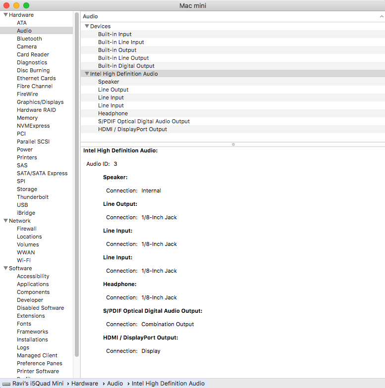

Some progress...
I set config.plist/ACPI/DSDT/Fixes/FixHDA_8000/NO
And now the HDMI port shows up in system report. But still not available in the sound as an option for output.
​Edit: anyway to makee the SSDT-HDEF3.aml not be ignored? I see a message that says the patch was a success in the boot log.
Also, I see that in IORegExplorer my monitor (Display0 - AppleDisplay) is connected to Port 0x6.
But the script says that HD4000 port 0x7 is a native HDMI port.
Is there something special about my system that I need to manually correct? Given that this is an IVY bridge CPU on a 6-series motherboard.
