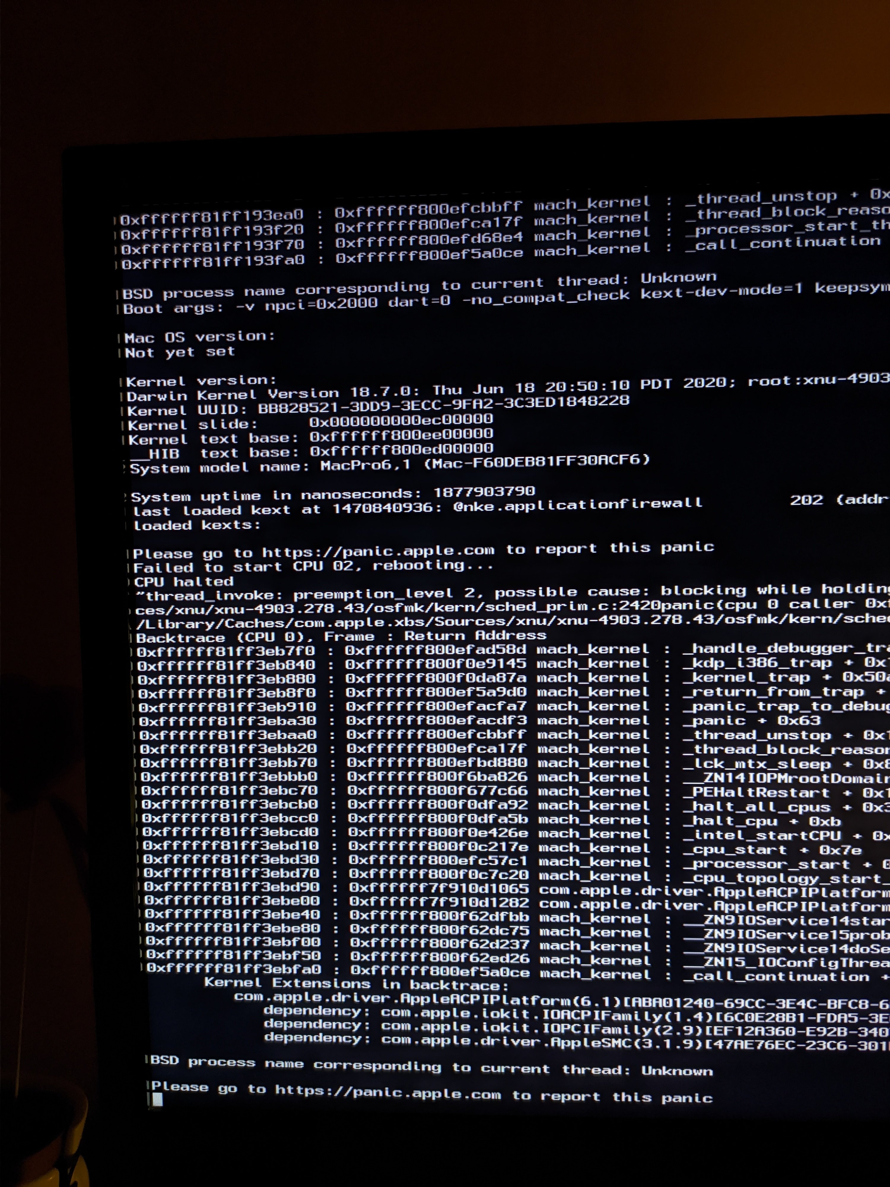

Singa Posted August 13, 2020 Share Posted August 13, 2020 Hi, its doesn`t working on xeon e5 2620v3, kllisre x99z v102, macOS - Mojave. Panic - "Failed to start CPU02, rebooting.... CPU halted", "BSD process name corresponding to current thread: Unknown" Link to comment https://www.insanelymac.com/forum/topic/323366-voodootscsync-configurator-create-a-custom-version-of-voodoo-tsc-sync/page/2/#findComment-2734128 Share on other sites More sharing options...
ITzTravelInTime Posted August 13, 2020 Author Share Posted August 13, 2020 30 minutes ago, Singa said: Hi, its doesn`t working on xeon e5 2620v3, kllisre x99z v102, macOS - Mojave. Panic - "Failed to start CPU02, rebooting.... CPU halted", "BSD process name corresponding to current thread: Unknown" Doesn't surprises me, the version of the kext that the app ships with is old, you can always import the most recent kext and modify it with the app and do a custom configuration by using the number of threads for your cpu as the configuration option Link to comment https://www.insanelymac.com/forum/topic/323366-voodootscsync-configurator-create-a-custom-version-of-voodoo-tsc-sync/page/2/#findComment-2734131 Share on other sites More sharing options...

ITzTravelInTime Posted August 13, 2020 Author Share Posted August 13, 2020 you don't need the -no_compat_check and this attached here is the copy of voodootsmcsync that i use for my i7 5820k, so if it doesn't work that a problem with your bootloader config file or you need to use a custom dsdt/ssdt to address potential issues caused by the motherboard. I have the same kernel panic as yours btw but when trying to boot big sur and without the messange about cpu 2, catalina works just fine. VoodooTSCSync.kext.zip Link to comment https://www.insanelymac.com/forum/topic/323366-voodootscsync-configurator-create-a-custom-version-of-voodoo-tsc-sync/page/2/#findComment-2734138 Share on other sites More sharing options...

ITzTravelInTime Posted August 13, 2020 Author Share Posted August 13, 2020 5 minutes ago, Singa said: Not working, most likely I need to deal with dsdt/ssdt as you said( Also check that virtual smc or fake smc (whatever you use) are loaded and working since the kernel panic lists the apple smc driver in the backtrace. for virtualsmc make sure to have the latest kext and the latest lilu with the required efi driver and that the kext injection is added to clover or that you have the kexts in your config file if you are using open core. Link to comment https://www.insanelymac.com/forum/topic/323366-voodootscsync-configurator-create-a-custom-version-of-voodoo-tsc-sync/page/2/#findComment-2734140 Share on other sites More sharing options...
Singa Posted August 13, 2020 Share Posted August 13, 2020 4 minutes ago, ITzTravelInTime said: Also check that virtual smc or fake smc (whatever you use) are loaded and working since the kernel panic lists the apple smc driver in the backtrace. for virtualsmc make sure to have the latest kext and the latest lilu with the required efi driver and that the kext injection is added to clover or that you have the kexts in your config file if you are using open core. I think that if it was not so, then the system would not boot at all, and so it boots only with 1 core Link to comment https://www.insanelymac.com/forum/topic/323366-voodootscsync-configurator-create-a-custom-version-of-voodoo-tsc-sync/page/2/#findComment-2734141 Share on other sites More sharing options...
