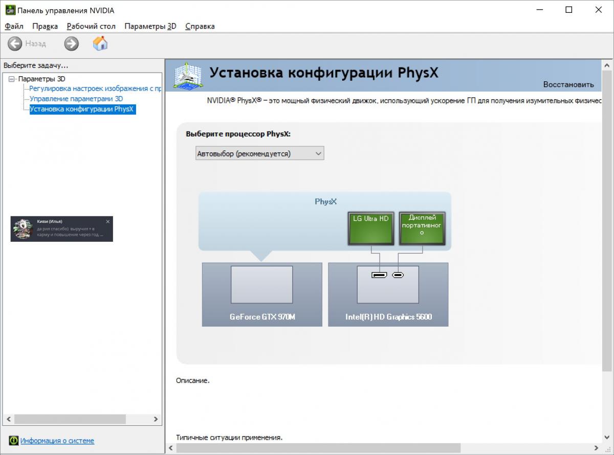

I'm pretty sure that DP works by IntelHD (screenshot from Windows in attachments).
On Windows displayport works properly 4k@60fps. Any ideas? Is it possible to make displayport work?
