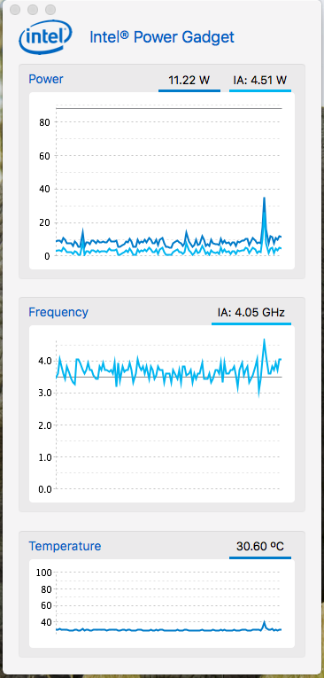

tikizondo94 Posted March 23, 2017 Author Share Posted March 23, 2017 Ok, Fresh install. Disabled third party USB in bios. Left all other setting alone. Removed all other hard drives only NVMe drive and separate storage drive. "has no efi". Straight forward install via clover using uefi mode. Added Pilkes nvme patch to my config.plist and IONVMeFamily.kext in clover kexts folder per nvme patch. After install and setup. I replaced clover folder with the one you sent me. Only adding the nvme patch to the folder. Also generated new SSDT per my overclock at 4600mhz and installed in ACPI patched folder. USB 3 seems to work on some ports as usual. Sound etc works. But system is not going below 3.5ghz on my intel gadget stats. Also system still auto reboots within 2 seconds after shut down or sleep. It wont allow me to send you my Ioreg file. Even compressed it says the file is to big. 10mb limit. Compressed its 15.8mb Send me Paul’s iMac.zip Link to comment https://www.insanelymac.com/forum/topic/322083-hack-reboots-directly-after-shutdown-or-sleep/#findComment-2390454 Share on other sites More sharing options...

tikizondo94 Posted March 24, 2017 Author Share Posted March 24, 2017 Unfortunately same result. Auto reboot at shutdown and sleep. CPU is still only dropping to 3.5 in its idle state. Link to comment https://www.insanelymac.com/forum/topic/322083-hack-reboots-directly-after-shutdown-or-sleep/#findComment-2390565 Share on other sites More sharing options...
MaLd0n Posted March 24, 2017 Share Posted March 24, 2017 Check, put ur SSDT pike in folder, reboot and test CLOVER.zip try a load optmized defauls in bios, ostype to other os Link to comment https://www.insanelymac.com/forum/topic/322083-hack-reboots-directly-after-shutdown-or-sleep/#findComment-2390652 Share on other sites More sharing options...
tikizondo94 Posted March 25, 2017 Author Share Posted March 25, 2017 Check, put ur SSDT pike in folder, reboot and test CLOVER.zip try a load optmized defauls in bios, ostype to other os Unfortunatly that didnt work either. In a random shot, i decided to use my stock clover install folder from my install USB. No SSDT or anything. Only added FixShutdown in the dsdt fixes from clover configurator. And my normal boot args and for some reason my cpu idles at 800mhz and scales to 4.6ghz as normal. It even shuts down now normally without rebooting. Sleep still does not work but im working on it. Heres a copy of my clover folder. CLOVER.rar 1 Link to comment https://www.insanelymac.com/forum/topic/322083-hack-reboots-directly-after-shutdown-or-sleep/#findComment-2391729 Share on other sites More sharing options...

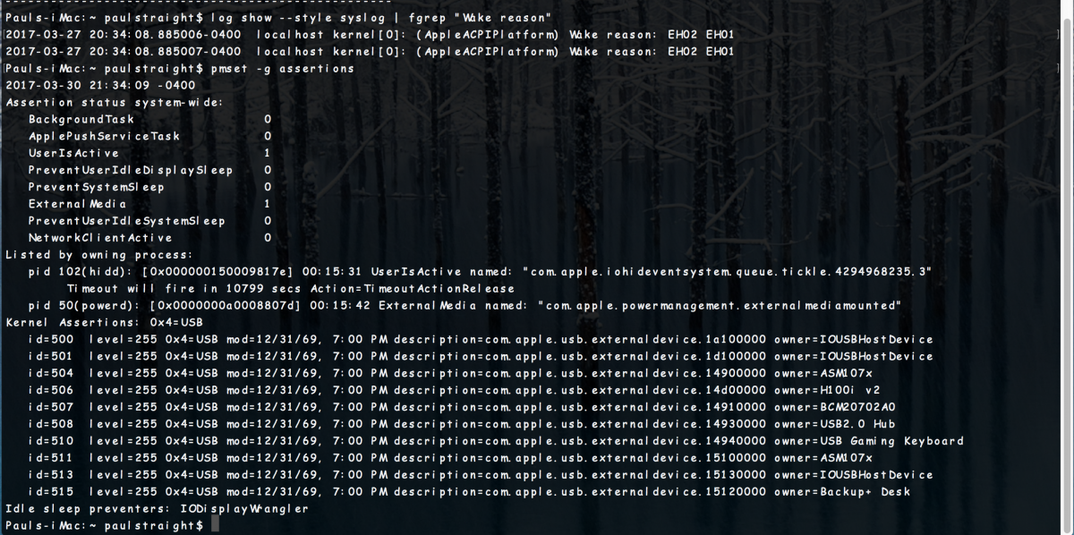

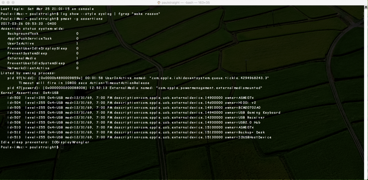

MaLd0n Posted March 26, 2017 Share Posted March 26, 2017 put in sleep again, wait for wake and run in terminal log show --style syslog | fgrep "Wake reason" pmset -g assertions Link to comment https://www.insanelymac.com/forum/topic/322083-hack-reboots-directly-after-shutdown-or-sleep/#findComment-2391780 Share on other sites More sharing options...
tikizondo94 Posted March 26, 2017 Author Share Posted March 26, 2017 This is what i get. Heres a copy of my IO reg if that helps at all. Paul’s iMac.zip Link to comment https://www.insanelymac.com/forum/topic/322083-hack-reboots-directly-after-shutdown-or-sleep/#findComment-2391924 Share on other sites More sharing options...
TheRacerMaster Posted March 30, 2017 Share Posted March 30, 2017 grep is case sensitive. You need "Wake reason", "not wake reason". 1 Link to comment https://www.insanelymac.com/forum/topic/322083-hack-reboots-directly-after-shutdown-or-sleep/#findComment-2395553 Share on other sites More sharing options...
tikizondo94 Posted March 31, 2017 Author Share Posted March 31, 2017 grep is case sensitive. You're need "Wake reason", "not wake reason". My bad. sorry. This is what I get with the proper command.. Link to comment https://www.insanelymac.com/forum/topic/322083-hack-reboots-directly-after-shutdown-or-sleep/#findComment-2395638 Share on other sites More sharing options...
