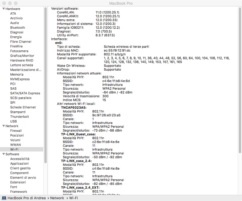

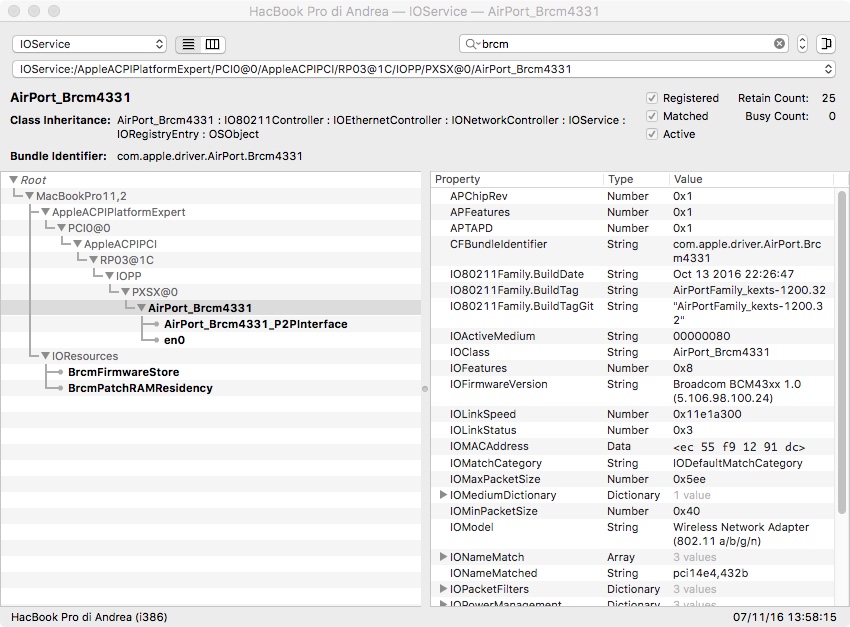

whityini Posted November 7, 2016 Share Posted November 7, 2016 Thank you UltraLaser, I have applied your suggestions and system is working, included wifi and bt, but now my wifi device is recognised into the system information as a third party wireless device while into the IORegistry is again a Brcm4331 (see the attached images, sorry for the Italian language!!). Obviously handoff/hotspot is not working. Do you have any other idea? Link to comment https://www.insanelymac.com/forum/topic/317656-bcm94352hmb-bt-working-with-fakepciidkext-but-wifi-not-os-1012/#findComment-2315091 Share on other sites More sharing options...
toleda Posted November 8, 2016 Share Posted November 8, 2016 IORegistry is again a Brcm4331 Obviously handoff/hotspot is not working. Do you have any other idea? You posted in a 4352 thread; your Wifi is not 4352. All 4352 patches applied to your wifi card are ignored. No idea if CAT patches Airport_Brcm4331.kext Link to comment https://www.insanelymac.com/forum/topic/317656-bcm94352hmb-bt-working-with-fakepciidkext-but-wifi-not-os-1012/#findComment-2315820 Share on other sites More sharing options...
