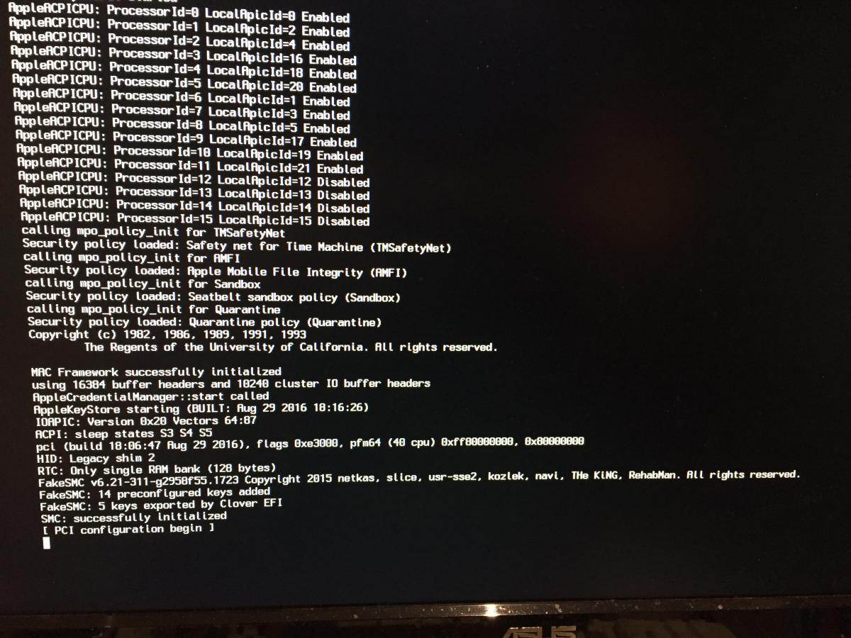

Renegade Posted October 27, 2016 Share Posted October 27, 2016 Hi, I recently tried to install Sierra on a spare HDD with GPT and got it to work on my X58a-UD3R v2.0 rig.Used Clover in "Legacy" mode, installed into the EFI partition. Then I decided to install on my Crucial M4 SSD* and followed the exact same steps, but this time It won't boot: the boot process hangs just when the progress bar appears. Please see attachment for verbose mode. If I use the Clover installed into HDD's EFI partition and select the Sierra installed on SSD, it boots... So I'm thinking about a new incompatibility between Clover and Crucial M4 SSD... Let me summarize:Clover from USB installer > Sierra installation on SSD > boot okClover from HDD > Sierra installation on SSD > boot okClover from SSD > Sierra installation on SSD > boot hangs when loading bar appears. Thanks in advance. * This drive has been running Mavericks and Yosemite (both with Clover) without any problem. Link to comment https://www.insanelymac.com/forum/topic/317265-clover-wont-boot-sierra-on-crucial-m4-ssd/ Share on other sites More sharing options...
SavageAUS Posted October 29, 2016 Share Posted October 29, 2016 Try to boot with npci=x2000 Link to comment https://www.insanelymac.com/forum/topic/317265-clover-wont-boot-sierra-on-crucial-m4-ssd/#findComment-2308833 Share on other sites More sharing options...
magnifico Posted November 3, 2016 Share Posted November 3, 2016 Try to boot with npci=x2000 It is a obsolete string Link to comment https://www.insanelymac.com/forum/topic/317265-clover-wont-boot-sierra-on-crucial-m4-ssd/#findComment-2313336 Share on other sites More sharing options...
J Lamp Posted November 6, 2016 Share Posted November 6, 2016 Try copying everything from your EFI partition on your old drive to the EFI partition on the new SSD drive. I doubt there's a hardware incompatibility. If it booted with a particular configuration before it that same configuration should with the SSD. Link to comment https://www.insanelymac.com/forum/topic/317265-clover-wont-boot-sierra-on-crucial-m4-ssd/#findComment-2314447 Share on other sites More sharing options...
